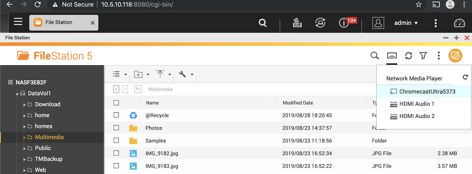

3. Simply open File, Photo, Music or the Video Station apps, select the file(s) you would like to stream and hit the cast button in the top right corner of the window as shown in the picture below.

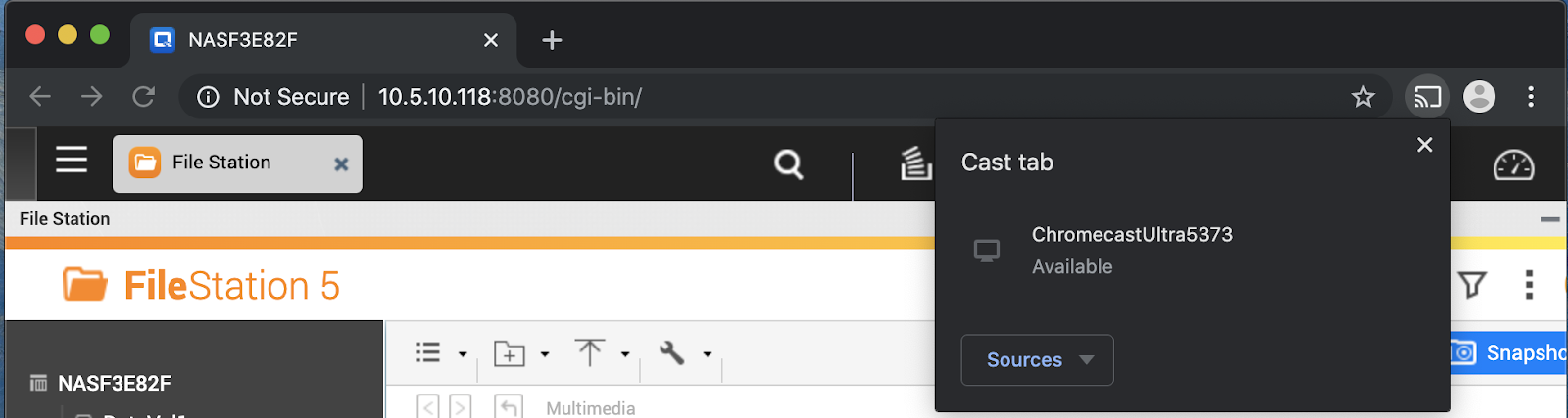

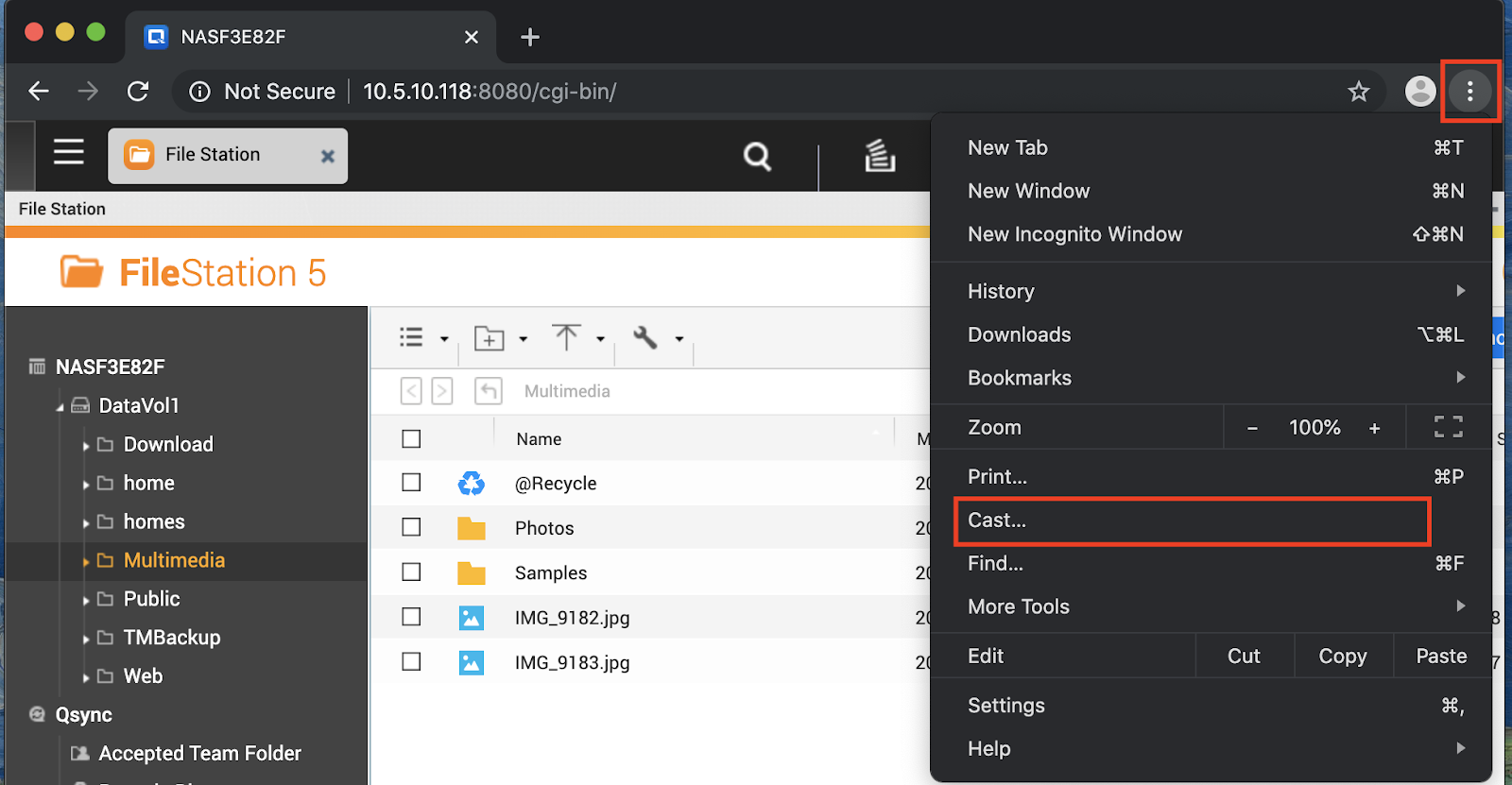

Please find a PC/Mac in the same network where NAS and Chromecast located and install the latest version of Chrome browser. Open Chrome browser, and click on Cast... see if Chromecast can be found by the browser.

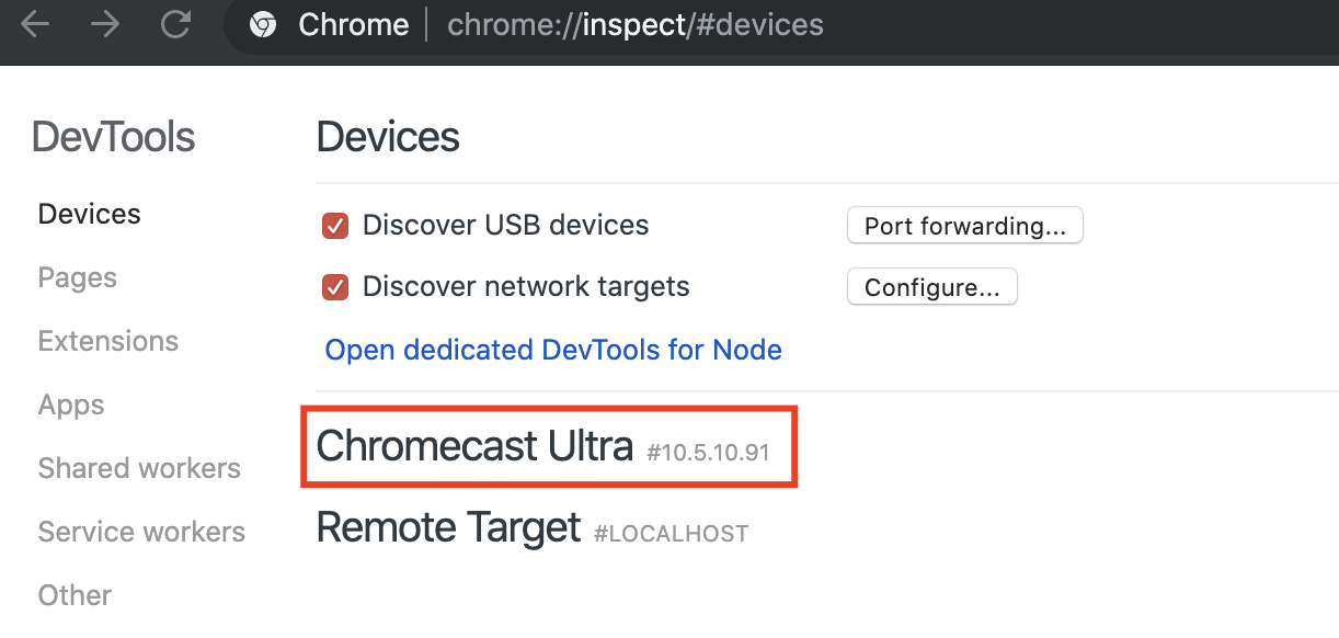

Put chrome://inspect/#devices into the address bar to find the IP of Chromecast. For instance,My Chromecast Ultra is at 10.5.10.91.
And check again to see if it’s in the same network of NAS.
