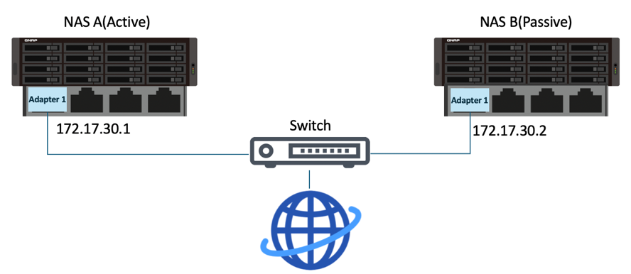

  • Cluster connection
    • The cluster connection on both NAS devices must be configured according to the following diagram:
    • Use the same network interface on both NAS devices to connect to the same network.
      Note
      • We recommend connecting them to the same network switch.
      • If a vSwitch adapter is bound to this interface, you must remove the binding before the interface can be used for the HA cluster.
    • On each NAS device, the network interface used for the primary cluster connection must be assigned a static IP address.
      Note
      The two static IP address on the two NAS devices must be in the same subnet.

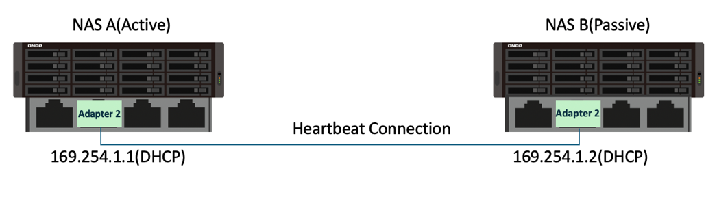

  • Heartbeat connection
    • The heartbeat connection between the NAS devices must be configured according to the following diagram:
    • The two NAS devices must be directly connected via the heartbeat interface, with no other devices in between.
    • Use the same network interface on both NAS devices to connect to each other.
      Note
      • The fastest and lowest-latency network interface is recommended.
      • If a vSwitch adapter or VLAN is bound to this interface, you must remove the binding before the interface can be used for the HA cluster.
      • The heartbeat connection always uses a fixed MTU size of 1500 bytes.
    • On each NAS device, the network interface used for the heartbeat connection must be assigned a DHCP IP address.

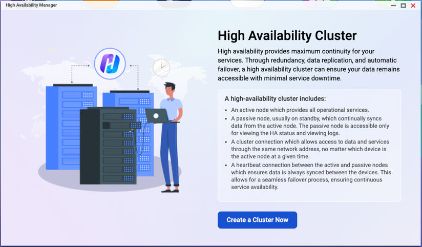

  4. On the active node device, open High Availability Manager.
    For our example, the active node device is "HANAS1".
  5. Click Create a Cluster Now.

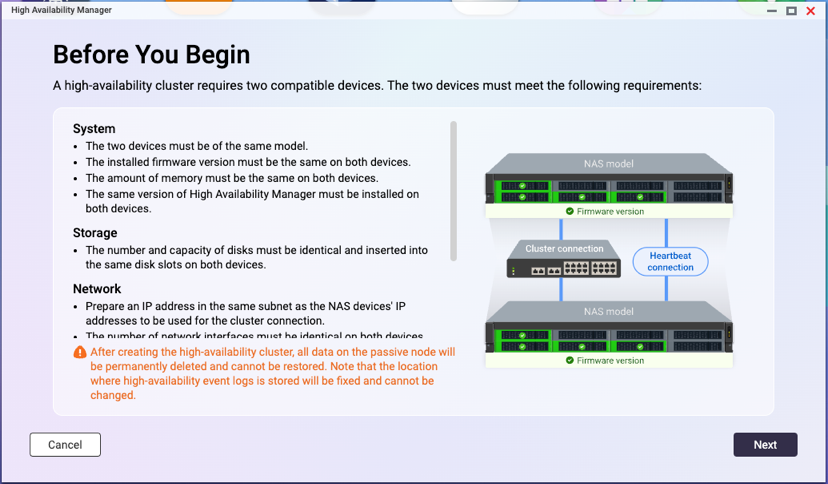

    The Before You Begin page appears.
  6. Verify that the configurations on the two NAS devices meet the listed requirements, and then click Next.

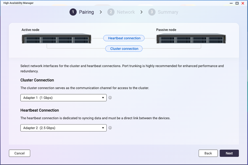

  7. Pair the two NAS devices.
    1. Under Cluster Connection, select a network interface.
      For our example, select "Adapter 1".
    2. Under Heartbeat Connection, select a network interface.
      For our example, select "Adapter 2".
    3. Click Next.

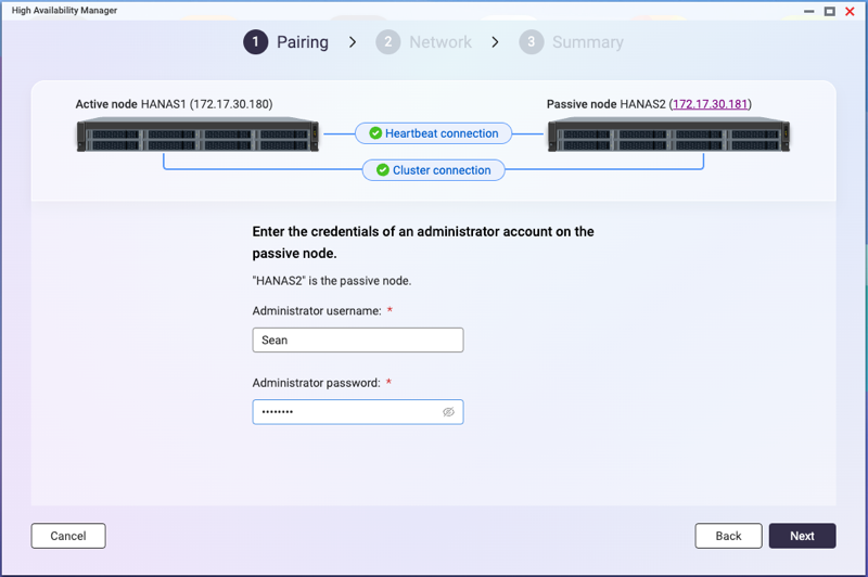

    4. Enter the credentials of an administrator account for the passive node device.
      For our example, the passive node device is "HANAS2".
    5. Click Next.

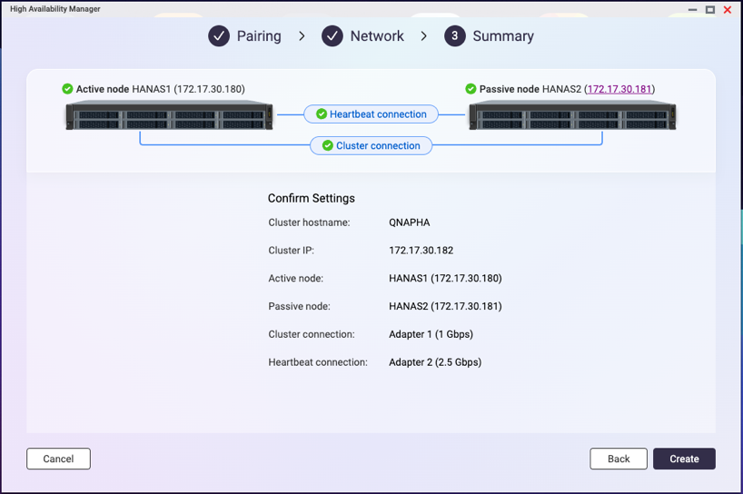

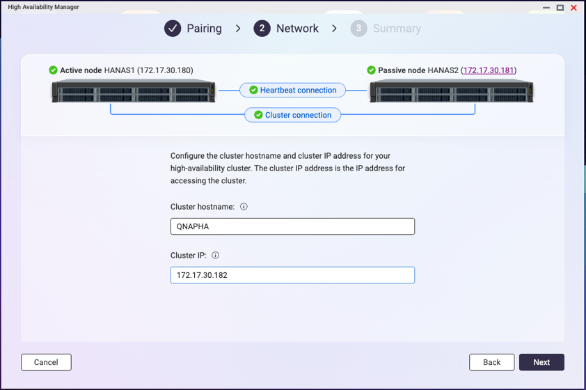

  8. Configure the cluster settings.
    The cluster hostname and cluster IP address specified in these steps will be used for accessing services in the HA environment.
    1. Specify a cluster hostname.
      Note
      • The cluster hostname must contain 1 to 12 characters.
      • The cluster hostname may only include letters (A-Z, a-z), numbers (0-9), and hyphens (-).
      • The cluster hostname will replace the original server name. The original node names will become "aliases", which will only be shown within High Availability Manager and Storage Manager.
    2. Specify a cluster IP address.
      Note
      The cluster IP address must be a static IP address in the same subnet as the cluster interface IP addresses on the two NAS devices.
    3. Click Next.
  9. Review the summary.

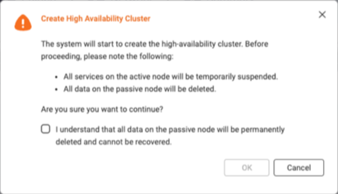

  10. Click Create.
    A warning message appears.
  11. Select I understand that all data on the passive node will be permanently deleted and cannot be recovered.
    Note
    Some services may also become temporarily unavailable during the creation process.
  12. Click OK.

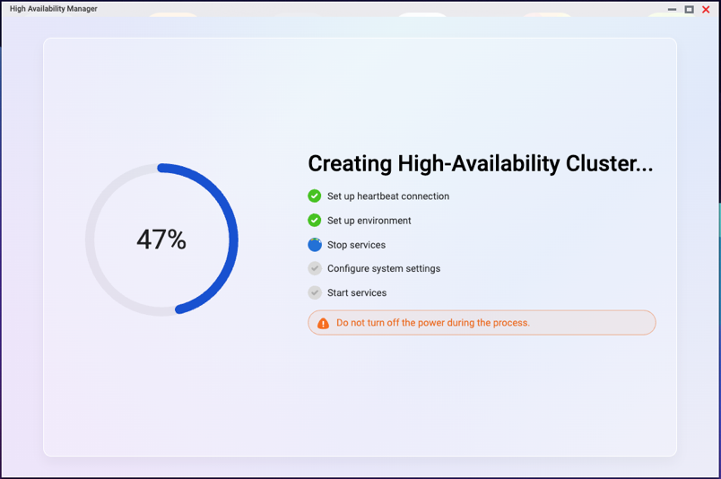

    The system begins to create the HA cluster. This process may take several minutes depending on your system environment.
    Important
    Do not shut down the NAS devices during the cluster creation process.

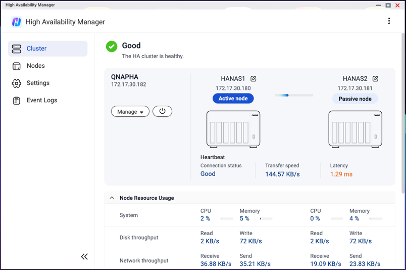

Once the system finishes creating the HA cluster, you will see a final confirmation page.
You can now manage and monitor your HA cluster in High Availability Manager.
