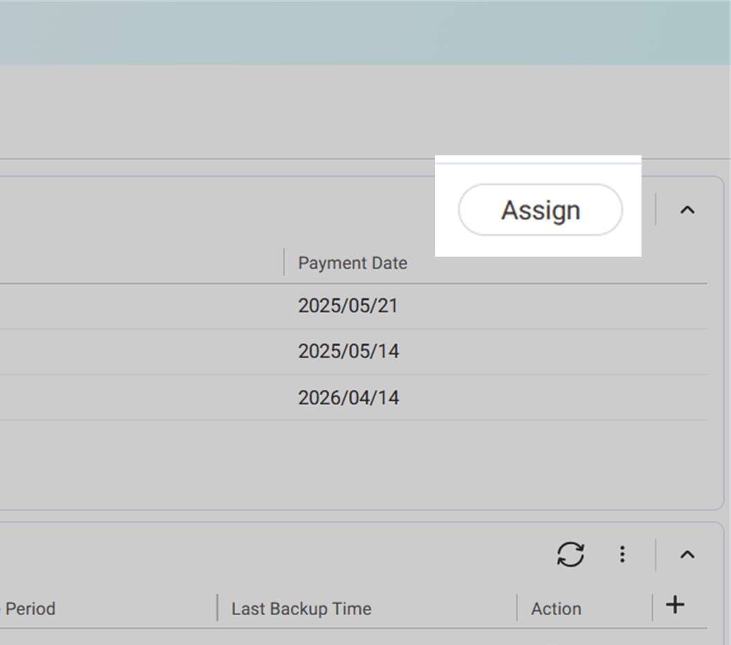

2. Click Assign on the top right corner of the Available License table.

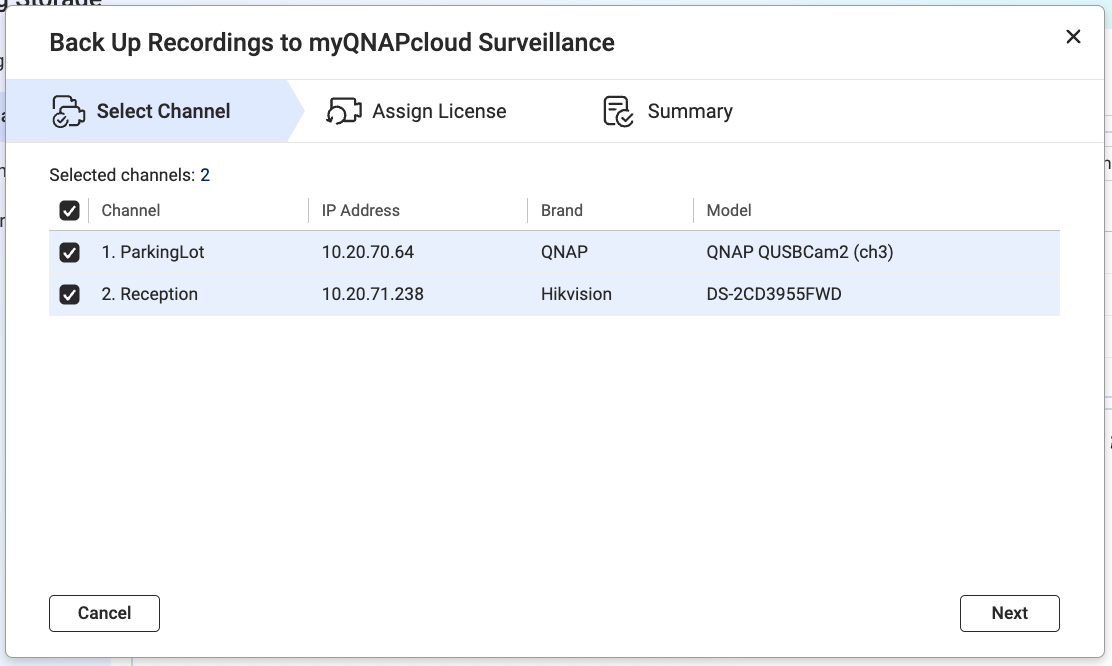

3. Select one or more channels from the list.

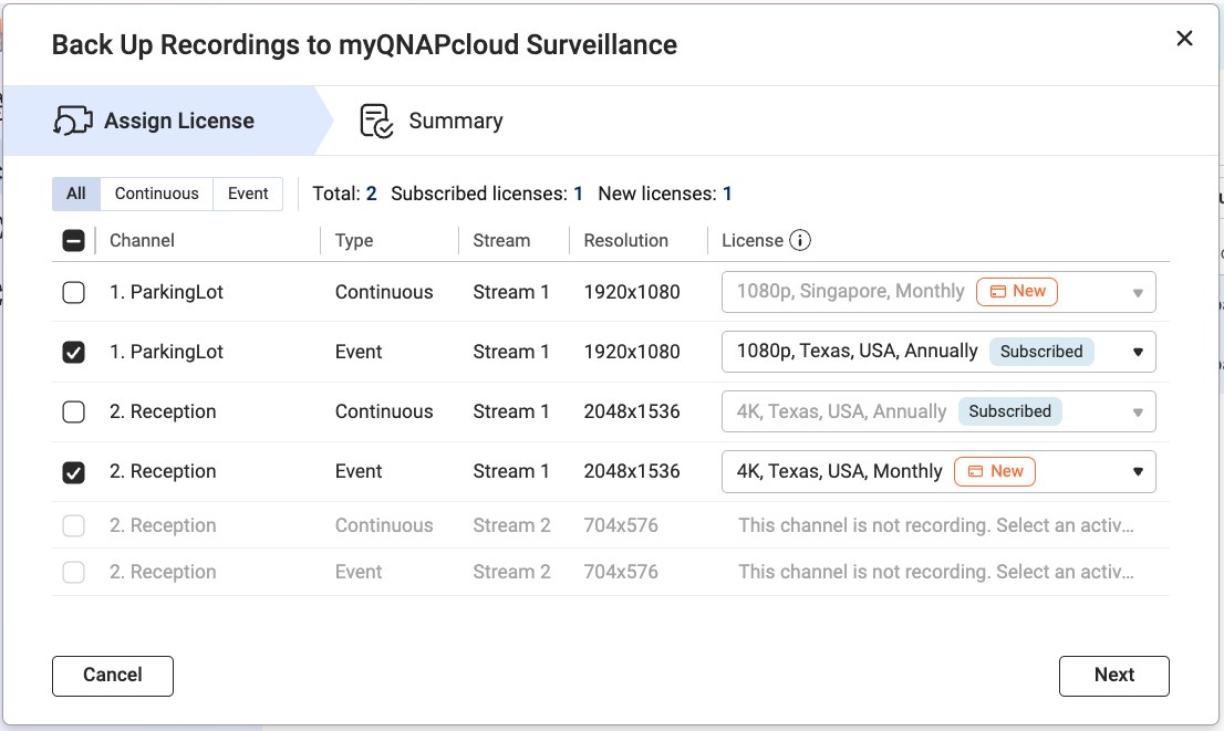

4. Confirm the stream and the recording type, review the selected license, and then click Next.
Note
  • Subscribed:
    • This means you have already purchased this license.
    • If you cannot select your purchased license, the stream's resolution may not meet the license criteria. Adjust your stream's settings to match the license resolution in Camera Settings, then restart the process.
    • For more details, see What license should I prepare for myQNAPcloud Surveillance.
  • New:
    • This means you need to purchase the license after clicking Assign on the final step.

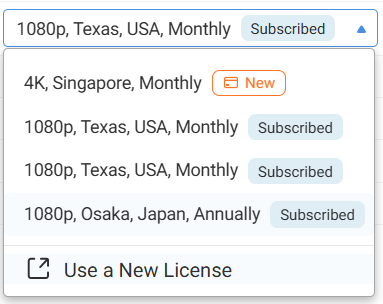

    • You can change the resolution, region, or the subscription period of the pre-assigned license by selecting Use a New License from the drop-down menu.

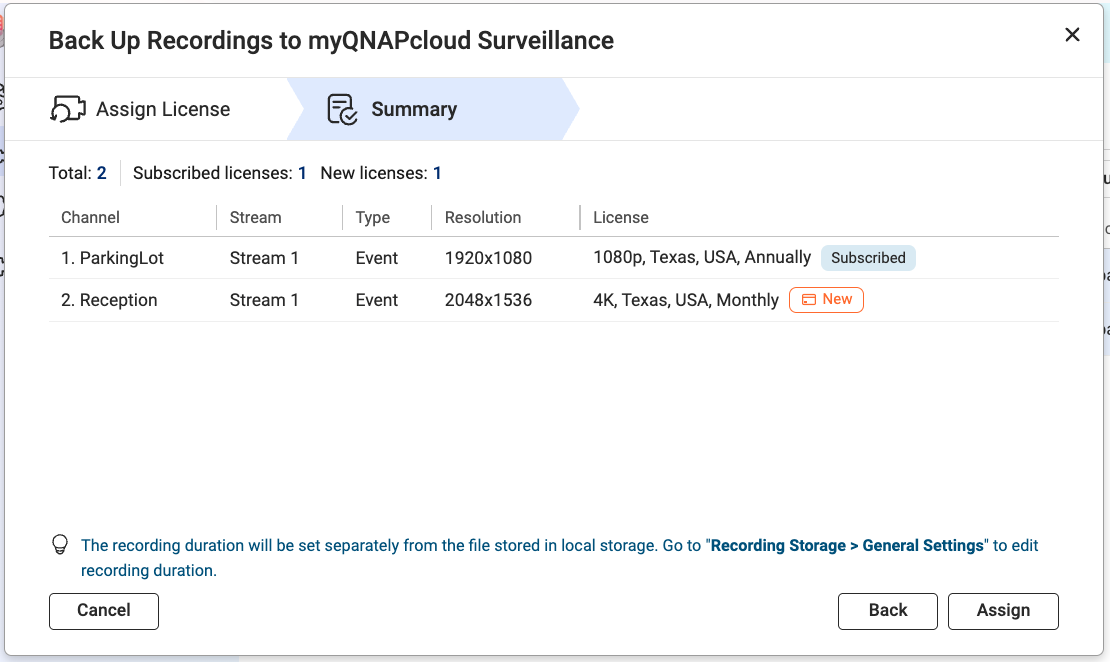

5. Review the summary, then click Assign.

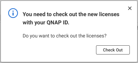

Important

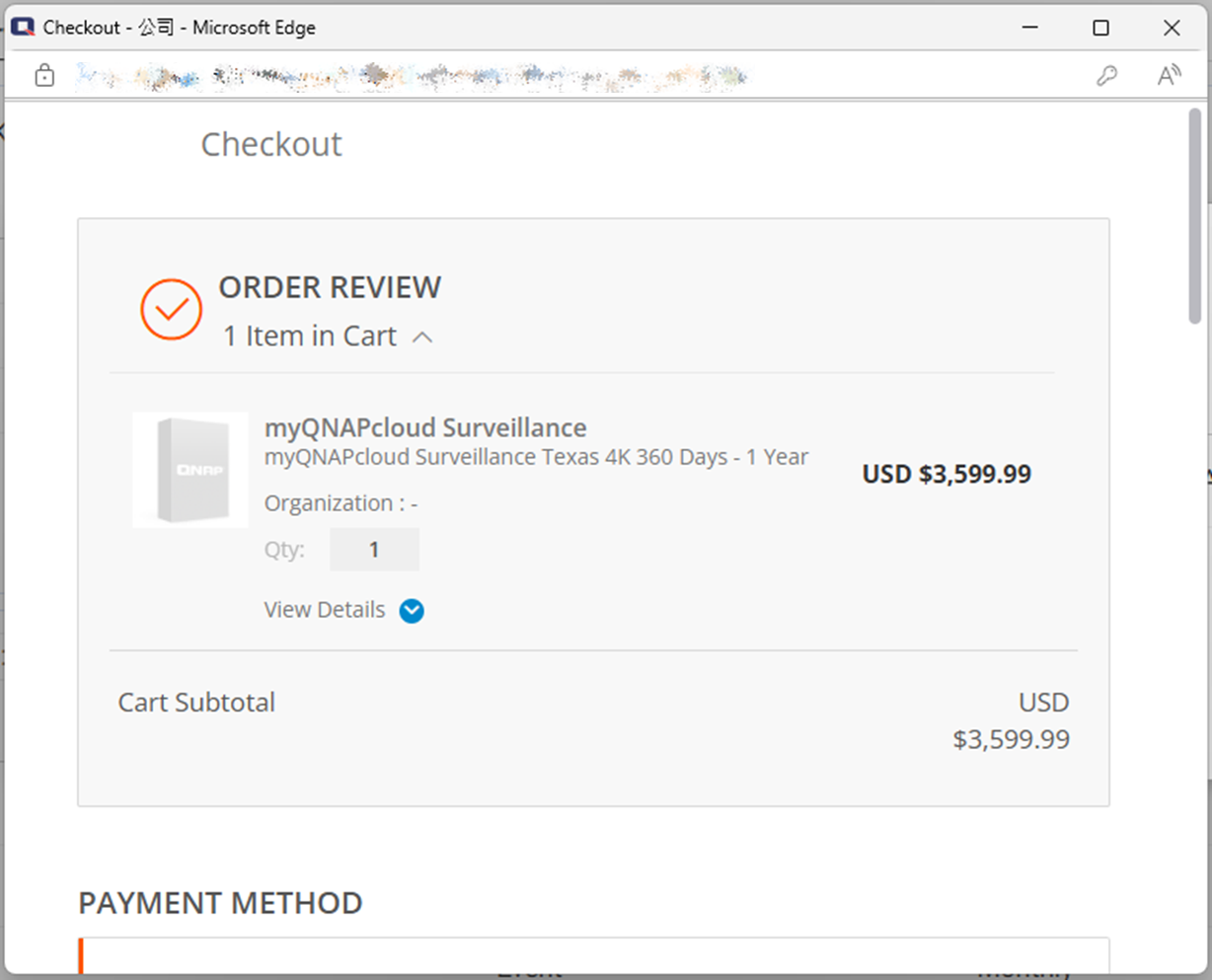

If you select a new license, you will be required to check out the license with your QNAP ID.
6. Click Check out to start the checkout process for the new licenses used in this assignment.
