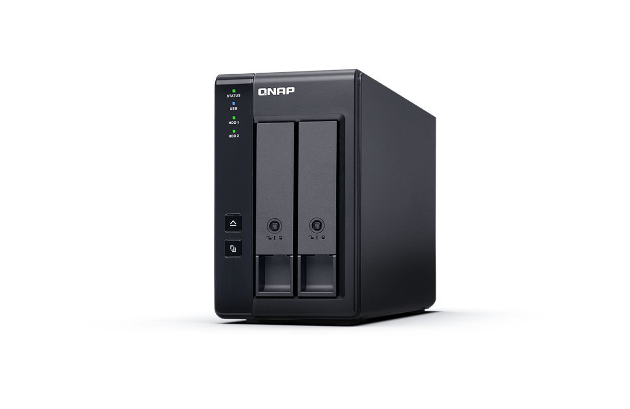

TR-002
2 Bay USB Type-C Direct Attached Storage with Hardware RAID
tr-002
The TR-002 USB 3.2 Gen 2 RAID expansion enclosure allows you to expand the capacity of your QNAP NAS and PC. The TR-002 can also be utilized as a DAS (Direct-attached Storage) device, allowing you to directly access its content just by connecting it via USB. The TR-002 features two 3.5-inch SATA drive bays with multiple RAID configuration options and USB 3.2 Gen 2 Type-C connectivity to bring you a highly reliable and secure storage capacity expansion solution.
1. To ensure optimal system compatibility, transfer performance, and data integrity, please connect the external enclosure directly to the USB port of your NAS or PC. Do not connect a USB hub or docking station between the host system and the expansion unit.
2. Non-Server versions of Windows have a 63TB limit for a single volume. Thus, when connecting QNAP storage expansion products, the same limitation applies. For volumes larger than 63TB, it is recommended to use the Windows Server operating system.
  • USB 3.2 Gen 2 (10Gbps)
    USB 3.2 Gen 2 Type-C port* for faster data transfer.
    Maximum 1M USB cable is recommended.
  • Supports SATA drives
    Supports up to two SATA drives for reliable read and write performance
  • Disk mode DIP switch
    Disk mode DIP switch to change from Hardware Control and Software Control configurations for setting RAID group.
  • Lockable drive trays
    Lockable hard drive trays to prevent accidental drive removal.
  • Easy to eject
    Eject button for disconnecting the TR-002 from a NAS or computer*.
    Requires the QNAP External RAID Manager utility.
Effective storage expansion with RAID Support
The TR-002 is an ideal storage expansion solution for PCs, especially for laptops which lack the ability to install larger, higher-capacity drives. Featuring two 3.5-inch SATA drive bays and supporting RAID configuration, the TR-002 provides the ability to store a vast number of files and data and to ensure protection against potential drive failure.
Supports various RAID levels
The TR-002 supports a variety of RAID configurations. Depending on your requirements, you can switch between hardware- or software-controlled RAID modes. Move the DIP switches to corresponding positions for your ideal RAID mode: Individual, JBOD, RAID 0 or RAID 1. You can also configure the RAID settings from your QNAP NAS, or by using the QNAP External RAID Manager utility on your computer.
