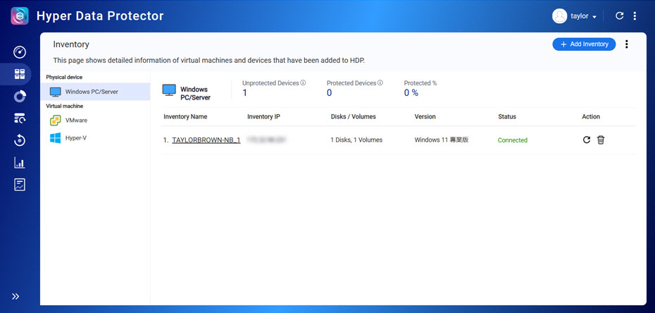

    After logging in, Netback PC Agent automatically creates an inventory in HDP for your PC/server. An HDP inventory stores configuration and connection information for your PC/server and allows you to easily manage your backups.

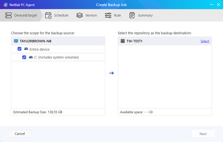

    The Create Backup Job window appears.
  3. Create a repository on your NAS.
    A repository is a shared folder on your NAS where your backup data is stored.
    1. Click Select next to your NAS device.
    2. Follow the remaining steps to create a repository.
    3. Click Next.
  4. Specify when you want the backup job to run. You can run the backup job manually at any time, automatically based on a schedule, or automatically based on a trigger event.
  5. Click Next and follow the remaining steps to create the backup job.

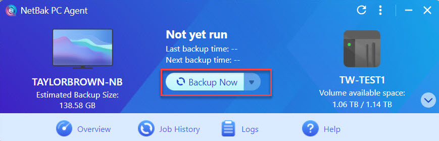

  6. After creating the backup job, run the backup job by clicking Backup now.

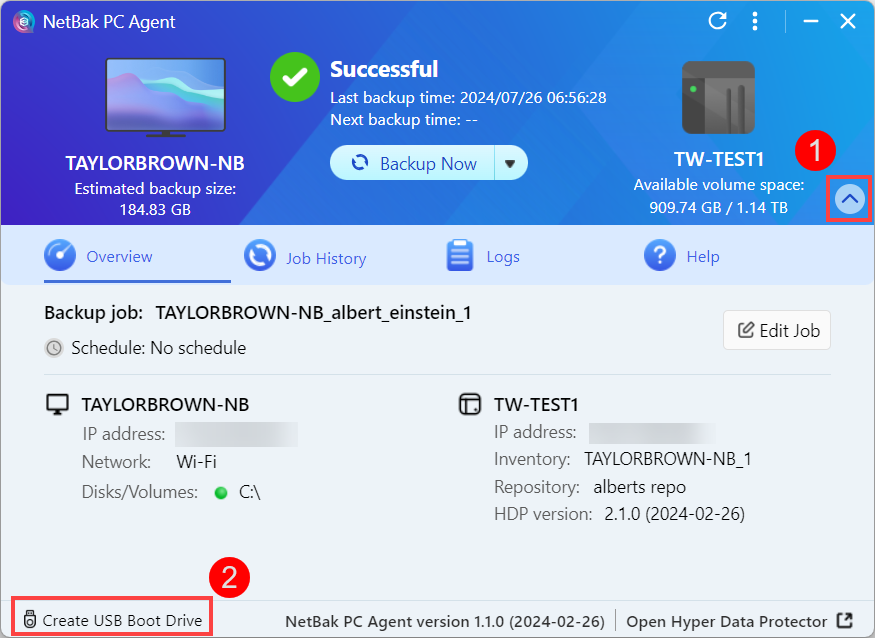

  4. Click (down arrow) on the bottom right corner and click Create USB Boot Drive.

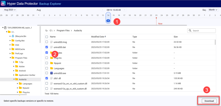

  4. In HDP Backup Explorer, select your backup version, select the files and folders, then click Download to download the files/folders to your PC/server. You can then replace the original files/folders with the downloaded files/folders if needed.
