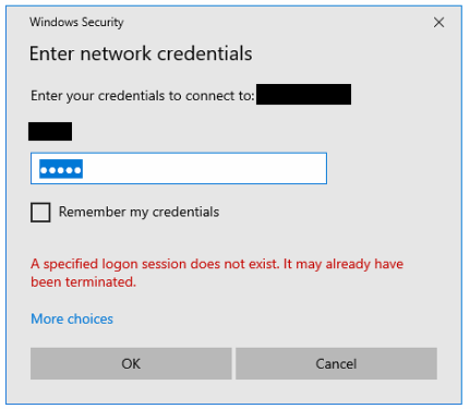

On Windows 10 or later, you may encounter the "Enter network credentials" error when connecting to your NAS.
Root Cause
By default, Windows first tries to access an SMB server using your Windows account credentials. If these differ from your NAS account credentials, the connection is rejected and Windows displays this prompt so you can enter your NAS credentials instead.
Note
This is expected Windows behavior, not a sign of a network or security problem with your NAS.

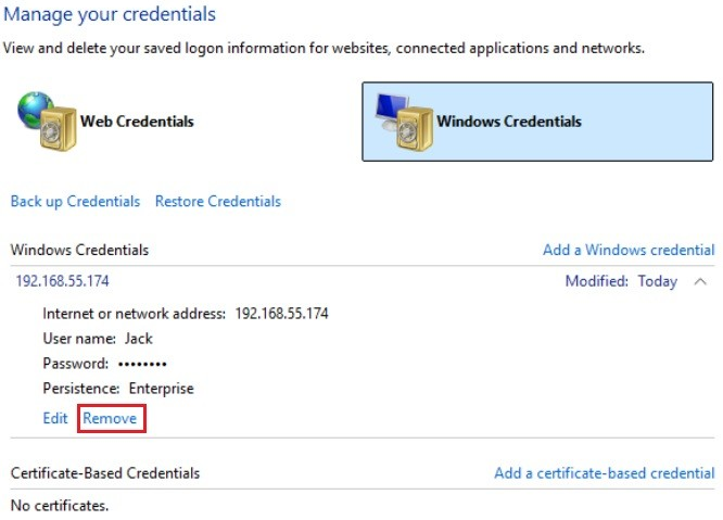

  1. On your Windows PC, open Control Panel.
  2. Go to User Accounts > Credential Manager > Windows Credentials.
  3. Click Remove to remove the saved Windows credentials for your NAS (identified by IP address or server name).

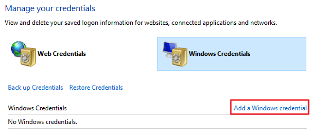

  4. Click Add a Windows credential.
  5. In the User namefield, specify your NAS username using the following format:
    • For NAS users: NAS Server Name\Your Username. For example, if your NAS is named "QNAPNAS" and your username is "Jack," enter "QNAPNAS\Jack".
    • For domain users: Domain Name\Your Username. If you continue to experience issues, refer to Solution 2.
  6. Complete the following fields as well:
    • Internet or network address: Specify the IP address or hostname of your NAS.
    • Password: Specify the password for your NAS account.
Tip
We recommend saving these credentials in Credential Manager for convenience.
  1. Click OK.
