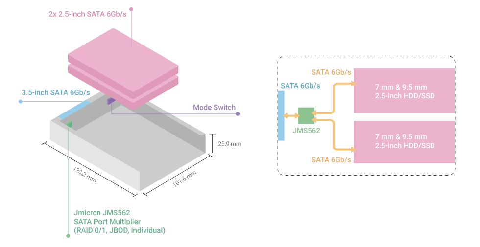

Architecture diagram
Note: The connected drive may not reach its optimal performance due to protocol translation and some overhead.

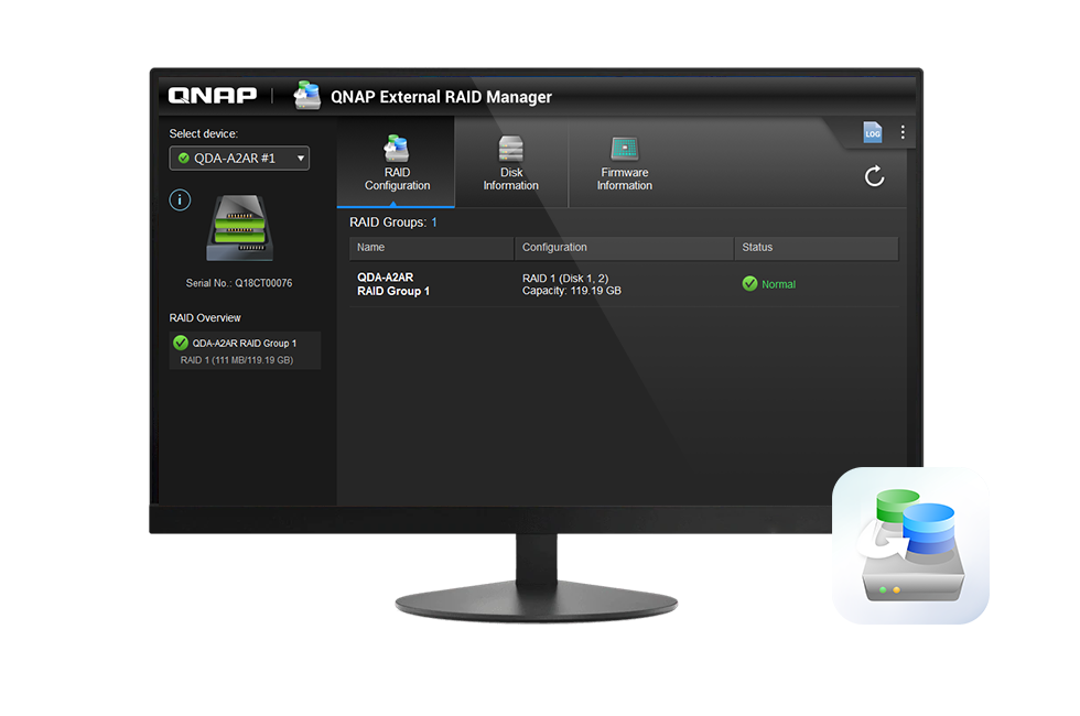

External RAID Manager for Windows users
The QNAP External RAID Manager utility allows Windows® users to view the drive status and RAID information of the QDA-A2AR. Firmware updates for the QDA-A2AR can also be managed with the External RAID Manager utility.
