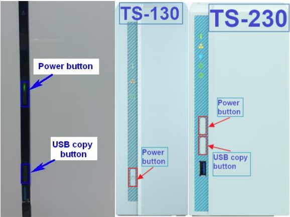

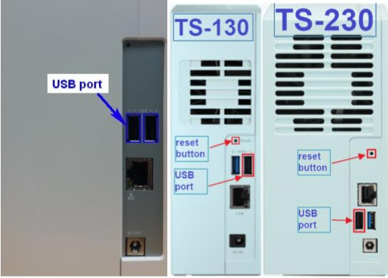

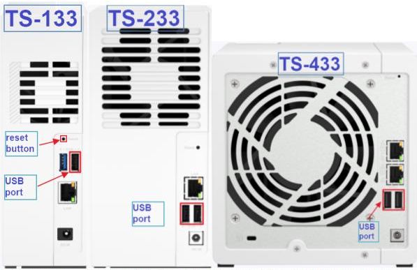

  3. Connect the USB boot drive to a rear USB port of the NAS.

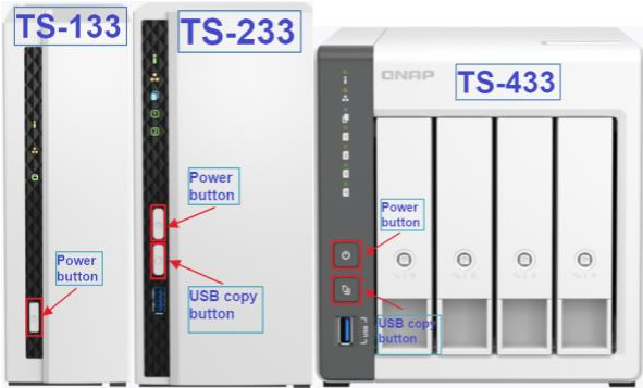

  4. Power on the NAS with the following steps:
    1. Press and hold the USB One Touch Copy button or reset button.
    2. Press the power button.
    3. Continue holding the USB One Touch Copy button or reset button until a NAS audio alert is triggered.
    4. Release the USB One Touch Copy button or reset button.

  6. If your NAS is a TS-133, TS-233, TS-433, TS-216, TS-216G, TS-416 or TS-AI642 then perform the following:
    1. Wait until the system status LED starts flashing alternate red & green.
      The NAS firmware recovery process starts.
    2. When the NAS firmware recovery process is finished, a NAS audio alert of 3 short beeps is triggered.
    3. If the system status LED became solid red and a NAS audio alert of 2 long beeps was triggered during the recovery process, then the NAS recovery process failed. Retry the recovery process by repeating steps 4 & 6. If the NAS recovery process is still not successful, see the Further Troubleshooting section below.

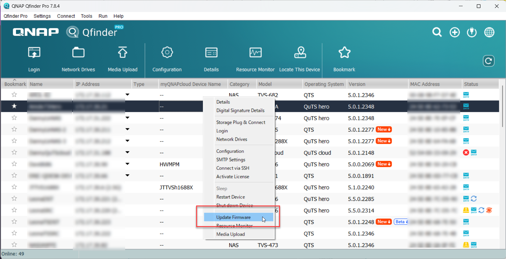

Install the latest firmware version on your NAS with Qfinder Pro
  1. Download and install Qfinder Pro.
  2. Open Qfinder Pro.
  3. Locate your NAS in the device list.
    Tip
    For details on using Qfinder Pro, see Qfinder Pro Help.
  4. Right click on your NAS.
  5. Select Update Firmware.

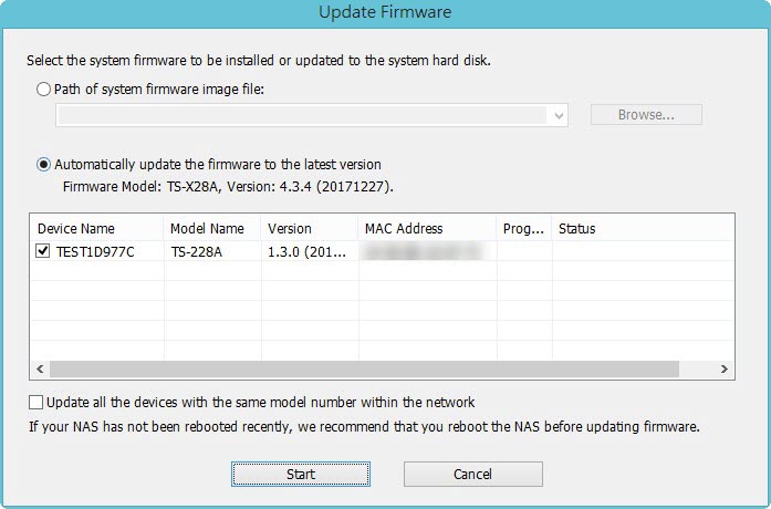

    The Update Firmware window opens.
  6. Select Automatically update the firmware to the latest version.
  7. Click Start.
    The NAS firmware will be updated to the latest version.
