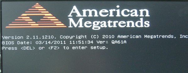

  6. Power on the NAS
    BIOS information is displayed including the version and release date of the BIOS.
  7. Wait until the DOM (Disk-on-module) starts up.
    If the DOM fails to start up completely, then the DOM data has been corrupted and you can continue following this guide to recover the NAS.

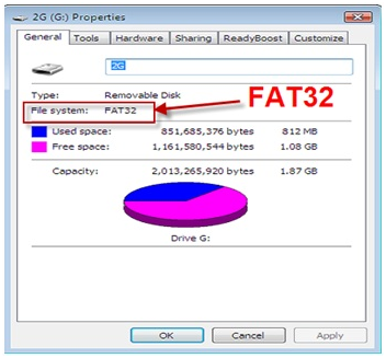

  3. Format the USB flash drive as FAT32:
    1. Open File Explorer.
    2. Go to My Computer.
    3. Locate the USB flash drive.
    4. Right click the USB flash drive icon.
      A context menu appears.
    5. Click Format.
      The USB Format window appears.
    6. Under File system, select Fat32.
    7. Click Start.
      A confirmation window appears explaining that all data will be erased on the flash drive.
      Warning
      Formatting a USB flash drive will erase all its existing data. If you have data on the USB flash drive you want to preserve, copy the data to your PC first, then after formatting the USB flash drive, copy the data back.
    8. Click OK.
      The USB flash drive is formatted.

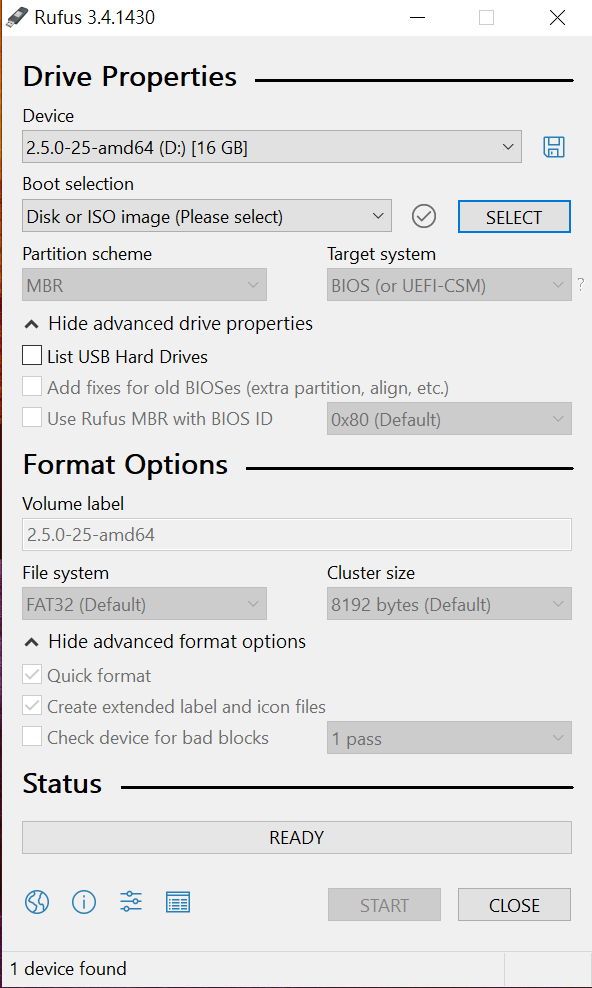

  4. Install Clonezilla on the USB drive:
    1. Open Refus.
    2. Under Device, select the USB drive.
    3. Next to Boot selection, click Select.
    4. Select the downloaded Clonezilla ISO file.
    5. Click Open.
    6. Click Start.
      Rufus installs Clonezilla onto the USB drive.

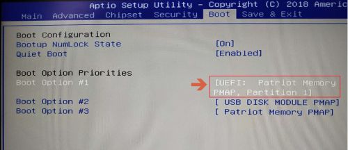

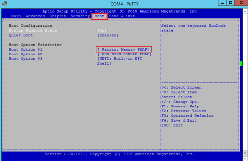

  4. Press the delete key to enter the BIOS page when the enter setup prompt appears on the monitor connected to the NAS.
    The BIOS page appears.
  5. Use arrow keys to navigate to the Boot tab.
  6. Under Boot Option Priorities > Boot Option #1, specify your USB flash drive. If your NAS has UEFI-based BIOS (for example the HS-453DX, TVS-951X, TVS-h1288X, TVS-h1688X, or TS-h3088XU) then select the UEFI version of your USB flash drive.
    Warning
    Do not select USB DISK MODULE.
    Selecting the UEFI version of your USB drive for UEFI-based BIOS:

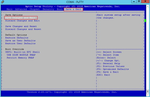

  7. Use the arrow keys to navigate to the Save & Exit tab.
  8. Under Save Options, select Save Changes and Exit and press enter.
    The NAS will start up using your USB drive, and the Clonezilla options page appears.

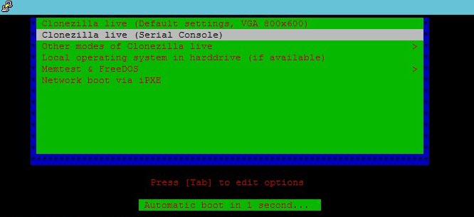

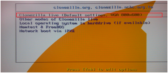

  9. Select the Clonezilla boot option:
    1. If your monitor is connected to the NAS via a com port, then select Clonezilla Live (Serial Console).
    2. If your monitor is connected to the NAS via an HDMI™ or VGA cable, then select Clonezilla Live (Default settings, VGA 800x600).

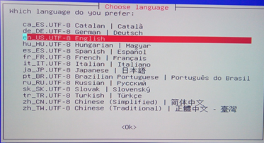

  10. If the Choose language page appears, select your language.

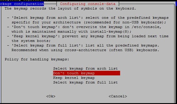

  11. If the Configuring console-data display page appears, select Don't touch keymap.

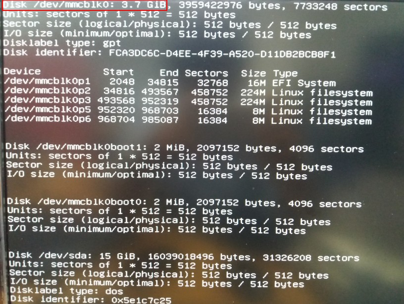

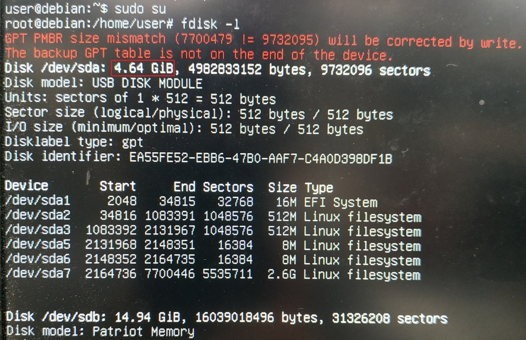

  14. View NAS partitions by entering the following commands:
    sudo su
    fdisk –l
    The partitions present depend on the NAS model:
    • TS-251A, TS-253E, TS-451A, TBS-453A, TS-551, TBS-453DX, HS-453DX, TS-262, TS-462, TS-662, TS-264, TS-464, TS-664, TS-464U, TS-1264U-RP, TS-x62C, TS-x64C, TBS-464:
      PartitionDescription
      /dev/sdaThe USB boot device
      /dev/mmcblk0The DOM (Disk On Module)
    • TS-251B, TS-253B, TS-453B, TS-653B, TS-253Be, TS-453Be:
      /dev/mmcblk1The DOM (Disk On Module)
    • All other NAS models:
      /dev/sdbThe DOM (Disk On Module) drive. The storage capacity of the DOM depends on the NAS model:
      • TDS-16489U R2 / TES-1885U / TES-3085U: 3.9 GB
      • TVS-h1288X/TVS-h1688X/TS-h3088XU: 4.64 GB
      • TVS-675: 4.7 GB
      • All other models: 492 MB

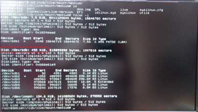

  15. Enter the following command:
    cd /lib/live/mount/medium/
  16. Enter the following command depending on your NAS model:
    1. TS-251A, TS-253E, TS-451A, TBS-453A, TS-551, TBS-453DX, HS-453DX, TS-262, TS-462, TS-662, TS-264, TS-464, TS-664, TS-464U, TS-1264U-RP, TS-x62C, TS-x64C, TBS-464:
      cp dom.img /dev/mmcblk0
    2. TS-251B, TS-253B, TS-453B, TS-653B, TS-253Be, TS-453Be, TS-453BT3:
      cp dom.img /dev/mmcblk1
    3. TVS-h1288X, TVS-h1688X, TS-h3088XU:
      cp dom.img /dev/sda
    4. All other NAS models:
      cp dom.img /dev/sdb
    5. The NAS system image is copied to the NAS DOM.

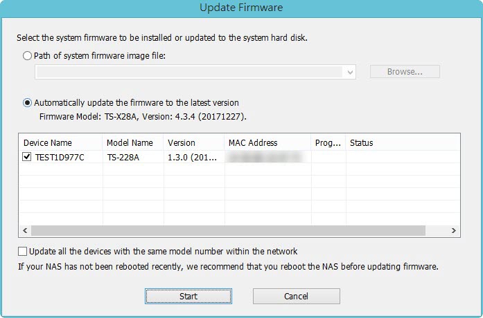

Install the latest firmware version on your NAS with Qfinder Pro
  1. Download and install Qfinder Pro.
  2. Open Qfinder Pro.
  3. Locate your NAS in the device list.
    Tip
    For details on using Qfinder Pro, see Qfinder Pro Help.
  4. Right click on your NAS.
  5. Select Update Firmware.
    The Update Firmware window opens.
  6. Select Automatically update the firmware to the latest version.
  7. Click Start.
    The NAS firmware will be updated to the latest version.
