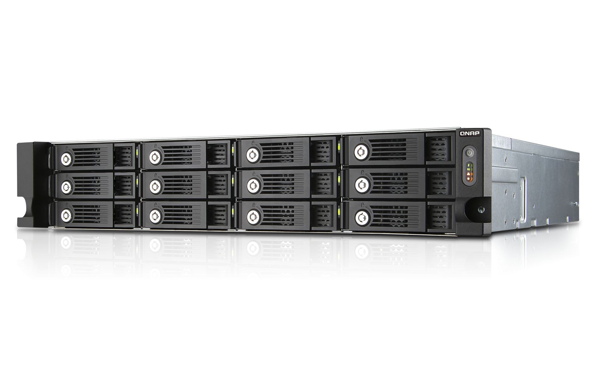

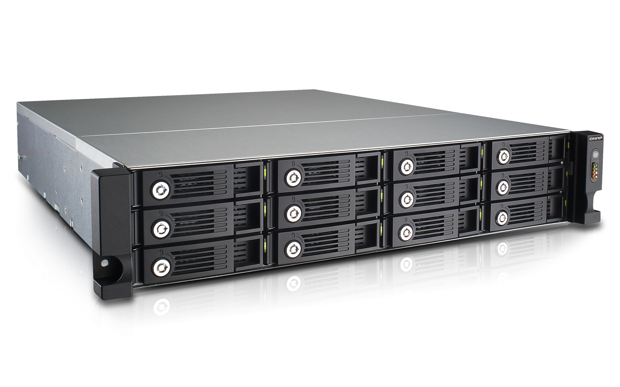

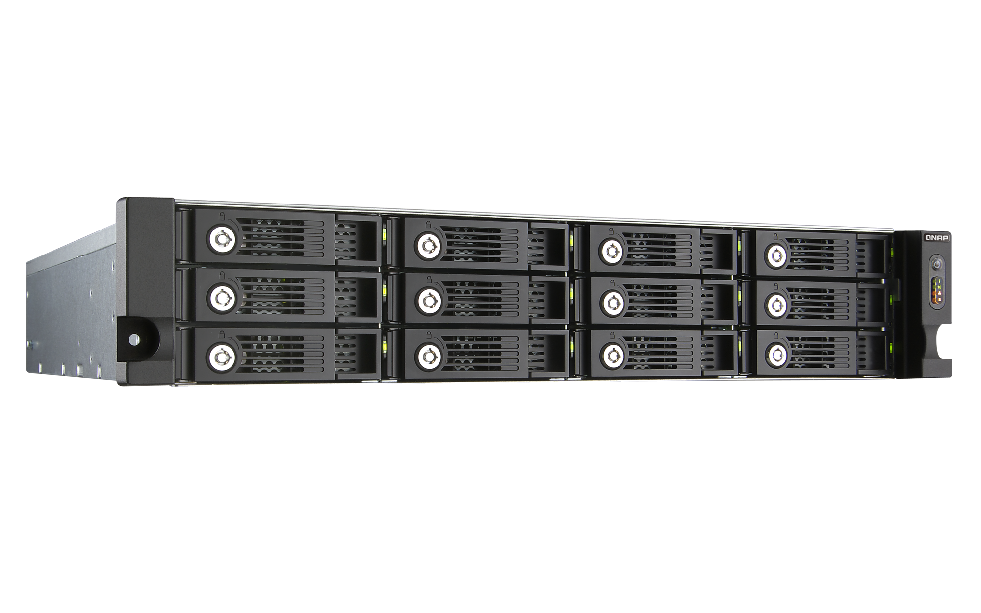

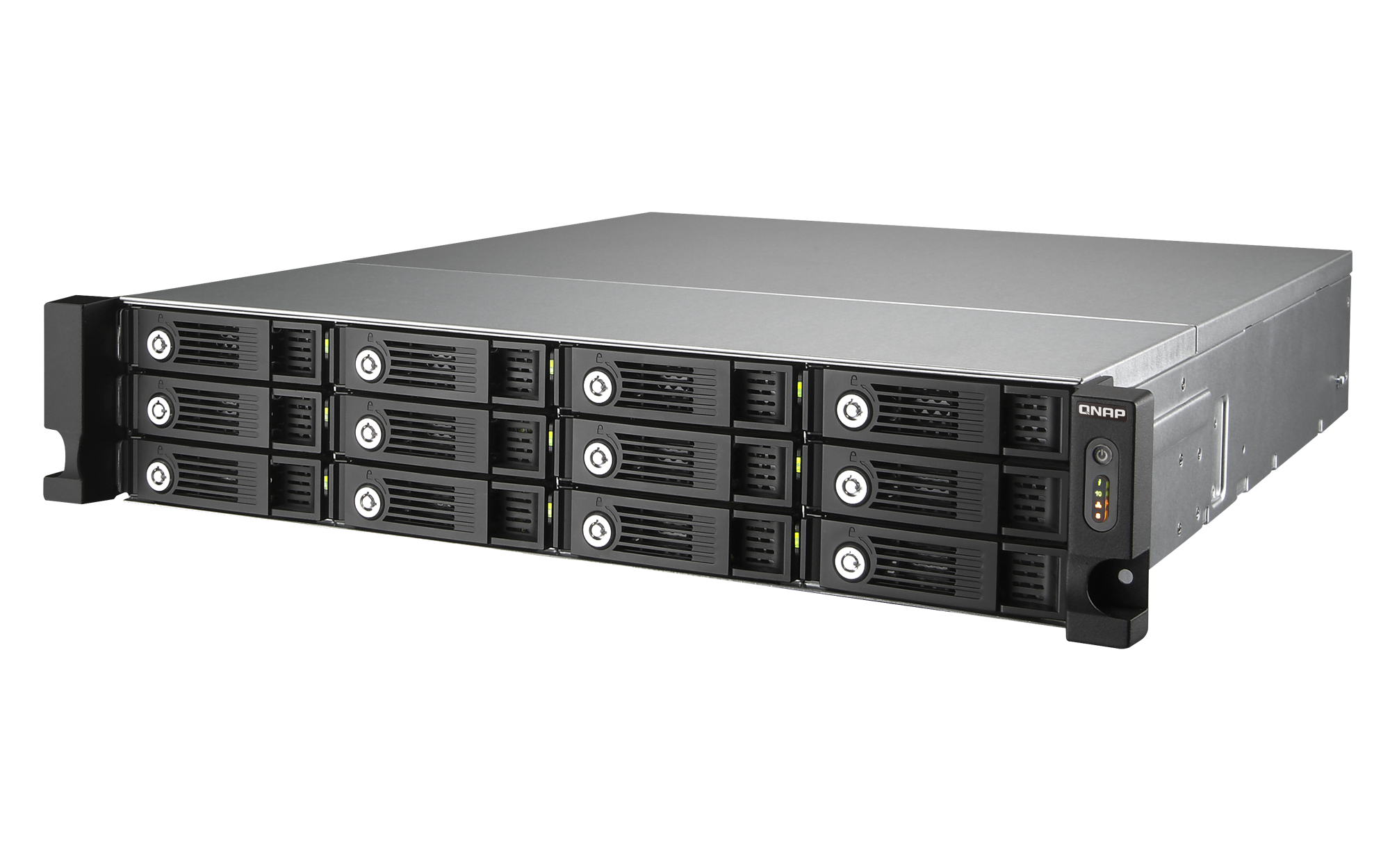

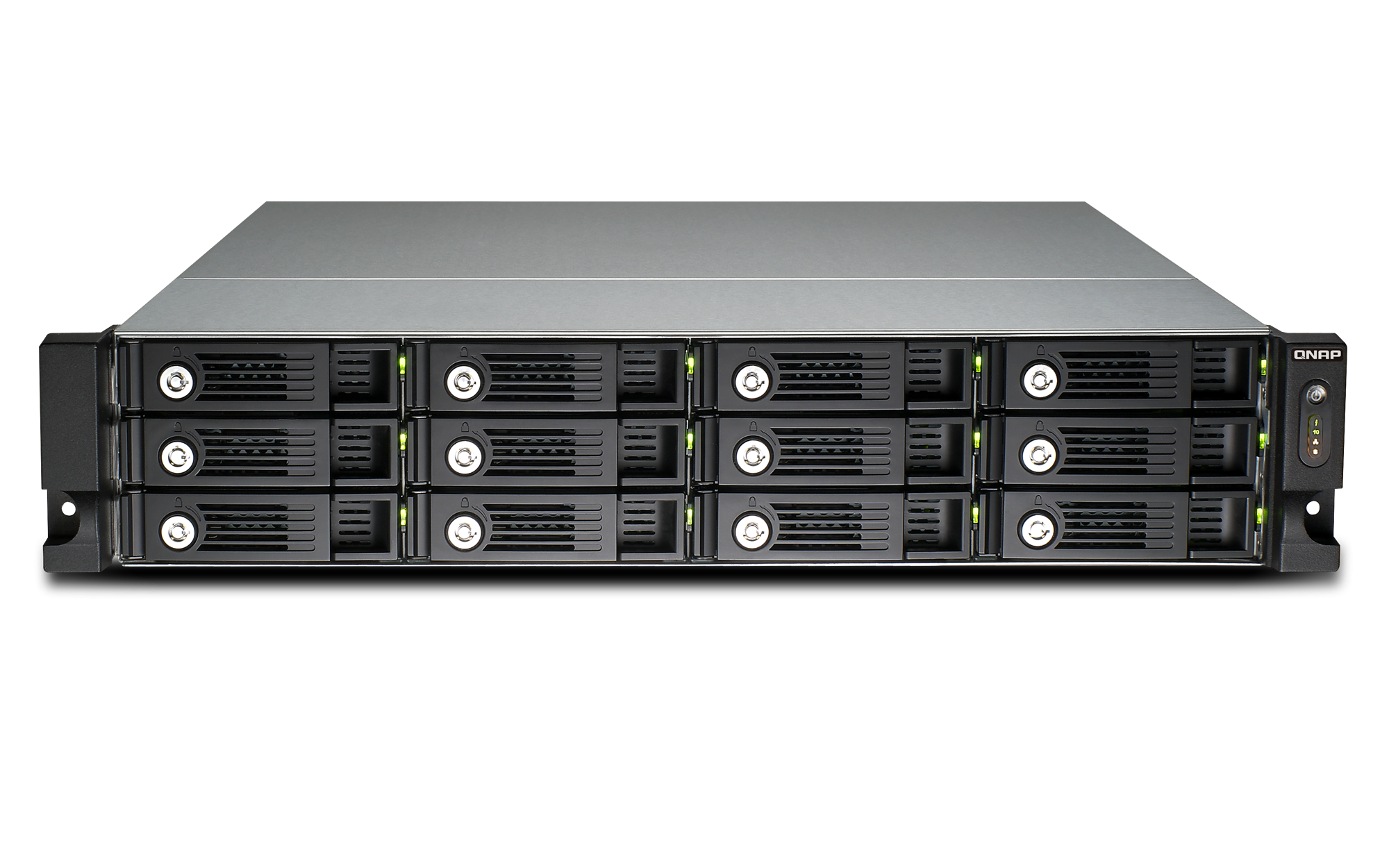

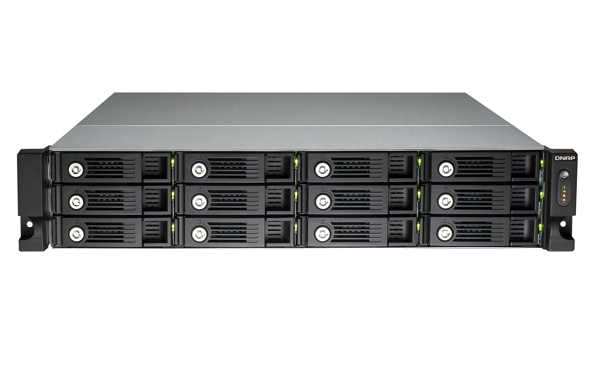

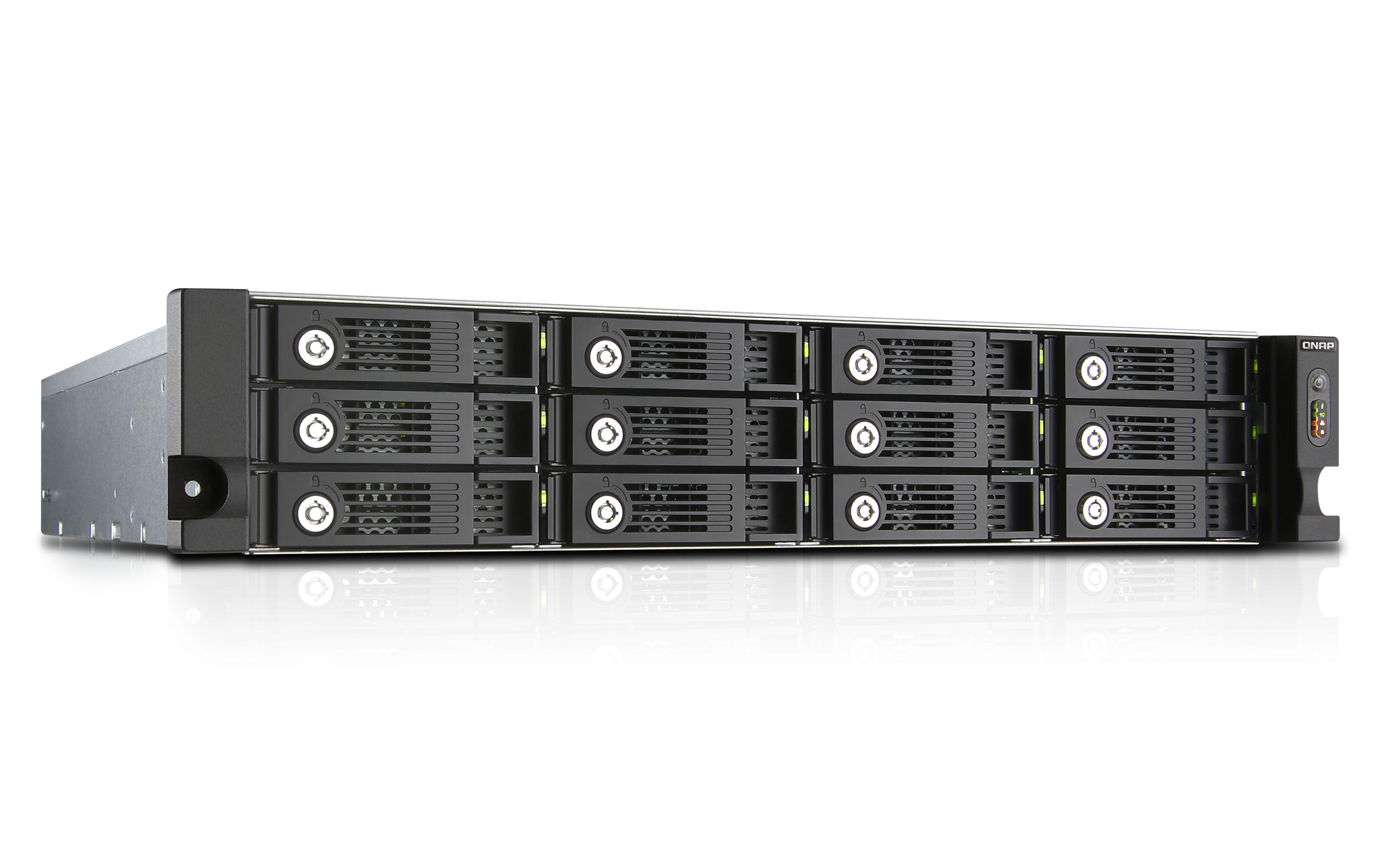

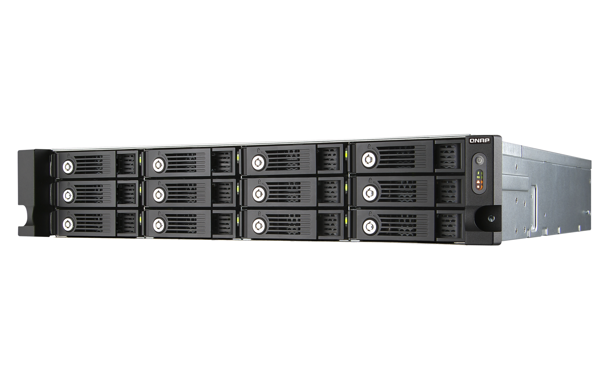

Hard Drive 12 x 3.5” or 2.5” SATA 6Gb/s, SATA 3Gb/s hard drive or SSD
NOTE:
1. The standard system is shipped without hard drives.
2. For the hard drive compatibility list, please visit www.qnap.com/compatibility.
Hard Drive Tray 12 x hot-swappable and lockable tray

LED Indicators Status, 10 GbE, LAN, eSATA, hard drives

Buttons System: Power button and reset button
Alarm Buzzer System warning

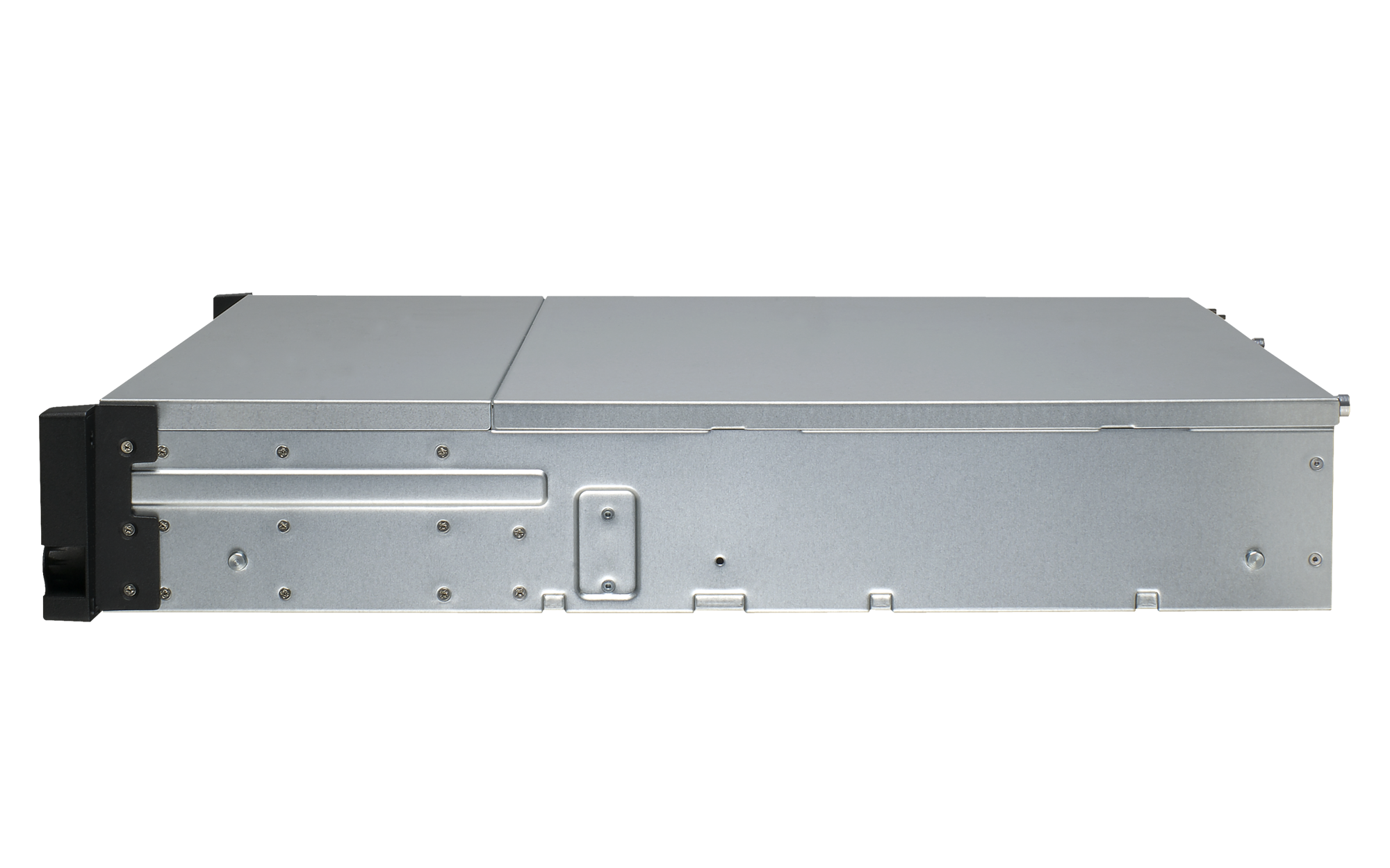

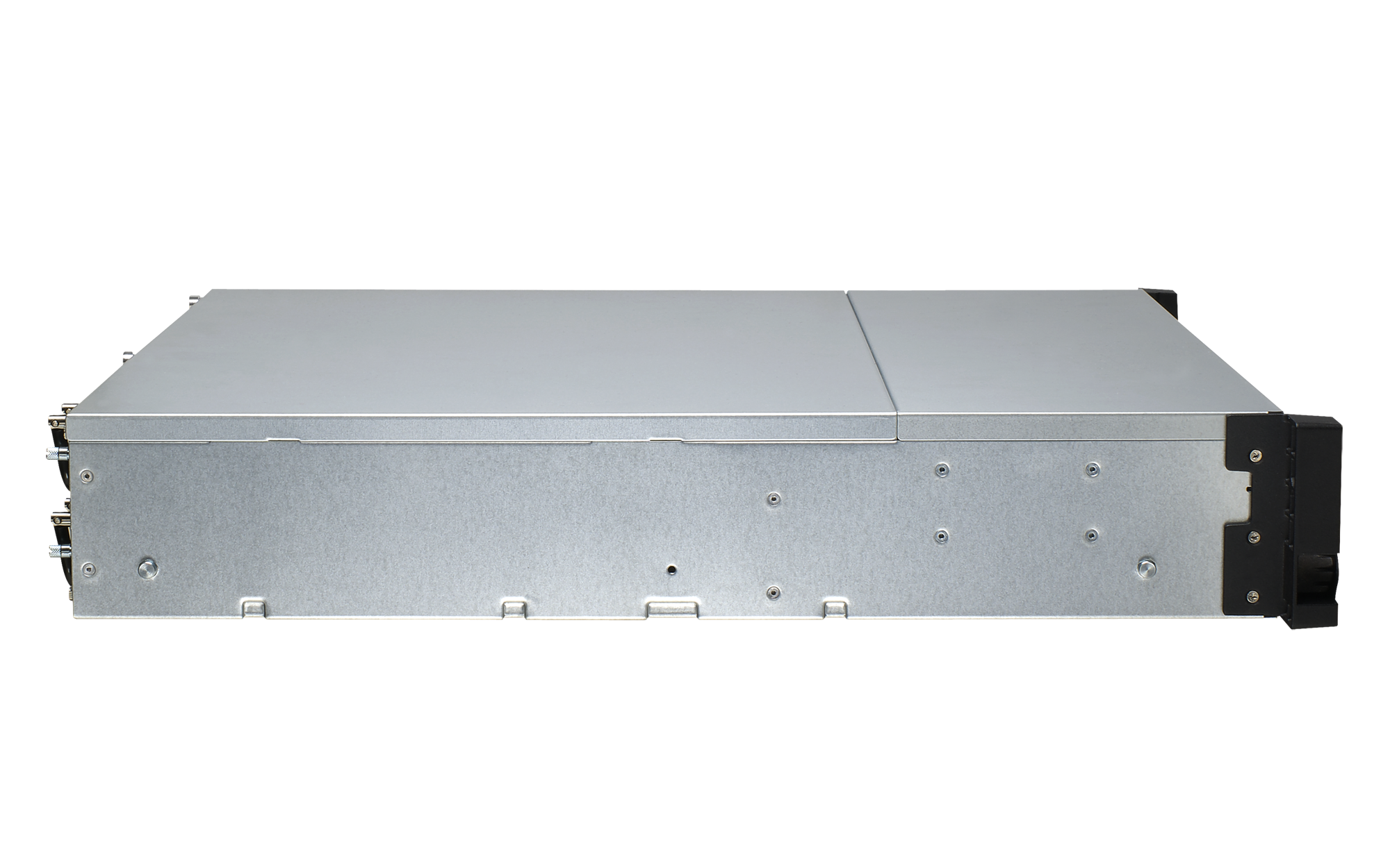

Form Factor 2U, Rackmount
Dimensions 89 (H) x 482 (W) x 534 (D) mm
3.50 (H) x 18.98 (W) x 21.02 (D) inch
Weight 16.14 kg/35.58 lb (Net)
18.98 kg/ 41.84 lb (Gross)
