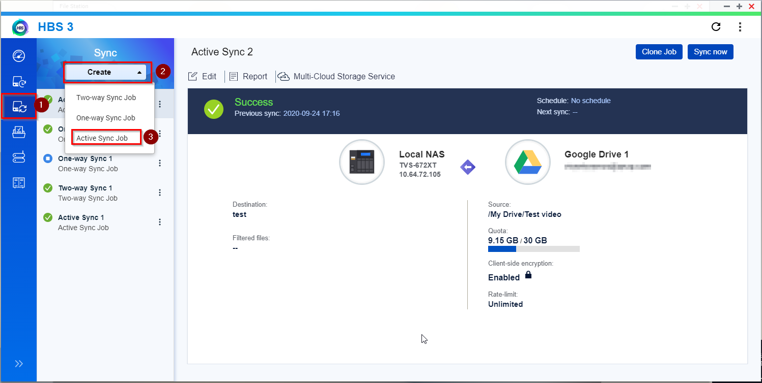

The way to recover them is creating an “Active Sync Job” to sync from the Cloud to the NAS and enabling the encryption again.
1. Create the Job

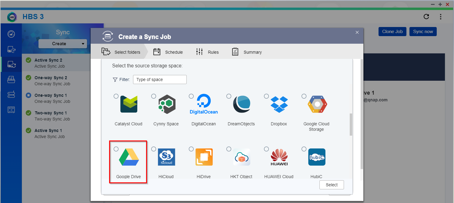

2. Select the cloud provider

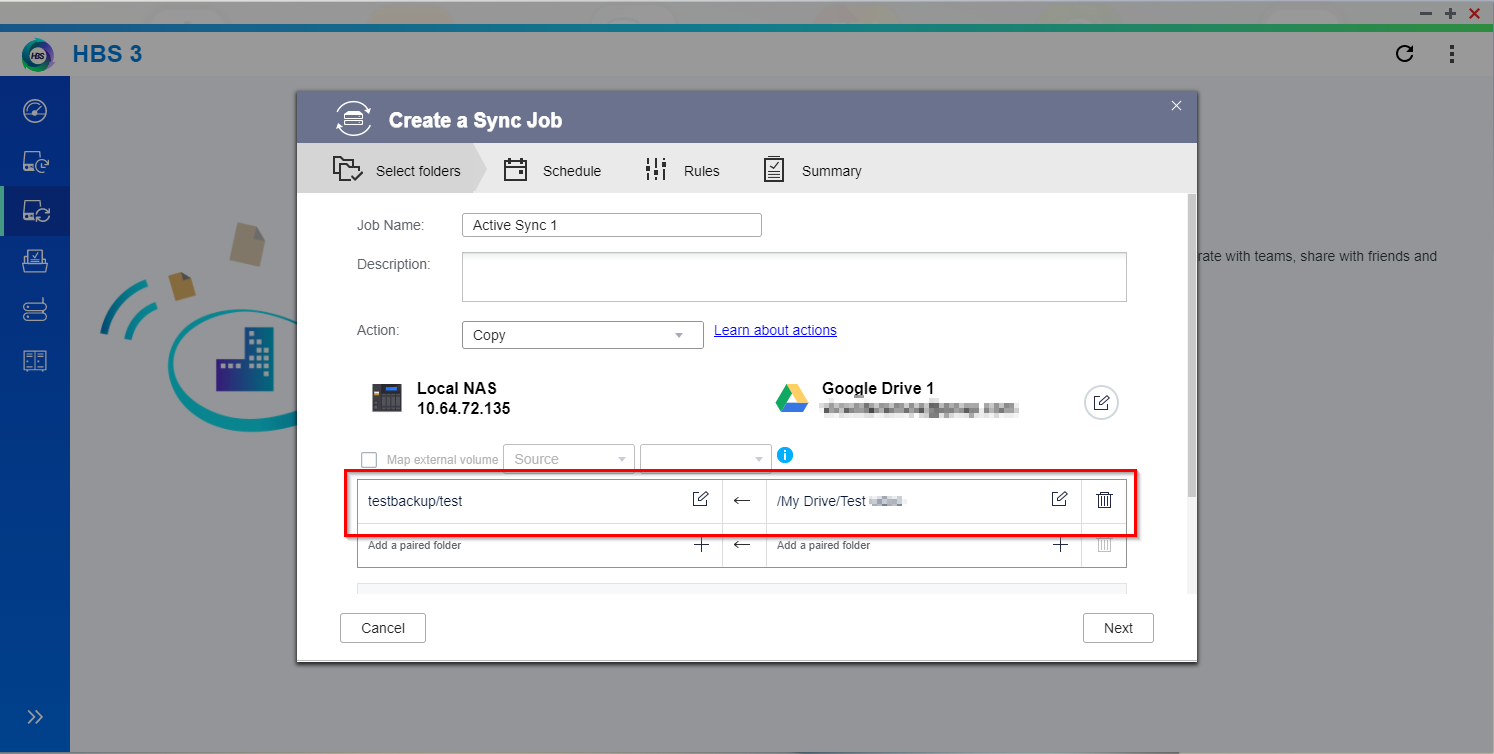

3. Select the source and destination of the sync

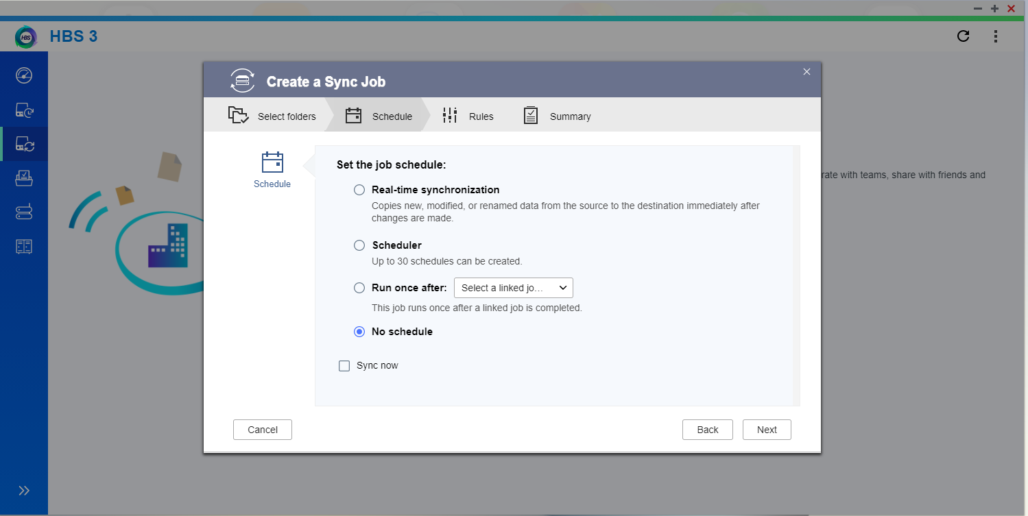

4. We do not need schedule because we try to recover the encrypted files

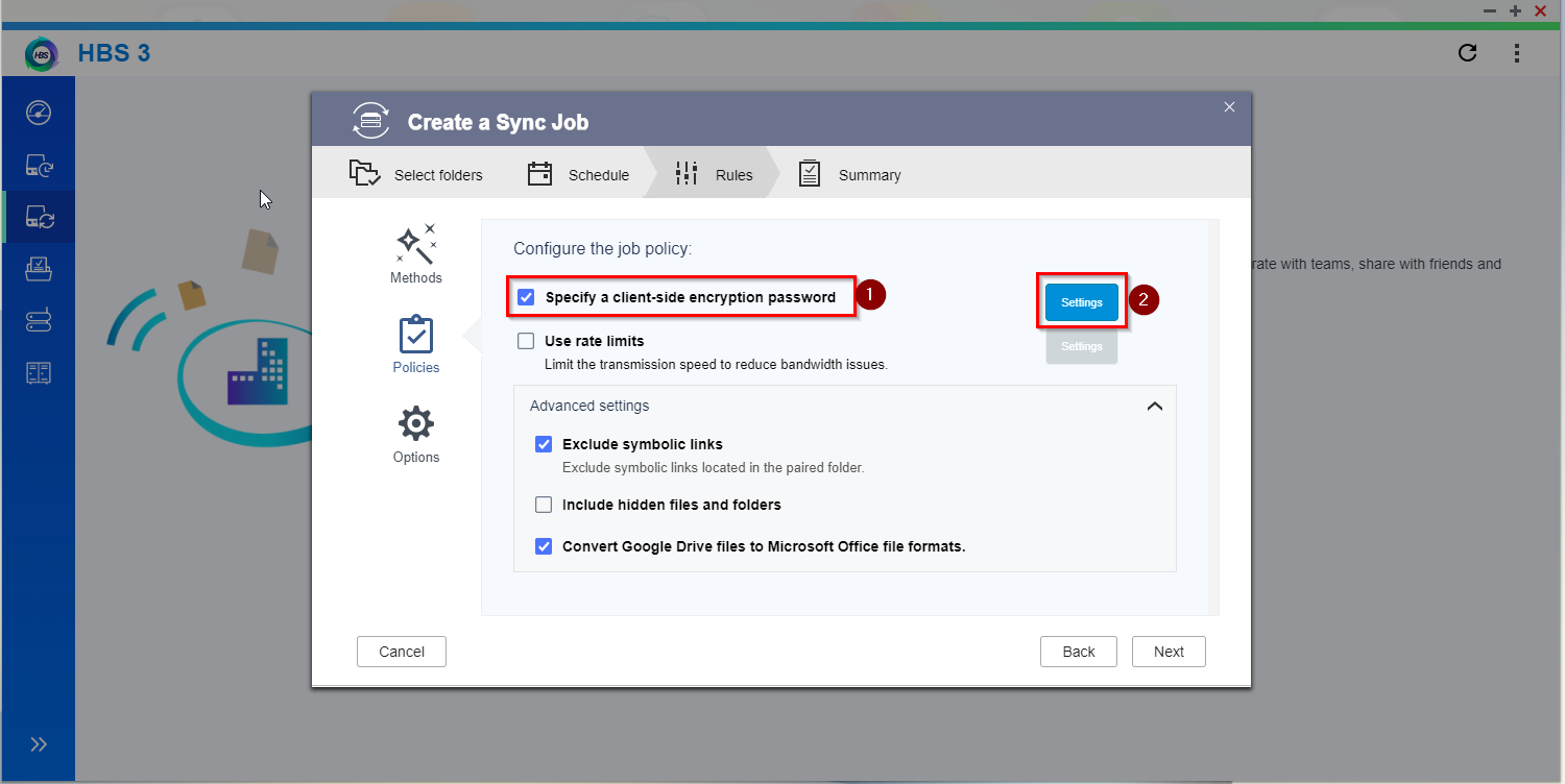

5. In “policies” we need to mark “Specify a client-side encryption password” and click in setting

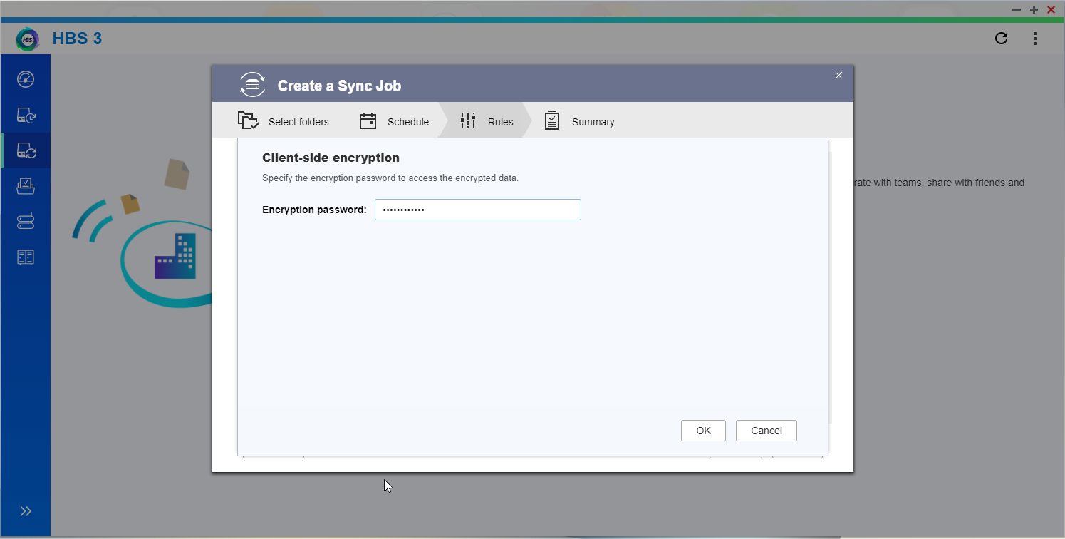

6. Type the password used to encrypt the files
7. Click on “Create”
