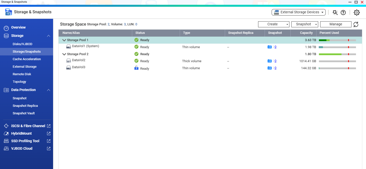

1. Check the RAID and data status
Open Storage & Snapshots and check the status of the storage pool, RAID group, other member disks, and data accessibility.
If two or more disks in the same RAID group are abnormal, the storage pool is inactive, or the data is inaccessible, stop further testing.

Take screenshots of Storage & Snapshots > Disks/VJBOD and the RAID/storage pool status.

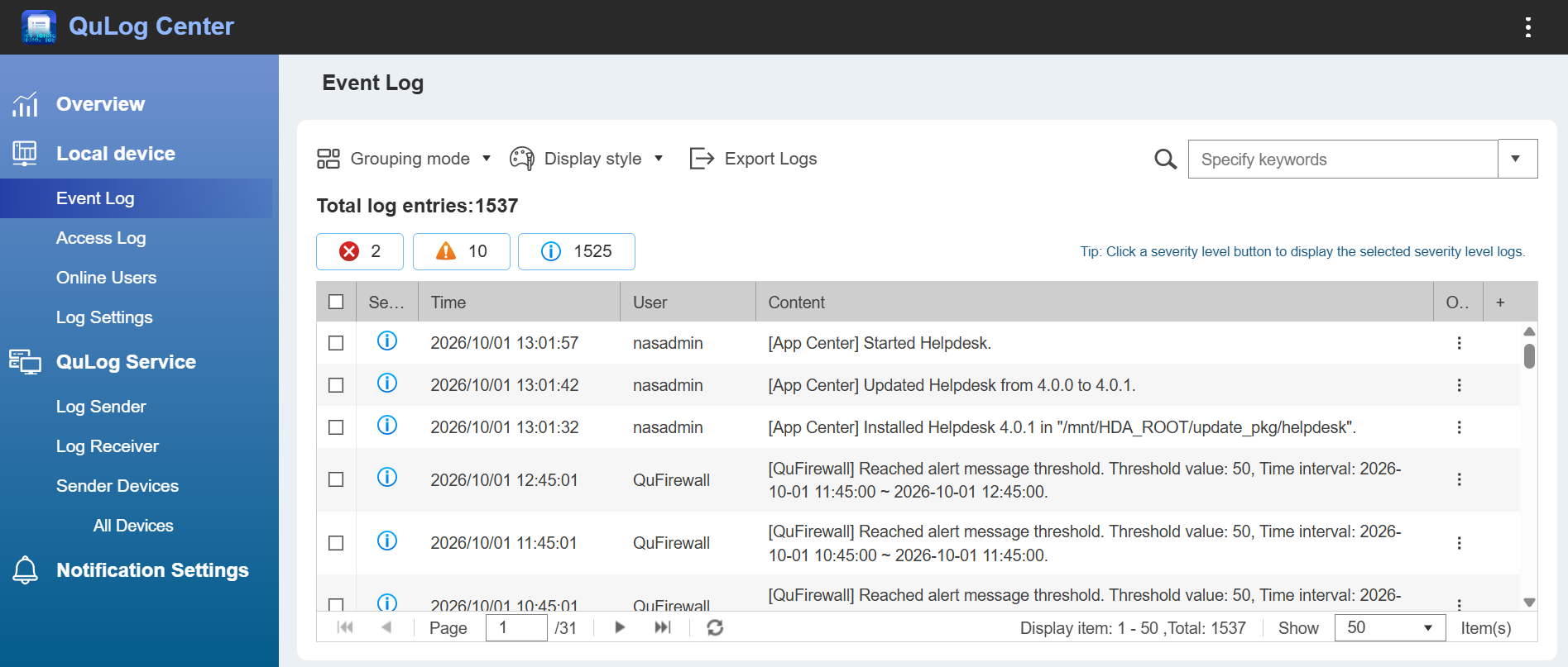

4. Check the event log and disk health

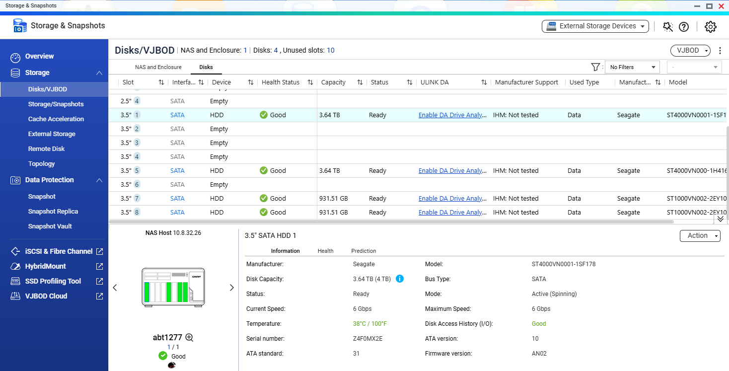

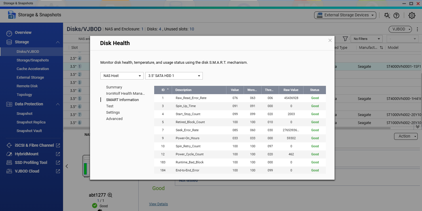

In QuLog Center > System Event Log, check for events around the time of the issue, such as Disk disconnected, Disk I/O error, RAID degraded, SMART warning, or Expansion enclosure disconnected.
In Storage & Snapshots > Disks/VJBOD, check the disk health, SMART information, temperature, and Reallocated/Pending/Uncorrectable Sector values.

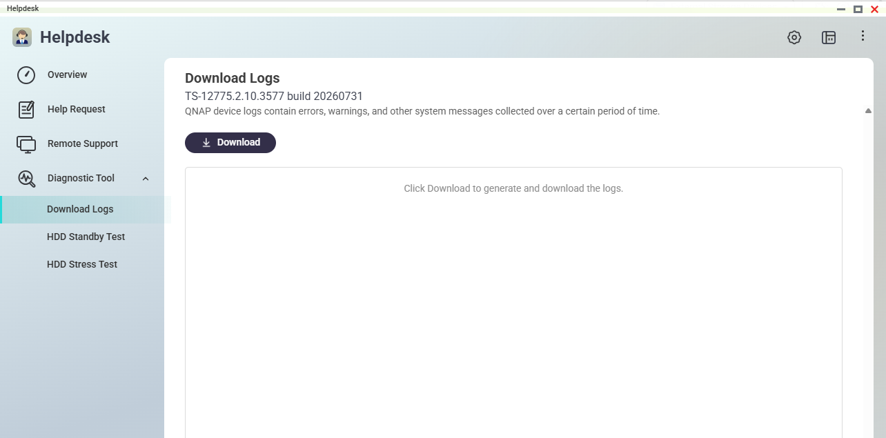

5. Collect diagnostic logs before further troubleshooting
If the NAS GUI is still accessible, go to:
Helpdesk > Diagnostic Tool > Download Logs
Download the diagnostic log ZIP file before considering a reboot. An accurate incident timestamp can help QNAP Support correlate the issue with kernel and storage-related messages.

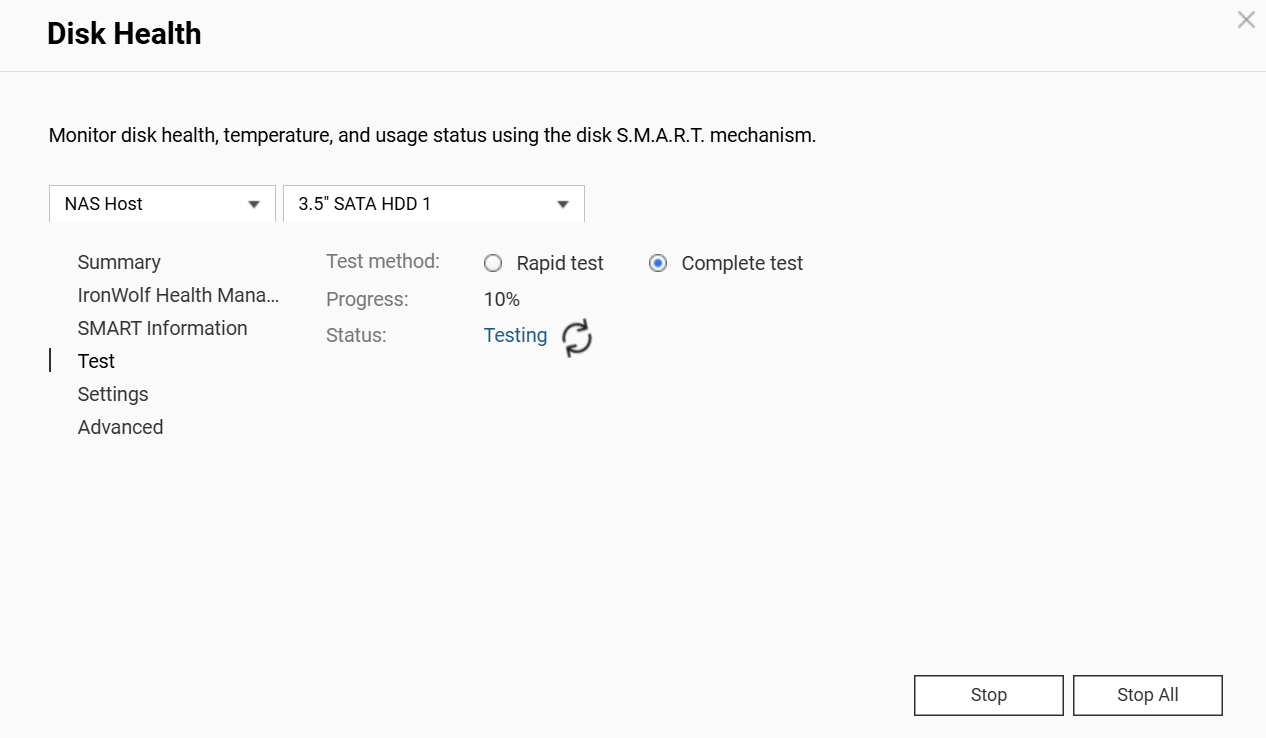

6. Run disk tests only when the RAID and data are safe
If the RAID is stable, no other member disk is abnormal, and important data has been backed up, consider running:
  • Complete SMART Test
  • Scan for bad blocks
    If the RAID is degraded or another member disk is abnormal, do not run long-duration disk tests.

  • Move the suspected disk to another known-good bay and check whether the problem follows the disk.
  • If necessary, connect the disk to a PC or use an appropriate SATA-to-USB adapter, and test it with the disk manufacturer's diagnostic tool.
If the problem follows the disk → Investigate the disk first.
If different disks have the same problem in the same bay → Investigate the disk tray, bay, backplane, or I/O path.
