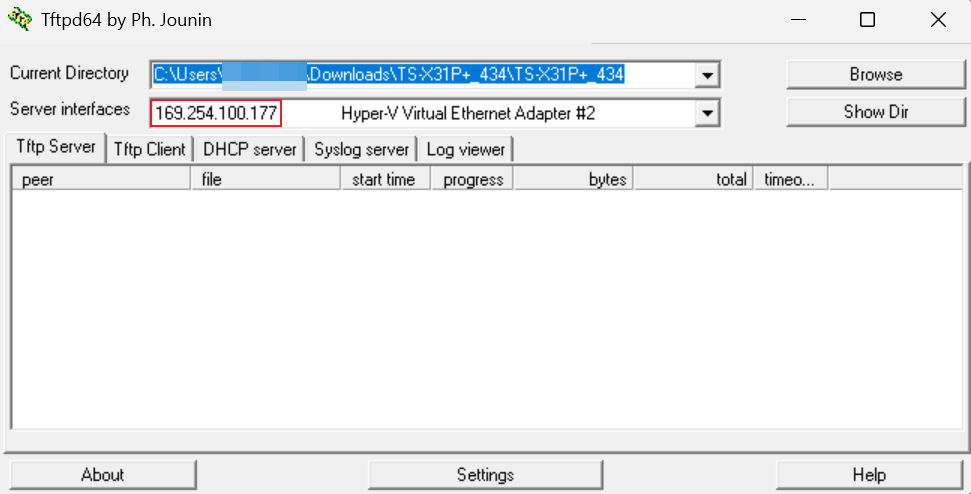

  4. Open Tftpd64.
  5. For Current Directory, specify the directory of the NAS firmware file.
  6. For Server interfaces, specify the network port configured with the static IP address.

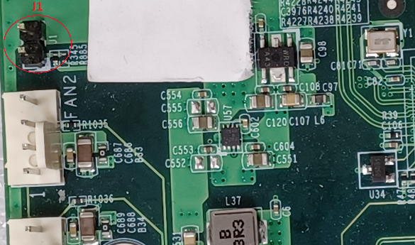

    2. If your NAS model is TS-431XeU, then connect a jumper to the pin J1 shown below:

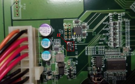

    3. If your NAS model is TS-431XU, TS-831XU, TS-1231XU, TS-832XU, or TS-1232XU, then connect a jumper to the pin J2 shown below:

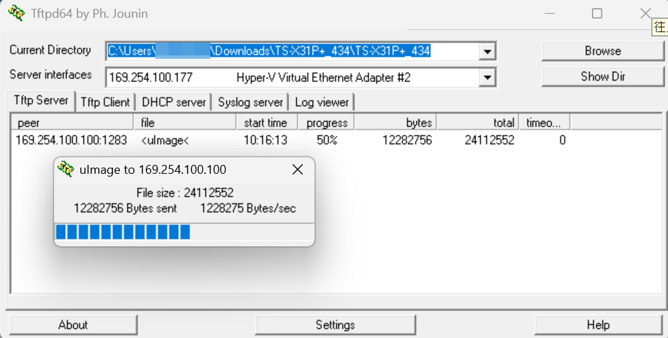

  6. After the NAS is powered on, the NAS will download the firmware file automatically from your Windows PC via Tftpd64. You can view the download progress in Tftpd64:
    After the firmware file is downloaded and installed onto the NAS, the NAS will automatically shut down.

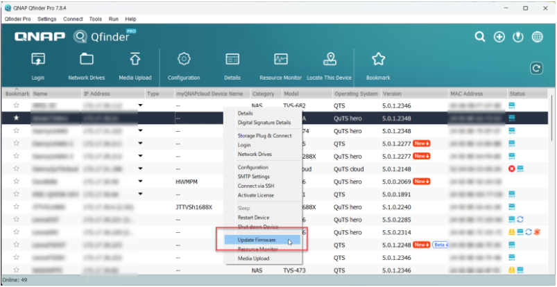

  2. Open Qfinder Pro.
  3. Locate your NAS in the device list.
    Tip
    For details on using Qfinder Pro, see Qfinder Pro Help.
  4. Right click on your NAS.

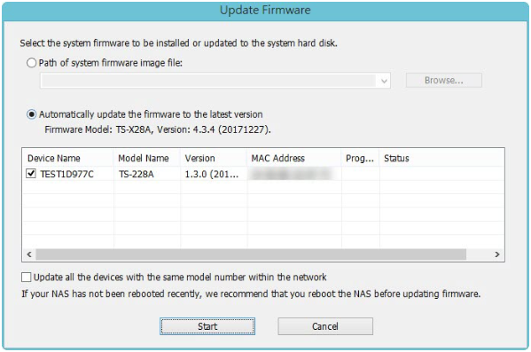

  5. Select Update Firmware.
    The Update Firmware window opens.
  6. If your NAS model is one of the following models, please click on it to download the firmware corresponding to your model. You will need to update to this QTS firmware v4.3.6 first and then update to the latest version. Otherwies, skip this step.
  7. Select Automatically update the firmware to the latest version.
  8. Click Start.
