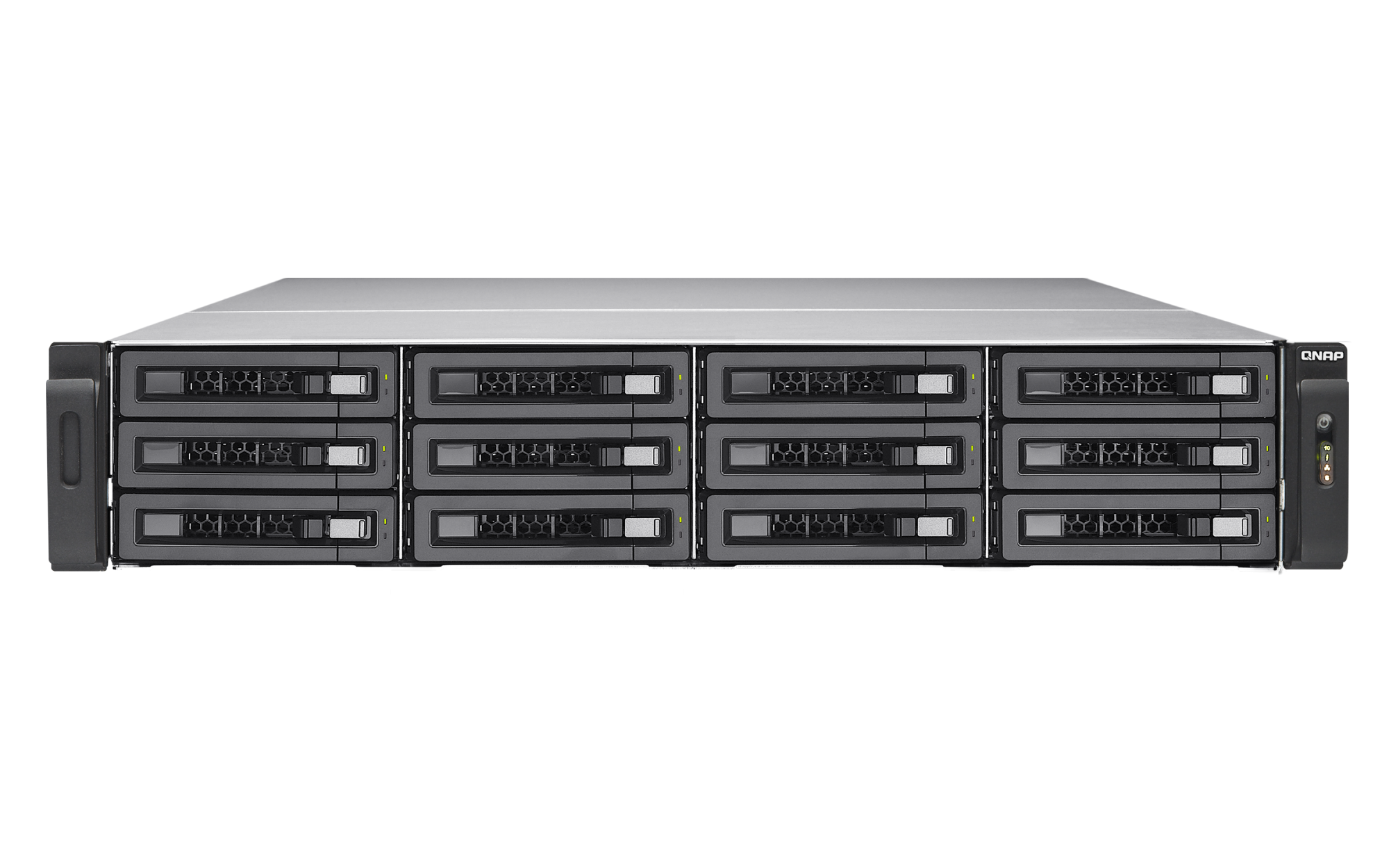

Hard Drive 12 x 3.5-inch SATA 6Gbps/3Gbps hard drive or 2.5-inch SATA, 6Gbps/3Gbps hard drive SSD hard drive
NOTE:
  1. The standard system is shipped without hard drives.
  2. For the hard drive compatibility list, please visit Compatibility list
Hard Drive Tray 12 x hot-swappable and lockable tray

Buttons System: Power button and reset button
Alarm Buzzer System warning
Form Factor 2U, Rackmount

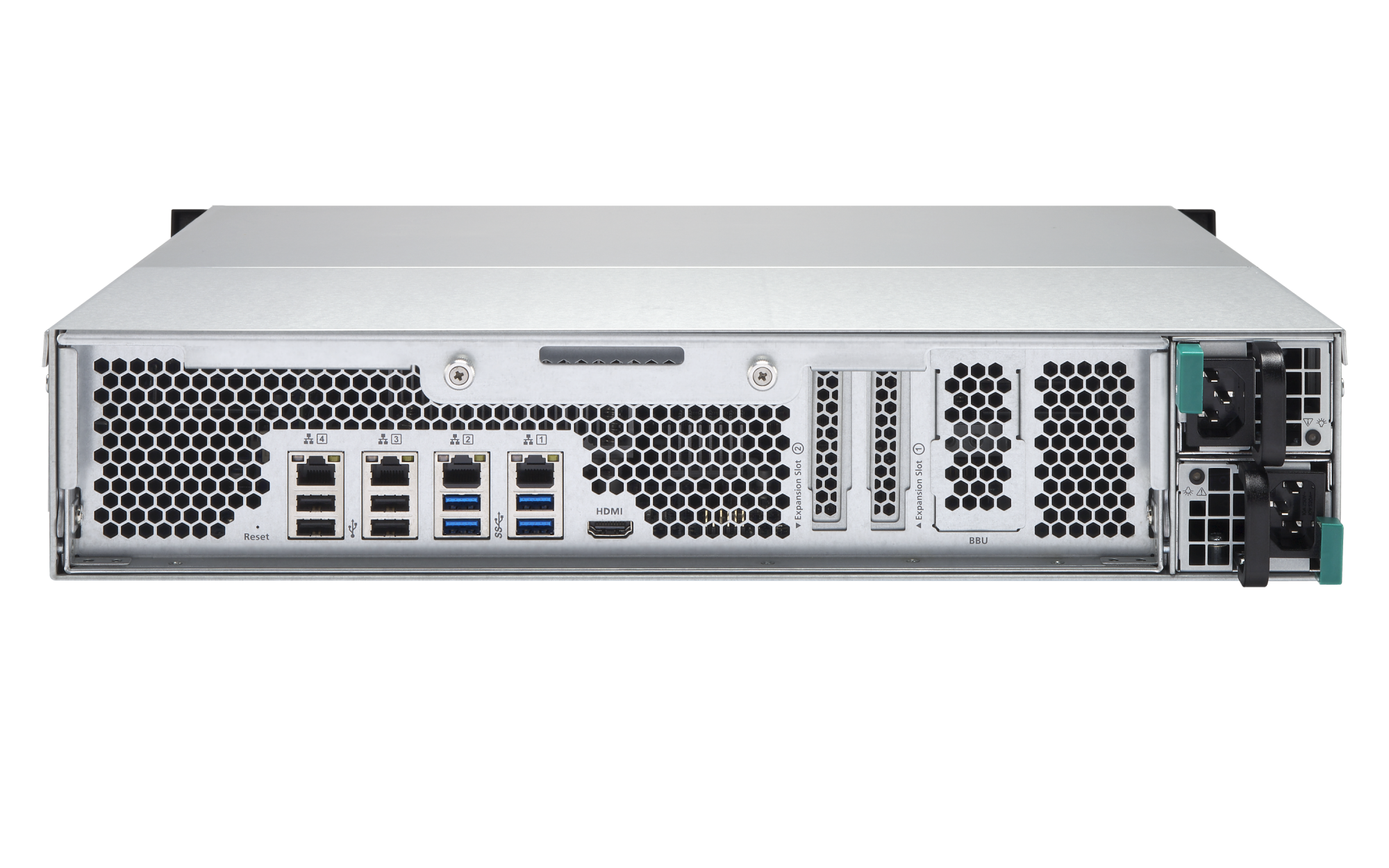

1. Power Button 5. Gigabit LAN x 4
2. LED Indicators:
10 GbE, Status, LAN, Storage Expansion Port Status
6. USB 3.2 Gen 1 Port x 4
3. Password & Network Settings Reset Button 7. Left slot: PCIe Gen.3 x 8
Right slot: PCIe Gen.3 x 4 (This PCIe slot is an open-edge design. It can be used with a Gen.3 x 8 card.)
4. USB 2.0 Port x 4 8. Power Connector
