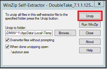

- Execute the Double-Take installation and click “Unzip”.

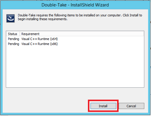

- After the file has been unzipped, click “Install Double-Take Availability”. Select a language for the installation and then click “OK”.
- Click “Install”

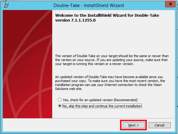

- Choose “No, skip this step and continue the current installation” and click “Next”.

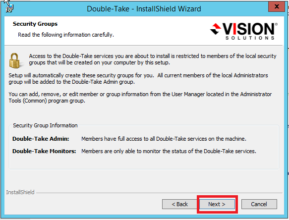

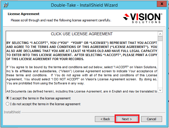

- Read and accept the license agreement and click “Next”.
- Click “Next’.

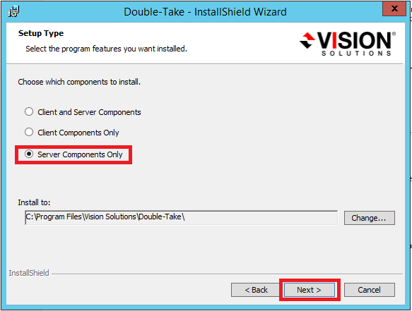

- Choose “Server Components Only” and click “Next”.

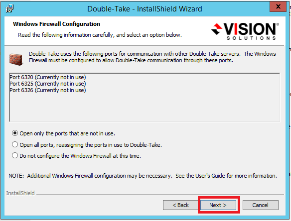

- Double-Take will use port 6320, 6325 and 6326 to communicate with the source, target and the client side. Choose “Open only the ports that are not in use.” and click “Next”.

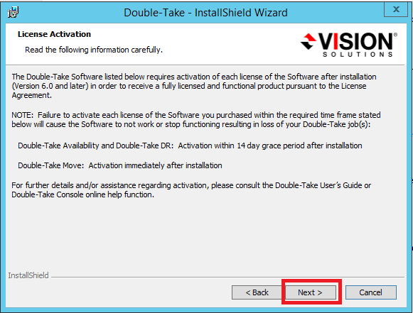

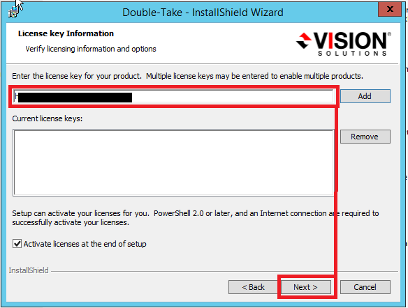

- Enter the license key and click “Next”.

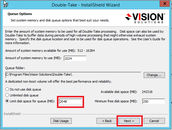

- Choose “Limit disk space for queue (MB)” and specify 2048 MB capacity. Click “Next”.

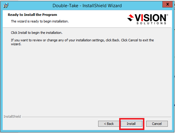

- Click “Install”.

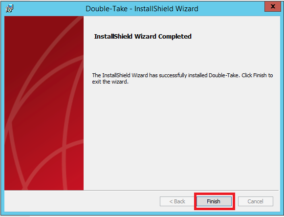

- Click “Finish”.

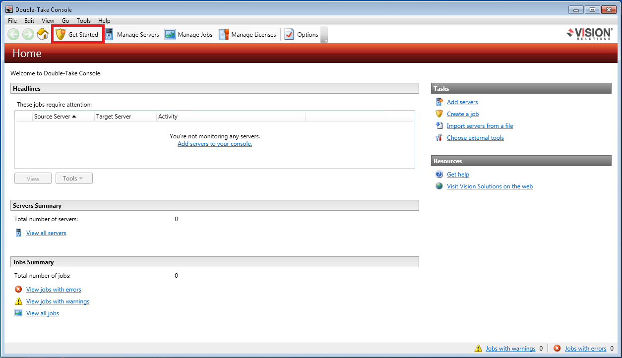

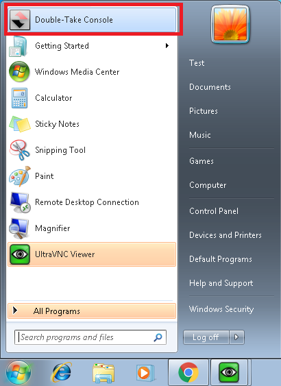

- Start the Double-Take® Console.

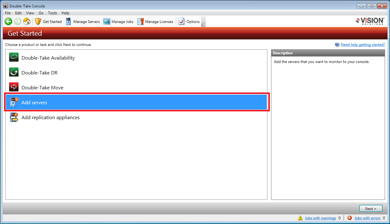

- Click “Get Started” in the Double-Take® Console.

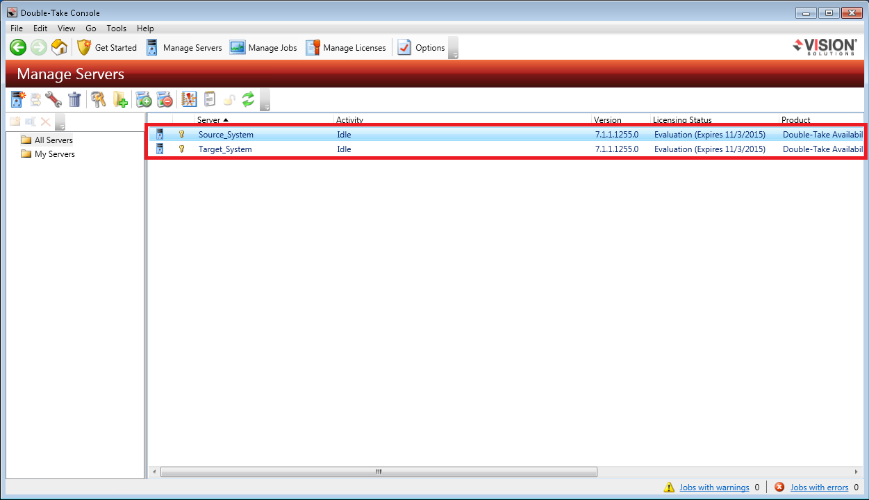

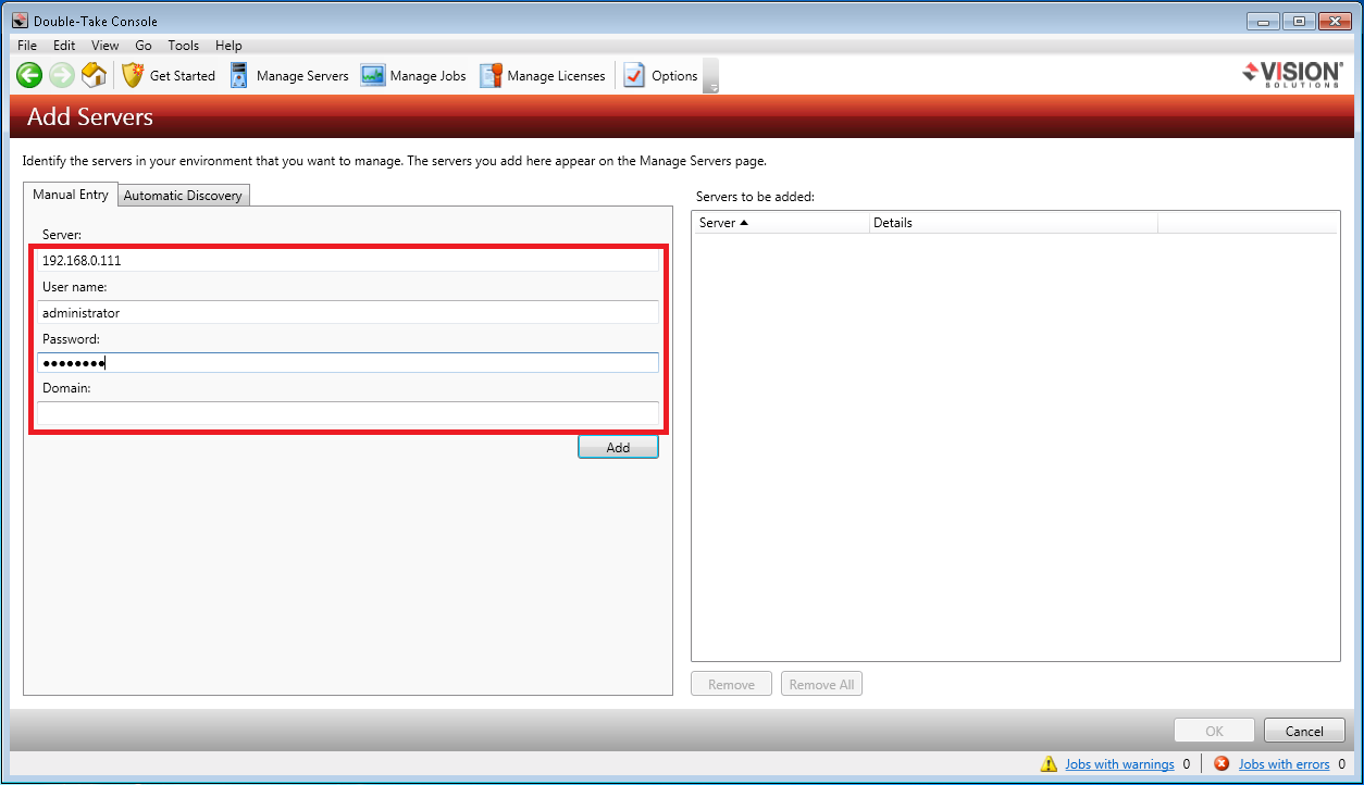

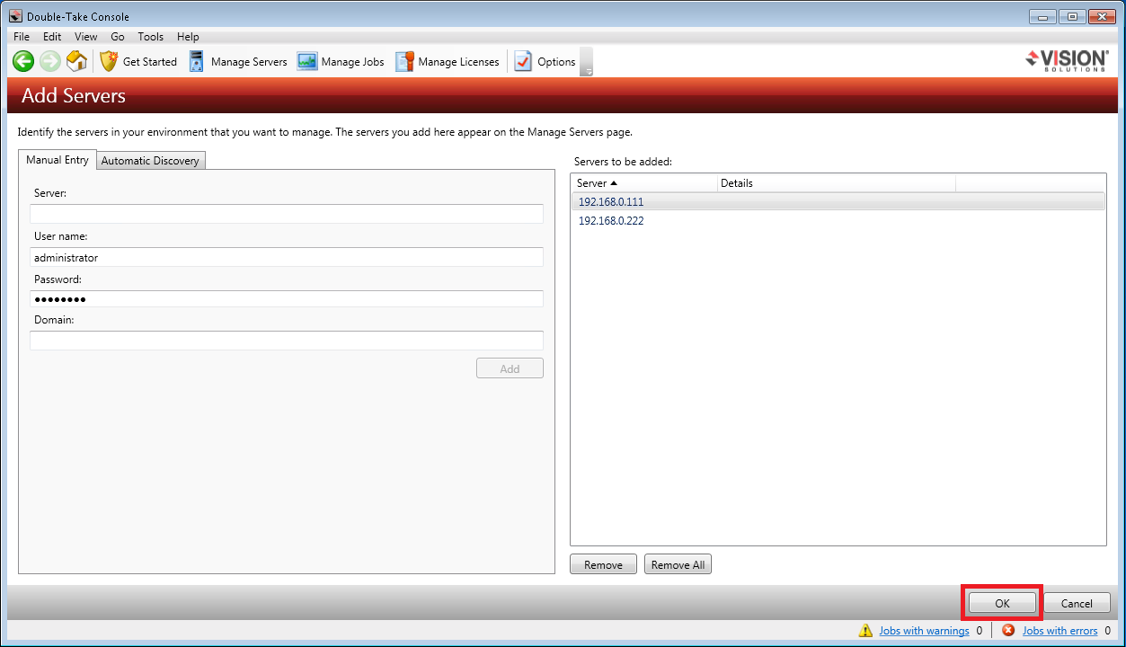

- Click “Add servers”.
- In this tutorial, the source system uses IP 192.168.0.111, and the target system uses IP 192.168.0.222. Enter the “User name” and “Password”.
- After adding the source and target, click “OK” to add the servers.
- The source system and target system will be added.

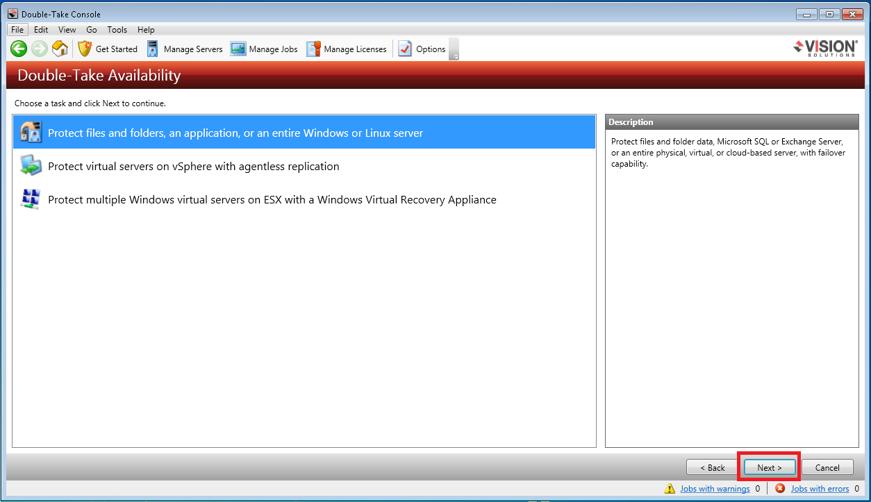

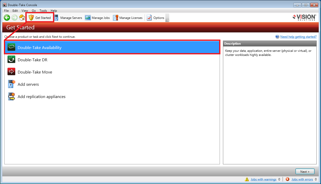

- To create a failover job for disaster recovery, click “Get Started” and choose “Double-Take Availability”. Click “Next”.
- Choose “Protect files and folders, an application, or an entire Windows or Linux server” and click “Next”.

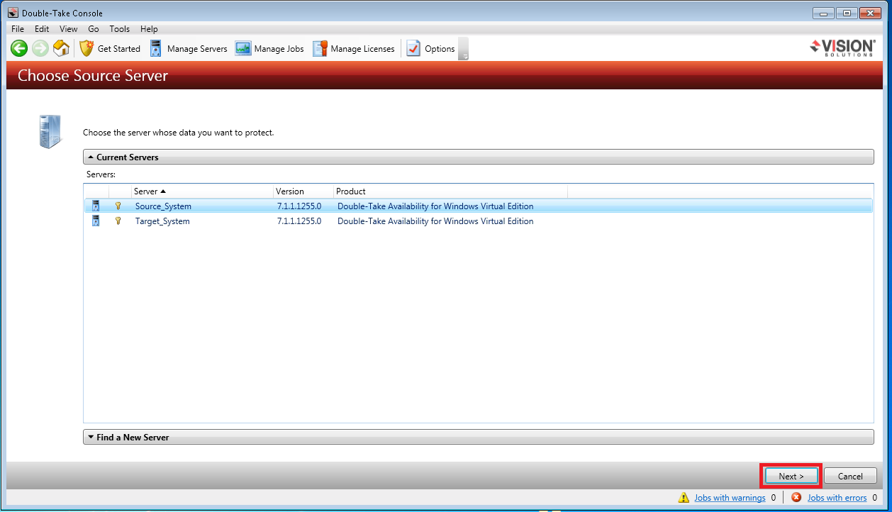

- Choose “Source_System” as a source server and click “Next”.

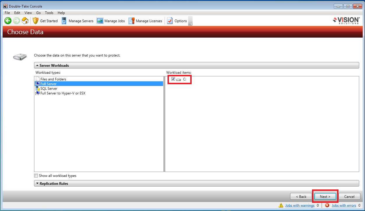

- Choose “Full Server” and the system drive will be selected as default. Click “Next”.

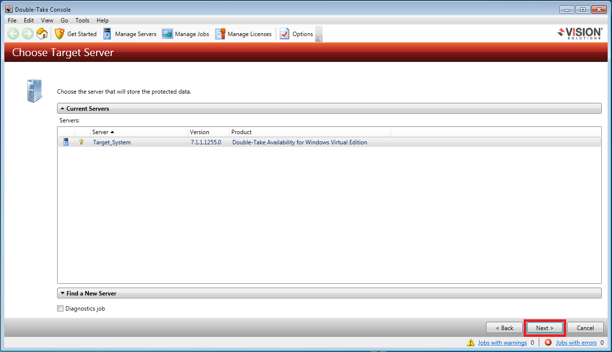

- Choose “Target_System” as target server and click “Next”.

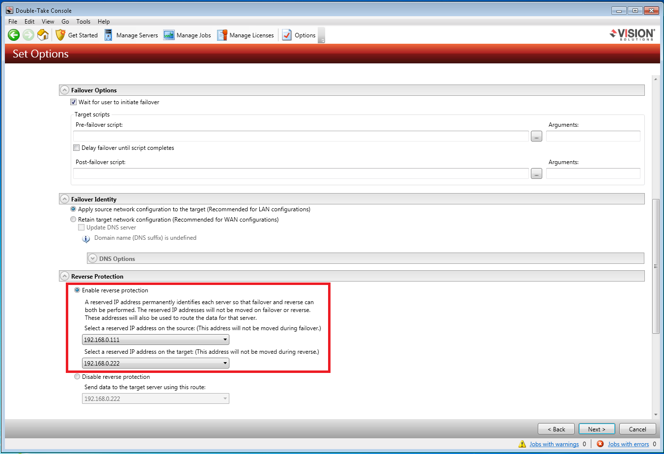

To manually initiate failover, check “Wait for user to initiate failover”. On the other hand, the failover will be triggered automatically with uncheck. - Failover Identity
To apply the source network settings, check “Apply source network configuration to the target (Recommended for LAN configurations)”. For instance, the source system IP 172.17.22.187 will be kept and used by the target server after failover. - Reverse Protection
If you want to reverse the target system to the original server, check “Enable reverse protection”. To enable reverse protection, you need to choose an existing IP address to identify the source and target system. For instance, IP 192.168.0.111 is used for the source system, and IP 192.168.0.222 is for the target system.

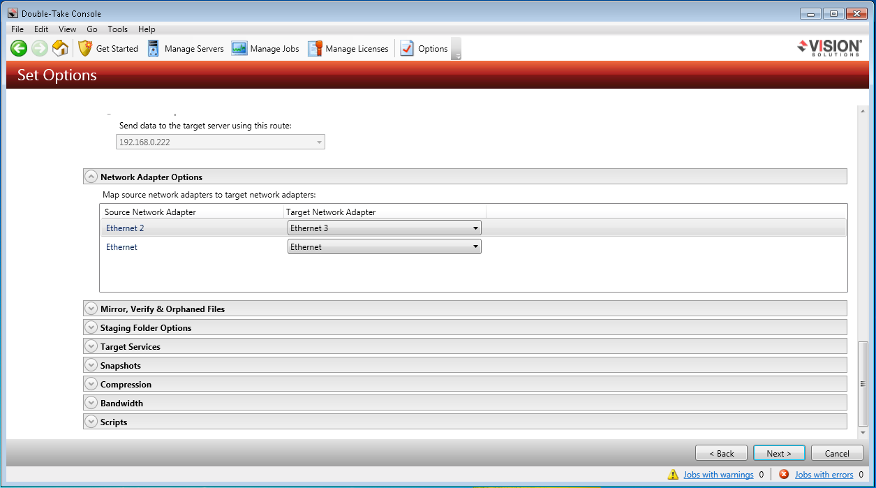

- Network Adapter Options
Please ensure the corresponding network settings between the source and target system. For example, the network adapter of the source system [172.17.22.187] should be associated with the target’s adapter [172.17.22.173].

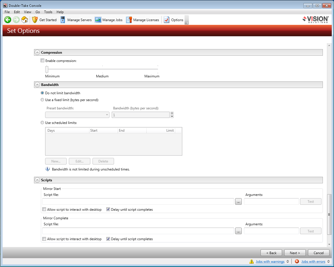

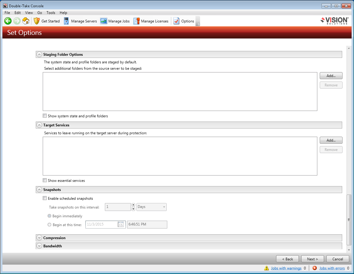

- (Optional) Mirror, Verify & Orphaned Files/ Staging Folder Options/ Target Services/ Snapshots/ Compression/ Bandwidth/ Scripts
These options are good enough for a failover job. For these listed options, you can configure them for certain usages. Afterwards, click “Next”.

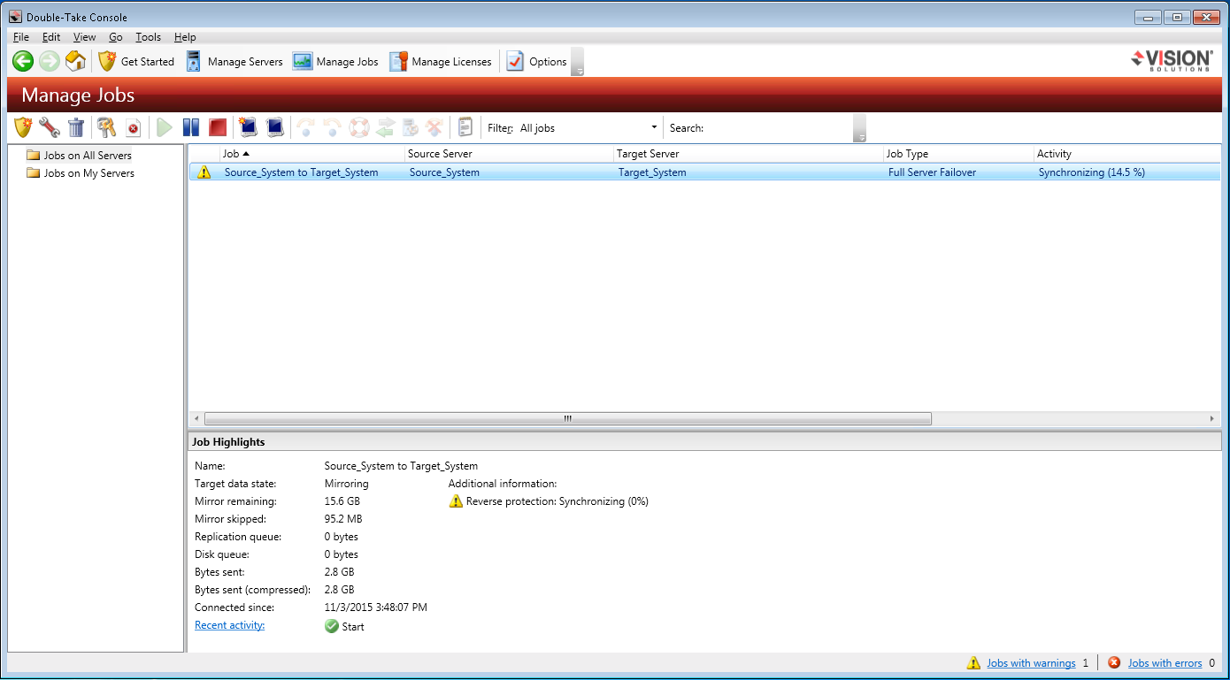

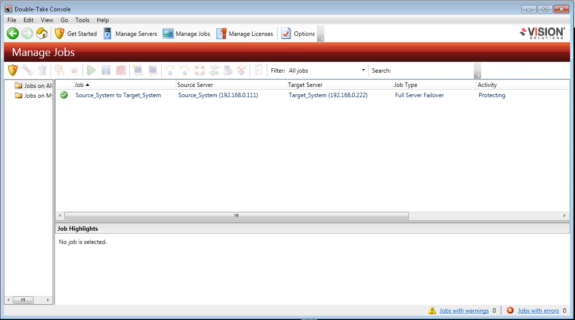

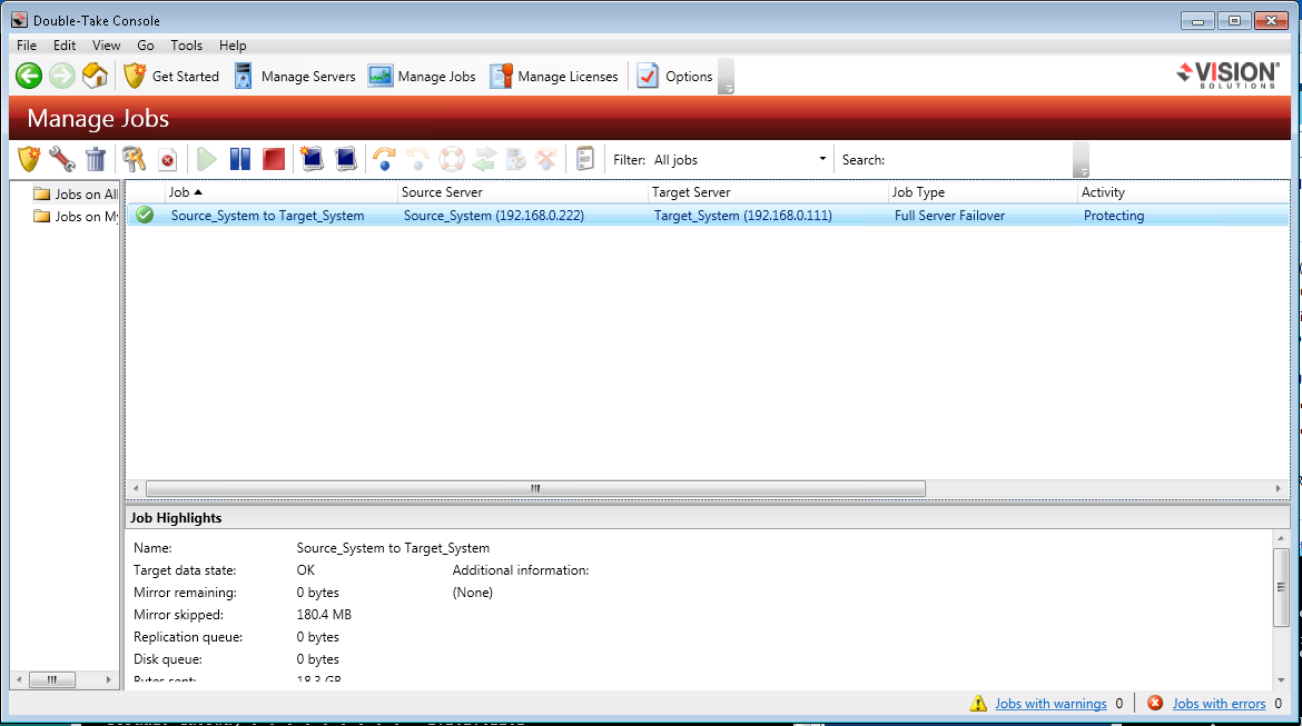

- After creating a failover job, all of the files and applications on the source system will be mirrored on the target system.
- When the data synchronization has been finished, all of the changes on the source system will be automatically replicated to the target system and the target system will be standby for failover.

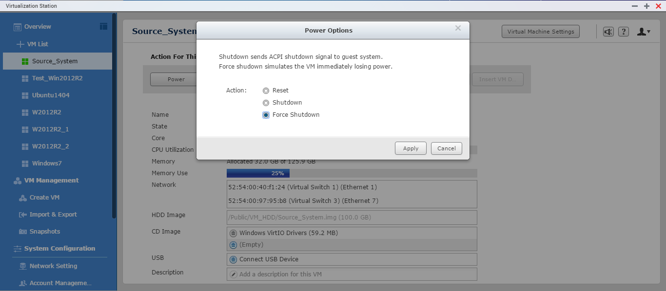

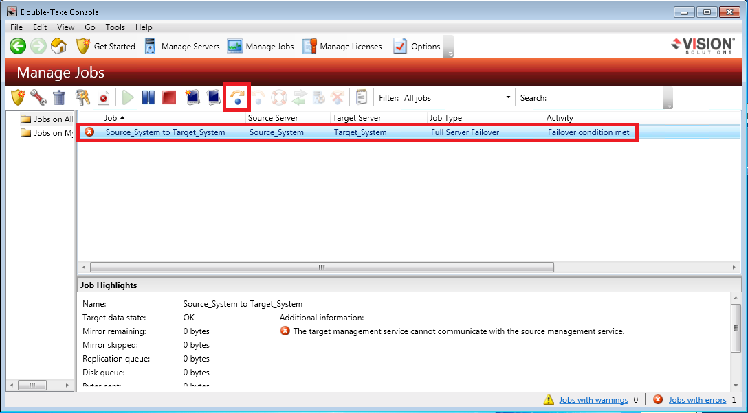

- In the VM1 information page, click “Power”, choose “Force Shutdown” and click “Apply”. The source system will be immediately shut down.
- Go to the Double-Take® Console. The failover condition will be met and the “Failover” button turns into enabled.
(Please note: if you choose “Wait for user to initiate failover” in the Failover Options, this icon will be enabled until you click it. If not, the failover will be automatically triggered.)
- Click “Failover”.

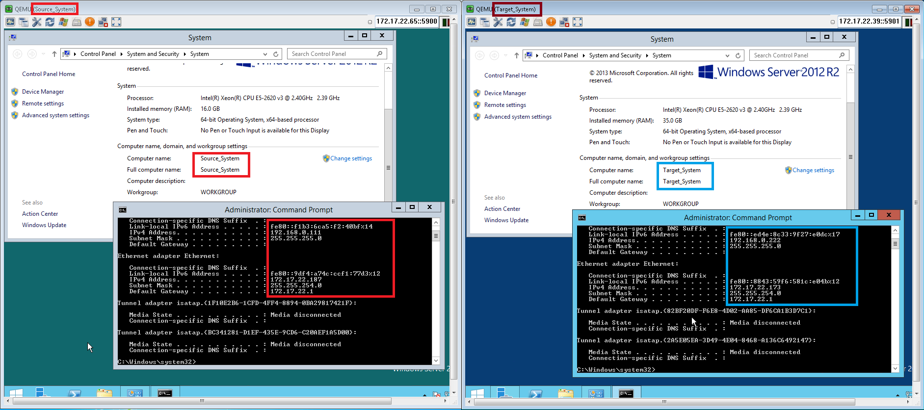

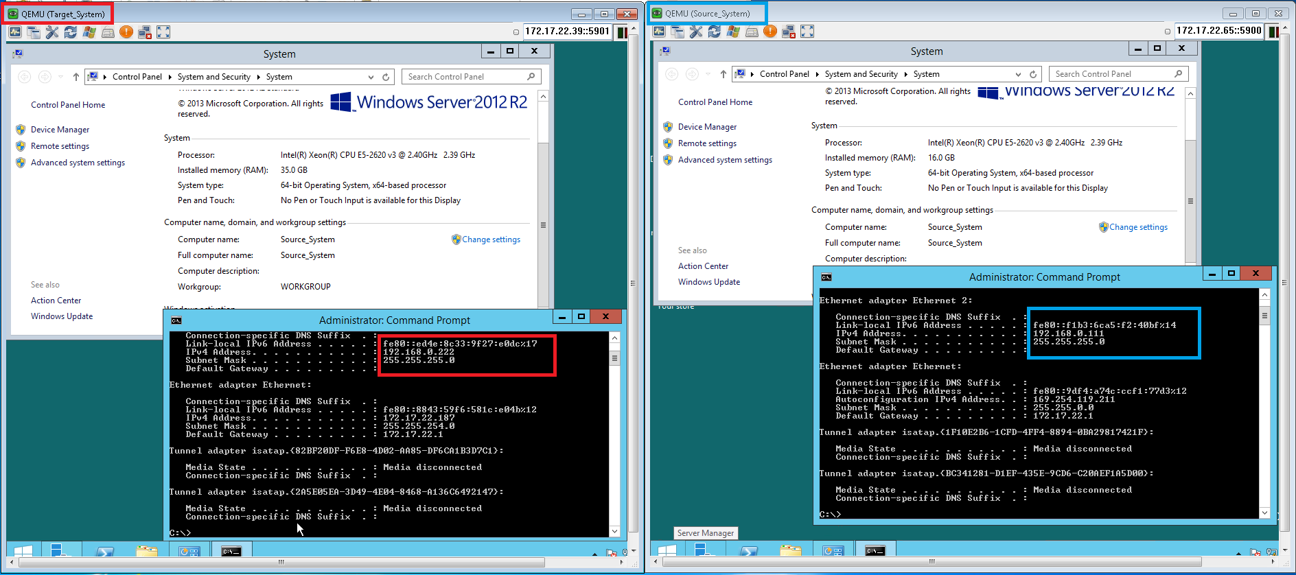

- After processing the failover, the target system will be restarted and will take over all of the application services that the source system has.

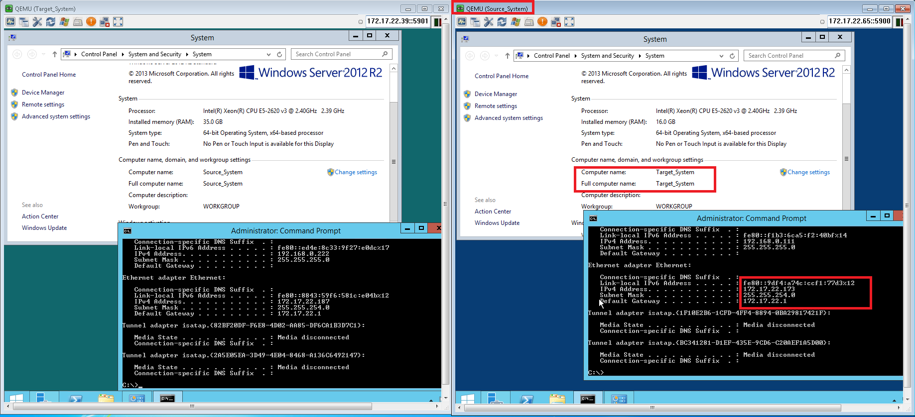

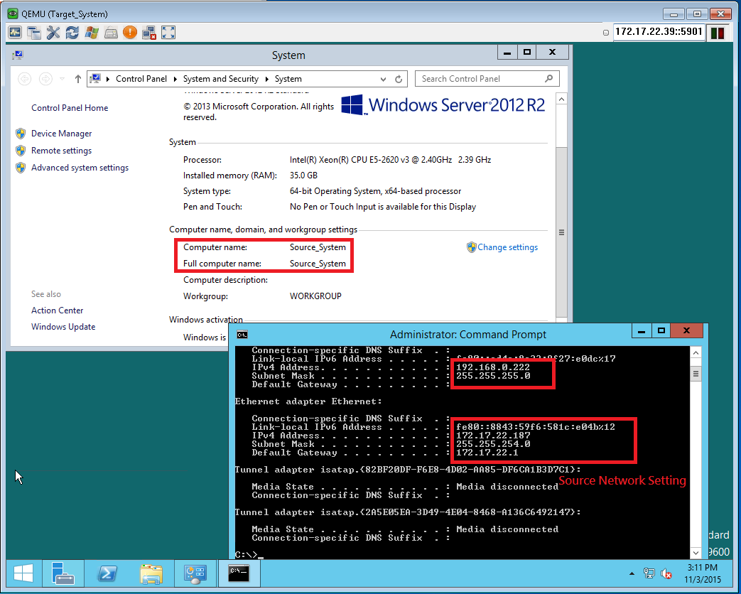

In VM2 (formerly the target system), the computer name will change to “Source_System” and the IP address will apply the original source system 172.17.22.187. However, IP 192.168.0.222 is still kept in VM2. This IP address is used to identify the original system if reverse protection is activated.

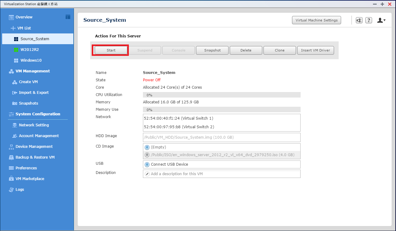

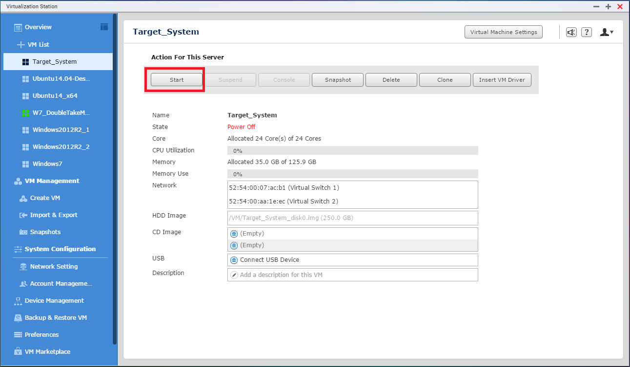

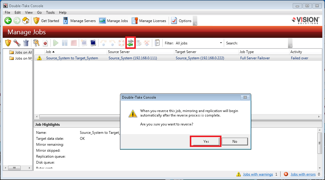

- If the source system (VM1) returns, you can use reverse protection to restore the original target system to VM1. Go to the VM1 information page and click “Start” to invoke VM1.

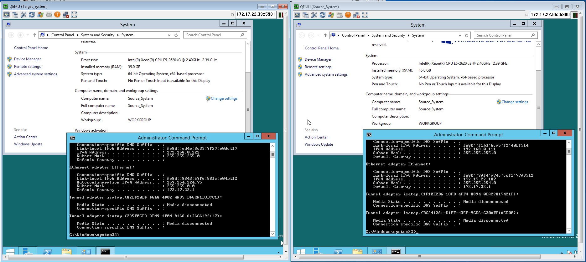

After starting VM1, both VM1 and VM2 will run the same source system.

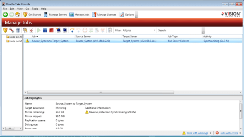

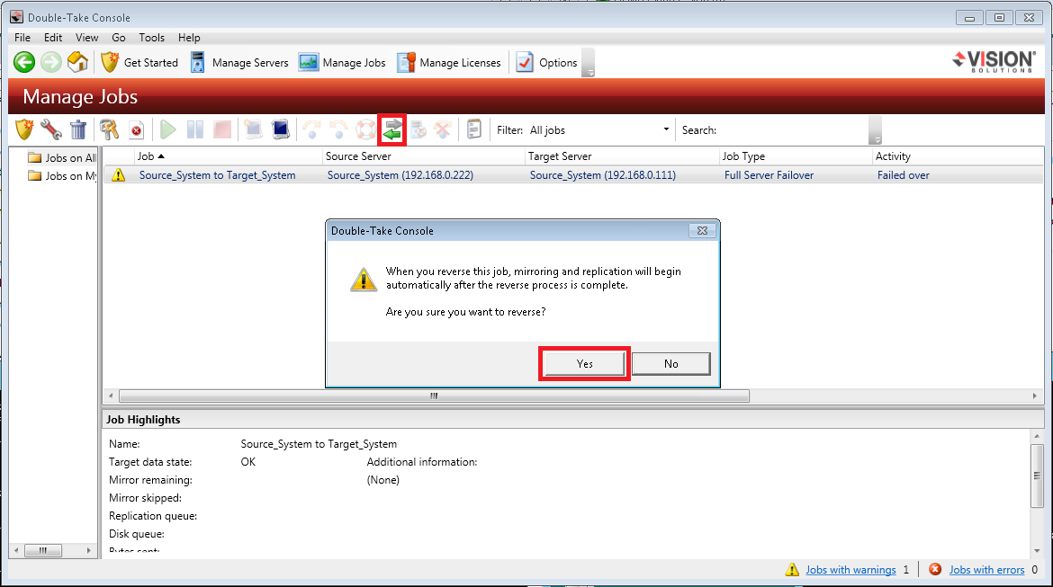

- Click “Reverse” and “Yes”.

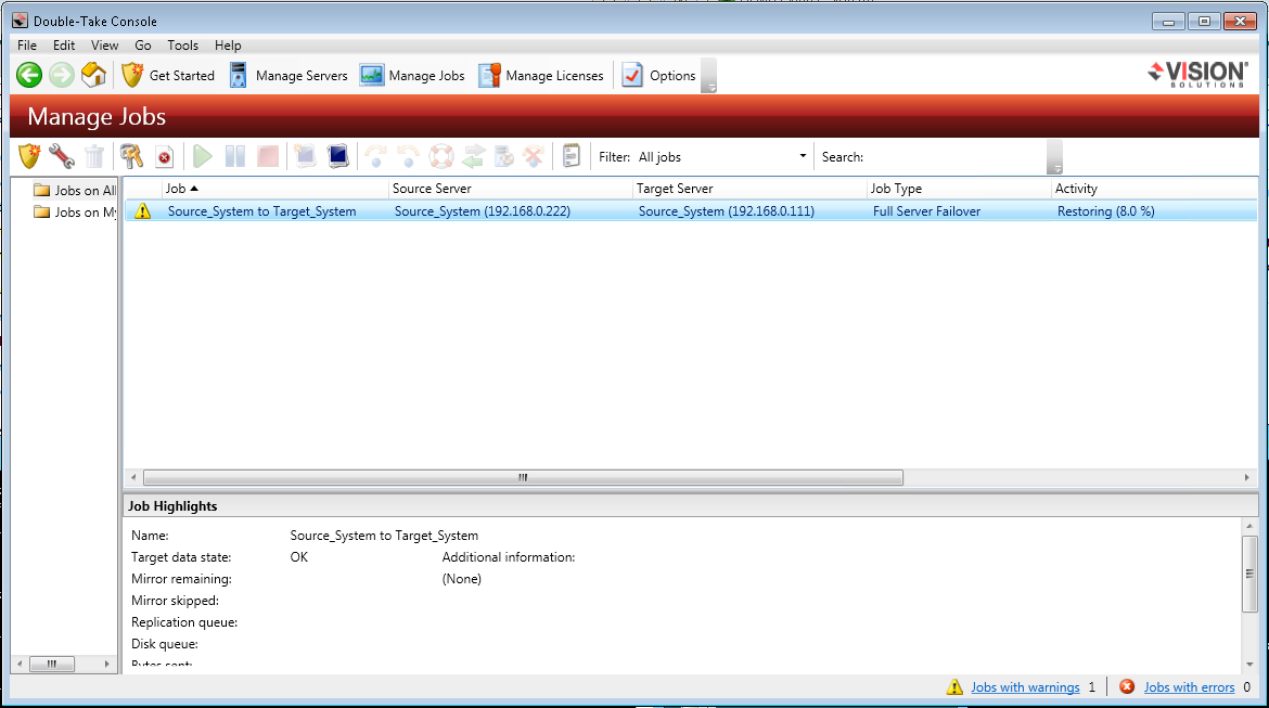

- After clicking reverse, Double-Take® will restore the original target system to VM1.
VM1 will run with the target system and use the original network setting (172.17.22.173).
- Afterwards, Double-Take® will carry out synchronization again.
After the data is synchronized, the failover job will be changed from VM2 to VM1 (VM2 is running the source system, while VM1 is the target system and acts as the backup server.)

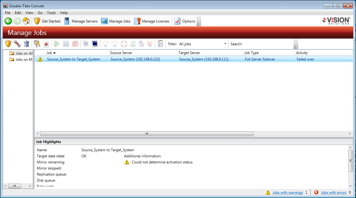

5. If you want to make the source system run on the original server (VM1) and the target system run on VM2.
It will need to failover and reverse again.
- Click “Failover” and “Failover”.
- When the failover finishes, VM2 will be shutdown and VM1 will be restarted. All the data will be replicated and the application services will be taken over from VM2 to VM1.
VM2 will power-off and the failover job will display a warning.
- Go to the VM2 information page and click “Start”.
Both VM1 and VM2 are running the same source system.

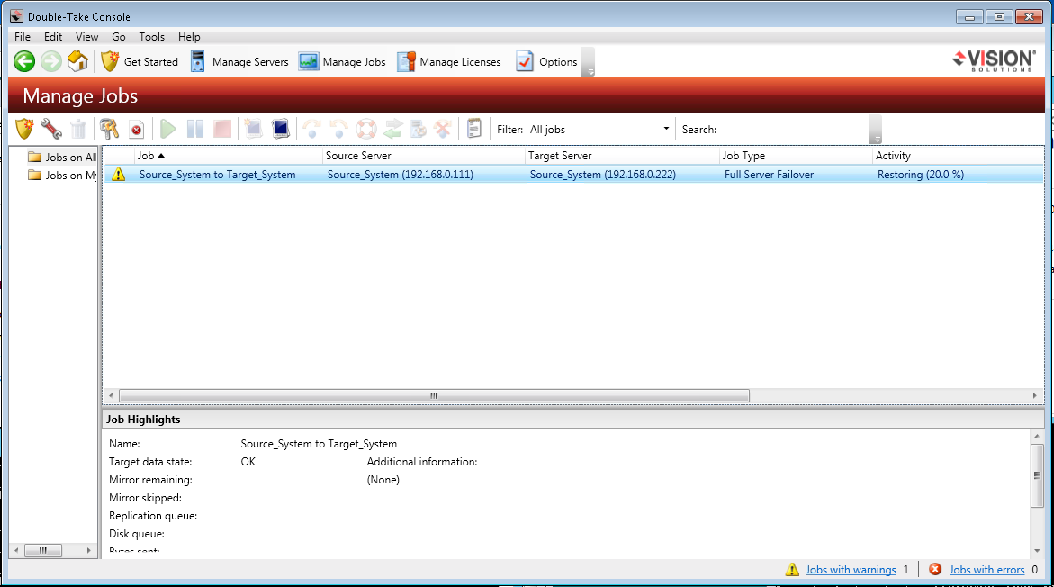

- Go back to the Double-Take® console. Click “Reverse” and “Yes”.
- After clicking the reverse button, Double-Take® will restore the original target system to VM2.
- VM1 is running the original source system, and VM2 has been reverted to the target system as the backup server.
- Afterwards, Double-Take® will synchronize again.
