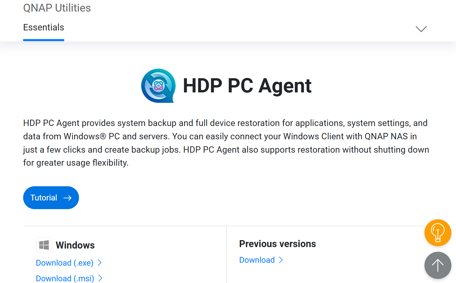

  3. NetBak PC Agent is installed on your Windows PC/server.

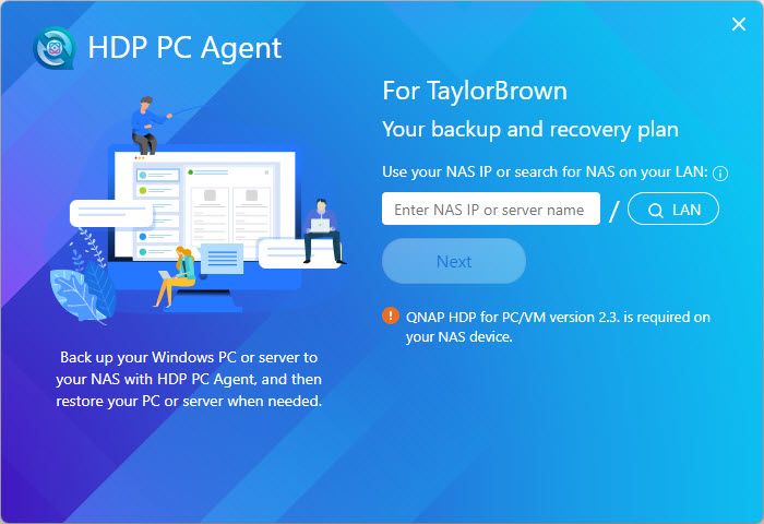

  2. Log into your QNAP NAS.
    1. Enter your NAS IP address or NAS server name. Alternatively, if your NAS is connected to your computer's local network, then you can find your NAS by clicking the search LAN button.
    2. Enter your NAS username and password.

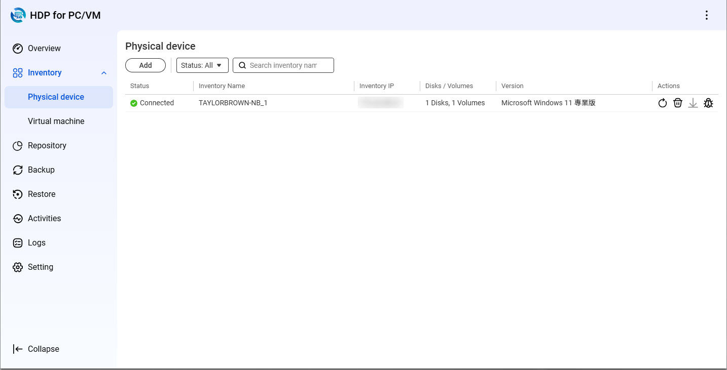

      After logging in to the NAS, Netback PC Agent automatically creates an HDP inventory for this PC/server:

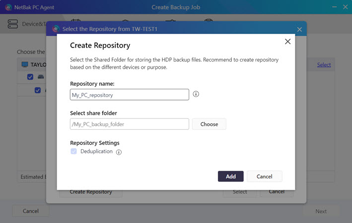

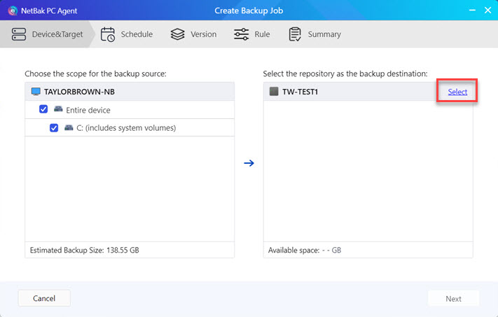

  3. Create a repository on your NAS. A repository is a location on your NAS where the backed-up data of your PC/server will be stored.
    1. Enter a name for the repository.
    2. Select a shared folder for the repository.

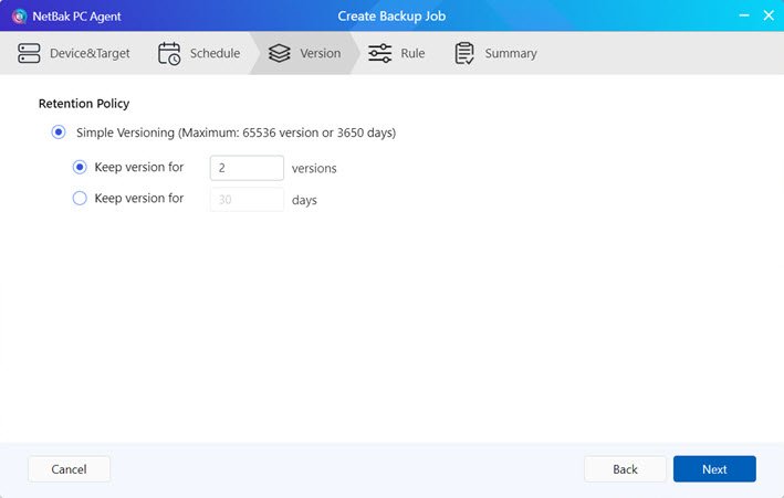

  5. Specify how many backup versions will be kept in the repository. When restoring your PC/server, you will select one of the backup versions to use for the restore.

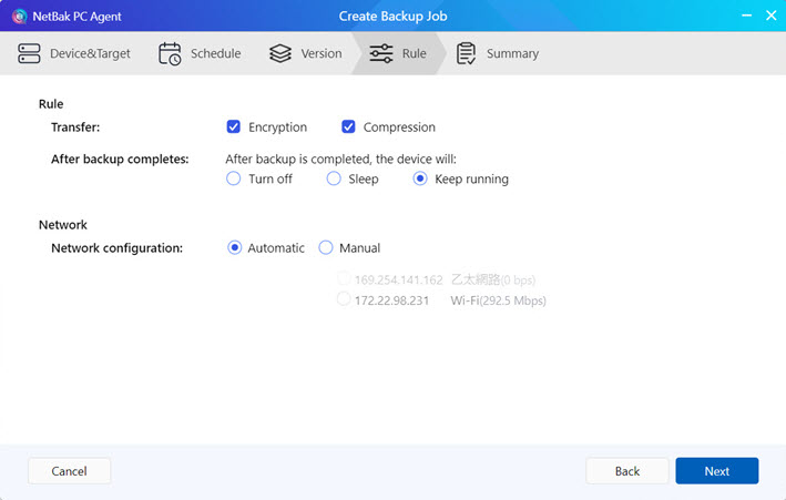

  6. Specify further miscellaneous options to apply.

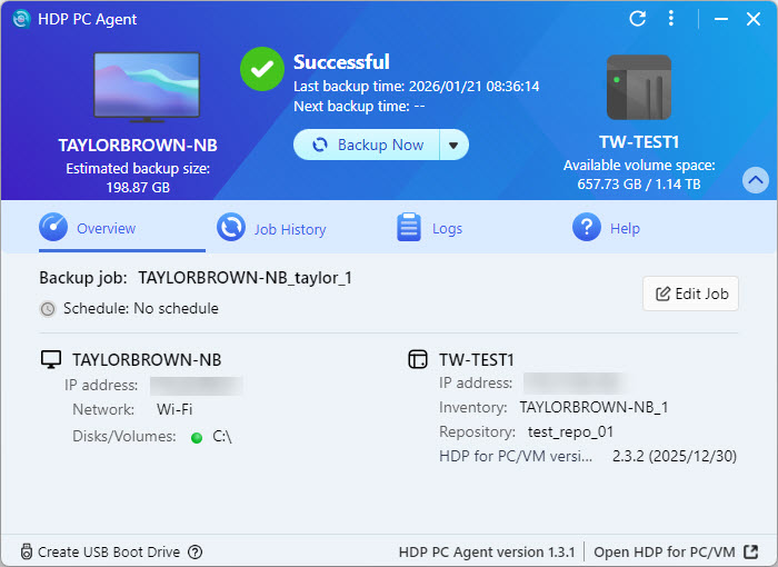

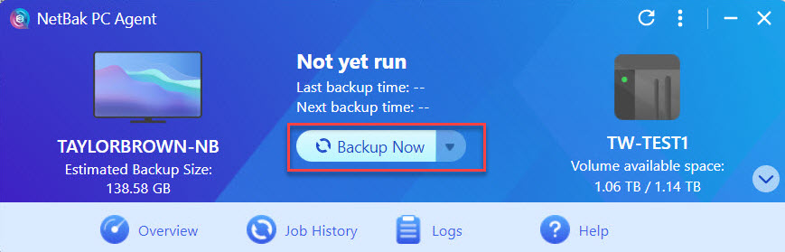

  9. After the backup job is created, perform an immediate backup.
    Warning
    Do not power off, sleep, or log out of your device while the backup job is running.
  10. After the backup job is finished, a backup version is created.
  11. To use this backup version for a future restore of the device, you will first need to create a USB boot drive with NetBak PC Agent. See the next section for details.
