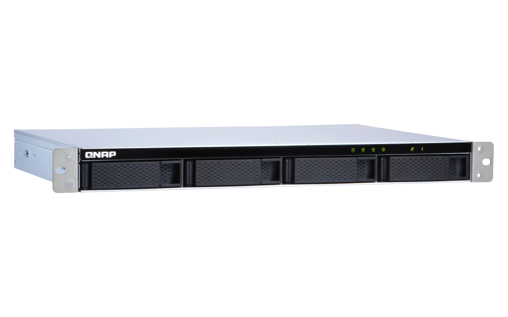

TL-R400S Specification
  1. TL-R400S
    JBOD Connection Interface SATA
    Drive Bay 4 x 3.5-inch
    The system is shipped without HDD.
    For the HDD compatibility list, please visit https://www.qnap.com/compatibility/
    3.5-inch SATA 6Gb/s, 3Gb/s hard disk drives
    2.5-inch SATA 6Gb/s, 3Gb/s solid state drives
    You can only use one disk type (HDD or SSD) in a RAID group. Combining different types of disk in one RAID group is not supported.
    Hot-swappable
    Form Factor 1U Short Depth Rackmount
    Host Interface 1 x SFF-8088
    LED Indicators HDD 1-4, Status, Link, Fan error
    Buttons Power switch
    Dimensions (HxWxD) 43,9 × 438,9 × 291,1 mm
    Excludes ear hook and the protruding part of the Power Supply Unit.
    Weight (Net) 4.92 kg
    Weight (Gross) 5.77 kg
    Power Supply Unit 100W PSU, 100 - 240V
    Power Consumption: Operating Mode, Typical 25.07 W
    Tested fully populated with Seagate ST6000NM0024 hard drives.
    Fan Mode Switch (Auto, high, medium, low)
    Fan 2 x 40mm, 12VDC
    System Warning Buzzer
    Kensington Security Slot

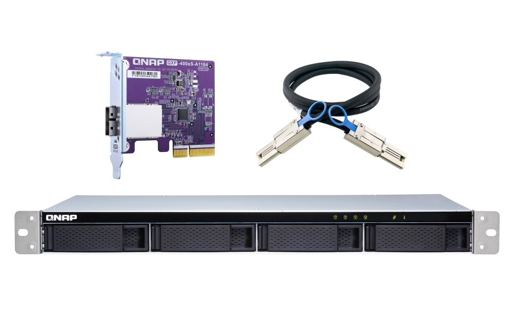

TL-R400S
TL-R400S
Power Cord x 1
Power Cord x 1
Mini SAS cable (SFF-8088 to SFF-8088) x 1
Flat head screw x 12 (for 2.5
Flat head screw x 12 (for 2.5" HDD)
Flat head screw x 16 (for 3.5
Flat head screw x 16 (for 3.5" HDD)
QXP SATA Expansion Card: QXP-400eS-A1164
Hanger x 2
Hanger x 2
Holder x 2
Holder x 2
