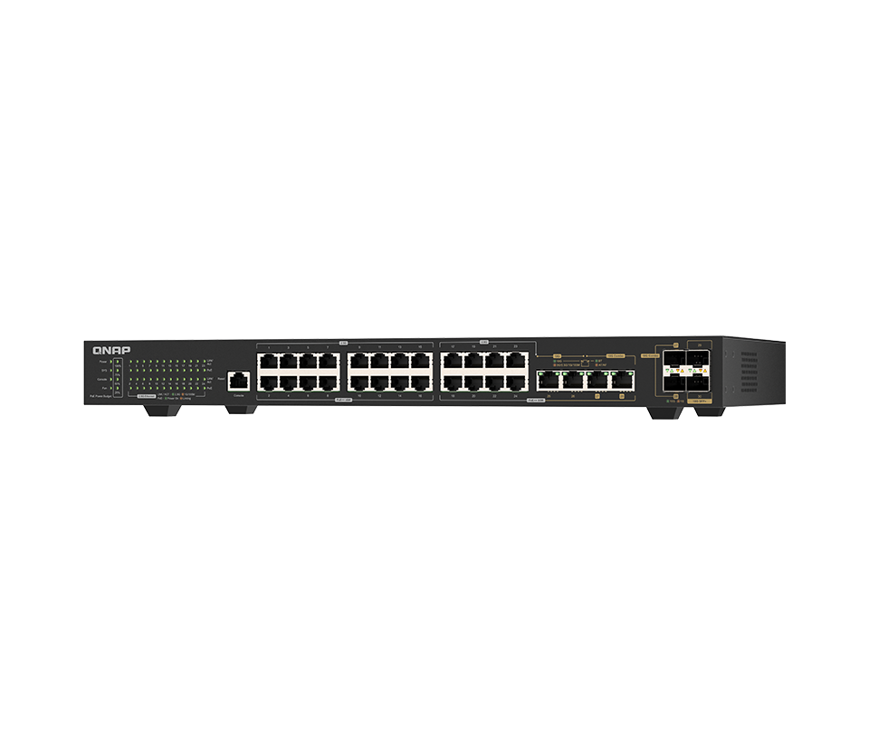

QSW-M2130P-2C2S26T Specification
  1. QSW-M2130P-2C2S26T
    Management Type L2 Web Managed
    Number of Ports 30
    10GbE SFP+ 2
    10GbE BASE-T (RJ45) 2
    10G/5G/2.5G/1G/100M
    10GbE SFP+/RJ45 Combo Ports 2
    Note: The 10GbE SFP+ ports are backward compatible with 1GbE SFP; the RJ45 (copper) combo port supports up to five speeds (10G/5G/2.5G/1G/100M).
    2.5GbE (RJ45) 24
    Total PoE Ports 28
    PoE++ PSE (802.3bt, 90W) Port 17-28 (90W)
    PoE Power Output Port 1-16 (45W)
    Port 17-28 (90W)
    Total PoE Power Budget 375W
    Power Supply Description Internal Power supply unit
    Max. Power Consumption 455W
    Input Power Type AC
    Input Voltage Range 100-240VAC, 50/60Hz
    MAC Address Table 32K
    Total Non-Blocking Throughput 120Gbps
    Switching Capacity 240Gbps
    Management Interface Web
    Console RJ45
    Energy Efficient Ethernet (IEEE 802.3az complaint)
    Fan PWM VAPO Bearing fan x 3
    Sound Level <28dB db(A)
    Supported Standards IEEE 802.3bz 2.5G/5GBase-T
    IEEE 802.3an 10GBASE-T
    IEEE 802.3ae 10G Fiber
    IEEE 802.3z 1000BASE-SX/LX
    IEEE 802.3bt Power over Ethernet
    IEEE 802.3x Full-Duplex Flow Control
    IEEE 802.1Q VLAN Tagging
    IEEE 802.1w RSTP
    IEEE 802.3ad LACP
    IEEE 802.1AB LLDP
    IEEE 802.1p Class of Service
    IEEE 802.3az EEE
    Form Factor Rackmount
    LED Indicators Per Port: Speed/Link/Activity
    Per System: Power/Loop
    Buttons Reset button
    Dimensions (HxWxD) 44 x 440 x 205 mm
    Weight (Net) 3.54 kg
    Weight (Gross) 4.398 kg
    Operating Temperature 0°C to 50°C (32°F to 104°F)
    Relative Humidity 5~95% Non-condensing
    Certifications CE, VCCI, BSMI, FCC, ICES, RCM, UKCA, LVD
    Electromagnetic Compliance CLASS A
    Jumbo Frames 12K
    Warranty 2 Years
