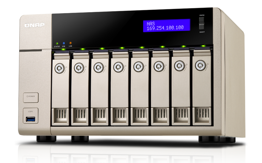

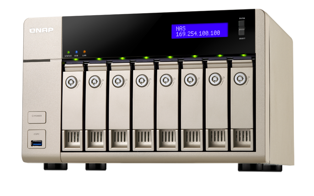

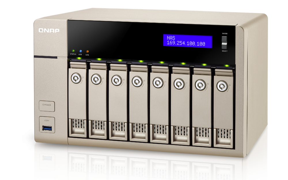

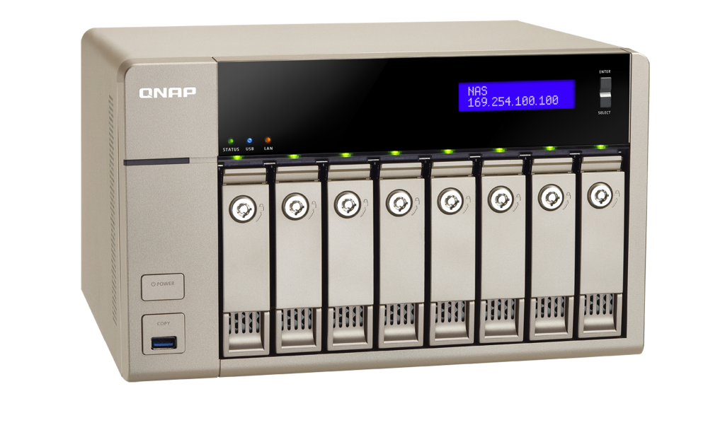

TVS-863 Specification
CPU AMD G-series GX-424CC quad-core 2.4 GHz processor with Radeon™ graphics
DRAM
TVS-863-4G: 4GB DDR3L-1600 x 1
TVS-863-8G: 8GB DDR3L-1600 x 1
Total memory slots: 2
Memory expandable up to: 16 GB (8GB x2)
NOTE: For the information of RAM module installation and compatible NAS models, please refer to the QNAP RAM Module Installation Guide.
Flash Memory 512MB DOM
Hard Disk Drive 8 x 3.5”or 2.5”SATA 6Gb/s, SATA 3Gb/s hard drive or SSD
NOTE:
1. The system is shipped without HDD.
2. For the HDD compatibility list, please visit https://www.qnap.com/compatibility/
Hard Drive Tray 8 x Hot-swappable tray
LAN Port 2 x Gigabit RJ-45 Ethernet port (Onboard:2, expandable to max 4 ports via PCI-E NIC)
PCIe Slot 1 (PCIe Gen2 x 4)
LCD Panel Mono-LCD display with backlight, Enter and Select buttons for configuration
LED Indicators Status, LAN, USB, HDD 1-8
USB 5 x USB 3.2 Gen 1 port (Front: 1, Rear: 4)
Support USB printer, pen drive, and USB UPS etc.
HDMI™ 2 (Mirrored Display), 1.4a
Note: 4K video playback and transcoding are not supported
Buttons Power/Status, USB One-Touch-Backup, reset
Alarm Buzzer System warning
IR Receiver QNAP RM-IR002 and MCE-compatible remotes
Form Factor Tower
Dimensions 185.2(H) x 298.2(W) x 235.4(D) mm
7.29(H) x 11.74(W) x 9.27(D) inch
Weight Net:7.83 kg (17.26lbs)
Gross: 8.9 kg (19.62lbs)
Power Consumption(W) S3 sleep: 2.35W
HDD standby: 46.21W
In operation: 70.45W
(with 8 x 2TB HDDs installed)
Sound Level* Sound pressure (LpAm): 21.3 dB(A)
Temperature 0-40˚C
Humidity 5~95% RH non-condensing, wet bulb: 27˚C
Power Supply ATX 250W, 110-240V AC, 50-60Hz, 5A
Secure Design Kensington security slot for theft prevention
Fan 2 x quiet cooling fan (12cm, 12V DC)
