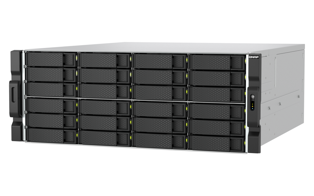

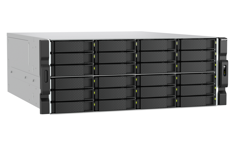

TS-h2477AXU-RP Specification
  1. TS-h2477AXU-RP-R7-32G
    CPU AMD Ryzen™ 7 Pro 7000 series 8-core/16-thread processor, burst up to 5.3 GHz
    AMD Radeon Graphics
    CPU Architecture 64-bit x86
    Graphic Processors AMD Radeon™ Graphics
    Encryption Engine (AES-NI)
    System Memory 32 GB UDIMM DDR5
    Maximum Memory 192 GB (4 x 48 GB)
    Memory Slot 4 x UDIMM DDR5
    Support optional ECC memory
    For dual-DIMM configurations, you must use a pair of identical DDR5 modules.
    Flash Memory 8GB (Dual boot OS protection)
    Drive Bay 24 x 3.5-inch SATA 6Gb/s, 3Gb/s
    M.2 Slot 2 x M.2 2280 PCIe Gen 5 x2 slots
    Tương thích với NVMe SSD PCIe Gen 3 trở lên. Vui lòng tham khảo https://www.qnap.com/compatibility/ để biết khả năng tương thích.
    GPU pass-through
    10 Gigabit Ethernet Port 2 x 10GBASE-T (10G/5G/2.5G/1G/100M)
    25 Gigabit Ethernet Port Optional via an adapter
    Wake on LAN (WOL)
    Jumbo Frame
    PCIe Slot 3
    Slot 1: Gen 4 x 4
    Slot 2: Gen 4 x 8 or Gen 4 x 4*
    Slot 3: Gen 4 x 4
    *Slot 2 provides the width of PCIe Gen4 x8 when Slot 1 is not in use, and provides the width of PCIe Gen4 x4 when Slot 1 is in use.
    Card dimensions for PCIe slot 1:250 x 111.15 x 18.76 mm / 9.84 x 4.38 x 0.74 inches
    Card dimensions for PCIe slot 2:250 x 111.15 x 18.76 mm / 9.84 x 4.38 x 0.74 inches
    Card dimensions for PCIe slot 3:200 x 111.15 x 23.76 mm / 9.84 x 4.38 x 0.94 inches
    Wider cards can be installed if the next PCIe slot will not be used.
    USB 3.2 Gen 2 (10Gbps) Port 2 x Type-A USB 3.2 Gen 2 10Gbps
    Form Factor 4U Rackmount
    LED Indicators Power Status, HDD 1-24, M.2 SSD 1-2, Status, LAN, storage expansion port status
    Buttons Power, Reset
    Dimensions (HxWxD) 177.35 × 432.4 × 511.7 mm
    Excludes ear hook and the protruding part of the Power Supply Unit.
    Weight (Net) 18.62 kg
    Weight (Gross) 27.74 kg
    Power Supply Unit 800W(x2), 100-240V
    Power Consumption: Operating Mode, Typical 218.77 W
    Fan System fan: 3 x 60mm, 12VDC
    System Warning Buzzer
    Standard Warranty 5 năm
    Max. Number of Concurrent Connections (CIFS) - with Max. Memory 5000
    Lưu ý: Chỉ sử dụng các module bộ nhớ QNAP để duy trì hiệu suất và độ ổn định của hệ thống. Đối với các thiết bị NAS có nhiều hơn một khe cắm bộ nhớ, sử dụng các module QNAP có thông số kỹ thuật giống hệt nhau và tham khảo hướng dẫn sử dụng phần cứng để cài đặt các module bộ nhớ QNAP tương thích.
    Cảnh báo: Sử dụng các module không được hỗ trợ có thể làm giảm hiệu suất, gây ra lỗi hoặc ngăn hệ điều hành khởi động.
    QNAP có quyền thay thế các bộ phận hoặc phụ kiện nếu bản gốc không còn có sẵn từ nhà sản xuất/nhà cung cấp. Bất kỳ sự thay thế nào cũng sẽ được kiểm tra và xác minh đầy đủ để đáp ứng các hướng dẫn nghiêm ngặt về tính tương thích và độ ổn định và sẽ mang lại hiệu suất tương tự như bản gốc.
    Các thuật ngữ HDMI, HDMI High-Definition Multimedia Interface, HDMI trade dress và các logo HDMI là các nhãn hiệu hoặc nhãn hiệu đã đăng ký của HDMI Licensing Administrator, Inc.
    Hình ảnh sản phẩm chỉ mang tính minh họa và có thể khác với sản phẩm thực tế. Do sự khác biệt về màn hình, màu sắc của sản phẩm cũng có thể khác so với những gì được hiển thị trên trang web.
    Thiết kế và thông số kỹ thuật có thể thay đổi mà không cần thông báo trước.
