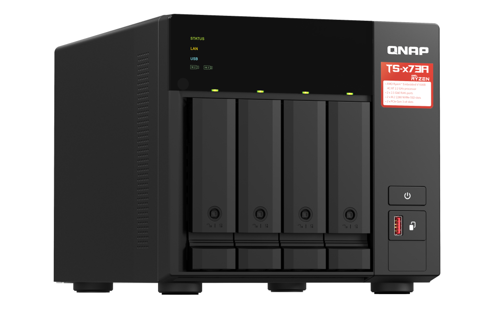

Support ECC memoryFor dual-DIMM configurations, you must use a pair of identical DDR4 modules.Flash Memory 5GB (Dual boot OS protection) Drive Bay 4 x 3.5-inch SATA 6Gb/s, 3Gb/s Drive Compatibility 3.5-inch SATA hard disk drives
2.5-inch SATA solid state drivesHot-swappable The following are not hot-swappable: M.2 SSDs, SSD cache drives, SSDs using PCIe expansion slots.M.2 Slot 2 x M.2 2280 PCIe Gen3 x1 slots The M.2 SSD is not included as standard.

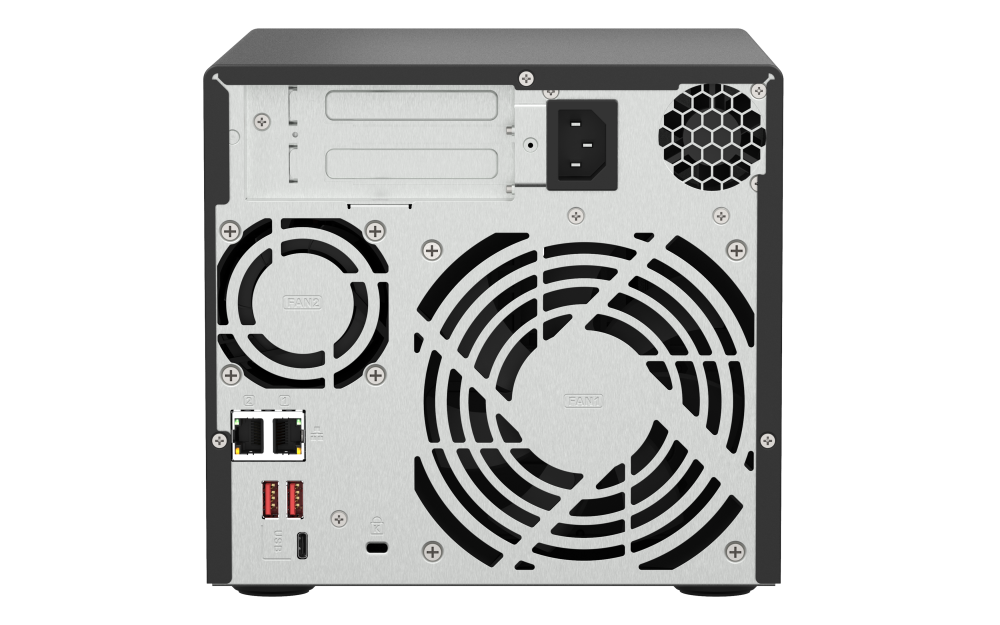

M.2 SSD operations can easily generate excessive heat. It is recommended to install a heatsink (from QNAP or a third-party provider) on the M.2 SSD.SSD Cache Acceleration Support GPU pass-through 2.5 Gigabit Ethernet Port (2.5G/1G/100M) 2(2.5G/1G/100M) 5 Gigabit Ethernet Port (5G/2.5G/1G/100M) Optional via a PCIe adapter 10 Gigabit Ethernet Port Optional via a PCIe adapter Wake on LAN (WOL) Jumbo Frame PCIe Slot 2
Slot 1: PCIe Gen 3 x4
Slot 2: PCIe Gen 3 x4Card dimensions for PCIe slot 1~Slot 2:200 x 68.9 x 18.76 mm / 7.87 x 2.71 x 0.74 inches.
Wider cards can be installed if the next PCIe slot will not be used.USB 3.2 Gen 2 (10Gbps) Port 3 x Type-A USB 3.2 Gen 2 5V/1A 10Gbps
1 x Type-C USB 3.2 Gen 1 5V/1A 5GbpsHDMI™ Output Optional via a PCIe adapter Form Factor Tower LED Indicators Status/Power, USB, LAN, Drive 1-4, M.2 SSD 1-2 Buttons Power, Reset, USB Auto Copy Dimensions (HxWxD) 180.2 × 199.3 × 279.6 mm Dimensions do not include foot pad (foot pad may be up to 30mm / 1.18 inches high depending on model)Weight (Net) 5.54 kg Weight (Gross) 6.15 kg Operating Temperature 0 - 40 °C (32°F - 104°F) Storage Temperature -20 - 70°C (-4°F - 158°F) Relative Humidity 5-95% RH non-condensing, wet bulb: 27˚C (80.6˚F) Power Supply Unit 250W, 100-240V AC, 50-60Hz, 3.5A Power Consumption: Disk Standby Mode 19.576 W Power Consumption: Operating Mode, Typical 29.792 W Tested with drives fully populated.Fan System fan: 1 x 120mm
CPU fan: 1 x 60mmSystem Warning Buzzer Standard Warranty 3 Max. Number of Concurrent Connections (CIFS) - with Max. Memory 2000 Lưu ý: Chỉ sử dụng các module bộ nhớ QNAP để duy trì hiệu suất và độ ổn định của hệ thống. Đối với các thiết bị NAS có nhiều hơn một khe cắm bộ nhớ, sử dụng các module QNAP có thông số kỹ thuật giống hệt nhau và tham khảo hướng dẫn sử dụng phần cứng để cài đặt các module bộ nhớ QNAP tương thích.
