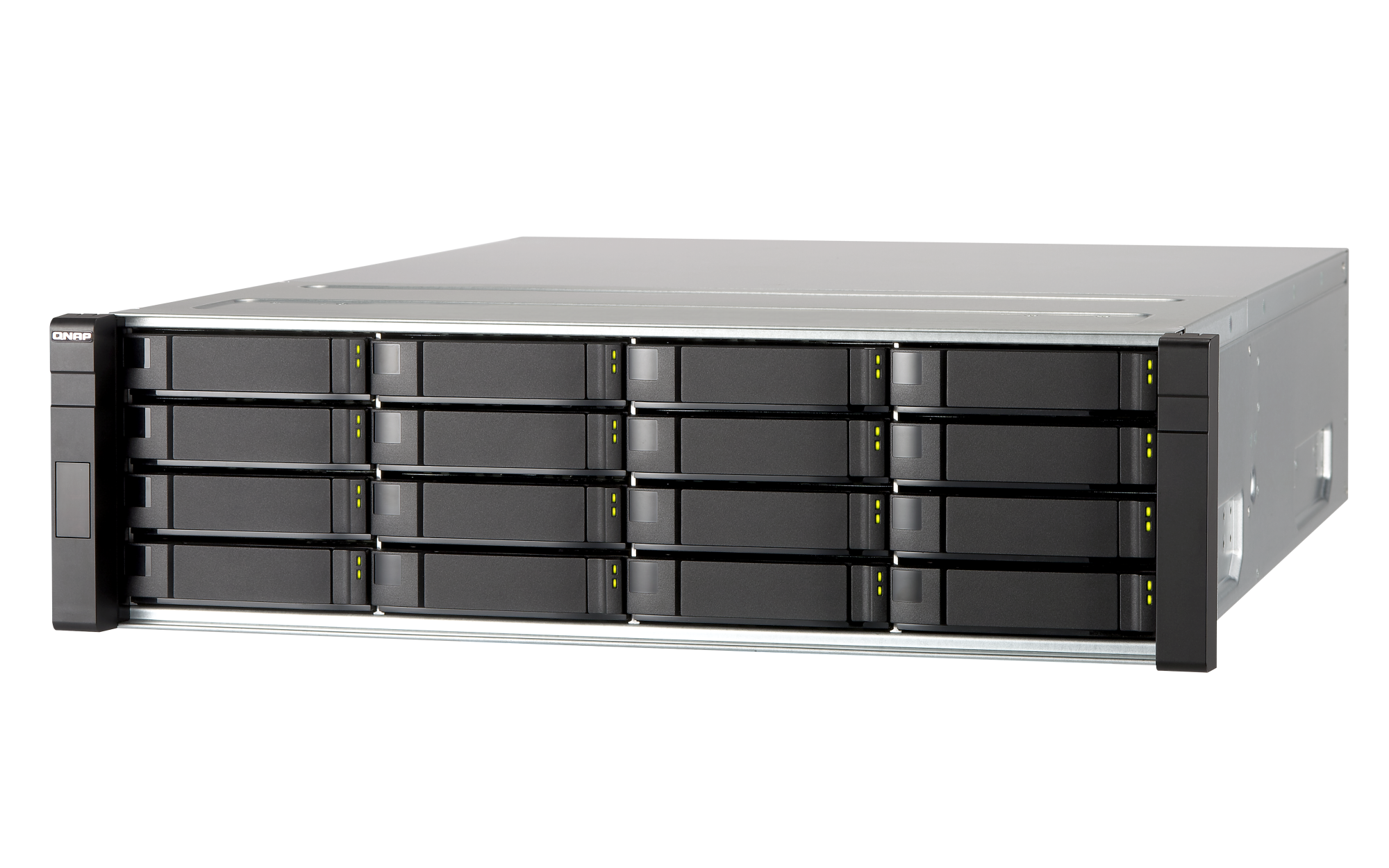

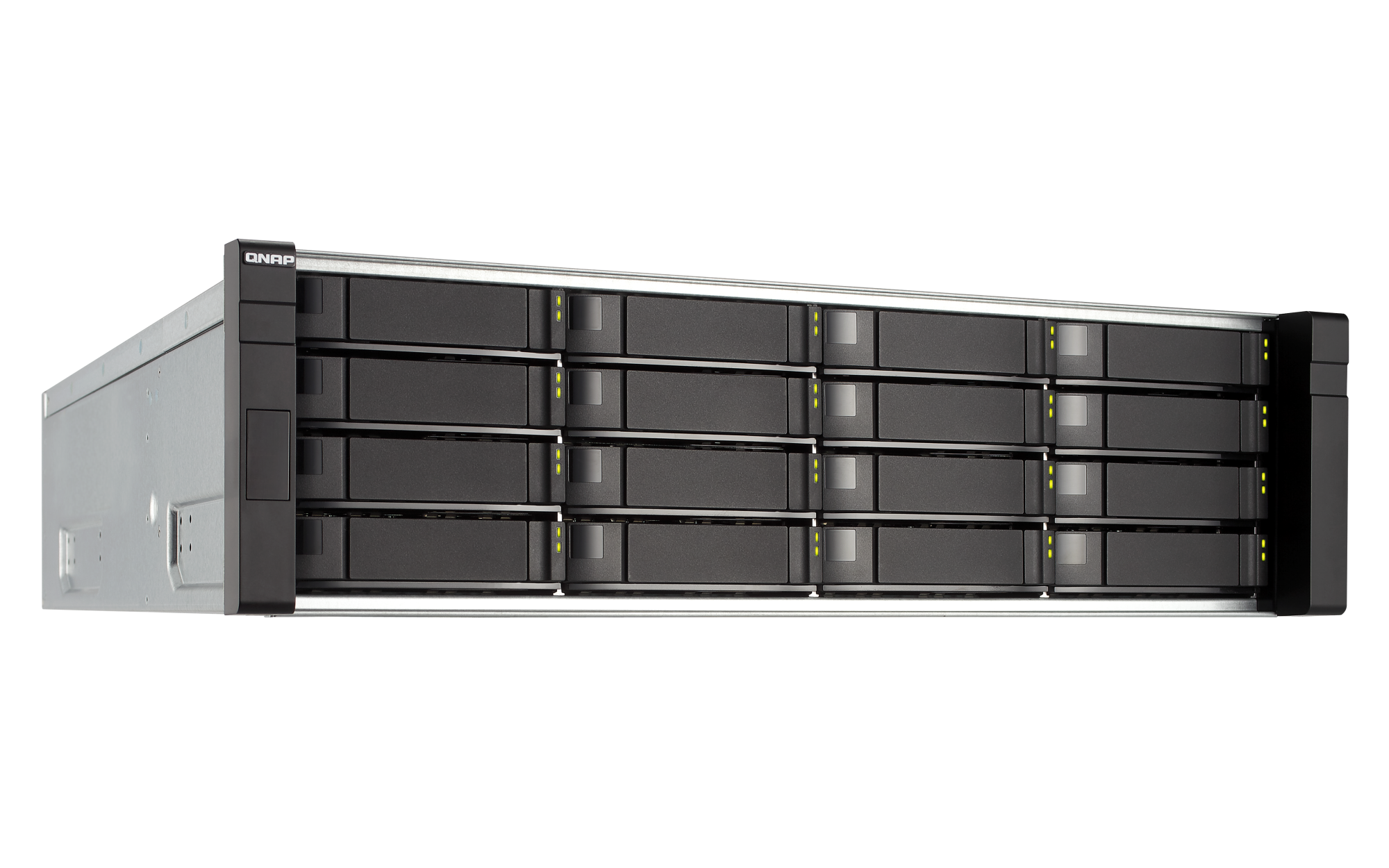

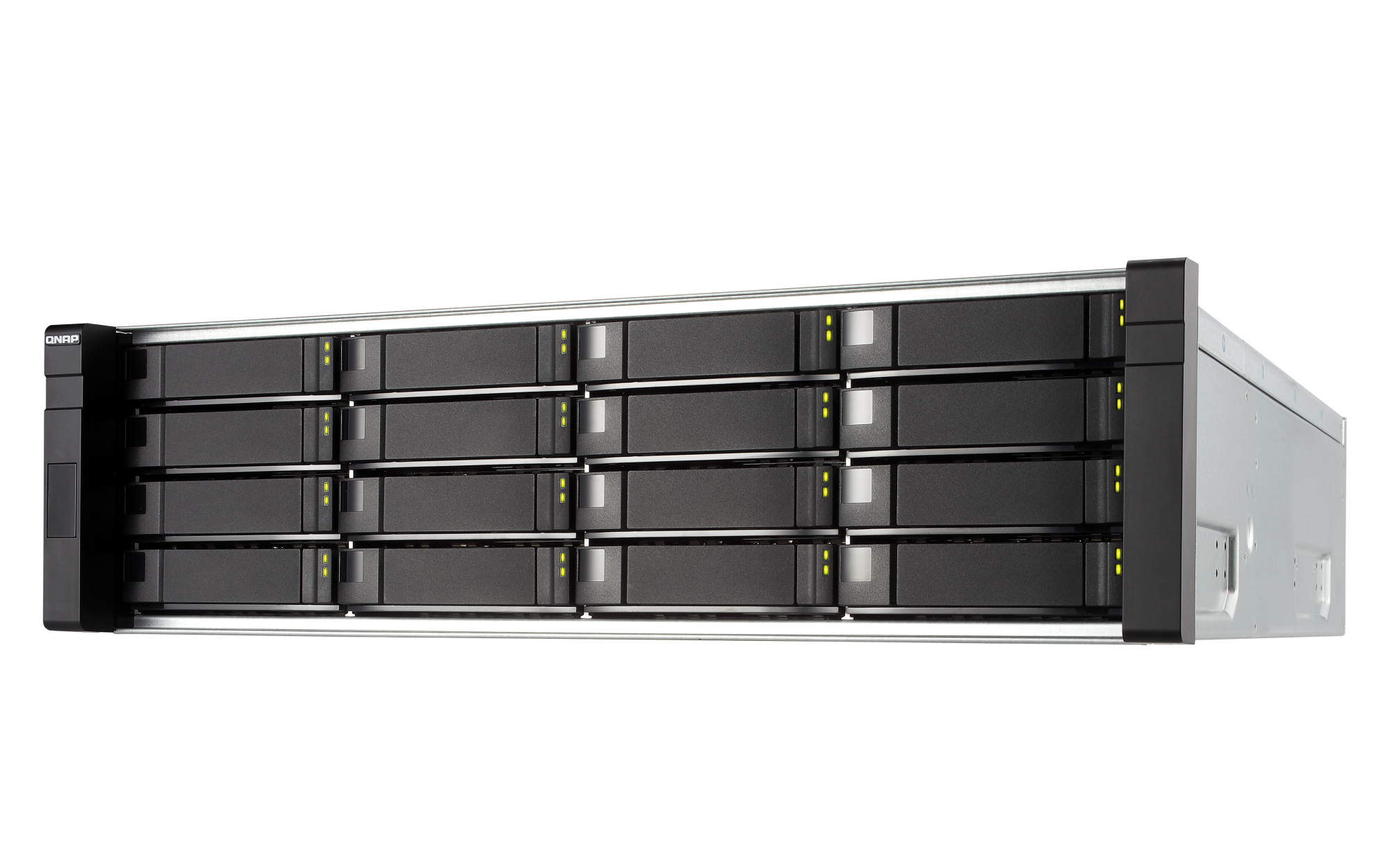

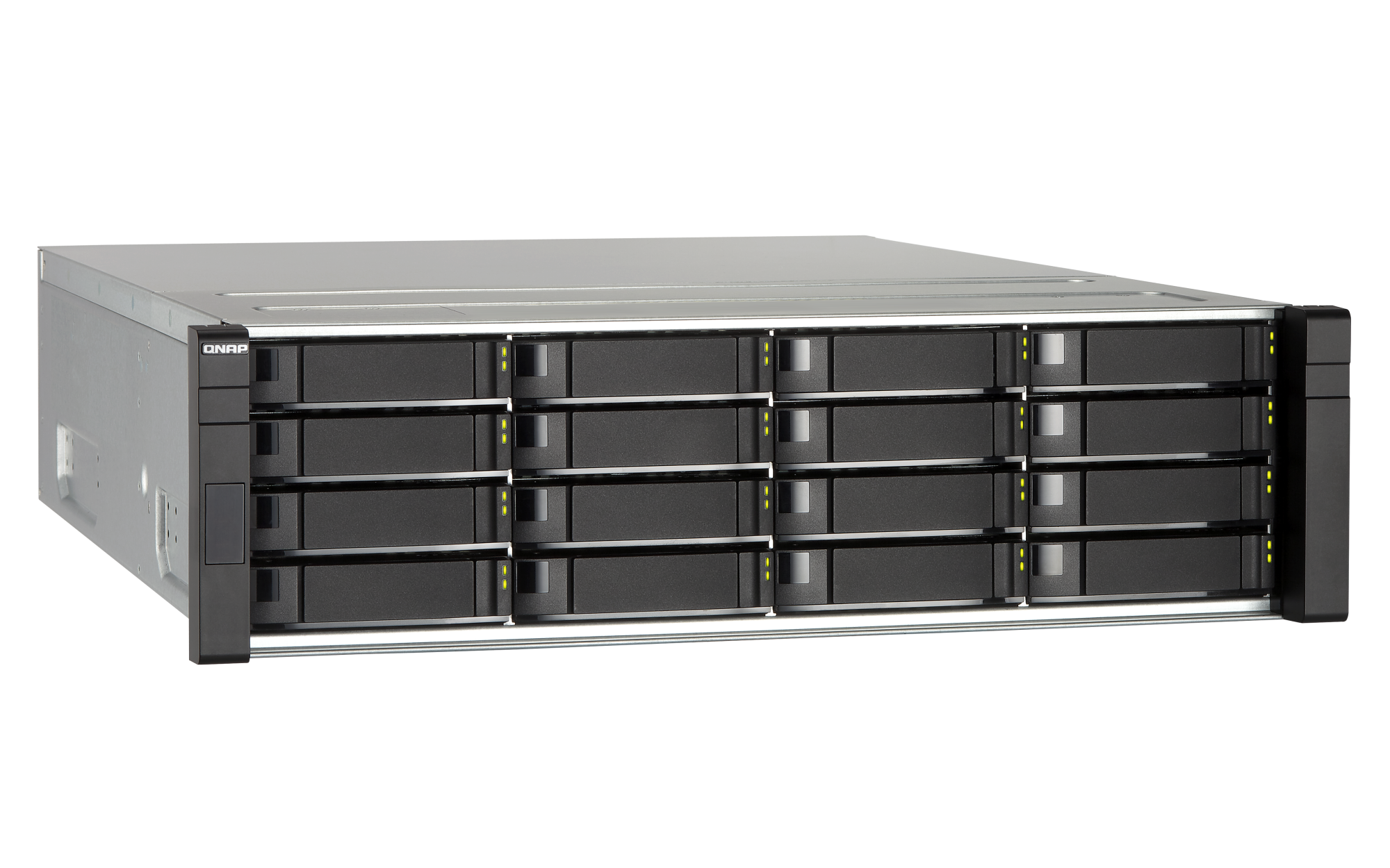

ES1640dc Specification
CPU Intel Xeon E5-2400 v2 family processor
Intel Xeon 6-core Processor E5-2420 v2 (15M Cache, 2.20GHz)
Memory System memory: DDR3 RDIMM
Total memory slots: 6 (Dual controllers; 2 x main memory DIMM and 1 x write cache DIMM for NVRAM for each controller.)
32GB for main memory DIMM and 16GB write cache DIMM per controller.
Flash Memory 2 GB DOM
USB 2 x USB 3.2 Gen 1/2.0 port (For Developement and debug only)

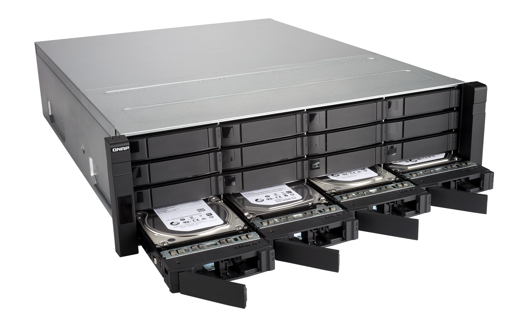

Hard Drive 16 x 3.5"/2.5" SAS 6Gbps hard drive (compatible with SAS 12Gbps hard drive), or 2.5" SAS SSD
Maximized Raw Capacity 128TB (Configuration: 16 x 8TB hard drives)
Hard Drive Interface SAS 6Gb/s
10/100/1000 Mbps LAN Port 1 for each controller (for remote management)
10Gbps LAN Port 2 x RJ45, Intel X540-BT2 for each controller
PCIe Slot PCIe Slot x8 (Gen2 x8): reserved for 40GbE or 10GbE LAN card
PCIe Slot x4 (Gen2 x4): reserved for dual path Mini-SAS
Cache for Copy To Flash (C2F) mSATA SSD (32GB) dedicated to NVRAM, SATA signaling
Form Factor 3U rackmount
Dimension 618(D) x 446.2(W) x 132(H) mm (excluding front grips)
Weight Net weight (NAS only): 26.75 kg / 58.97 lb
Gross weight (with packing and accessories): 36.94 kg / 81.44 lb
Sound Level Sound pressure (LpAm) (bystander position): 66.1dB
Power Consumption Sleep mode: 314.86 W
In operation: 501.40 W
Power Supply 770 W (Redundancy for fault tolerance)
Fan Hot-swappable fan module (60*60*38mm; 16000RPM/12v/2.8A x 3)
Electro-Magnetic Compatibility (EMC) • FCC Class A (USA only)
• CE Mark ( EN55022 Class A, EN55024)
SAFETY Standard • EN60950
• BSMI
• VCCI
• CB
• LVD

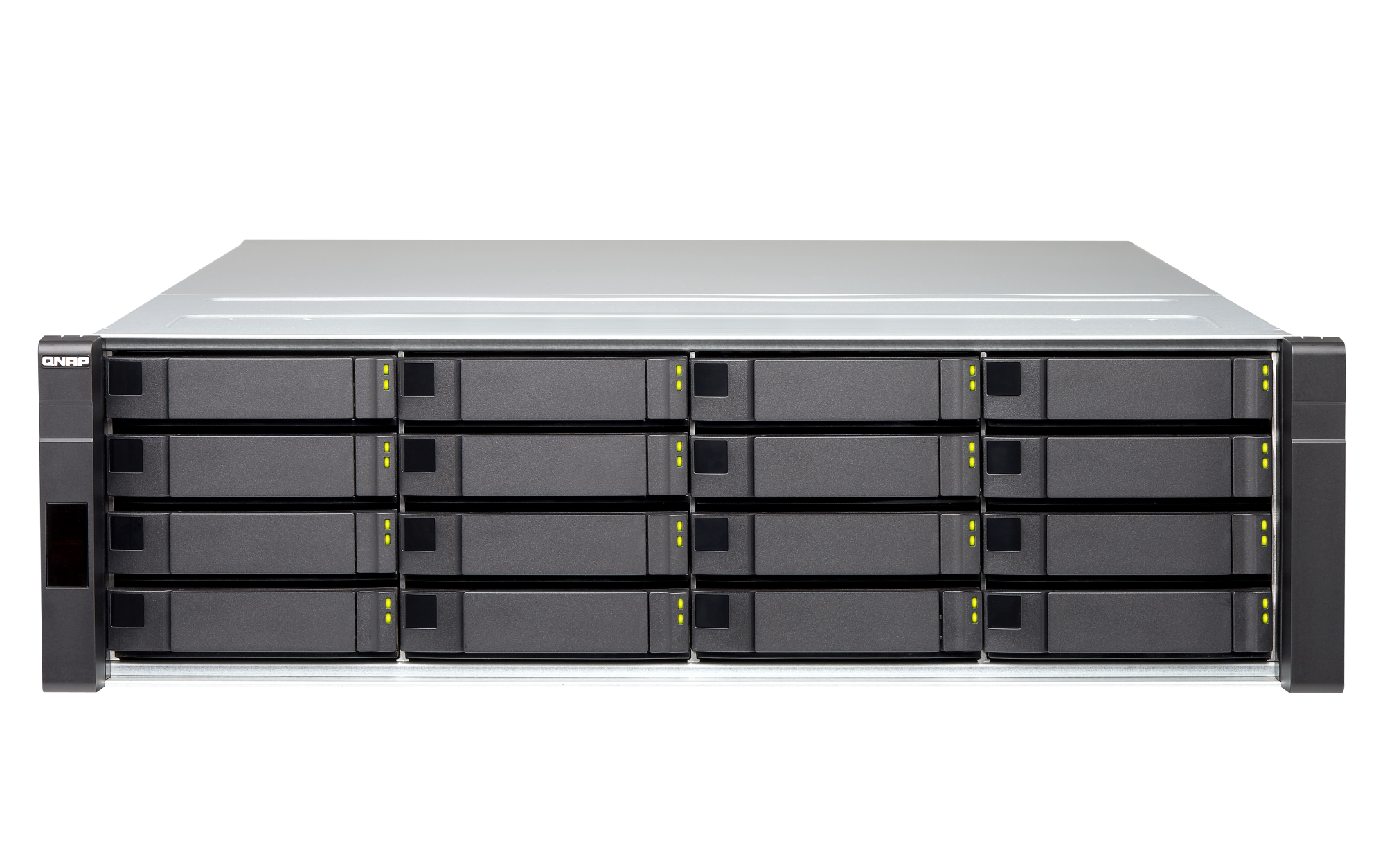

Front
1. Hard Drive Tray 3. Power On Button
2. Hard Drive LED Indicators 4. LED Indicators
System Power LED (Blue): on/off
System Status (Green/ Red): in operation, system errors, low power, degraded RAID mode, memory failure, fan/power supply failure, system/disk temperature too high, storage pool reaching threshold value, system performing take-over, power supply unit unplugged
LCD Status Display (Two-digit number): Status of JBOD connection

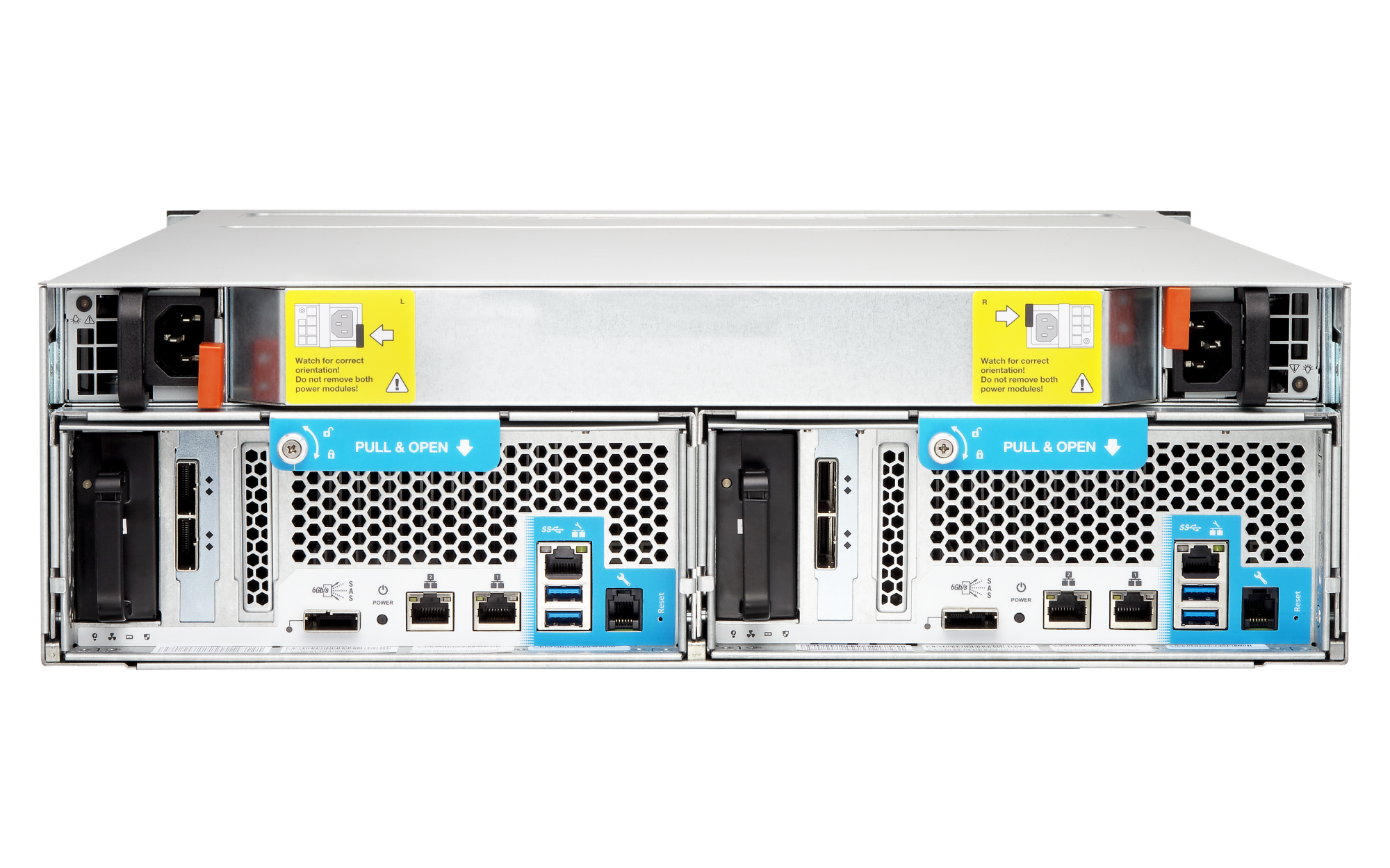

Rear
1. Password & Network Settings Reset Button 9. PCIe Gen2 x4 Slot, with dual path Mini-SAS (SFF-8088) expansion card on board
2. Power Supply LED (Green/ Orange) 10. PCIe Gen3 x8 Slot, reserved for 40GbE LAN card
3. RJ11 to RS-232 serial 11. BBU
4. 1GbE Management Port 12. BBU Status Light (Green/ Red/ Orange)
5. 2 x USB 3.2 Gen 1/2.0 Port 13. Controller Status Light (Green/ Orange)
6. 2 x 10GbE (RJ45) Port 14. Fan Status Light (Green/ Orange)
7. Power Button 15. Battery Status Light (Green/ Orange)
8. Reserved Mini-SAS Port (SFF-8088) 16. High Availability LED (Green/ Orange)
