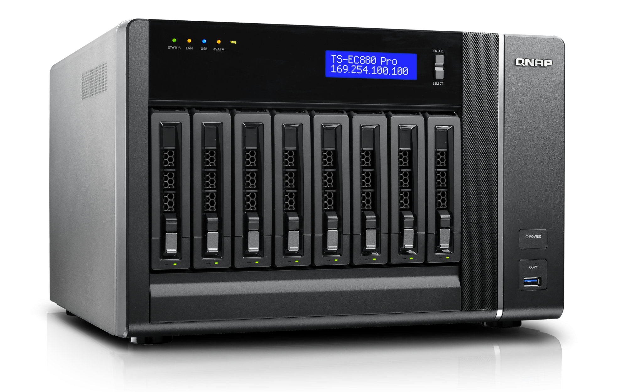

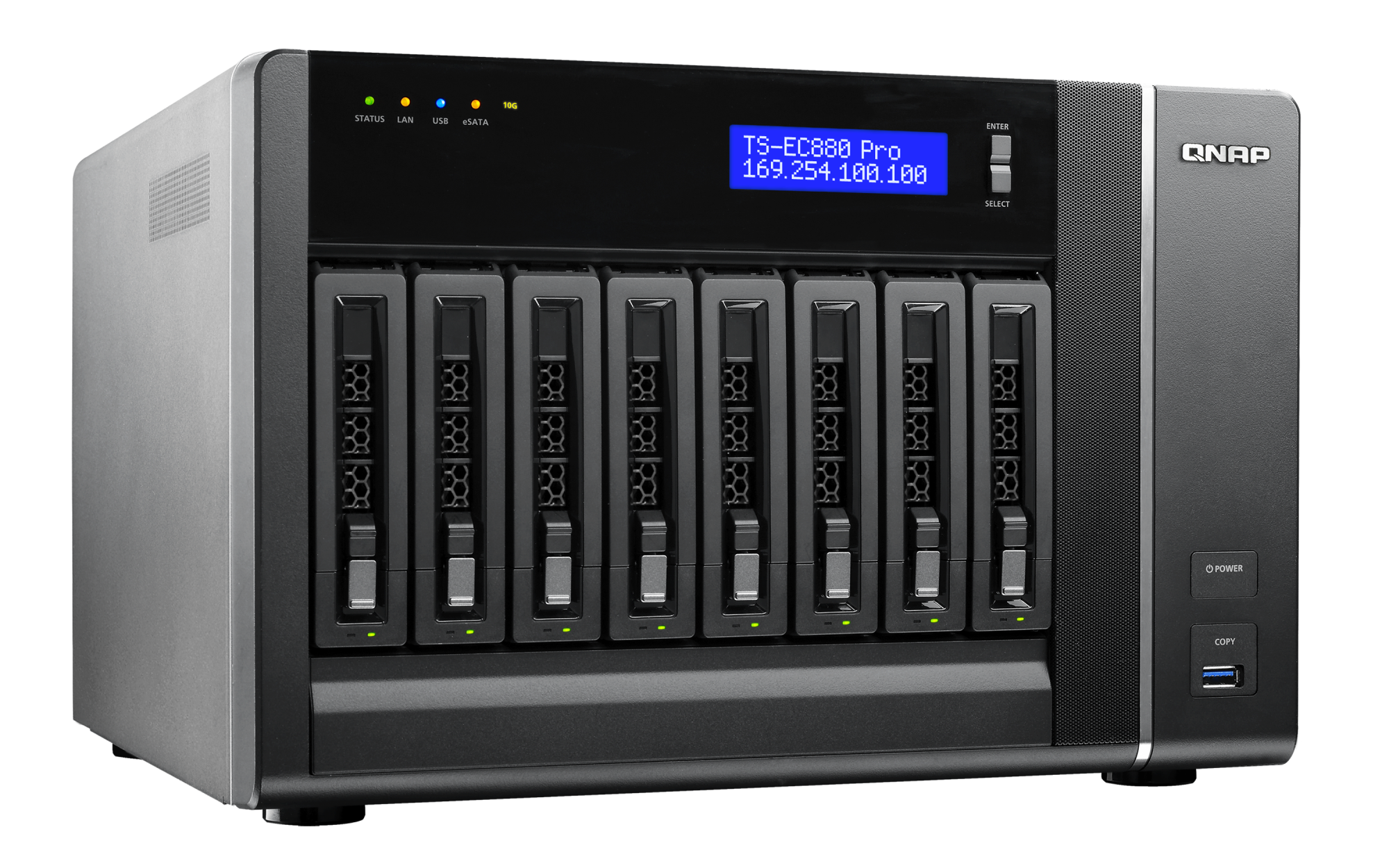

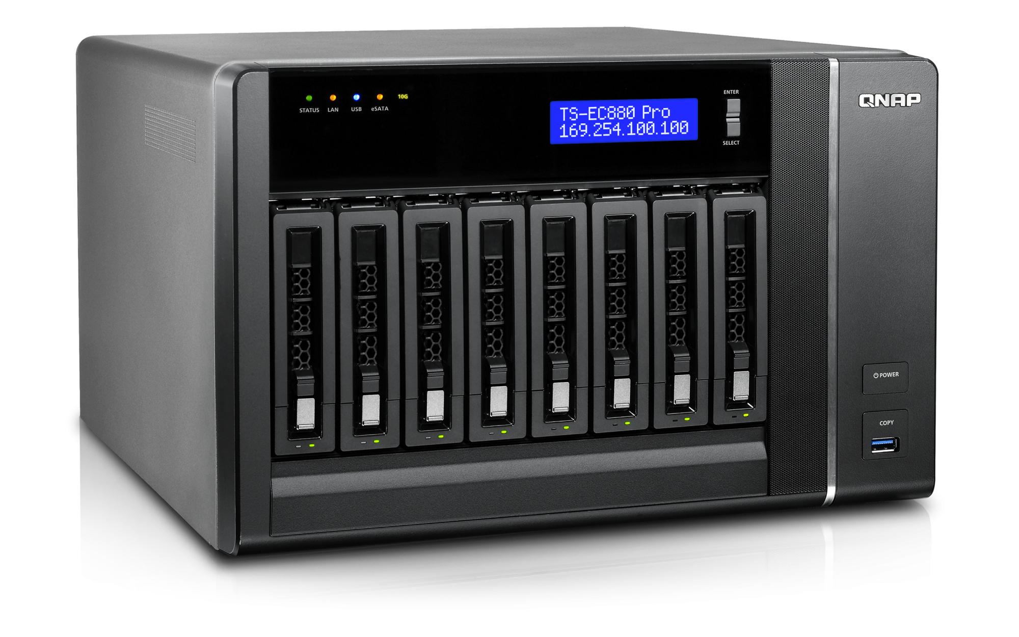

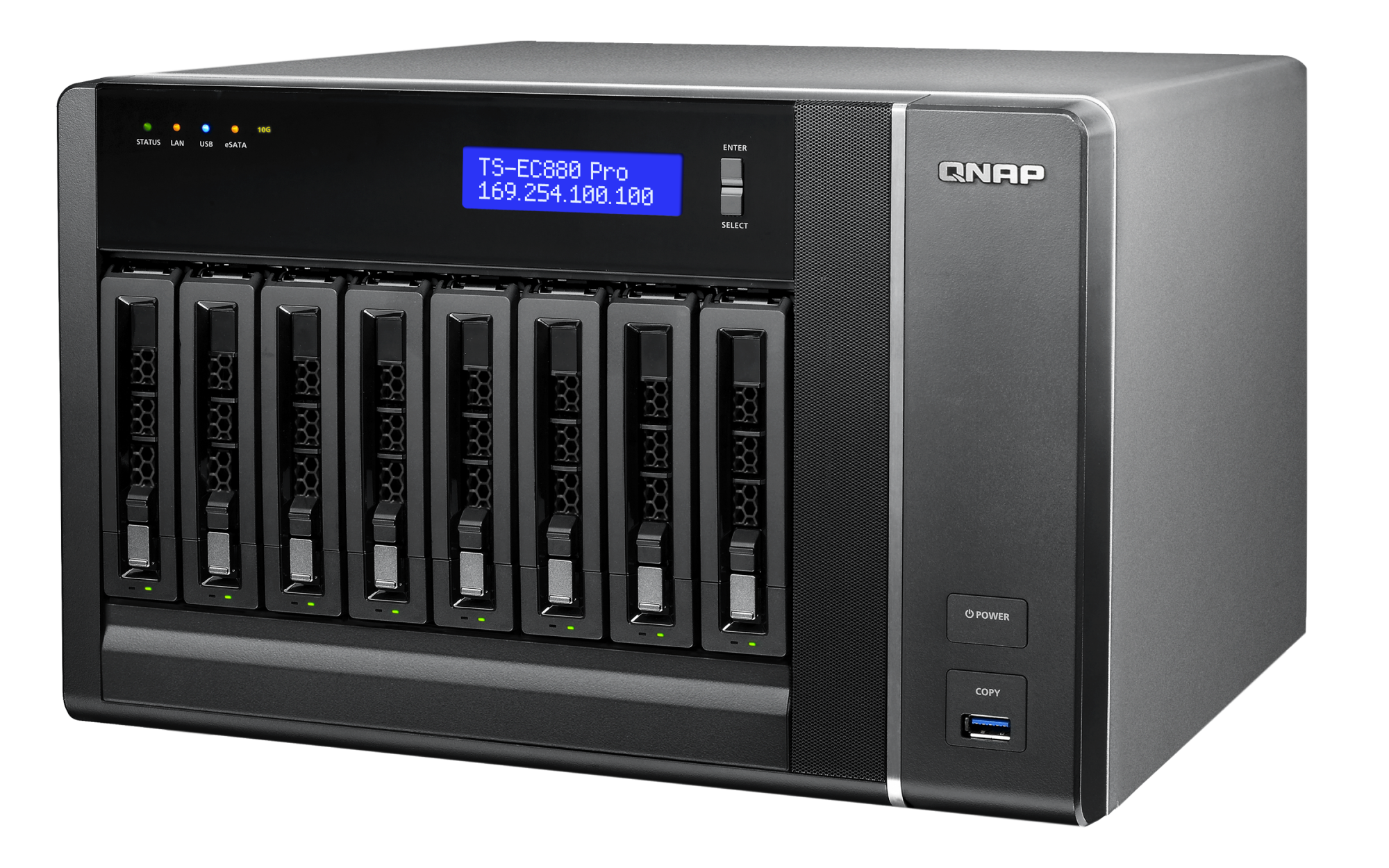

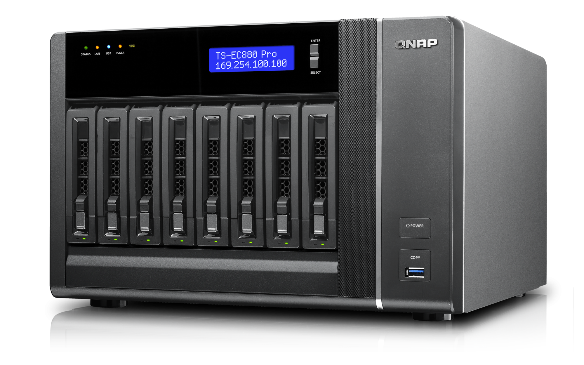

TS-EC880 Pro Specification
CPU Intel® Xeon® E3-1245 v3 3.4 GHz Quad Core Processor
Memory System memory: 2 GB DDR3 ECC RAM
Memory module pre-installed: 2 GB x1
Total memory slots: 4
Memory expandable up to: 32 GB (8GB x4)
  1. When upgrading RAM to more than 26GB, the original 2GB RAM modules must be removed.
  2. For the information of RAM module installation and compatible NAS models, please refer to the QNAP RAM Module Installation Guide
Flash Memory 512MB DOM
Internal Cache Port Two mSATA port on board for read caching
Note:  The standard system is shipped without mSATA flash. For the optional mSATA flash, please visit http://shop.qnap.com/
Hard Drive 8 x 3.5-inch SATA 6Gbps/3Gbps hard drive or 2.5-inch SATA, 6Gbps/3Gbps hard drive SSD hard drive
NOTE:
  1. The standard system is shipped without hard drives.
  2. For the hard drive compatibility list, please visit www.qnap.com/compatibility
Hard Drive Tray 8 x hot-swappable and lockable tray
LAN Port
4 x Gigabit RJ-45 Ethernet port
(Expandable up to 6 x 1 Gb LAN or 2 x 10 Gb + 4 x 1 Gb LAN by installing optional dual-port 10 Gb and 1 Gb network card)
1. For the optional network card compatibility list, please visit www.qnap.com/i/nl/product_x_grade/cat_intro.php?g_cat=11
2. For the information of network card installation, please refer to chapter 6 in the Turbo NAS Hardware Manual.
LED Indicators Status, LAN, USB, eSATA and 10 GbE,
USB 3x USB 3.2 Gen 1 port (1 front, 2 rear)
6x USB 2.0 port (rear)
Support USB printer, pen drive, USB hub, and USB UPS etc.
Buttons System: Power button and reset button
Alarm Buzzer System warning
Form Factor Tower
Dimensions 217.5(H) x 327(W) x 321.2(D) mm
8.56(H) x 12.8(W) x 12.65(D) inch
Weight Net weight (NAS only) : 12.52 kg/27.61 lb
Gross weight (with packing and accessories) : 19.75 kg/43.54 lb
Sound Level (dB) Standby: 30.3 dB
In operation: 31.2 dB
(with 8 x 1TB hard drives installed)
Power Consumption (W) Sleep mode: 68W
In Operation: 130W
Temperature 0-40˚C
Relative Humidity 5~95% non-condensing, wet bulb: 27˚C.
Power Supply Input: 100-240V AC, 50/60Hz, Output: 350W
PCIe Slot 1 (1* PCIe Gen3 x8)
Fan 2 x 12 cm smart cooling fan

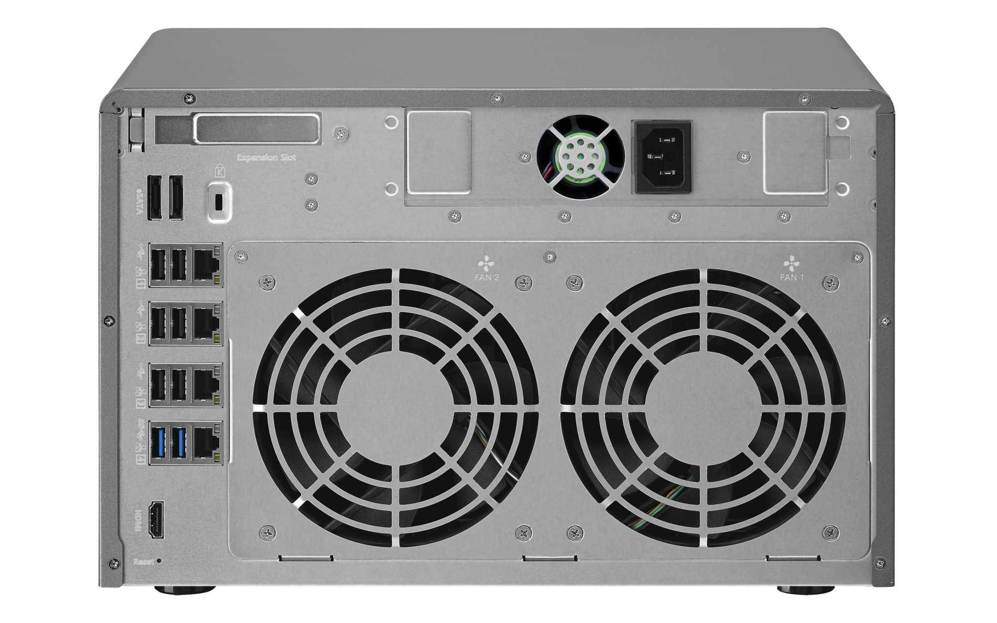

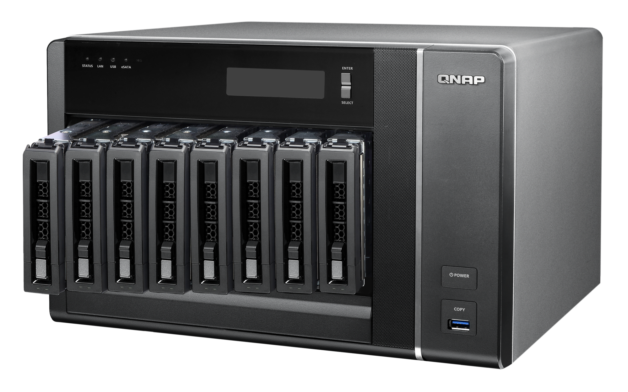

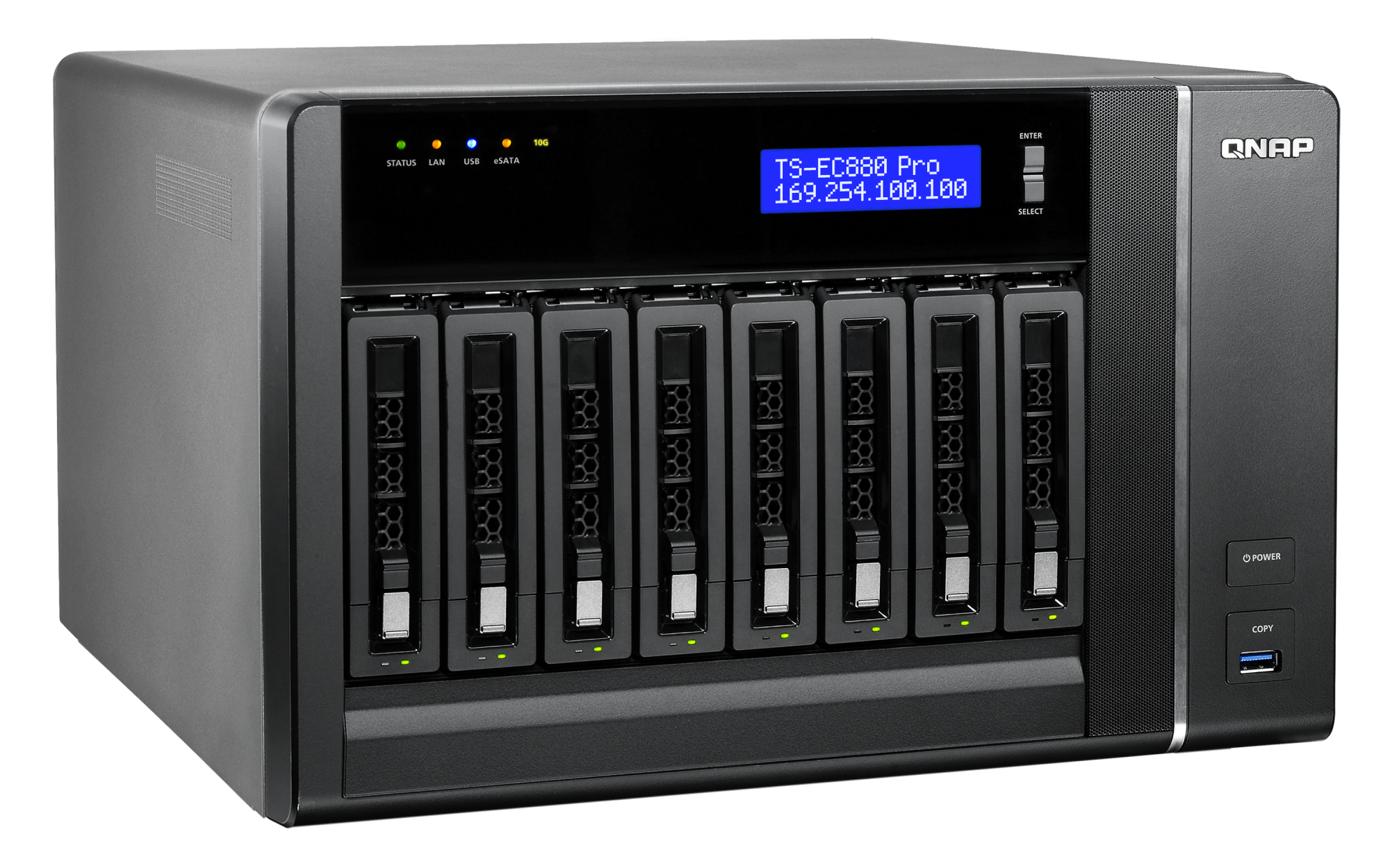

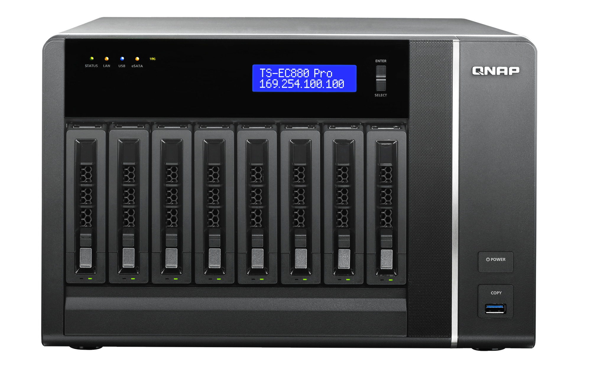

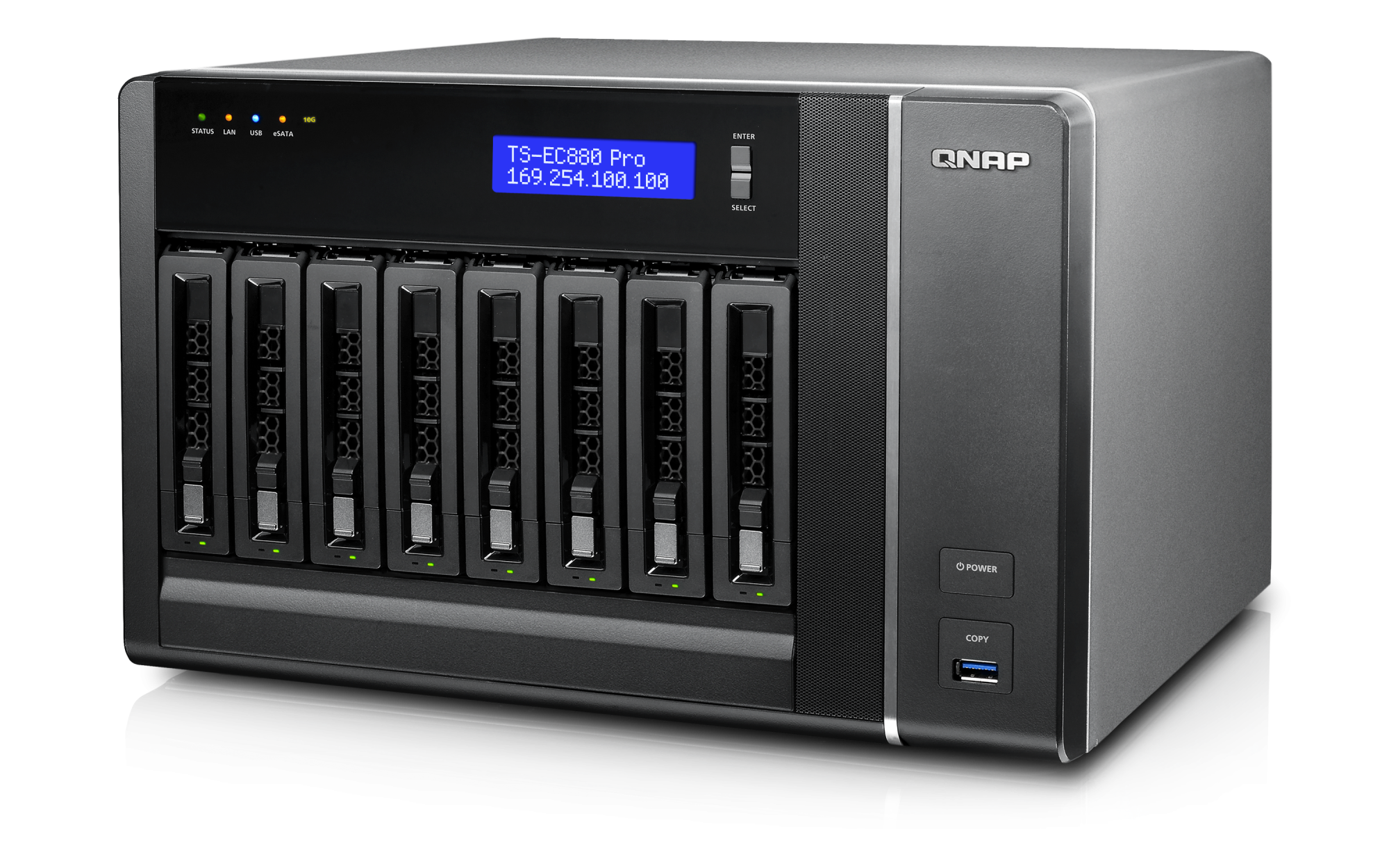

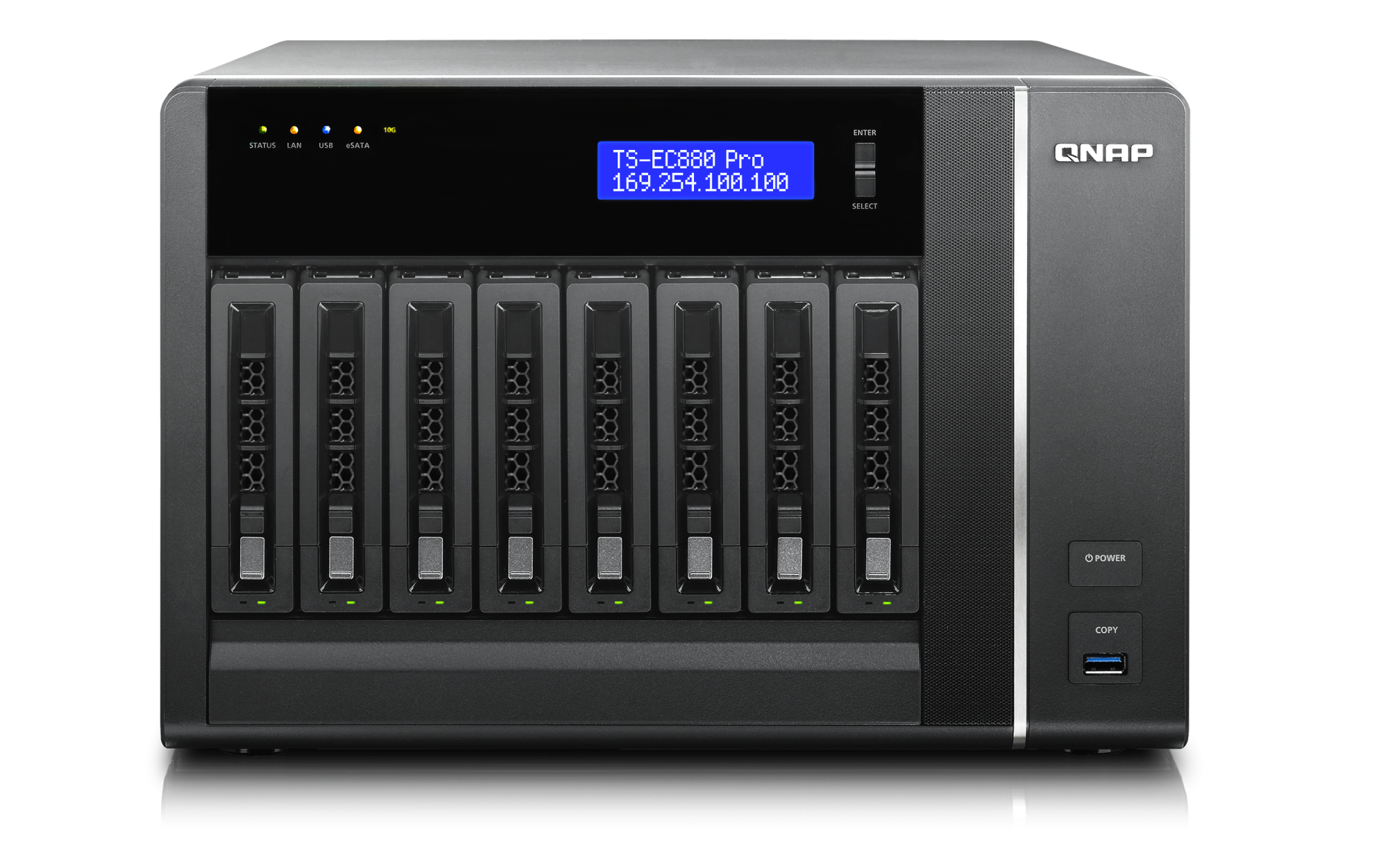

1. LED Indicators:
Status, LAN, USB, eSATA, 10 GbE, LAN
10. PCIe Slot x1
2. HDD Status LED 11. USB 2.0 Port x6
3. Select Button 12. Password & Network Settings Reset Button
4. Enter Button 13. USB 3.2 Gen 1 Port x2
5. Tray Lock 14. K-Lock Security Slot
6. Tray Release Button 15. Gigabit LAN Port x4
7. One Touch Copy Button/ USB 3.2 Gen 1 Port 16. Power Connector
8. Power Button 17. HDMI™ x1
9. eSATA Port x2
