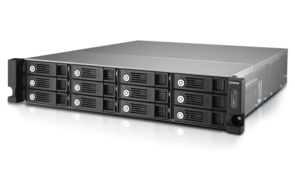

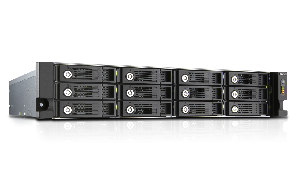

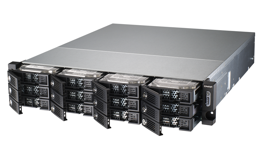

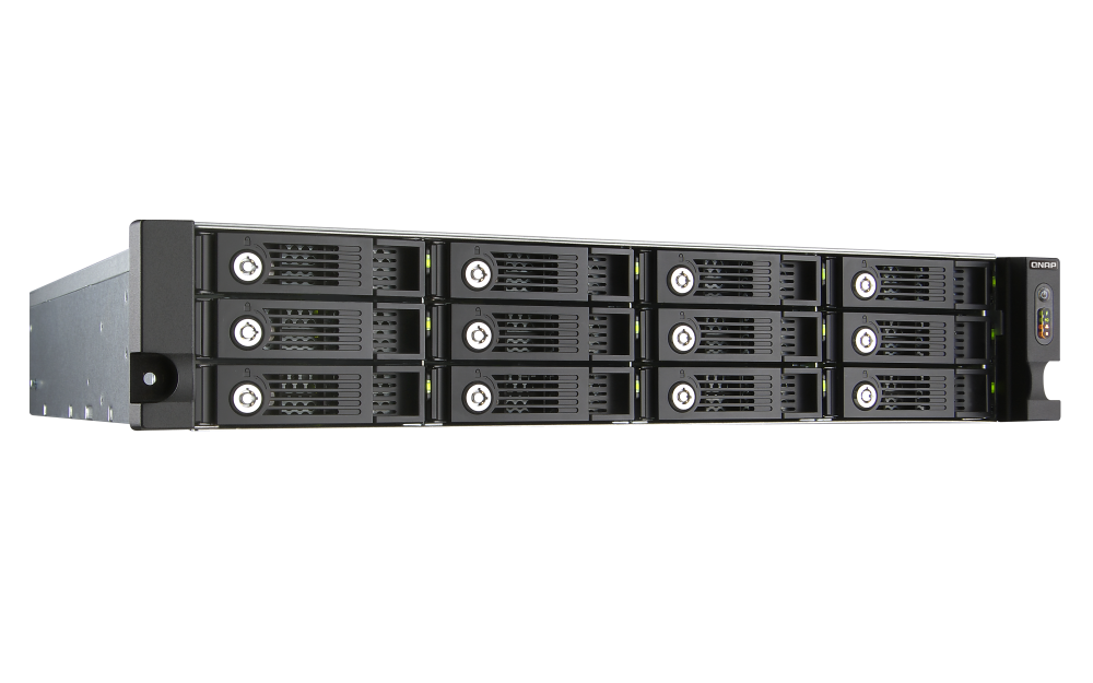

Hard Drive 12 x 3.5” or 2.5” SATA 6Gb/s, SATA 3Gb/s hard drive or SSD
NOTE:
1. The standard system is shipped without hard drives.
2. For the hard drive compatibility list, please visit www.qnap.com/compatibility.
Hard Drive Tray 12 x hot-swappable and lockable tray

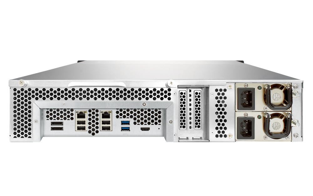

LAN Port 2 x Gigabit RJ-45 Ethernet port
(Expandable up to 6 x 1 Gb LAN or 4 x 10 Gb + 2 x 1 Gb LAN by installing optional dual-port 10 Gb and 1 Gb network card)
1. For the optional network card compatibility list, please visit www.qnap.com/i/en/product_x_grade/cat_intro.php?g_cat=11
2. For the information of network card installation, please refer to chapter 6 in the Turbo NAS Hardware Manual.
LED Indicators Status, 10 GbE, LAN, eSATA, hard drives
USB 2x USB 3.2 Gen 1 port (rear)
4x USB 2.0 port (rear)
Support USB printer, pen drive, USB hub, and USB UPS etc.
eSATA 2 (rear)
Buttons System: Power button and reset button

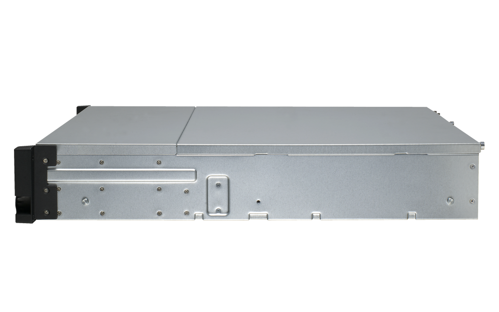

Form Factor 2U, Rackmount
Dimensions 89 (H) x 482 (W) x 534 (D) mm
3.50 (H) x 18.98 (W) x 21.02 (D) inch
Weight 16.14 kg/35.58 lb (Net)
18.98 kg/ 41.84 lb (Gross)

Power Supply Input: 100-240V AC, 47-63Hz
Output: 500W
Expansion Slot 2 (for network and storage expansion)
Fan 2 x quiet cooling fan (7 cm, 12V DC)

The TS-x70U rack mount models comply with ANSI/EIA-RS-310-D rack mounting standards. Before purchasing the server racks for these models, please make sure the server racks conform to the following criteria:
  1. Rack size
    1. Mounting post width: ≥ 451.5mm
    2. Panel width: ≥ 500mm
    3. Mounting post depth: 555mm~757mm
  2. If the NAS is to be installed in a rack, a rack shelf or QNAP rail kit (optional purchase) is required.
  3. The optional rack kits for the TS-x70U rack mount models are only compatible with square-hole server racks.
