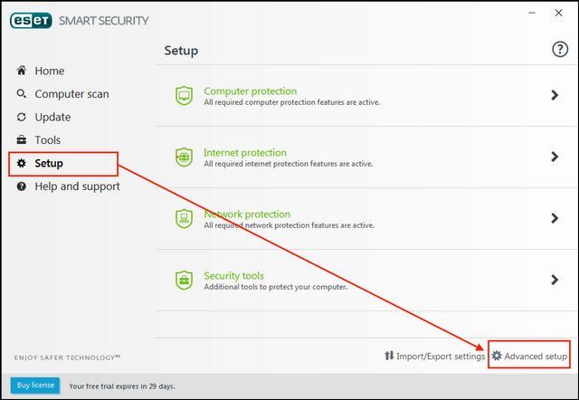

  1. Open ESET Smart Security.
  2. Go to Setup > Advanced setup.

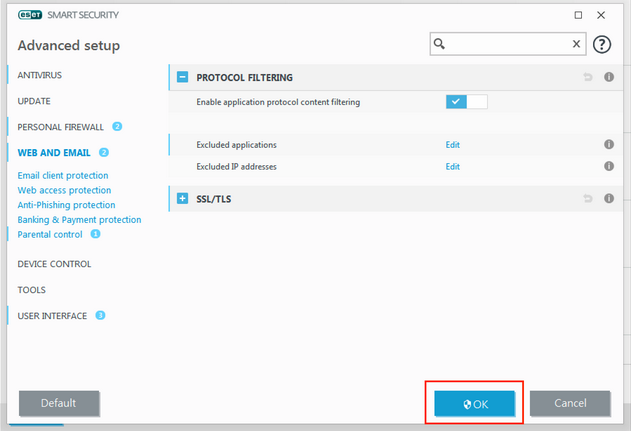

  3. Go to WEB AND EMAIL > PROTOCOL FILTERING.
  4. Locate Excluded applications and click Edit.

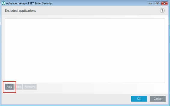

    The Excluded applications window opens.
  5. Click Add.

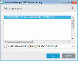

    The Add application window opens.
  6. Specify the location of the QVR Pro Client executable file.
  7. Click OK.
    The Add application window closes.

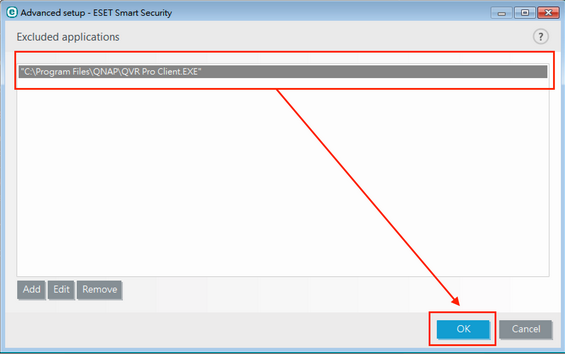

  8. Verify that QVR Pro Client is added to the list.
  9. Click OK.
    The Excluded applications window closes.
  10. Click OK.
