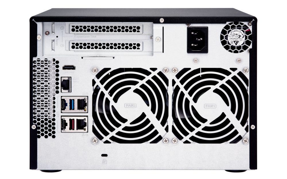

Slot 1: PCIe Gen 3 x16 (CPU)
Slot 2: PCIe Gen 3 x4 (PCH)Card dimensions for PCIe slot 1~Slot 2:210 x 111.15 x 18.76 mm / 8.26 x 4.38 x 0.74 inches.
Wider cards can be installed if the next PCIe slot will not be used.USB 3.2 Gen 1 port 1 USB 3.2 Gen 2 (10Gbps) Port 2 x Type-C USB 3.2 Gen 2 10Gbps

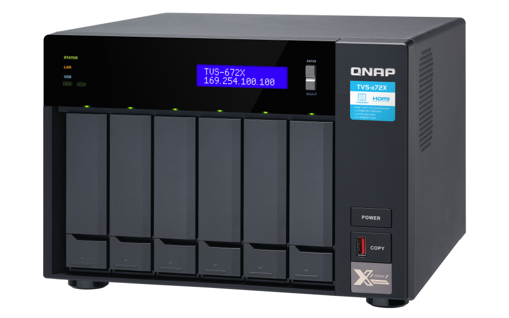

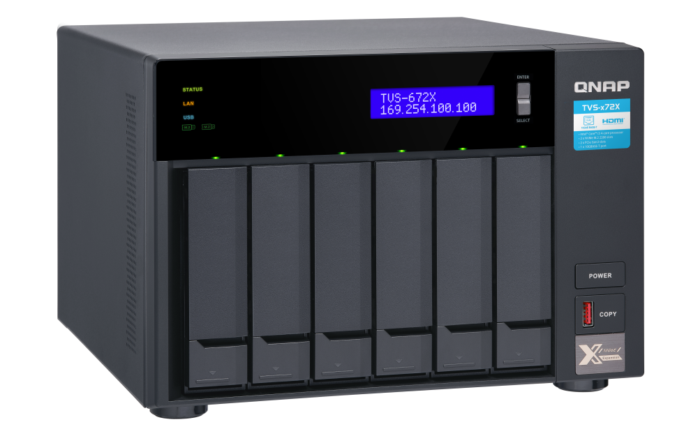

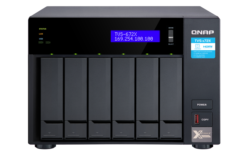

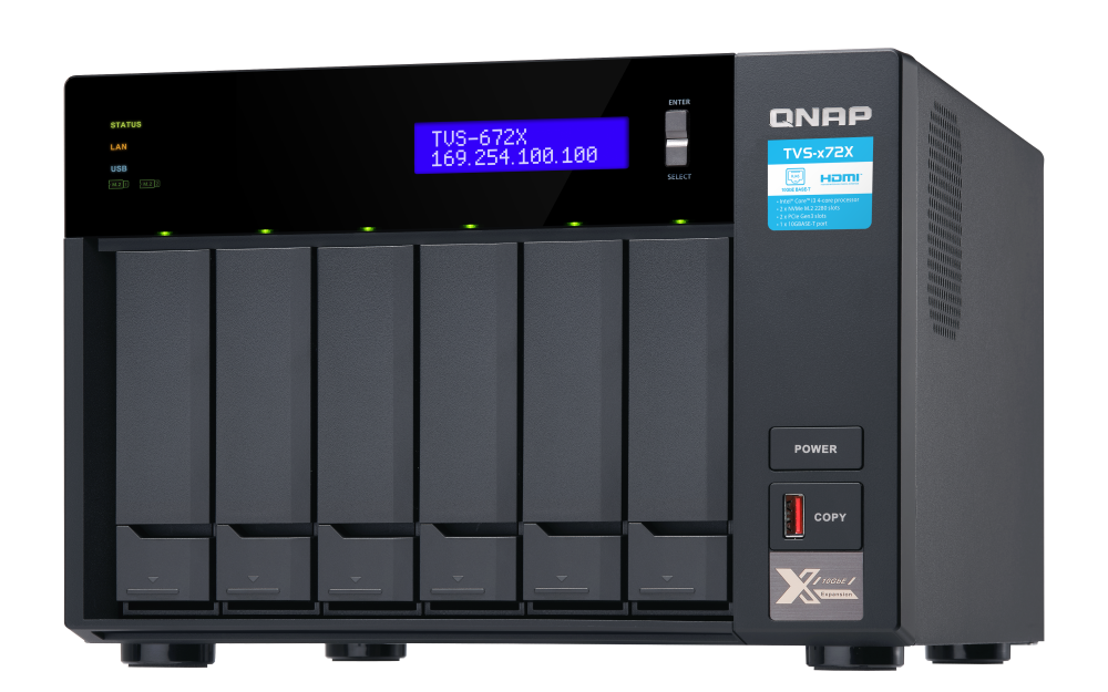

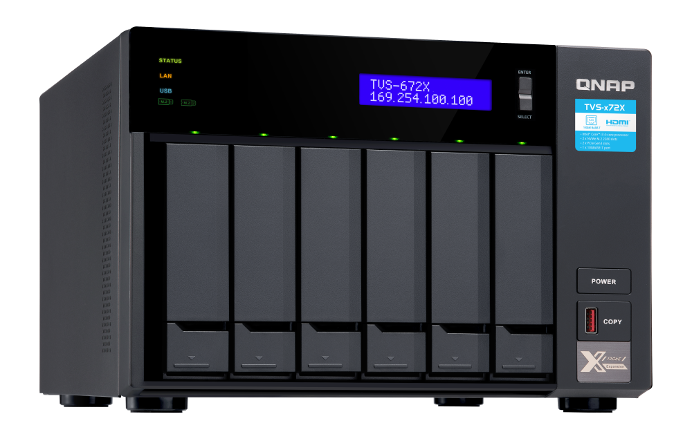

2 x Type-A USB 3.2 Gen 2 10GbpsIR Sensor (QNAP RM-IR004 & MCE) HDMI™ Output 1, HDMI™ 2.0 (up to 3840 x 2160 @ 60Hz) Form Factor Tower LED Indicators HDD 1-6, Status, LAN, USB port, M.2 port LCD Display/ Button Buttons Power, Reset, USB Copy Dimensions (HxWxD) 188.2 × 264.3 × 279.6 mm Weight (Net) 6.553 kg Weight (Gross) 8.07 kg Operating Temperature 0 - 40 °C (32°F - 104°F) Storage Temperature -20 - 70°C (-4°F - 158°F) Relative Humidity 5-95% RH non-condensing, wet bulb: 27˚C (80.6˚F) Power Supply Unit 250W, 100-240V Power Consumption: Disk Standby Mode 26.52 W Power Consumption: Operating Mode, Typical 45.6 W Tested fully populated with WD10EFRX hard drives.Fan System fan: 1 x 120mm, 12VDC
CPU fan: 2 x 60mm blower fanSystem Warning Voice prompts or Buzzer Kensington Security Slot Standard Warranty 2 Max. Number of Concurrent Connections (CIFS) - with Max. Memory 2500 Note: Use only QNAP memory modules to maintain system performance and stability. For NAS devices with more than one memory slot, use QNAP modules with identical specifications and refer to the hardware user manual to install compatible QNAP memory modules.
