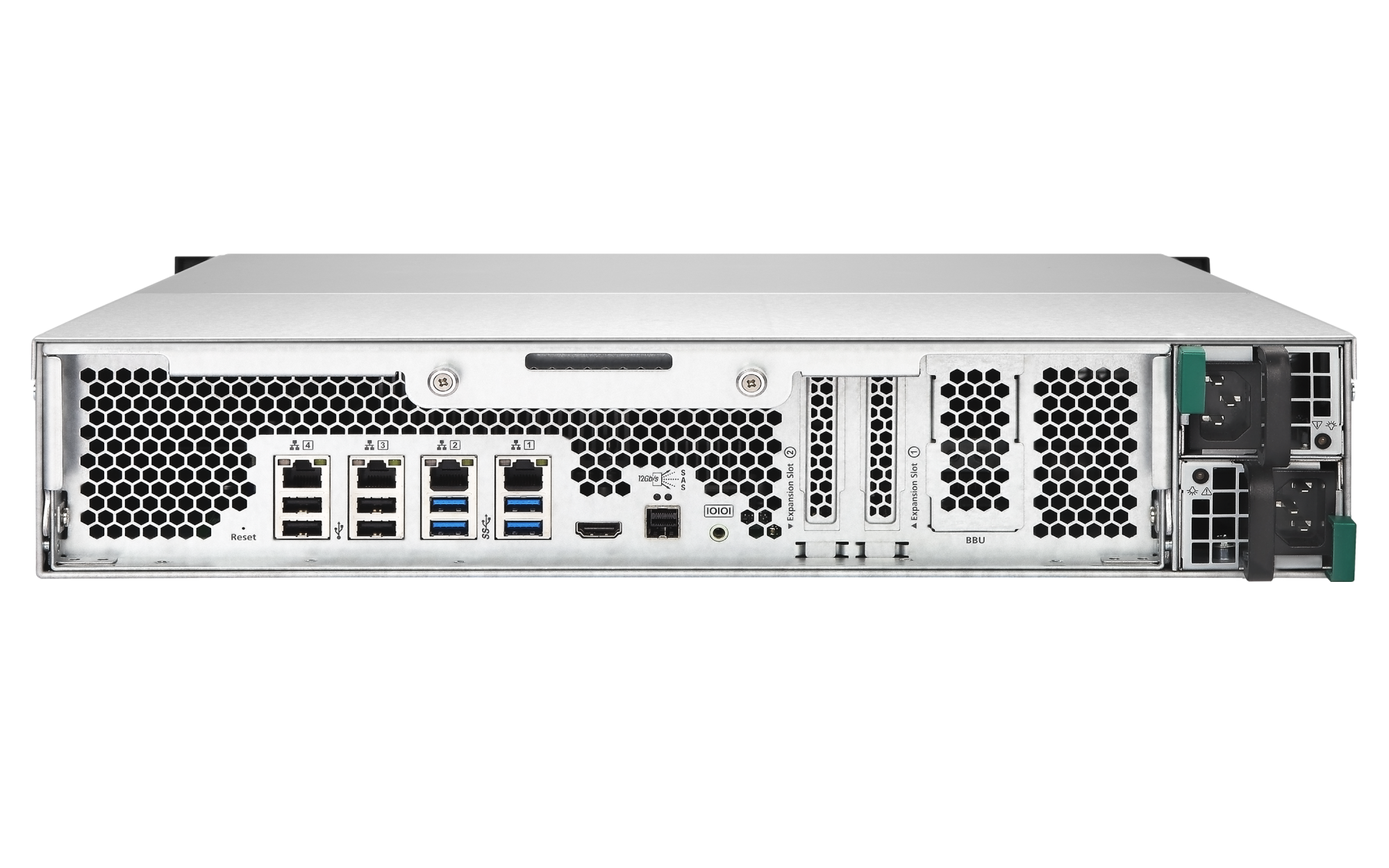

1. Power Button 7. HDMI™
2. LED Indicators: 10 GbE, Status, LAN, Storage Expansion Port Status 8. 12G mini SAS connector
3. Password & Network Settings Reset Button 9. Console
4. USB 2.0 Port x 4 10. PCIe slot x 2 (Left slot: 1* PCIe Gen3 x8; Right slot: 1* PCIe Gen3 x4)
5. Gigabit LAN x 4 11. BBU (Reserved)
6. USB 3.2 Gen 1 Port x 4 12. Power Connector
