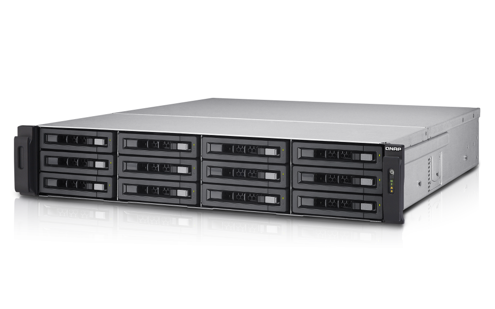

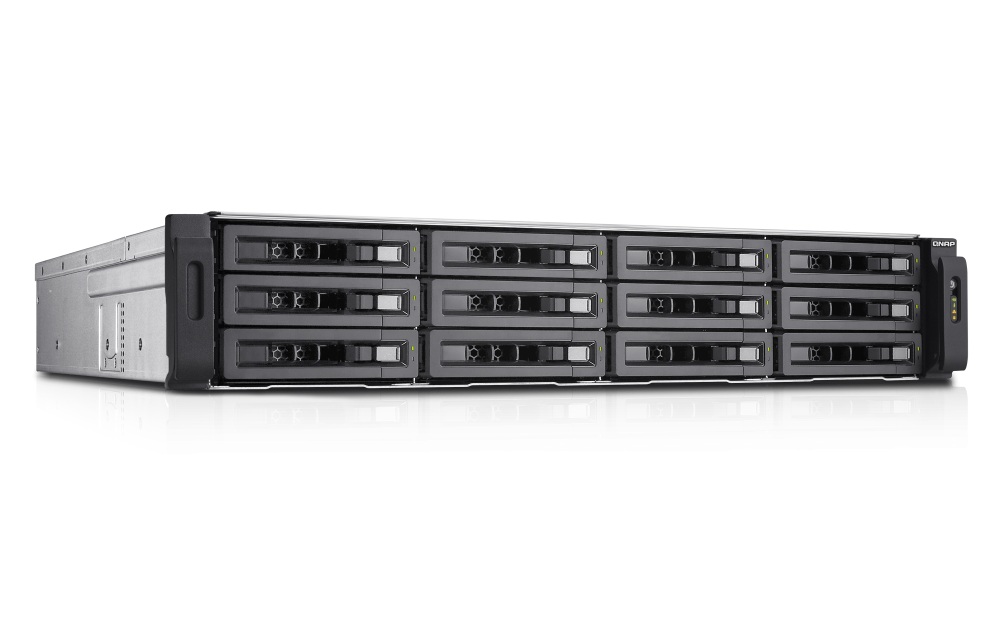

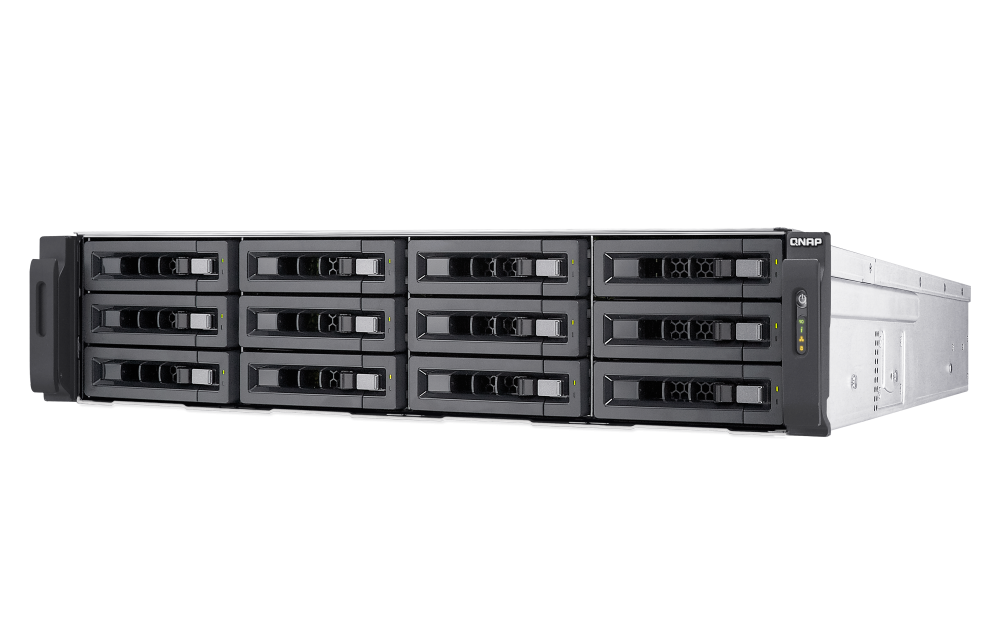

TVS-EC1280U-SAS-RP Specification
CPU Intel® Xeon® E3-1246 v3 Family 3.5 GHz Quad-core Processor
Memory TVS-EC1280U-SAS-RP-16G
System memory: 16GB DDR3 non-ECC RAM
Memory module pre-installed: 8 GB x2
Total memory slots: 4
Memory expandable up to: 32 GB (8GB x4)
TVS-EC1280U-SAS-RP-8GE
System memory: 8 GB DDR3 ECC RAM
Memory module pre-installed: 4 GB x2
  1. ECC RAM and non-ECC RAM cannot be used at the same time in the NAS.
  2. For the information of RAM module installation and compatible NAS models, please refer to the QNAP RAM Module Installation Guide
Flash Memory 512MB DOM
Internal Cache Port Two mSATA port on board for read caching. The standard system is shipped with two 128GB mSATA flash.
For the optional mSATA flash, please visit http://shop.qnap.com/
Hard Drive 12 x 3.5-inch SAS 12Gbps, SAS/SATA 6Gbps/3Gbps hard drive or 2.5-inch SAS/SATA SSD hard drive
NOTE:
  1. The standard system is shipped without hard drives.
  2. For the hard drive compatibility list, please visit https://www.qnap.com/compatibility
Hard Drive Tray 12 x hot-swappable and lockable tray
LAN Port
4 x Gigabit RJ-45 Ethernet port (Expandable up to 8 x 1 Gb LAN or 4 x 10 Gb + 4 x 1 Gb LAN by installing optional dual-port 10 Gb and 1 Gb network card)
1. For the optional network card compatibility list, please visit Compatibility list
2. For the information of network card installation, please refer to chapter 6 in the Turbo NAS Hardware Manual.
LED Indicators 10 GbE, Status, LAN, Storage expansion port status
USB 4x USB 3.2 Gen 1 port (rear)
4x USB 2.0 port (rear)
Support USB printer, pen drive, USB hub, and USB UPS etc.
Buttons System: Power button and reset button
Alarm Buzzer System warning
Form Factor 2U, Rackmount
Dimensions 88(H) x 442.5(W) x 530.5(D) mm
3.46(H) x 17.42(W) x 20.89(D) inch
Weight Net weight (NAS only) : 14.18 kg/ 31.26 lb
Gross weight (with packing and accessories) : 21.41 kg/ 47.20 lb
Sound Level* Sound pressure (LpAm) :49.4 dB(A)
Power Consumption (W) Sleep mode: 111.26
In Operation: 178.65 W
(with 12 x 1TB hard drive installed)
Temperature 0-40˚C
Relative Humidity 5~95% non-condensing, wet bulb: 27˚C.
Power Supply Redundant power: Input 90~264VAC; 450W x 2
PCIe Slot 2 (Left slot: 1* PCIe Gen3 x8; Right slot: 1* PCIe Gen3 x4)
Fan 4 x 6 cm smart cooling fan
1. Power Button 7. HDMI™
2. LED Indicators: 10 GbE, Status, LAN, Storage Expansion Port Status 8. 12G mini SAS connector
3. Password & Network Settings Reset Button 9. Console
4. USB 2.0 Port x 4 10. PCIe slot x 2 (Left slot: 1* PCIe Gen3 x8; Right slot: 1* PCIe Gen3 x4)
5. Gigabit LAN x 4 11. BBU (Reserved)
6. USB 3.2 Gen 1 Port x 4 12. Power Connector
Remark:
The TVS-x80U-SAS rack mount models comply with ANSI/EIA-RS-310-D rack mounting standards. Before purchasing the server racks for these models, please make sure the server racks conform to the following criteria:
