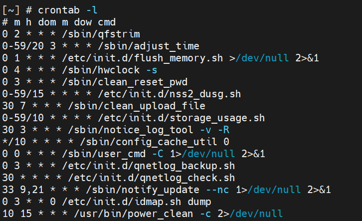

To view the contents of your crontab, please logon to your NAS via SSH and type crontab -l.
[~] # crontab -l
You will see a list of crontab entries.
e.g.:
This is the crontab definition. (from Wikipedia)
For more details, please see Cron on Wikipedia.
