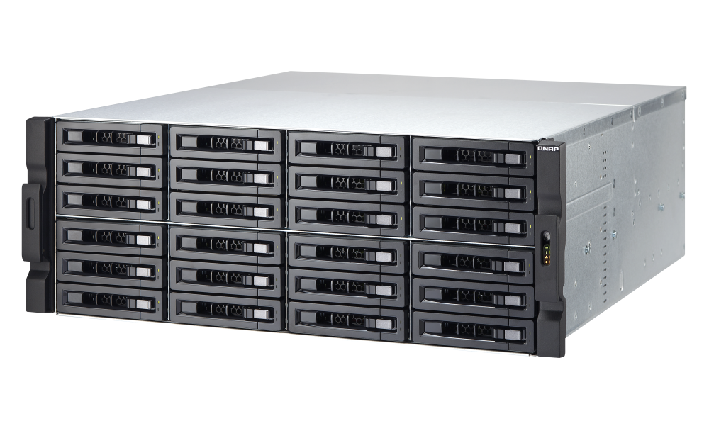

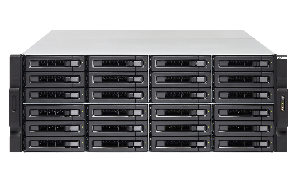

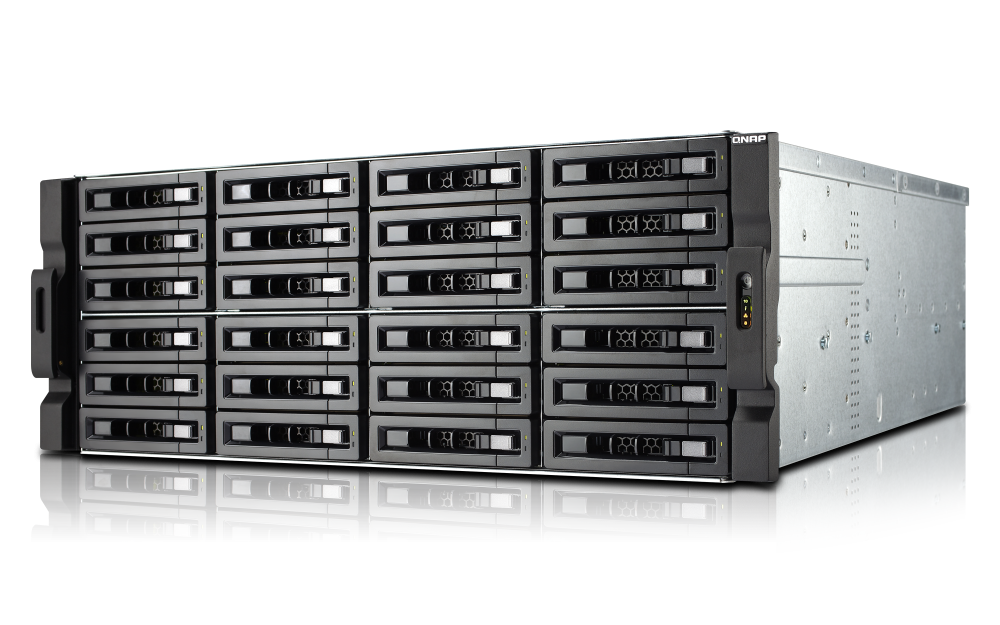

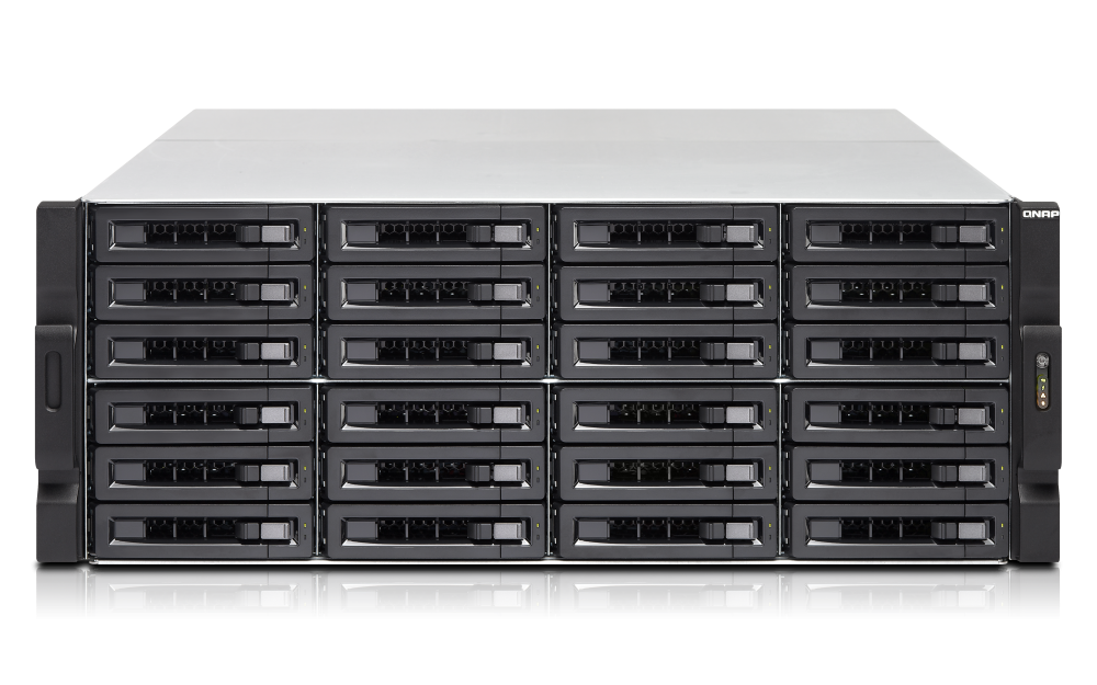

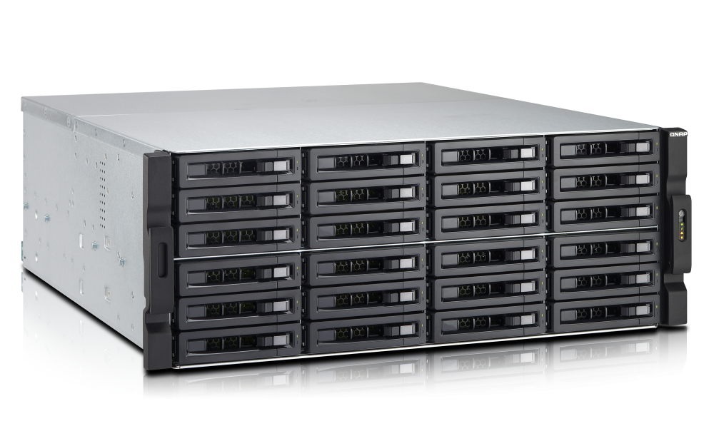

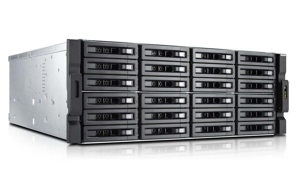

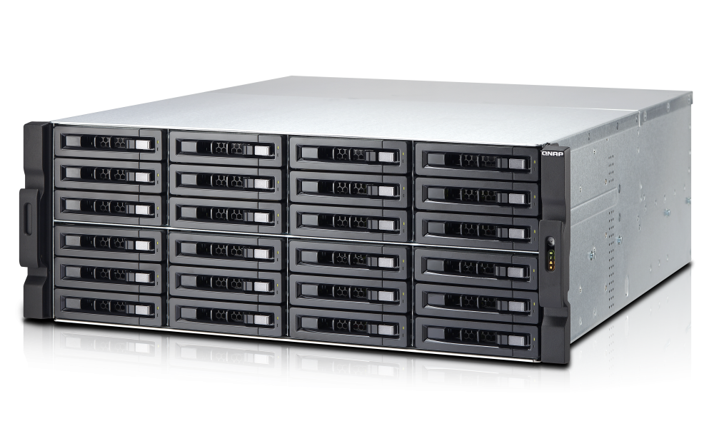

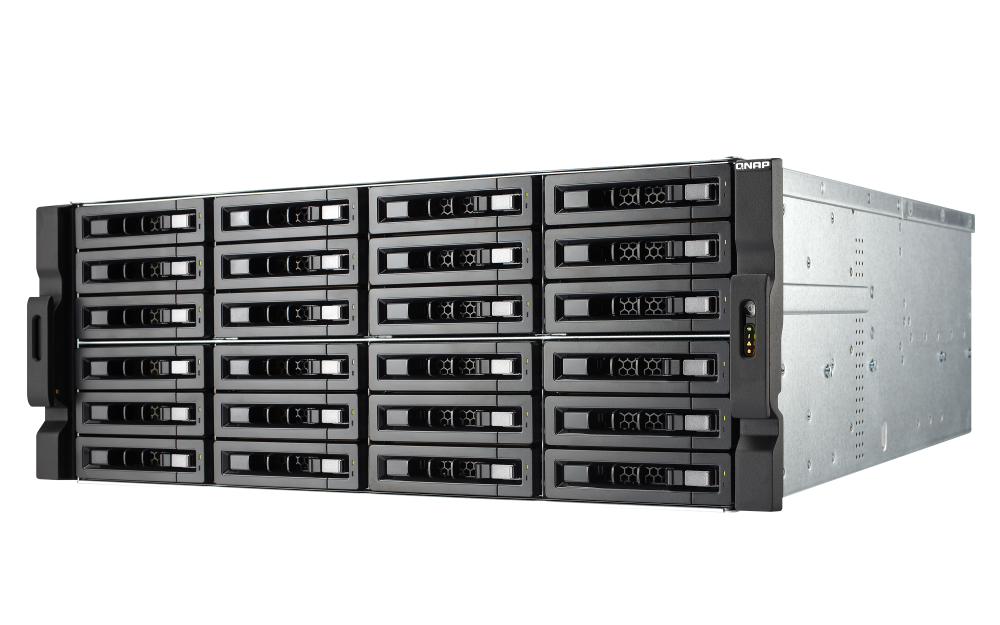

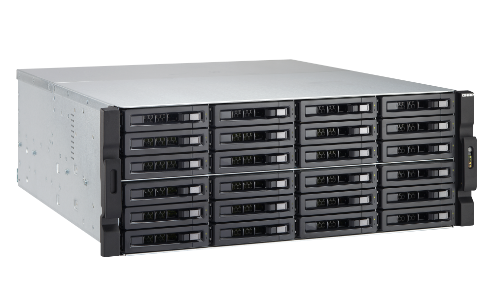

Hard Drive 24 x 3.5-inch SAS 12Gbps, SAS/SATA 6Gbps/3Gbps hard drive or 2.5-inch SAS/SATA SSD hard drive
NOTE:
  1. The standard system is shipped without hard drives.
  2. For the hard drive compatibility list, please visit https://www.qnap.com/compatibility
Hard Drive Tray 24 x hot-swappable and lockable tray

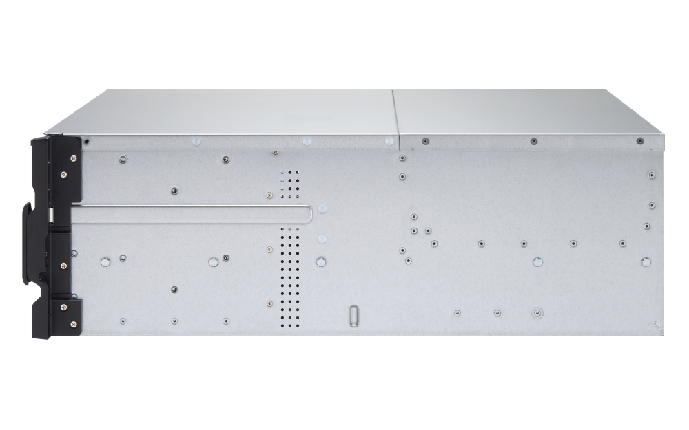

Form Factor 4U, Rackmount
Dimensions 176.15(H) x 442.5(W) x 530.5(D) mm
6.94(H) x 17.42(W) x 20.89(D) inch
Weight Net weight (NAS only) : 23.08 kg/50.88 lb
Gross weight (with packing and accessories) : 28.56 kg/ 62.96 lb
