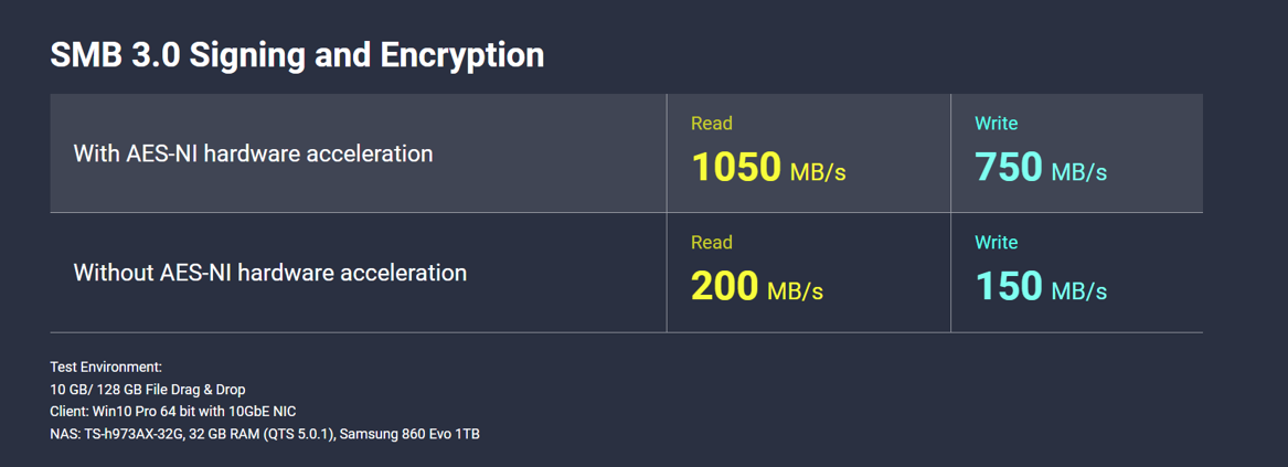

Enhanced Transfer Speeds for SMB Encryption
QNAP has improved the performance for SMB 3.0 (Server Message Block) signing and encryption with AES-NI hardware acceleration in QTS 5.0.1. QTS 5.0.1 has greatly enhanced the transfer speeds, which can provide better transmission efficiency and satisfy the demands for data security at the same time.

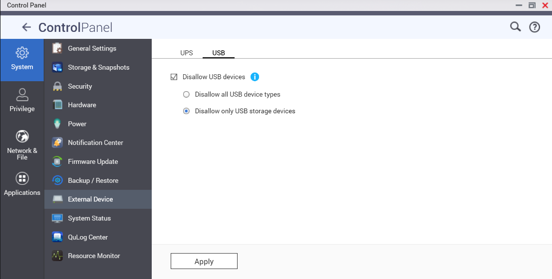

Disallow USB Connections to Enhance Device Security
USB ports provide a convenient way to connect your NAS with other devices. However, this convenient accessibility can also expose your NAS to secure risks. Starting from QTS 5.0.1, you can choose to disallow all USB devices or only disallow USB storage devices (such as external drives or expansion enclosures). USB blocking adds an extra layer of protection to safeguard your NAS against security threats such as viruses and malware.
To disallow USB connections, go to Control Panel > System > External Device > USB and then select the types of USB devices that you want to block.
