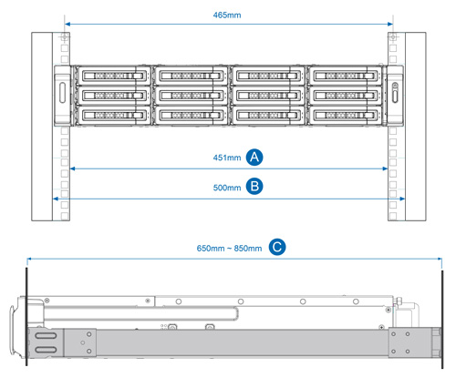

The TS-x79 rack mount models comply with ANSI/EIA-RS-310-D rack mounting standards. Before purchasing the server racks for these models, please make sure the server racks conform to the following criteria:
1. Rack size
  1. Mounting post width : ≥ 450mm
  2. Panel width : ≥ 485mm
  3. Mounting post depth : 650mm~850mm
2. The optional rack kits for the TS-x79 rack mount models are only compatible with square-hole server racks.
