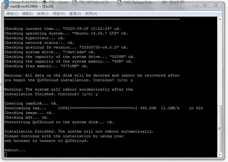

  1. Access the Linux instance using the instructions provided by the cloud platform provider.
  2. Download the QuTScloud installation tool.
    1. Open the terminal.
    2. Enter wget https://download.qnap.com/Storage/QuTScloud/installQuTS.
      The system downloads the tool.
  3. Grant execution permissions to the QuTScloud installation tool.
    1. Enter chmod +x installQuTS.
      The system changes the access permissions.
  4. Note the IP address and the MAC address of the first network card.
  5. Run the installation tool.
    1. Enter ./installQuTS.
      The system runs the installation tool.

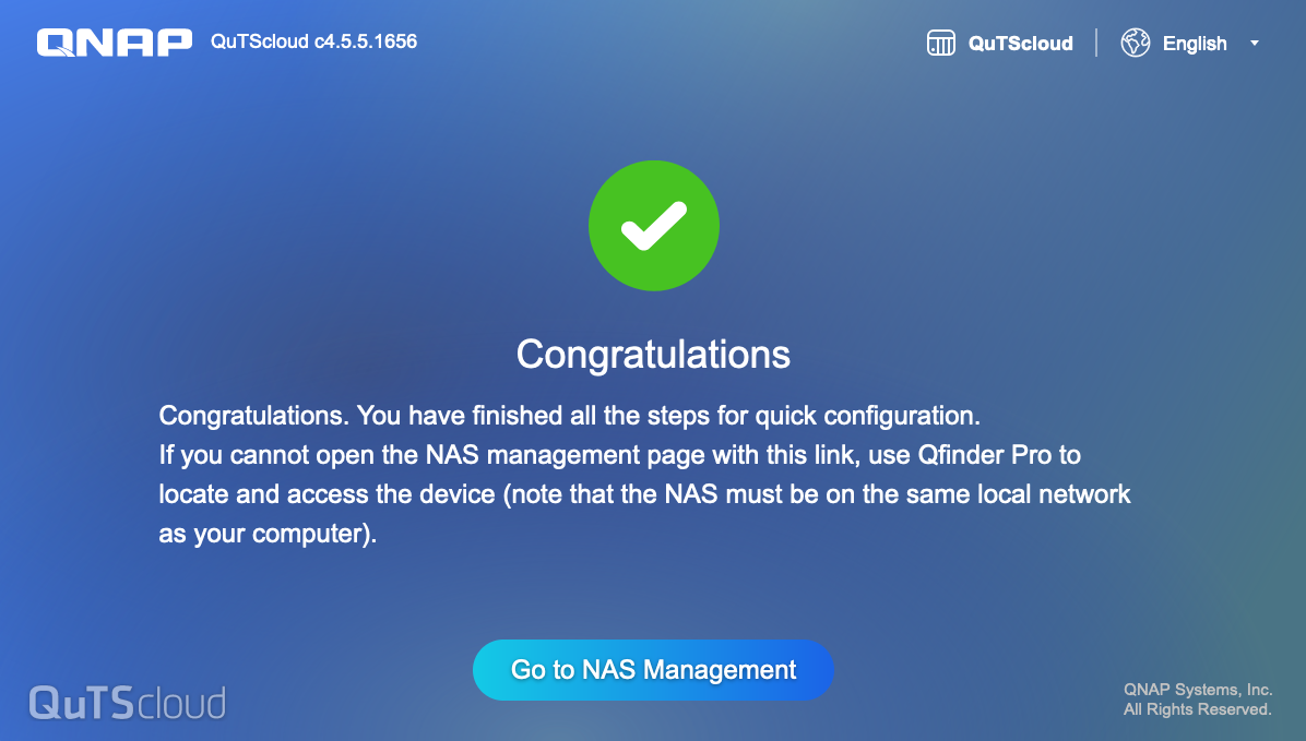

  6. Follow the instructions to finish process.
After the process completes, the system will reboot automatically. After restarting, you can access QuTScloud through your browser by using the IP address you noted earlier.

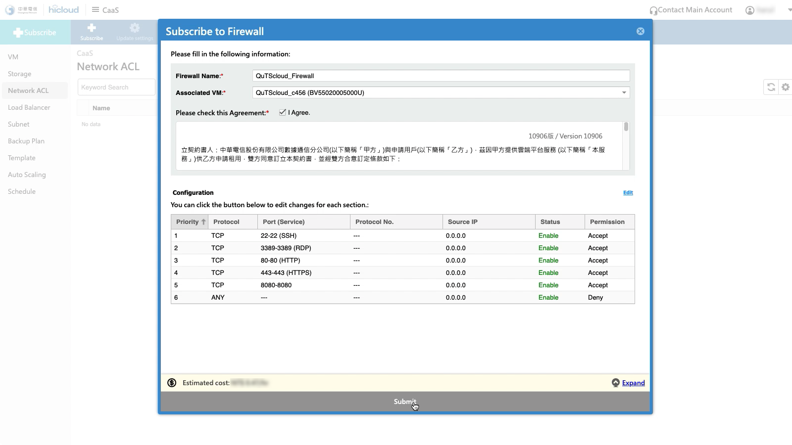

  7. Click Next: Configure Security Group.
  8. Configure instance security group.
    1. Add the following rules:
      Type
      Port Range
      Source
      SSH
      22
      Custom
      Customer TCP Rule
      8080
      Anywhere
      HTTP
      80
      Custom
      HTTPS
      443
      Custom
      Tip:
      For additional port information on QNAP services, see here.
    2. Click Review and Launch.

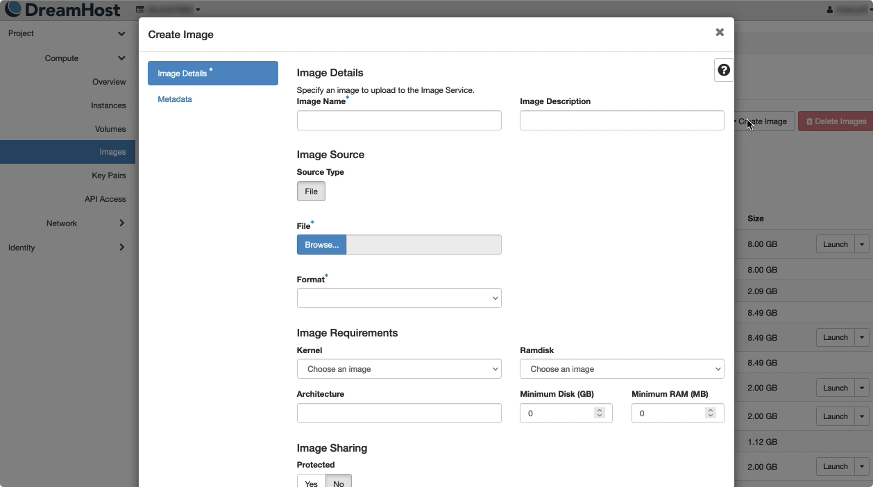

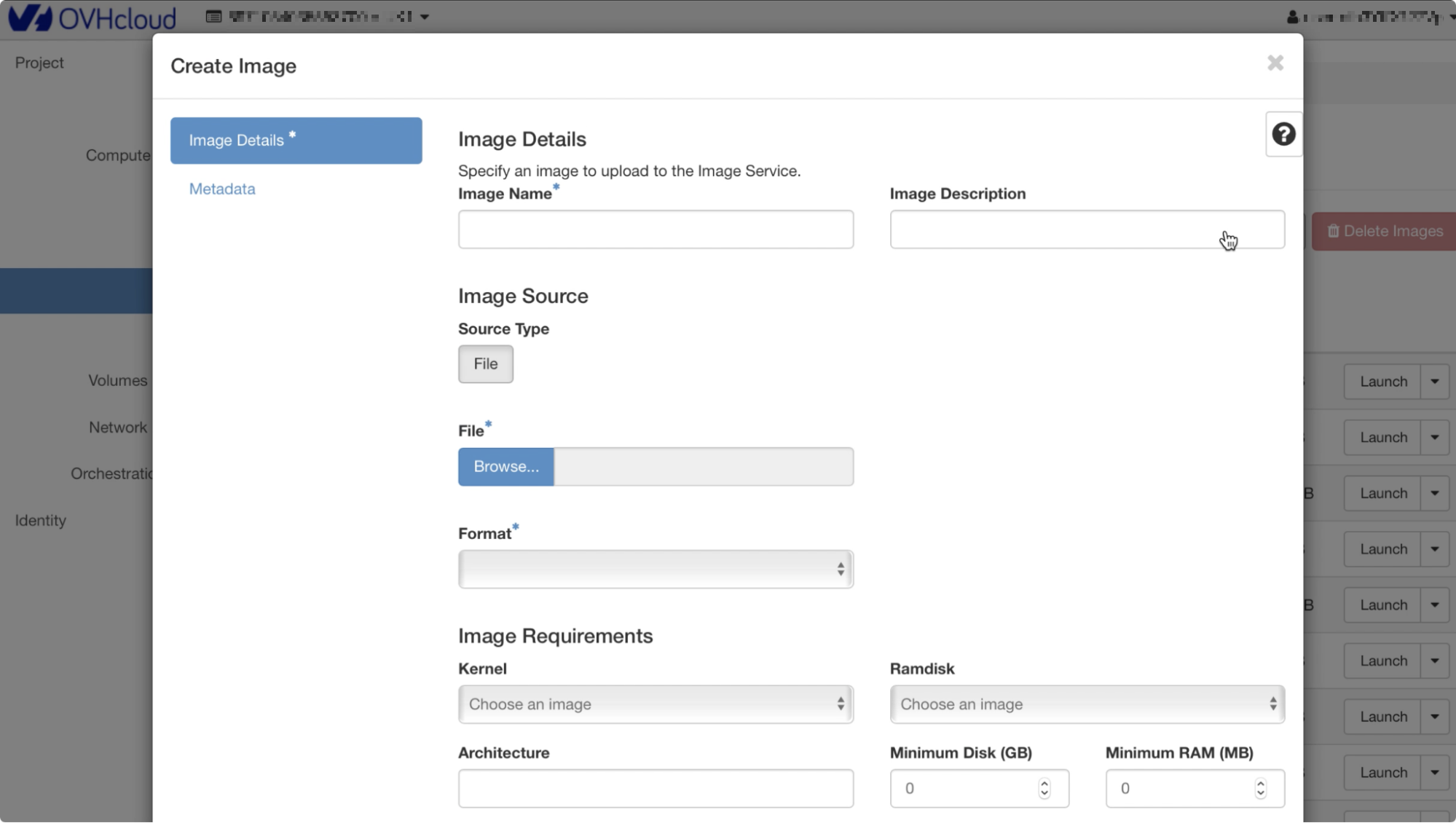

  3. Upload the QuTScloud image.

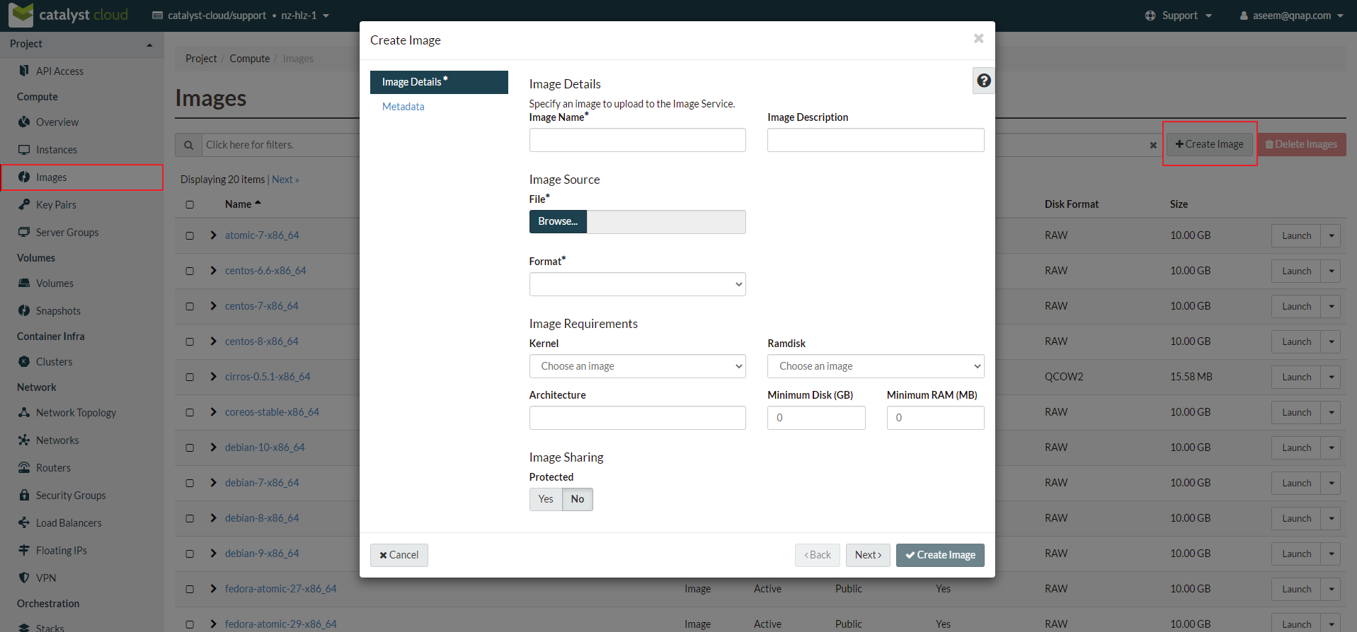

    1. Go to Images.
    2. Click Create Image.
      The Create an Image window opens.
    3. Configure the image.
      Field
      User Action
      Image Name
      Enter a name to identify the image.
      File
      Upload the image file.
      1. Click Browse.
        A file dialog window opens.
      2. Locate the image file.
      3. Click Open.
      Image Format
      Select RAW.
    4. Click Create Image.
      Catalyst Cloud processes the image.

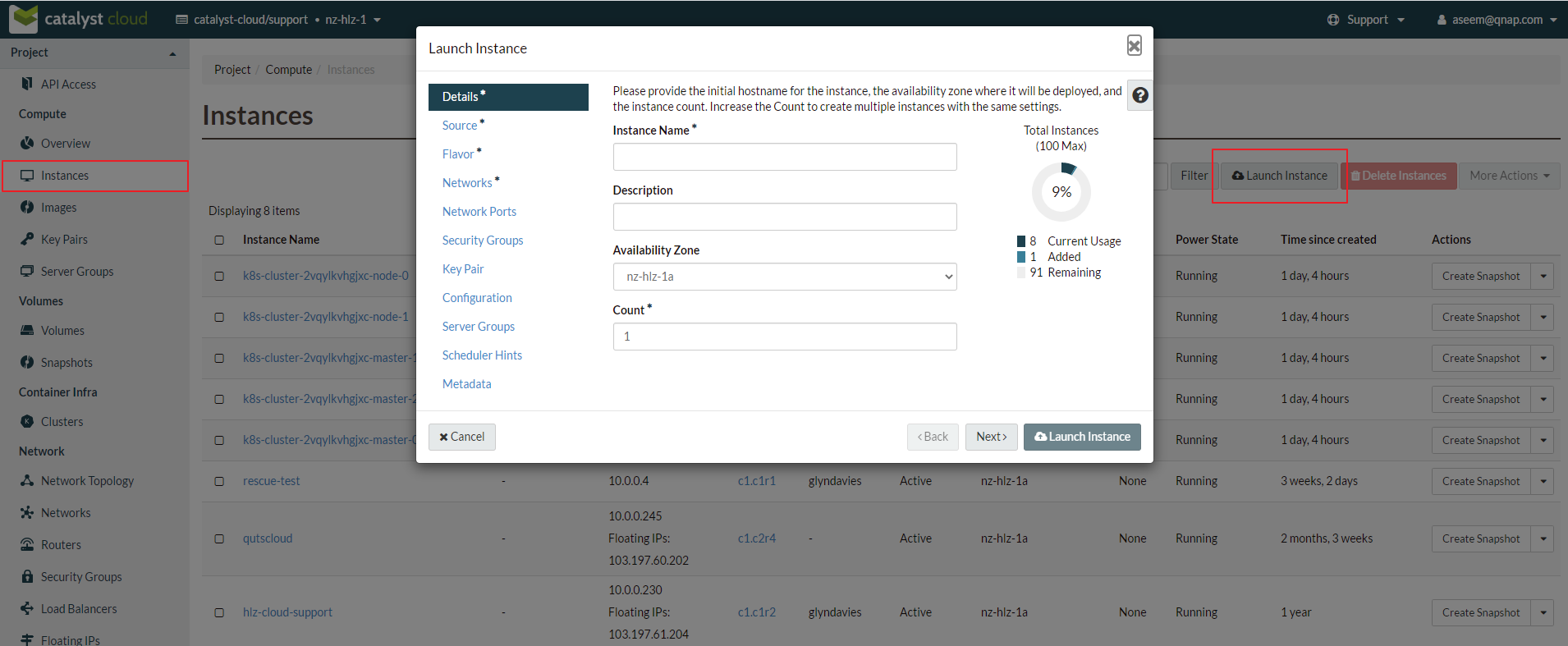

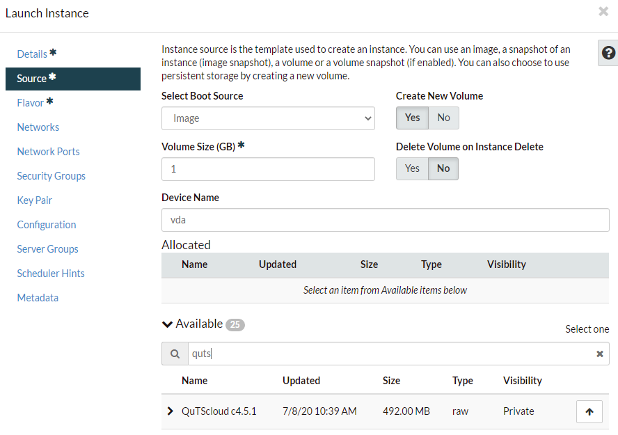

  4. Create an instance using the uploaded QuTScloud image.
    1. Go to Instances..
    2. Click Launch Instance.
      The Launch Instance window opens.
    3. Configure the Details section.
      Field
      User Action
      Instance Name
      Enter a name to identify the instance.
    4. Configure the Source section.
      Field
      User Action
      Select Boot Source
      1. Select Image.
      2. Locate the QuTScloud image in the Available section.
      Volume
      Select 1GB.
    5. Configure the Flavor section.
      Important:
      The instance must have at least 2GB of RAM available.

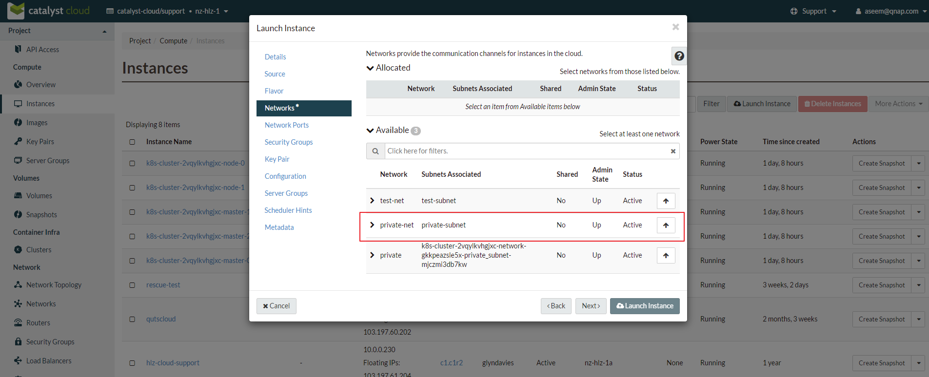

    6. Configure the Network section.
      1. Under Available, select private-net.

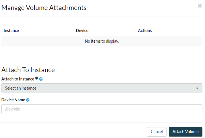

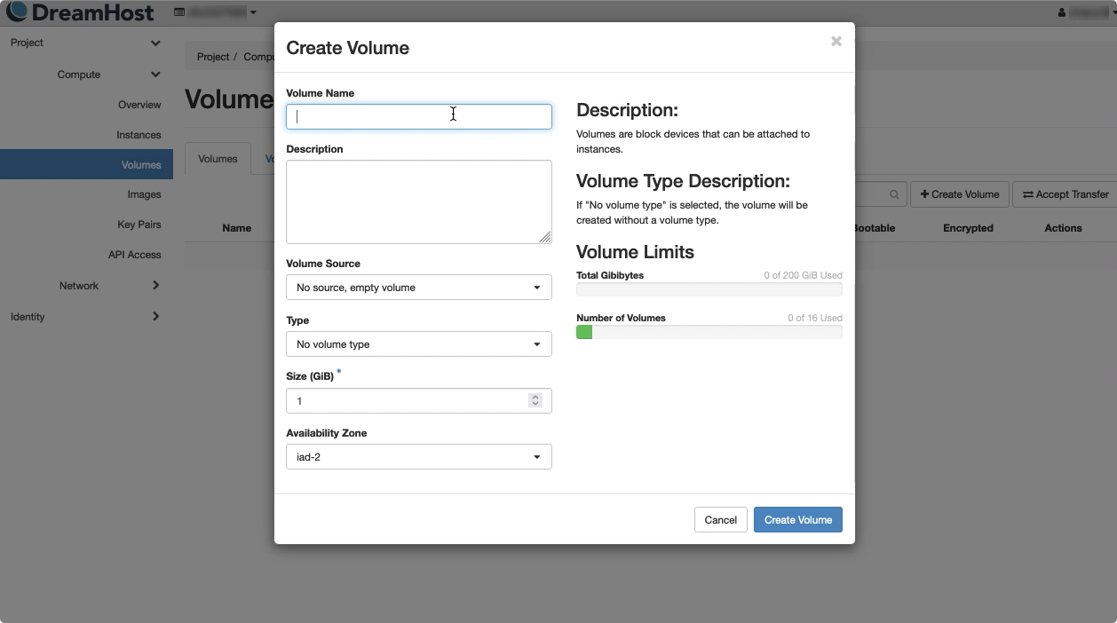

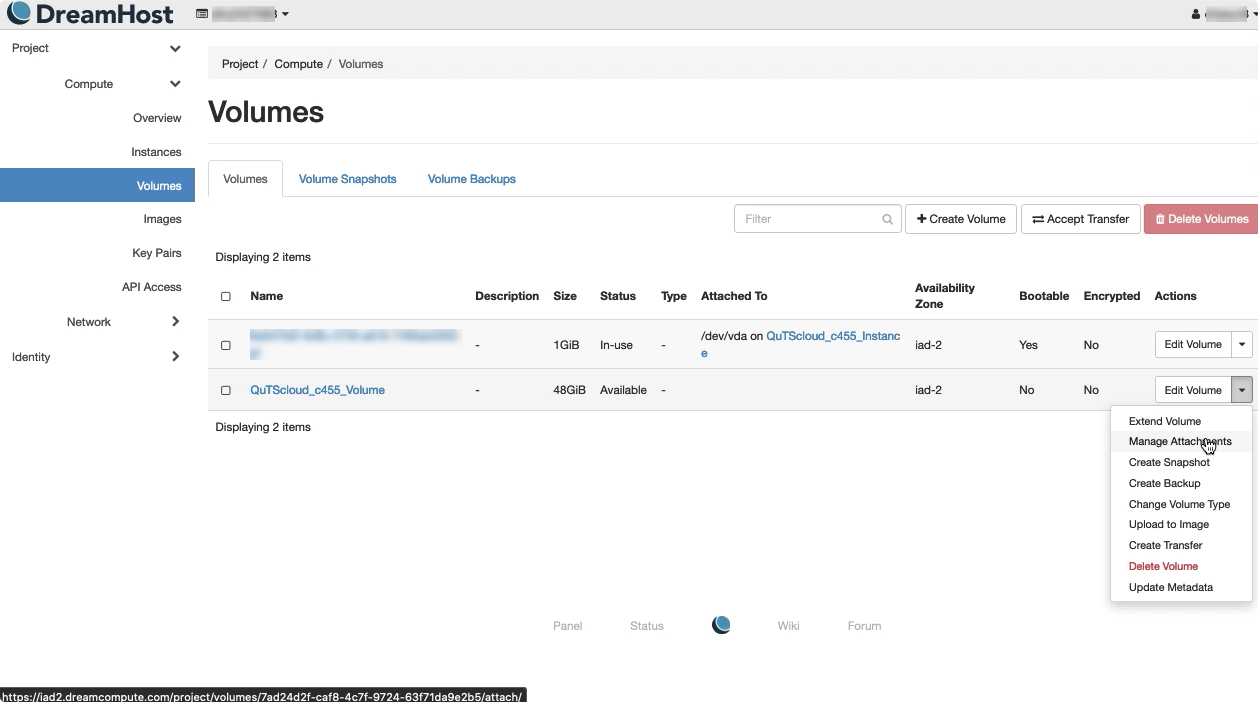

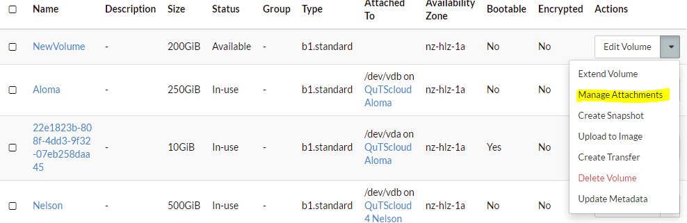

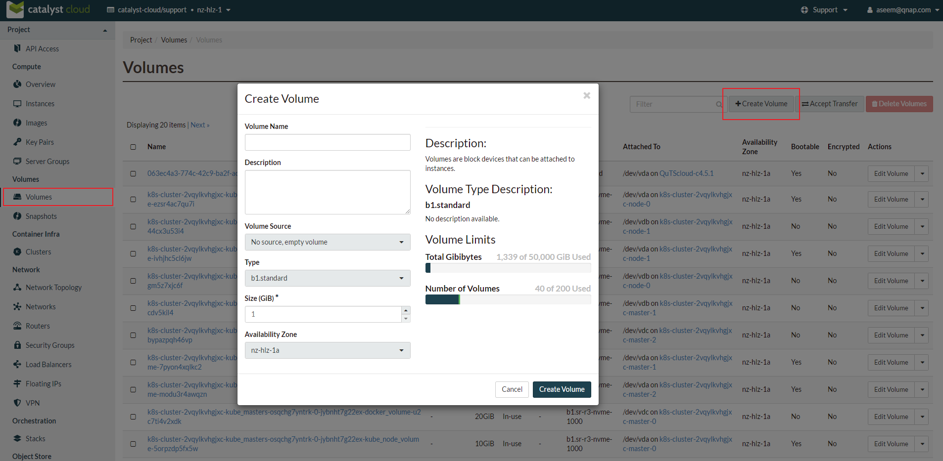

  5. Configure additional storage.
    Important:
    By default, Catalyst Cloud creates instances with a single disk (volume) attached. Unfortunately, this default volume does not contain sufficient storage for QuTScloud to operate correctly.
    QuTScloud requires at least 48GB of storage, but QNAP recommends 200GB of storage.
    1. Go to Volumes.
    2. Click Create Volume.
      The Create Volume tab opens.
    3. Configure the volume settings.
      Field
      User Action
      Volume Name
      Enter a name to identify the volume.
      Size
      Select a size for the volume.
      Important:
    4. Click Create Volume.
      Catalyst Cloud creates the volume.

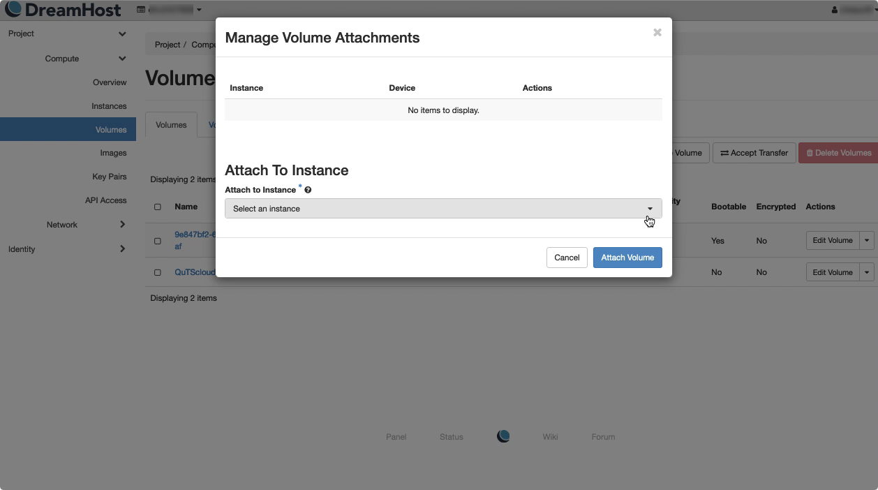

    5. Locate the created volume.
    6. Under Actions, select Manage Attachments.
      The Manage Volume Attachments window opens.
    7. Under Attach to instance, select the previously created instance.
    8. Click Attach Volume.
      Catalyst Cloud attaches the volume to the instance.

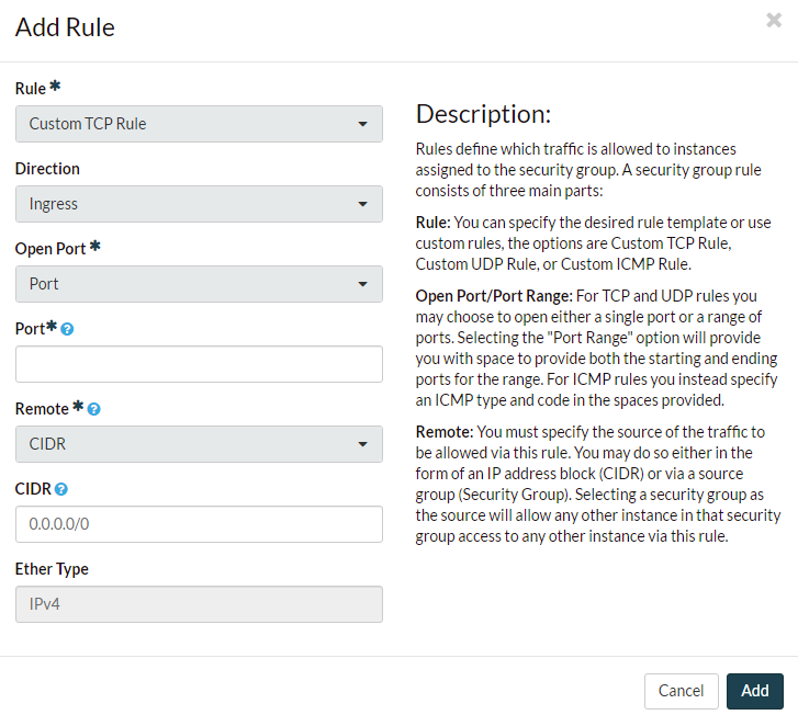

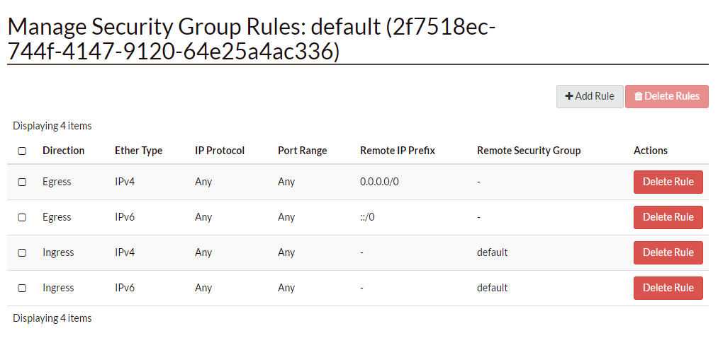

  6. Configure the firewall settings.
    1. Go to Security Groups.
    2. Identify the default security group.
    3. Click Manage Rules.
      The Manage Security Group window opens.
    4. Click Add Rule.
      The Add Rule window opens.
    5. Add inbound (ingress) rules.
      Type
      Port Range
      QuTScloud HTTPS Console
      443
      HTTP Server
      80
      QuTScloud HTTP Console
      8080
      SSH
      22
      Tip:
      Some services may require additional port rules. For example, FTP requires port 20, 21, and 55536 - 56559 for passive connections. Set the port range accordingly.
    6. Click Add.

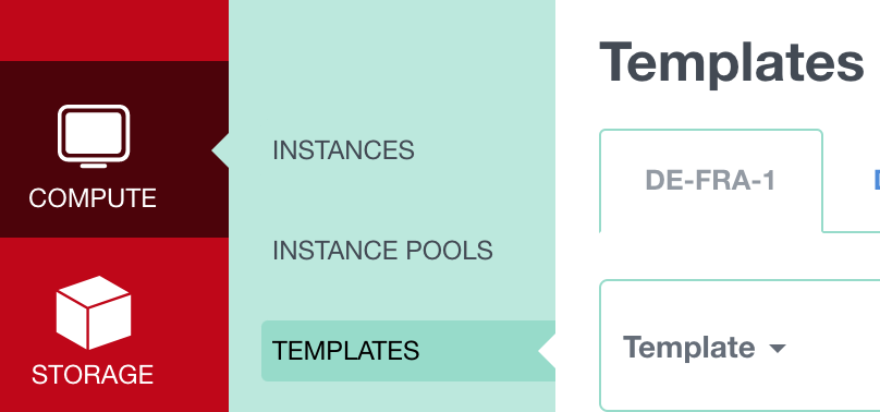

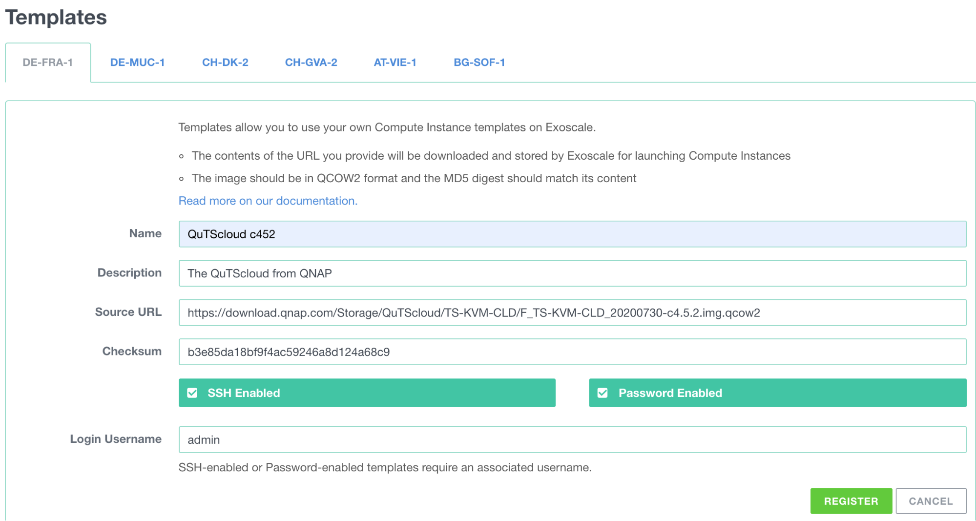

  3. Import the QuTScloud image.
    1. Go to Computer > Templates.
      The Templates window opens.
    2. Specify the template details.
      Important:
      You must repeat this process for every region you are hosting QuTScloud.
      Field
      User Action
      Name
      Enter a name to identify the template.
      Description
      Enter a description for the template.
      Source URL
      Enter the download URL you copied from the QNAP website.
      Checksum
      Enter the download checksum you copied from the QNAP website.
      SSH Enabled
      Optional: Select this option if you plan to connect over SSH.
      Login Username
      Enter a username to access QuTScloud.
      Important:
      If you have selected the SSH Enabled option, you must enter admin as the username.
    3. Click Register.
      Exoscale processes the image.

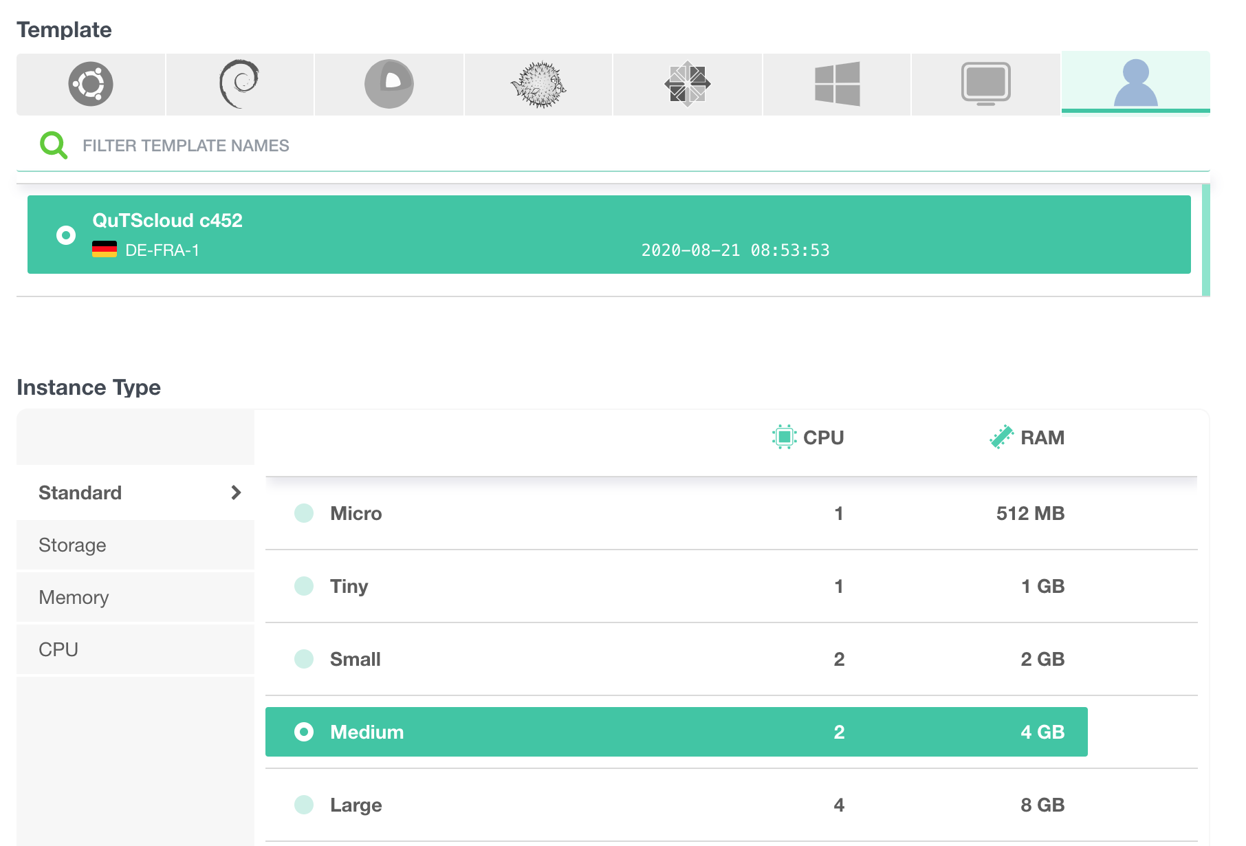

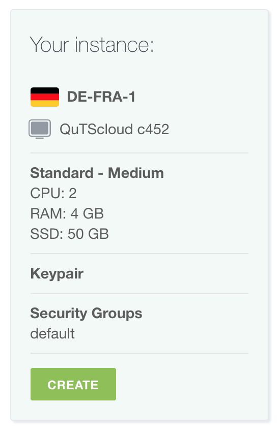

  4. Create an instance using the imported QuTScloud image.
    1. Go to Compute > Instance.
    2. Click Add.
      The Add New Instance window opens.
    3. Open the tab.
    4. Select the created QuTScloud template.
    5. Configure the instance type.
      Important:
      • The instance must have at least 2GB of RAM available.
      • QuTScloud requires at least 48GB of storage, but QNAP recommends 200GB of storage.
    6. Click Complete.
      Exoscale creates the QuTScloud instance.
      You can access QuTScloud by using the IP address displayed on the instance details page.

    5. Click Add.
      Exoscale creates the firewall rule.

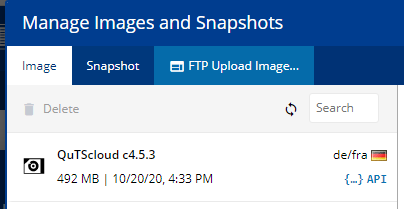

  3. Import the image.
    1. Go to Manager Resource > Image Manager.
      The Manage Images and Snapshots window opens.

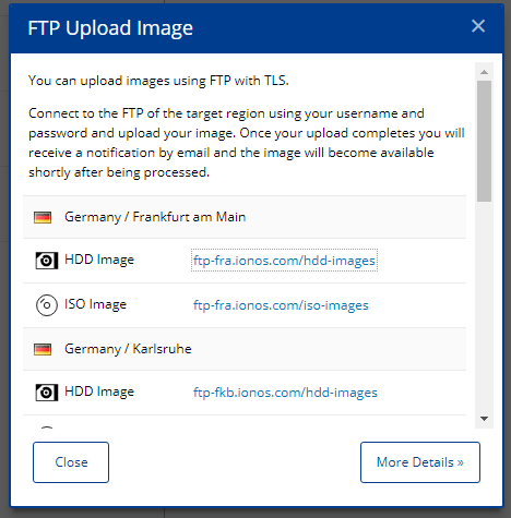

    2. Click FTP Upload Image.
      The FTP Upload Image window opens.
    3. Upload the QuTScloud VMDK image to the FTP server specified in the HDD Image field.
      Important:
      Your FTP client must support encrypted FTP to upload the image.
      IONOS processes the image file.
    4. Go to Images and select the image.

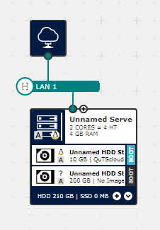

  5. Configure the data center diagram.
    Tip:
    For details, see the IONOS Online Help site.
    1. Drag a Server component onto the diagram..
    2. Click the plus and select Create and attach HDD Storage.
      The Create New Attached Storage window opens.
    3. Configure the attached storage.
      Setting
      User Action
      Name
      Specify a name for the attached storage
      Size in GB
      Specify the size of the boot disk.
      Important:
      After provisioning, it is not possible to reduce the storage size.
      Select Own Images and locate the image you uploaded earlier.
      You can create additional data disks by repeating this process and selecting No Image Selected.
      Boot from Disk
      Select Boot.
    4. Click Create.
      IONOS creates the boot disk.
    5. From the plus sign, drag a line to the Internet node.
      IONOS creates a link to the internet.
    6. Click Provision Changes.
QuTScloud begins running on the data center.
    1. Go to Images.
      The Create Image window opens.
      Field
      User Action
      Image Name
      File
      1. Click Browse.
      3. Click Open.
      Format
      Select VMDK.
      OVHcloud processes the image.

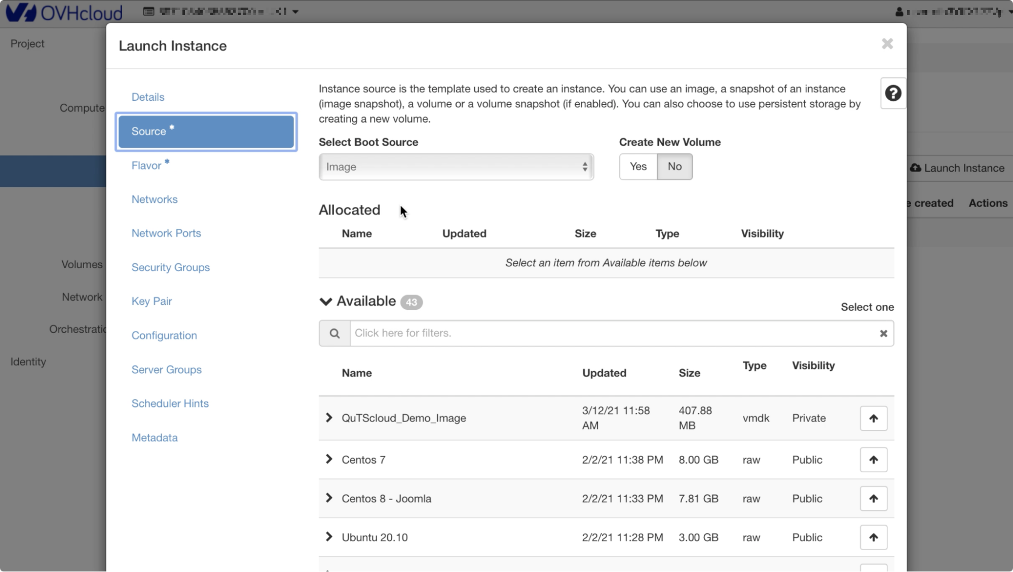

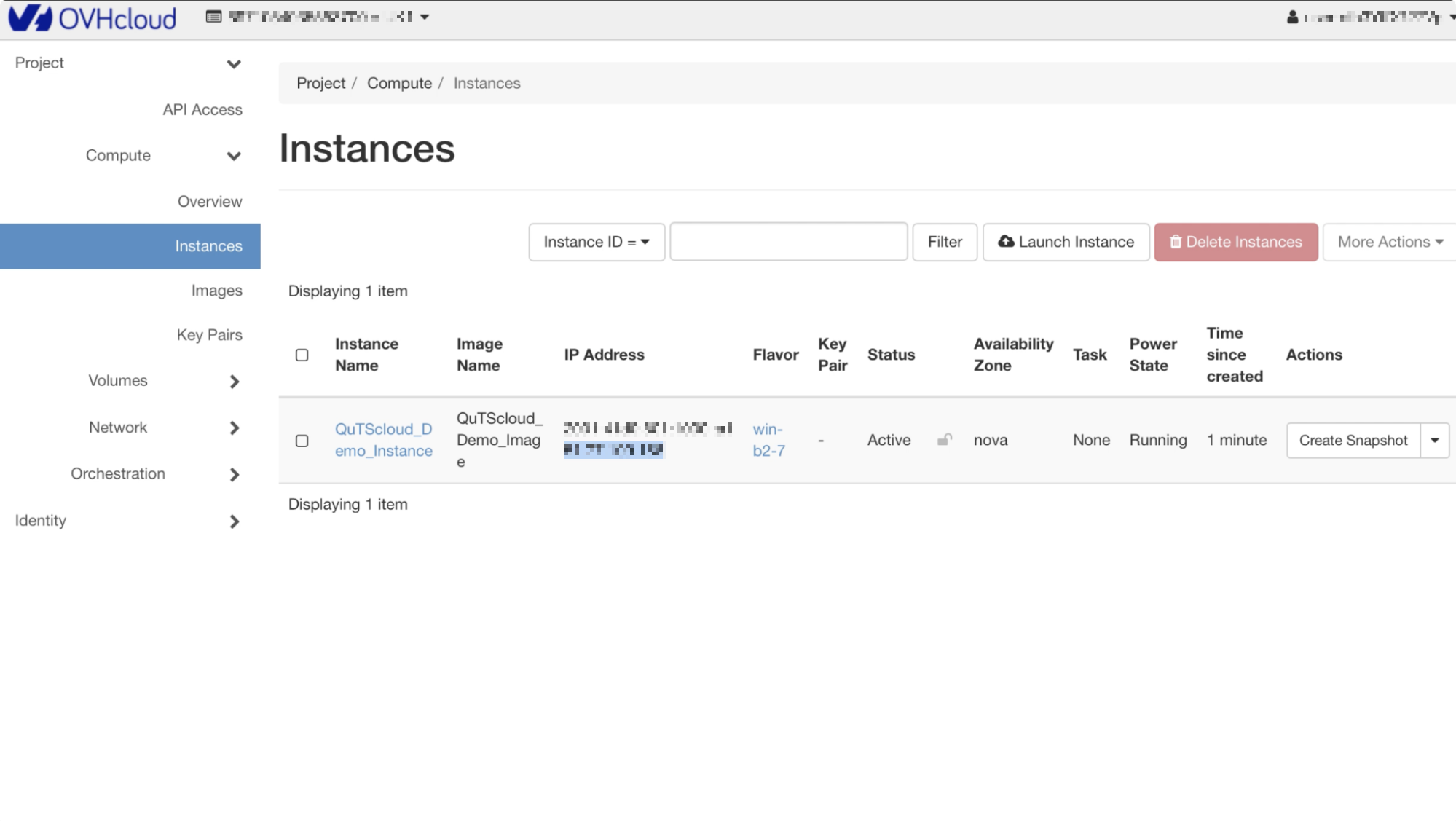

    1. Go to Instances.
      Field
      User Action
      Instance Name
      Field
      User Action
      Available
      Select the uploaded QuTScloud image.

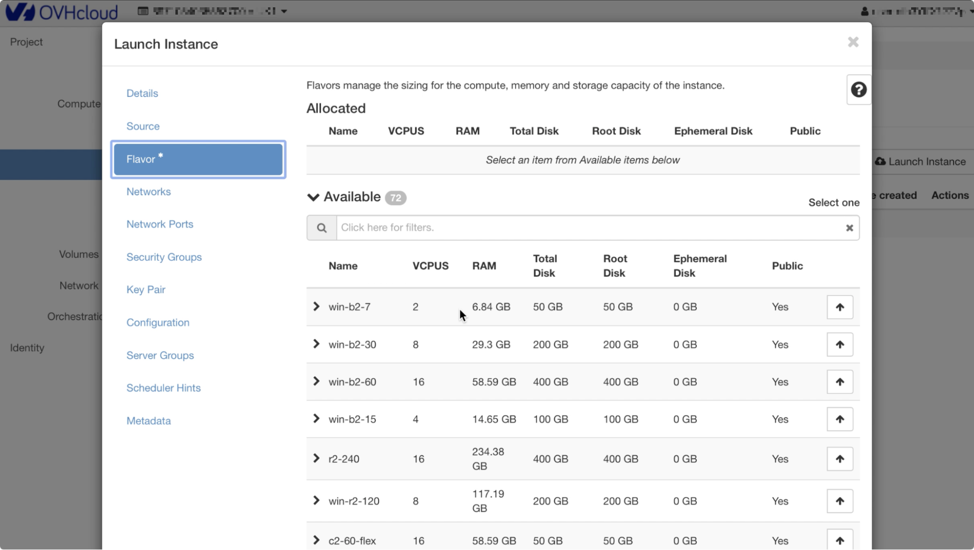

      Important:
    6. Click Create Instance.
      OVHcloud creates the instance.

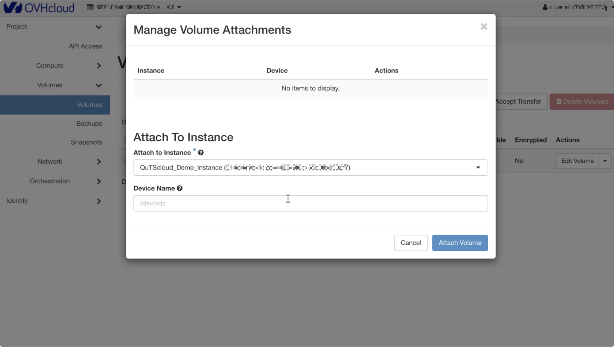

    1. Go to Volumes.
      The Create Volume window opens.
    3. Configure the volume.
      Field
      User Action
      Volume Name
      Size
      Select a size in GB for the volume.
      Important:
      OVHcloud creates the volume.
    5. Under Actions, select Manage Attachments.
    6. Under Attach to instance, select the previously created instance.
    7. Click Attach Volume.
      OVHcloud attaches the volume to the instance.
QuTScloud is accessible using the IP address displayed on the instance page.
    1. Go to Images.
      Field
      User Action
      Image Name
      File
      1. Click Browse.
      3. Click Open.
      Format
      Select RAW.
      DreamHost processes the image.

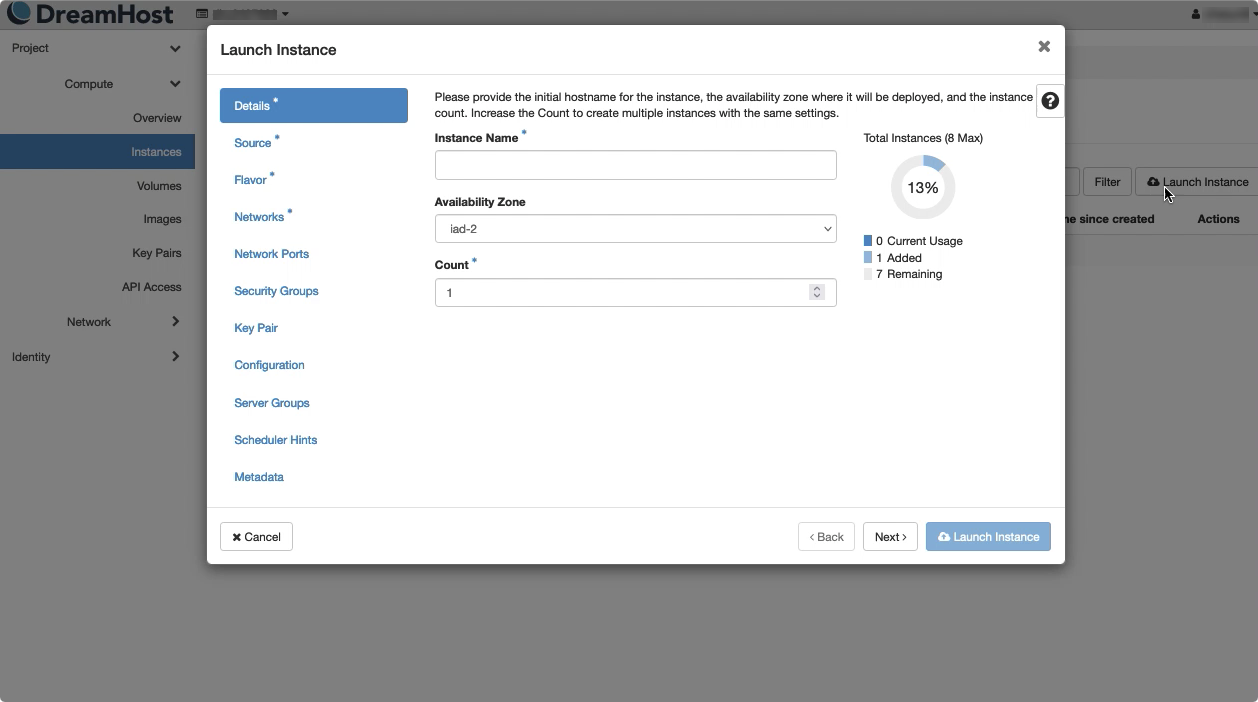

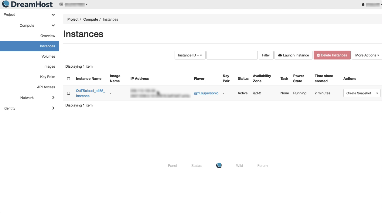

    1. Go to Instances.
      Field
      User Action
      Instance Name
      Field
      User Action
      Available

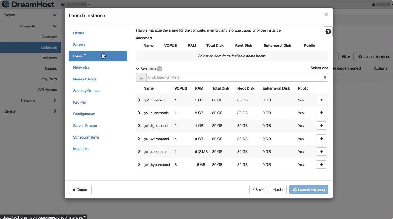

      Important:
      DreamHost creates the instance.
    1. Go to Volumes.
      Field
      User Action
      Volume Name
      Size
      Important:
      DreamHost creates the volume.
      DreamHost attaches the volume to the instance.

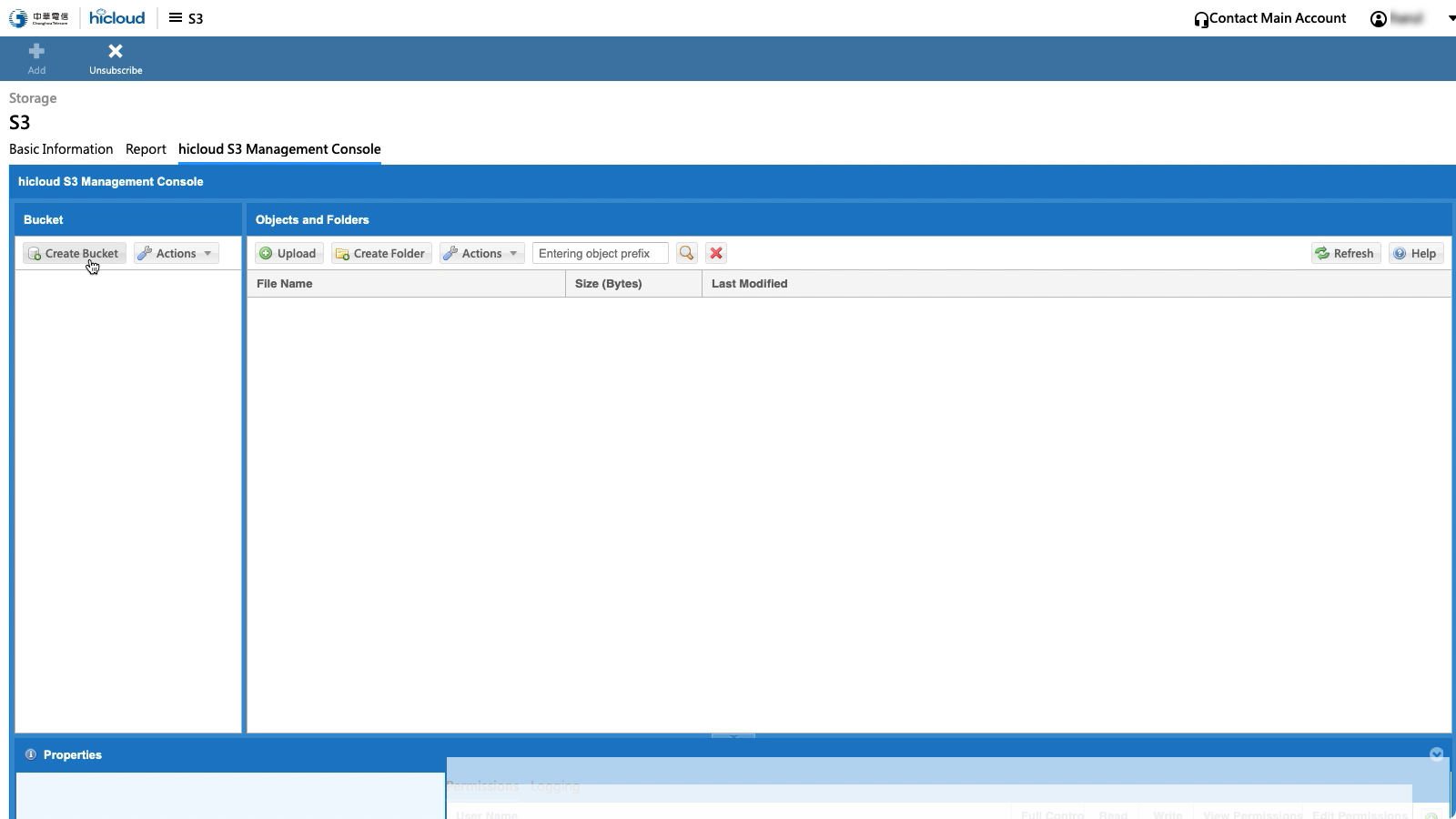

  3. Upload the image.
    1. Go to the S3 page.
    2. Click Create Bucket.
    3. Upload the QuTScloud image file.
      HiCloud processes the image.

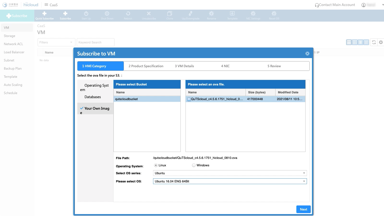

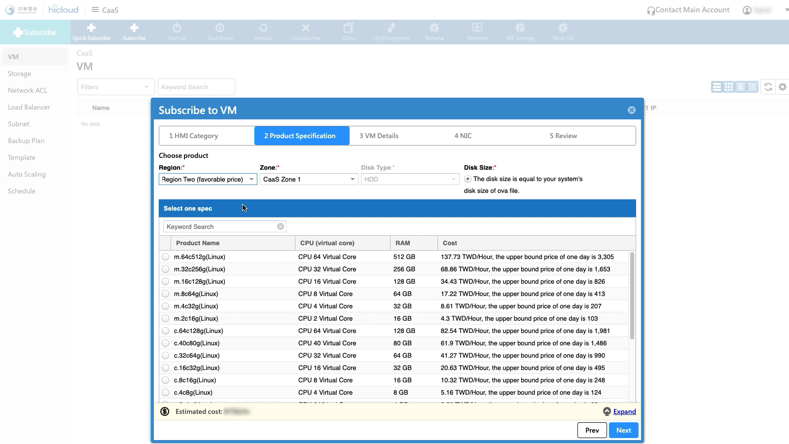

  4. Create a virtual machine using the uploaded QuTScloud image.
    1. Go to the HiCloud CaaS page.
    2. Click Subscribe.
      The Subscribe to VM window opens.
    3. Under Your Own Image, select the previously uploaded image.
    4. Specify the image details.
      Field
      User Action
      Operating System
      Select Linux.
      OS Series
      Select Ubuntu.
      OS
      Select Ubuntu 16.04 ENG 64Bit.
    5. Click Next.
  5. Configure the Product Specification.
    1. Specify the required information.
      Field
      User Action
      Region
      Select a Region.
      Zone
      Select a Zone.
      Spec
      Select a Spec.
      Important:
    2. Click Next.

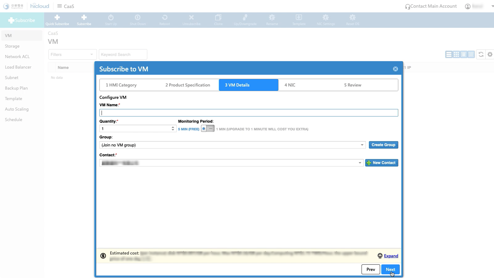

  6. Configure the VM Details.
      Field
      User Action
      VM Name
      Specify a name to identify the VM.
      Quantity
      Specify the quantity.
      Contact
      Select an existing contact, or create a new one.
    2. Click Next.
  7. Review the VM configuration.
  8. Click Finish.
    HiCloud creates the VM.

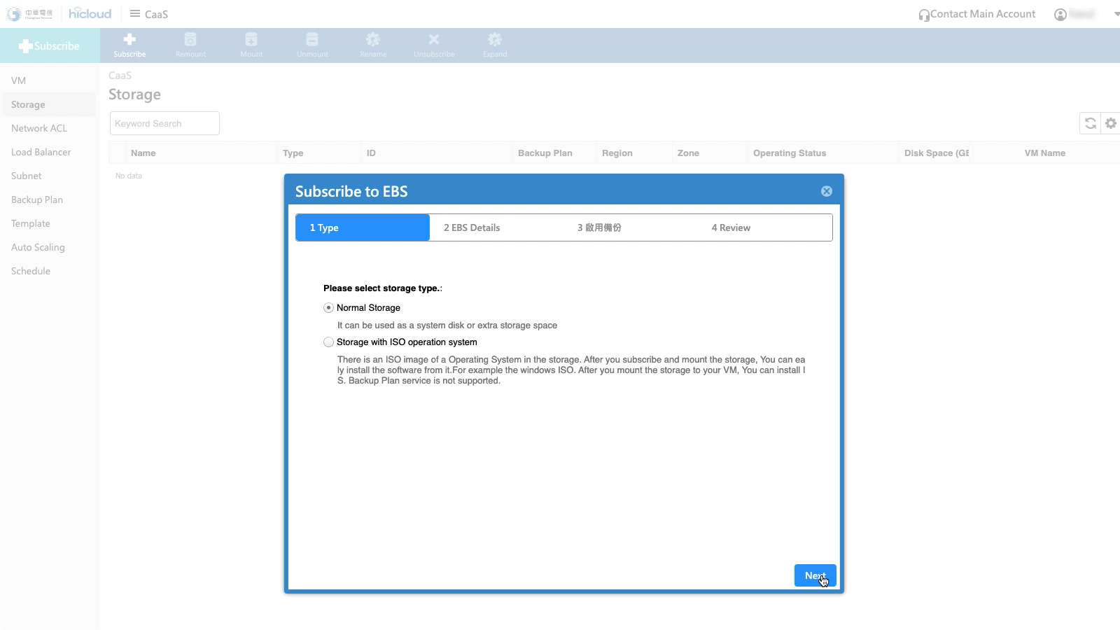

  9. Configure additional storage.
    1. Go to the Storage page.
    2. Click Subscribe.
      The Subscribe to EBS window opens.
    3. Select Normal Storage.
    4. Click Next.
    5. Configure the EBS details.
      Field
      User Action
      EBS Name
      Enter a name to identify the EBS.
      Associated VM
      Select the previously created VM.
      Amount
      Select a size in GB for the EBS.
      Important:
    6. Review the EBS configuration.
    7. Click Finish.
      HiCloud creates the volume.
  10. Configure the firewall.
    1. Go to the Network ACL page.
    2. Click Subscribe.
      The Subscribe to Firewall window opens.
    3. Configure the firewall.
      Field
      User Action
      Firewall Name
      Enter a name to identify the firewall.
      Associated VM
      Configuration
      Configure the port permission and priority.
      Important:
      QuTScloud requires port 80, 443, and 8080.
    4. Click Submit.
      HiCloud creates the firewall.

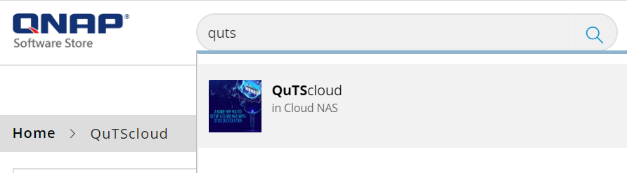

  1. Go to https://software.qnap.com.
  2. Sign in with your QNAP account.
    If you do not have a QNAP account, you must first sign up for an account.
  3. In the search box, enter QuTScloud.
    The QuTScloud license appears in the search results.

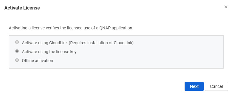

Activating a QuTScloud License Key
After purchasing a QuTScloud license, you must activate the license key from the QNAP License Manager. You are required to provide a valid license key when installing QuTScloud.
  1. Go to https://license.qnap.com.
  3. Select your QuTScloud license.
  4. Select Activation and Installation.

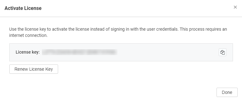

  5. Click Activate on QNAP Device.
    The Activate License window appears.
  6. Select Activate using the license key.
  7. Select Next.
    License Manager displays a license key.
  8. Copy and save the license key for later use.

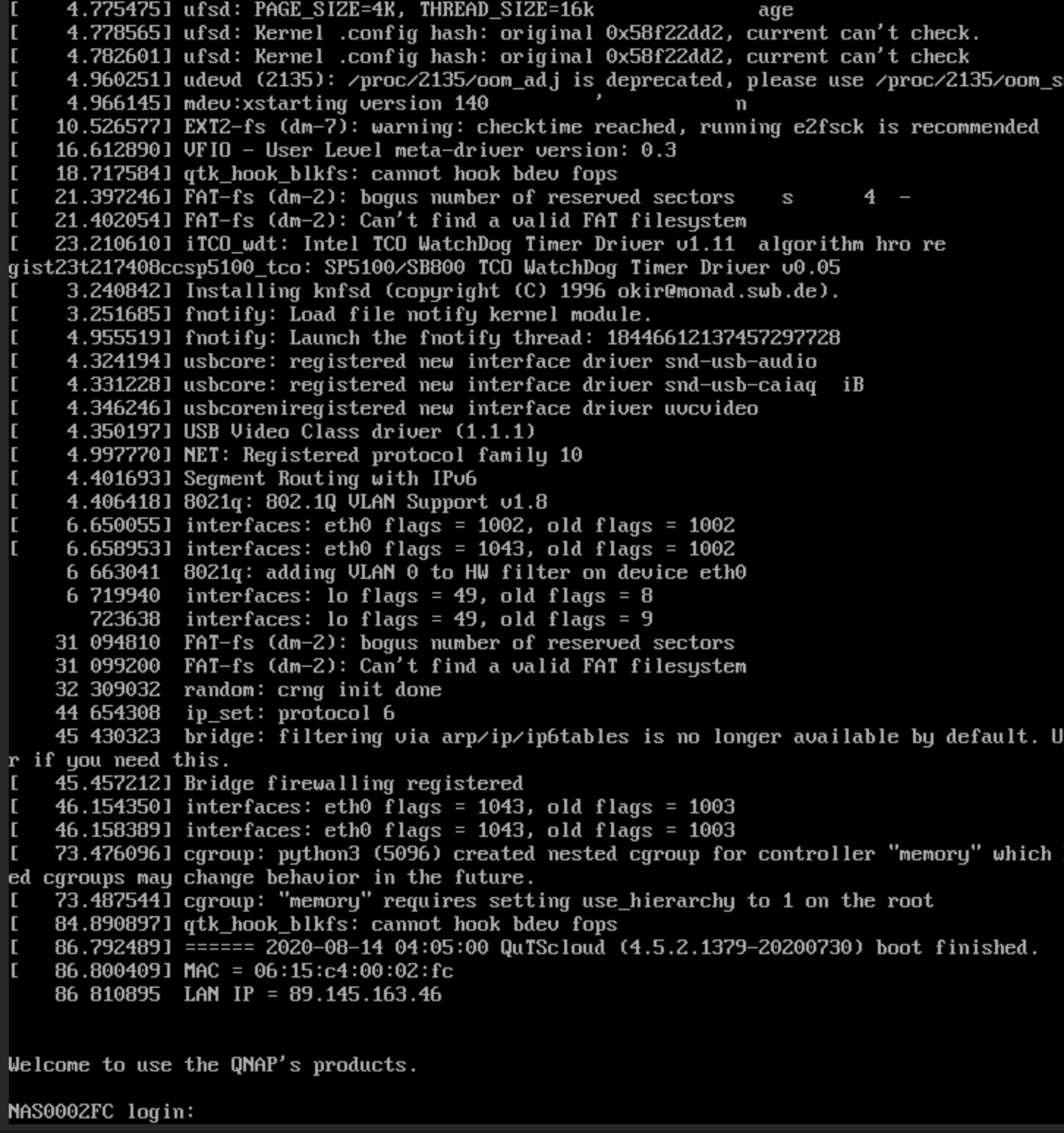

Initialize QuTScloud
The final step is to initialize QuTScloud on the platform you deployed it on earlier.
Most platforms provide console windows to emulate the keyboard, mouse and monitor attached to the QuTScloud.
After deployment, QuTScloud is usually accessible via web browser. Generally, you can locate the IP & MAC details by accessing the console output after the QuTScloud boot process completes. The IP & MAC information is displayed at the end of the boot message.
Refer to the specific deployment steps for your selected platform for details on identifying the IP and MAC address.
If QuTScloud is not initialized, you can use the default username and password outlined below.

Initializing QuTScloud
After creating and launching a QuTScloud virtual machine, you can begin setting up QuTScloud with the help of the Smart Installation wizard.
Tip:
A video tutorial for this process is available here.

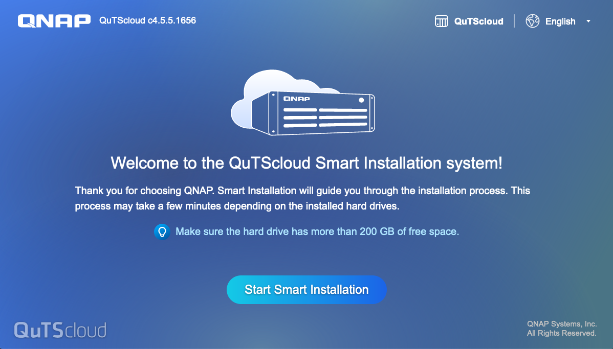

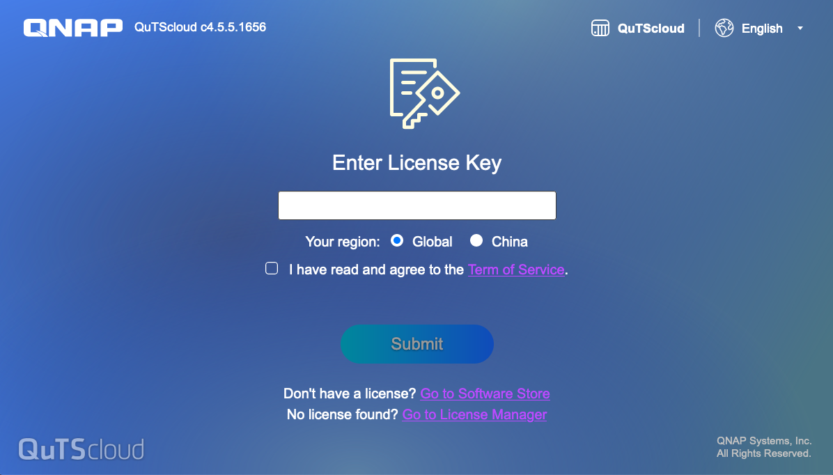

  1. Copy and paste the IP address of the QuTScloud virtual machine to your web browser.
    The Smart Installation wizard opens in your web browser.
  2. Click Start Smart Installation.
  3. Specify your QuTScloud license key.
  4. Read and agree to the Terms of Service.
  5. Click Submit.
    Important:
    Verifying a QuTScloud license requires an active internet connection.
  6. Specify the NAS name.
  7. Specify the administrator password.
  8. Confirm the password.
  9. Click Next.
  10. Review the summary of the device and account information.
  11. Click Apply.
    A confirmation message appears.
  12. Click Yes.
    QuTScloud starts initializing the system. The wizard displays the Congratulations screen after finishing the initialization.
  13. Click Go to NAS Management.
    The QuTScloud login screen appears.
  14. Enter your username and password.
  15. Click Login.

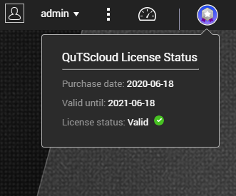

    The QuTScloud desktop opens in your web browser. You can click on the top-right corner to check your QuTScloud license status.
QuTScloud is now ready for use. You can start creating storage pools, volumes, and shared folders to start benefiting from the various features of QuTScloud.
To learn more about how to use QuTScloud, refer to the QuTScloud User Guide at http://docs.qnap.com.
