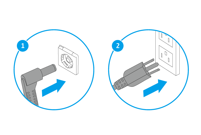

To avoid this issue, QNAP recommends the following solutions:
Connecting the device to a power outlet
  1. Connect the DC connector of the adapter to the power input of the device.
  2. Connect the AC connector of the adapter to the AC power outlet.

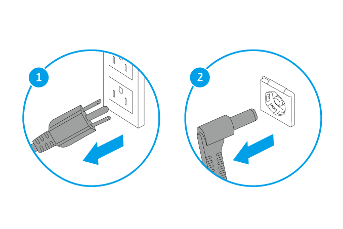

Disconnecting the device from a power outlet
  1. Disconnect the AC connector of the adapter from the AC power outlet.
  2. Disconnect the DC connector of the adapter from the power input of the device.
