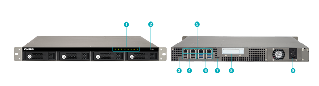

1. LED Indicators:
10 GbE, Status, LAN, Storage Expansion Port Status
6. USB 3.2 Gen 1 Port x 4
2. Power Button 7. HDMI™
3. Password & Network Settings Reset Button 8. Expansion Slot
4. USB 2.0 Port x 4 9. Power Connector
5. Gigabit LAN x 4
