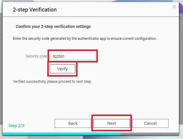

At this point, to make sure the input security code is correct, you may click on the button "Verify", then it will give you the message of "Verified successfully", and then it is the time to go on by clicking on the "Next" button to finalize the setup of the 2-step verification, as it is showed on the next picture below.

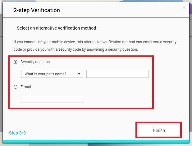

You will be requested to setup a security question or an email, to have an alternative method of authentication, in case you have no access to your phone, for example.

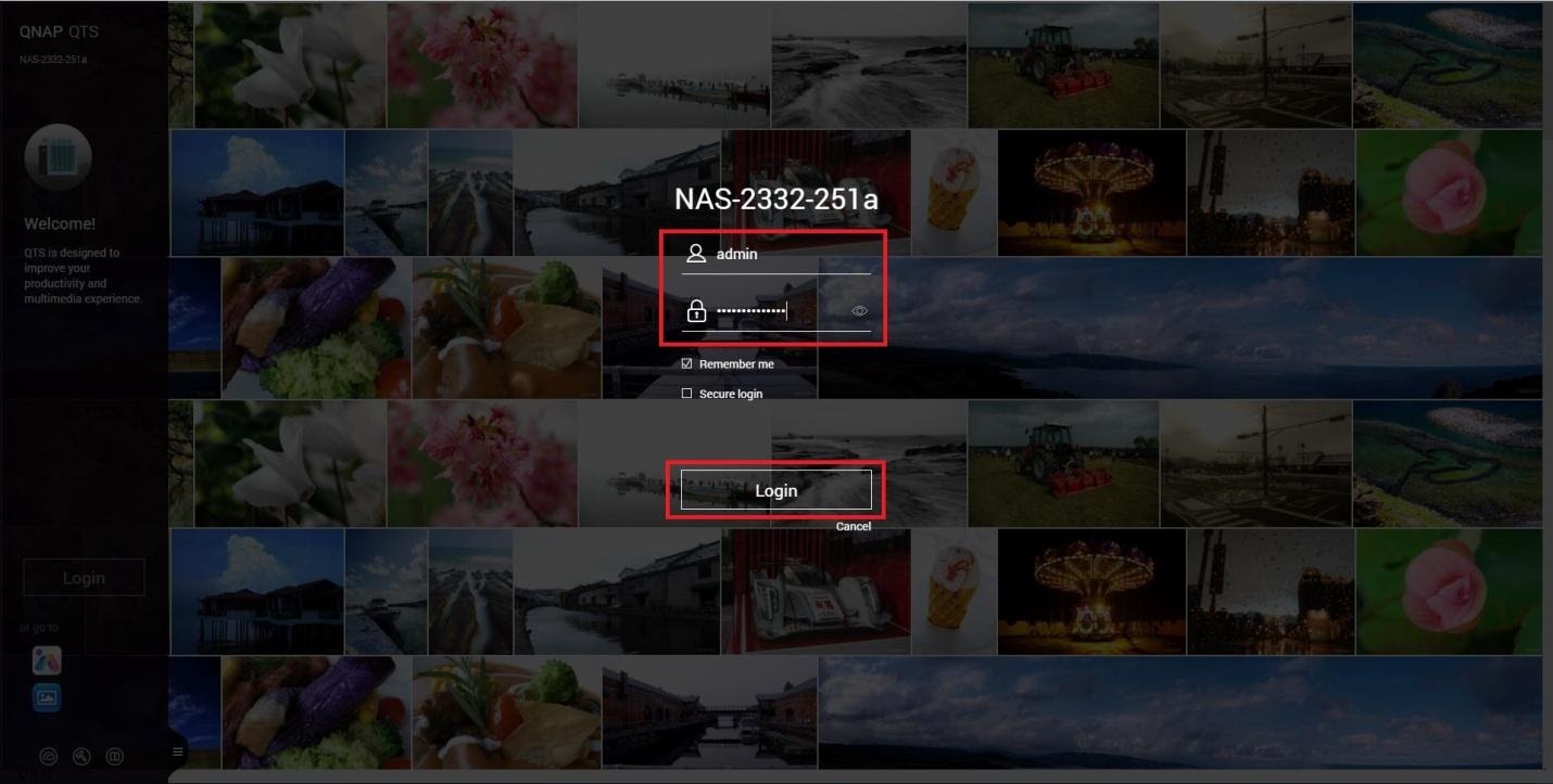

Later, once you click on the "Finish" button, the NAS should automatically logout in 5 seconds, so you can login again, but this time with the 2-step verification enabled. First step will be a simple login, using your user account and password, as showed on the picture below.

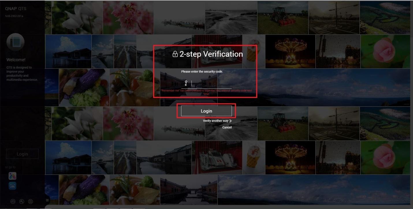

Then the second step will be the requested security code showed on the authenticator app that you have chosen to use for this purpose, refer to the picture below.
