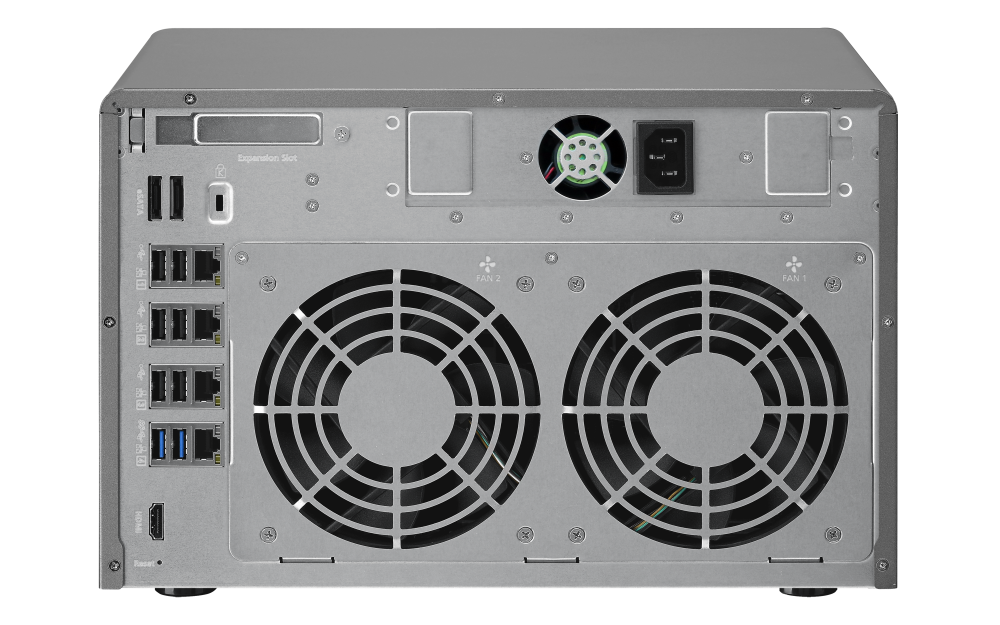

1. LED Indicators:
Status, LAN, USB, eSATA, 10 GbE, LAN
10. PCIe Slot x1
2. HDD Status LED 11. USB 2.0 Port x6
3. Select Button 12. Password & Network Settings Reset Button
4. Enter Button 13. USB 3.2 Gen 1 Port x2
5. Tray Lock 14. K-Lock Security Slot
6. Tray Release Button 15. Gigabit LAN Port x4
7. One Touch Copy Button/ USB 3.2 Gen 1 Port 16. Power Connector
8. Power Button 17. HDMI™ x1
9. eSATA Port x2
