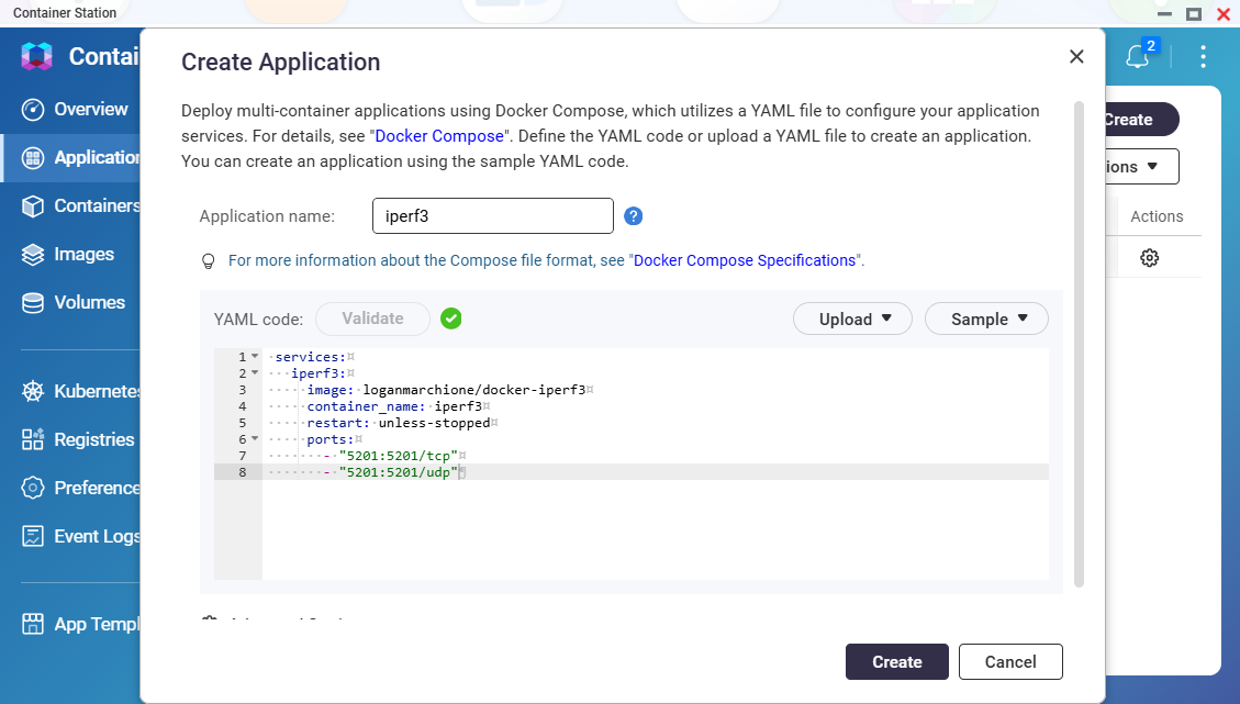

  3. In Container Station, select Create > Create Application, then enter the following Docker Compose configuration:
    services:
      iperf3:
        image: loganmarchione/docker-iperf3
        container_name: iperf3
        restart: unless-stopped
        ports:
          - "5201:5201/tcp"
          - "5201:5201/udp"
    Refer to the documentation for the loganmarchione/docker-iperf3 image for its supported environment variables and parameters. To have the NAS act as the iPerf3 client rather than the server, or to use host network mode for more accurate results, adjust the configuration accordingly.
  4. Click Validate to verify the correctness of the yaml code.

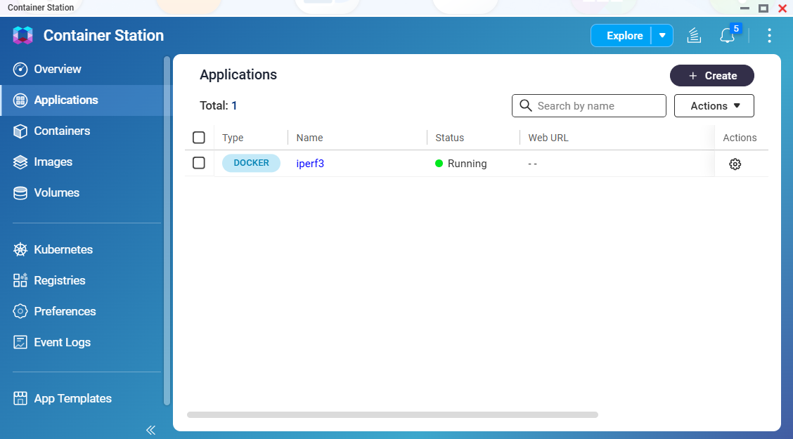

  5. Click Create and wait for the image to be pulled and the container to start.
  6. Confirm the container status is Running.
  7. iPerf3 is now ready to use on your NAS.

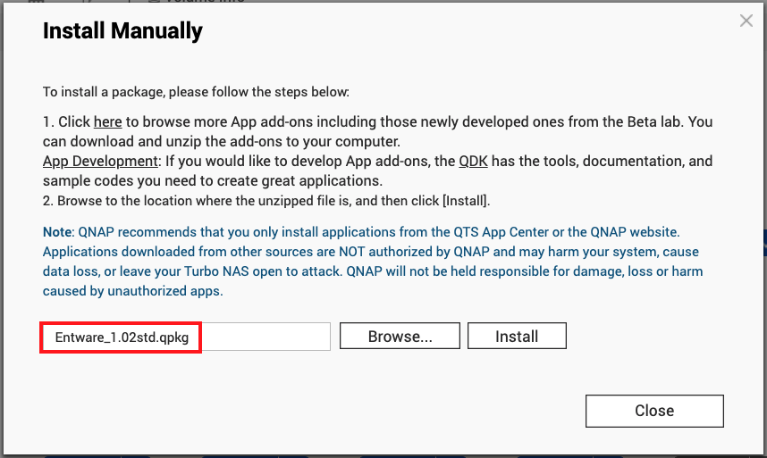

  2. Install the QPKG file:
    • Open the App Center
    • Select Install Manually
    • Click Browse and locate the downloaded QPKG file
    • Click Install
    • Accept the risk acknowledgment checkbox and confirm installation
    • Verify that Entware-std 1.02 appears in the App Center

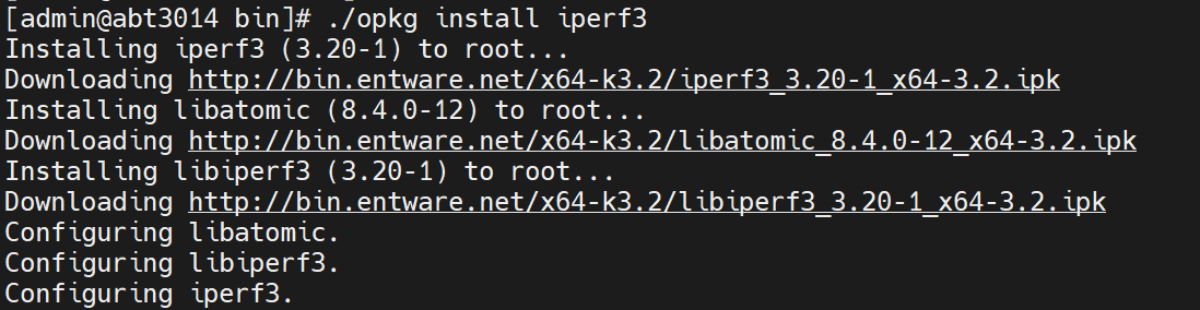

  3. Access the NAS command line via an SSH connection.
  4. Navigate to the Entware installation directory:
    # cd /share/CACHEDEV1_DATA/.qpkg/Entware/bin
    The volume name in this path varies by model and storage configuration, and differs on QuTS hero systems. If the directory does not exist, locate it with:
    # ls -d /share/*/.qpkg/Entware/bin

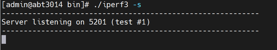

  5. Execute the package installation command:
    # ./opkg install iperf3
6. iPerf3 is now ready to use on your NAS.
