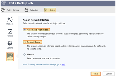

2. Check if the NAS has 2 or more network connections, and verify if the connections are in the same network subnet.
  • In the HBS, select the backup job and click edit .
  • Select the “Rules”   tab, then under the Rules page, select “Network”
By default, this option is set to “Automatic”, in which the backup job traffic will route into the least busy network (Network adapter not set as System Default Gateway) in the Network & Virtual Switch > Network > Interfaces. If the second connection is not added in the allowed connections (as described in step 3 below), the job would not complete.
  • Select the Default Route Option and Save the changes of the backup job.
  • Run the Backup and confirm
If the Backup completed without a problem; check the remote NAS HBS settings.
