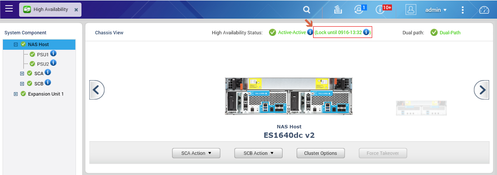

The HA status of the High Availability page is shown as “Locked util ....”. How to resume it to normal status?
Solution:
To solve it and resume it to normal status. You can try steps below:

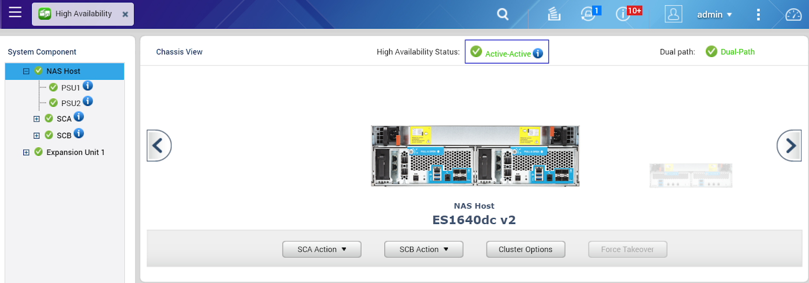

  1. Login NAS command prompt via SSH.
  2. Run the command (cf unlock) below to unlock it.
  1. Then the HA status will resume to normal status
