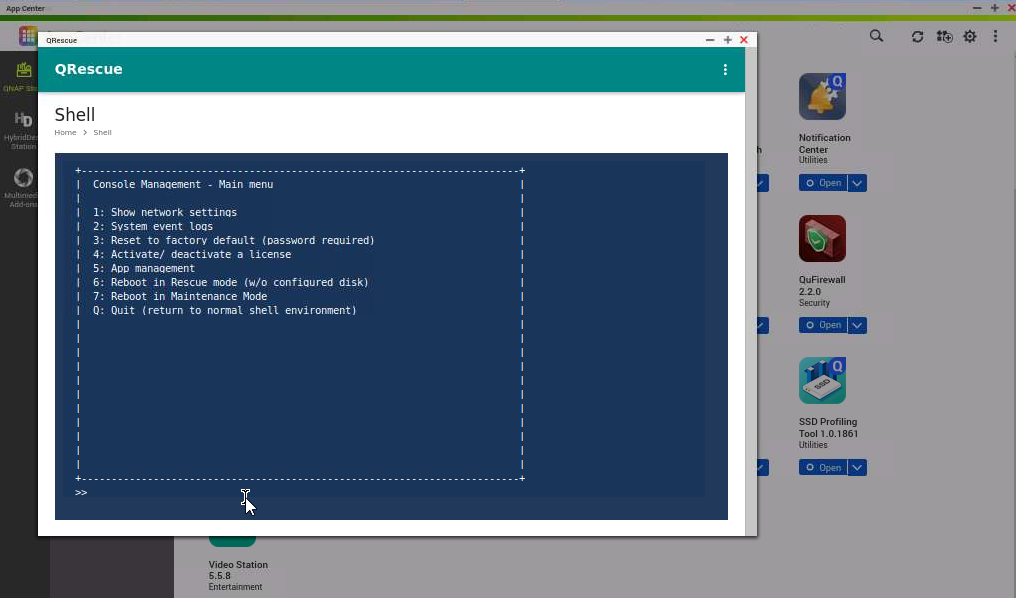

In the app center the Qrescue open button is not displayed and you cannot run Qrescue. img

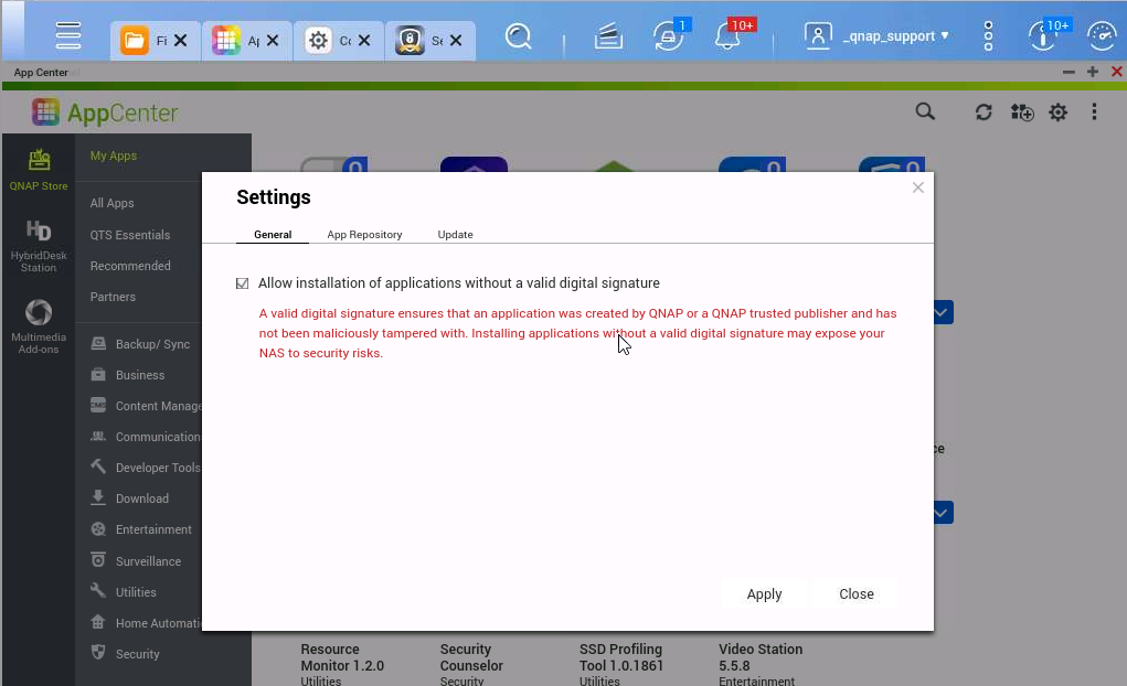

it is allowed to install app without valid signature

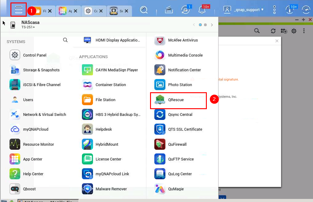

Also, when you click on the icon not possible to run it
In this case you have to run it from the men
