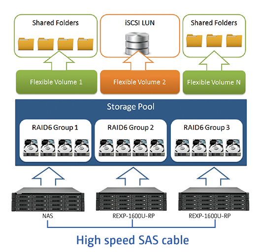

QNAP Flexible Volume
The disks, RAID Groups, storage pools, and volumes in the RAID expansion enclosures are configured via the QTS operating system.
  1. Support for multiple RAID groups in a storage pool to ensure data safety
  2. Online storage pool expansion
  3. Online volume expansion
  4. Block-based iSCSI LUN
  5. Support for thin-provisioned volume with space reclamation
  6. Support for thin-provisioned iSCSI LUN with space reclamation
QNAP Flexible Volume Architecture
Intelligent Storage Manager
