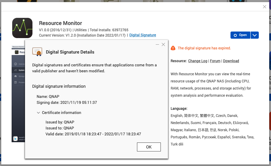

    1. Click "Digital Signature".
      The Digital Signature Details window opens.
    2. Find "Issued by"
      • If the app is Issued by QNAP
        • Click the Update button to update the app.
        • If you can't find the update button, upgrade QTS/QuTS hero to the latest version.
          Note: The app with no update/remove button is a built-in system application, updating the app requires upgrading the QTS/QuTS hero firmware.
        • Contact QNAP support if you have tried upgrading the QTS/QuTS hero firmware.
      • If the app is Issued by Third Party, contact the Application Author to renew their digital signature.
        • Update the QTS/QuTS hero firmware since Third Party Digital Signature starts to support after QTS/QuTS hero 5.0.1.
        • Contact Third Party Application Author to renew the Digital Signature
