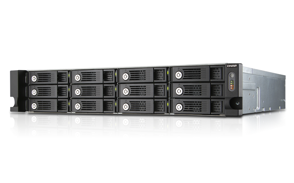

TVS-1271U-RP Specification
CPU TVS-1271U-RP-PT-4G: Dual-core Intel® Pentium® G3250 3.1 GHz Processor
TVS-1271U-RP-i3-8G: Dual-core Intel® Core™ i3-4150 3.5 GHz Processor
TVS-1271U-RP-i5-16G: Quad-core Intel® Core™ i5-4590S 3.0 GHz Processor
TVS-1271U-RP-i7-32G: Quad-core Intel® Core™ i7-4790S 3.2 GHz Processor
DRAM TVS-1271U-RP-PT-4G
System memory: 4 GB DDR3 RAM
Memory module pre-installed: 2 GB x2
Total memory slots: 4
Memory expandable up to: 32 GB (8GB x4)
Note: When upgrading RAM to more than 20GB, the original 2GB RAM modules must be removed.
TVS-1271U-RP-i3-8G:
System memory: 8 GB DDR3 RAM
Memory module pre-installed: 4 GB x2
Note: When upgrading RAM to more than 24GB, the original 4GB RAM modules must be removed.
System memory: 16 GB DDR3 RAM
Memory module pre-installed: 8 GB x2
TVS-1271U-RP-i7-32G
System memory: 32 GB DDR3 RAM
Memory module pre-installed: 8 GB x4
For the information of RAM module installation and compatible NAS models, please refer to the QNAP RAM Module Installation Guide
Flash Memory 512MB DOM
Internal Cache Port Two mSATA port on board for read caching
Note: The standard system is shipped without mSATA flash module. For the optional mSATA flash module, please visit http://shop.qnap.com/
Hard Drive 12 x 3.5-inch SATA 6Gb/s, SATA 3Gb/s hard drive or 2.5-inch SATA, SSD hard drive
NOTE:
1. The standard system is shipped without hard drives.
2. For the hard drive compatibility list, please visit www.qnap.com/compatibility
Hard Disk Tray 12 x hot-swappable and lockable tray
LAN Port 4 x Gigabit RJ-45 Ethernet port
(Expandable up to 8 x 1 Gb LAN or 4 x 10 Gb + 4 x 1 Gb LAN by installing optional dual-port 10 Gb and 1 Gb network card)
1. For the optional network card compatibility list, please visit www.qnap.com/compatibility
2. For the information of network card installation, please refer to chapter 6 in the Turbo NAS Hardware Manual.
LED Indicators Status, 10 GbE, LAN, storage expansion port status
USB/eSATA 4x USB 3.2 Gen 1 port (rear)
4x USB 2.0 port (rear)
Support USB printer, pen drive, USB hub, and USB UPS etc.
HDMI™ 1
Buttons System: Power button and reset button
Alarm Buzzer System warning
Form Factor 2U, Rackmount
Dimensions 89(H) x 482(W) x 534(D) mm
3.5(H) x 18.98(W) x 21.02(D) inch
Weight 16.14 kg/ 35.58 lb (Net)
18.98 kg/ 41.84 lb (Gross)
Power Consumption (W) HDD Standby:
TVS-1271U-RP-PT-4G: 88.88
TVS-1271U-RP-i3-8G: 87.89
TVS-1271U-RP-i5-16G: 88.91
TVS-1271U-RP-i7-32G: 89.82
In Operation:
TVS-1271U-RP-PT-4G: 173.38
TVS-1271U-RP-i3-8G: 176.27
TVS-1271U-RP-i5-16G: 174.64
TVS-1271U-RP-i7-32G: 176.42
(with 12 x WD WD20EFRX hard drive installed)
Sound Level* Sound pressure (LpAm): 45.0 dB(A)
Temperature 0~40˚C
Relative Humidity 5~95% non-condensing, wet bulb: 27˚C.
Power Supply Input : 100-240V~, 50-60Hz, 7A-3.5A
Output: 500W
PCIe Slot 2 (1* PCIe Gen3 x8, 1* PCIe Gen3 x4)
Fan 3 x 7 cm smart cooling fan
