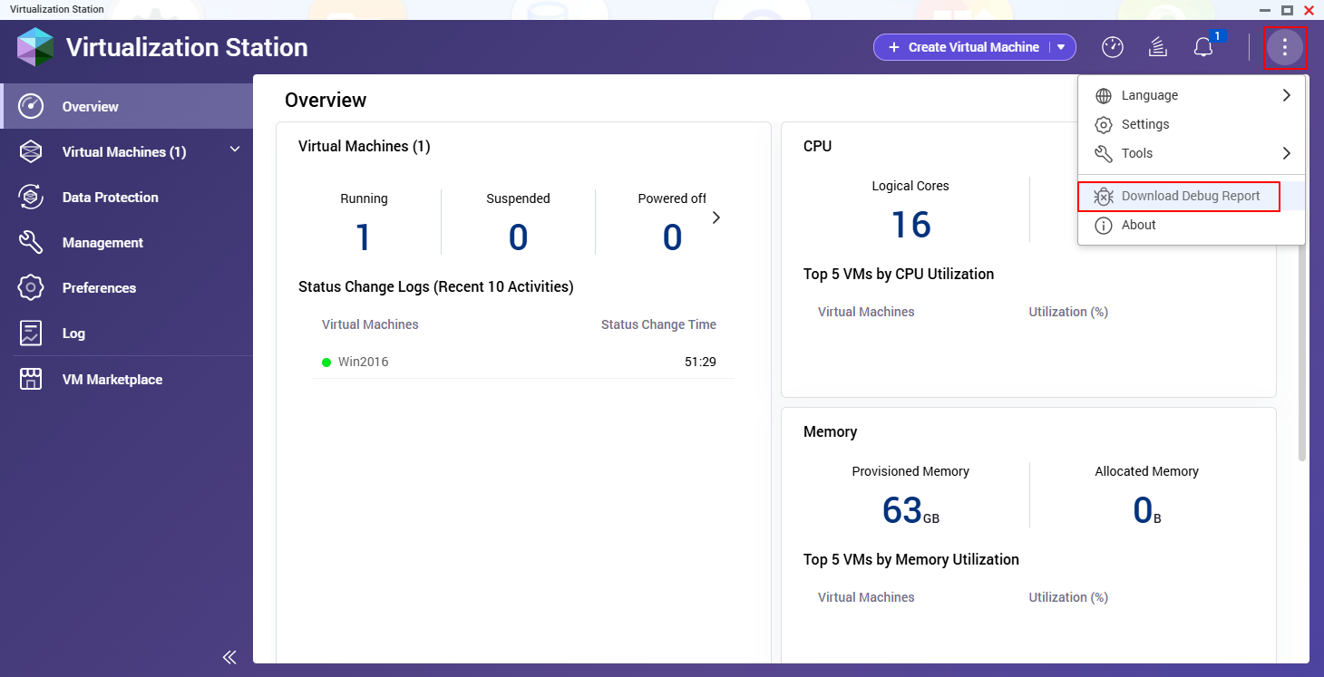

To download the debug log from Virtualization Station:
  1. Open the Virtualization Station application.
  2. Click the vertical 3-dot icon (⋮) in the upper-right corner.
  3. Select Download Debug Report.
    The debug report will be downloaded to your local computer.
Note
Provide the downloaded debug report file to QNAP support when submitting a support ticket to help expedite troubleshooting.
