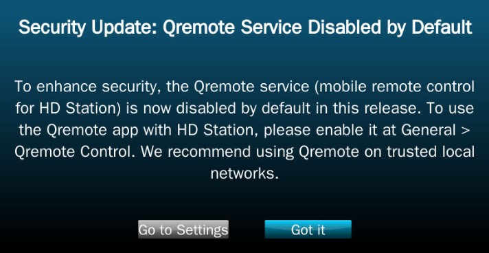

  • Qremote cannot connect to HD Station after the update
  • A security notice appears:
    “Security Update: Qremote Service Disabled by Default”
  • Remote control from the Qremote app does not work
Root Cause
To enhance security, QNAP changed the default setting so that Qremote is disabled by default in HD Station 4.2.22 and later. Users need to manually re-enable the feature.
