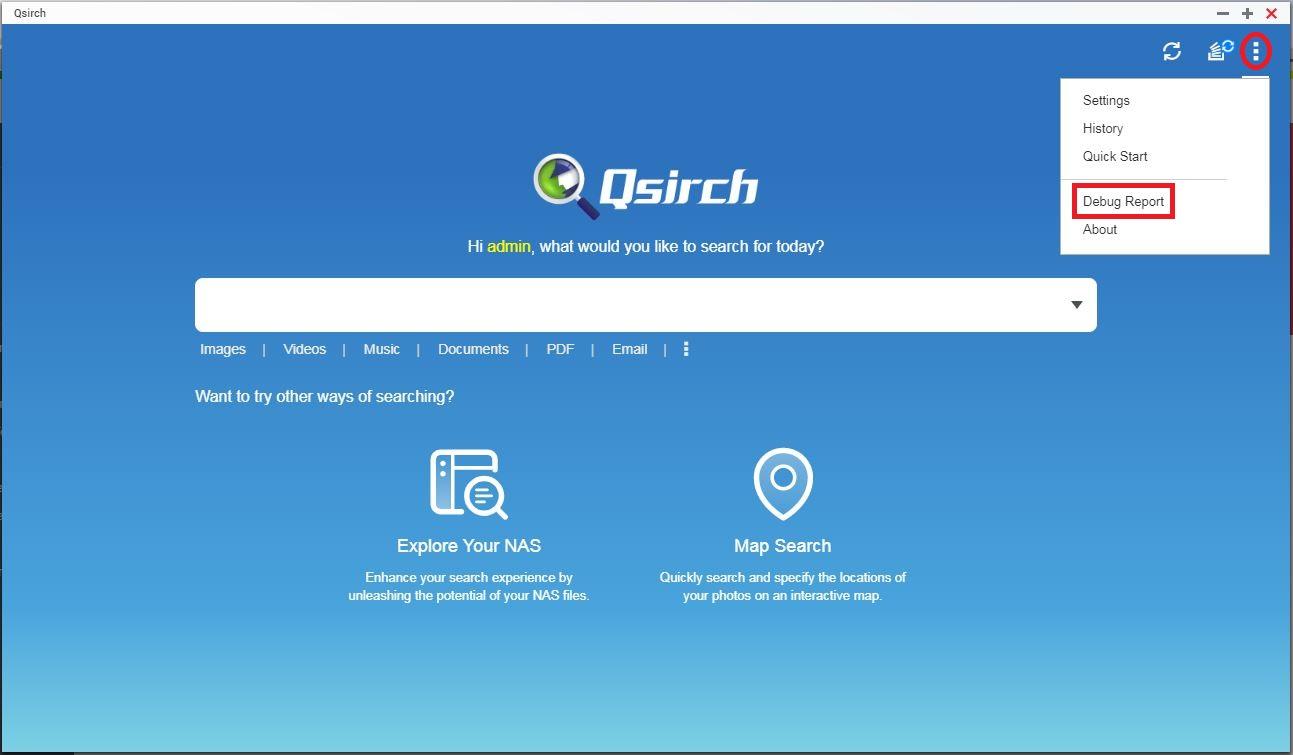

3) Debug Logs from Qsirch, it is showed on the picture below where it can be collected;Qsirch Debug Report.JPG
4) Dump logs from the NAS, see more information below.
