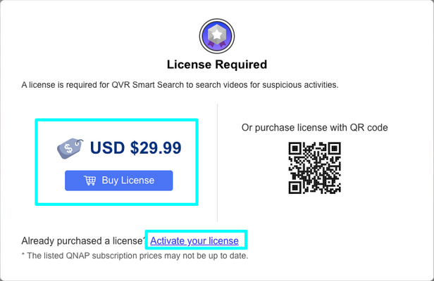

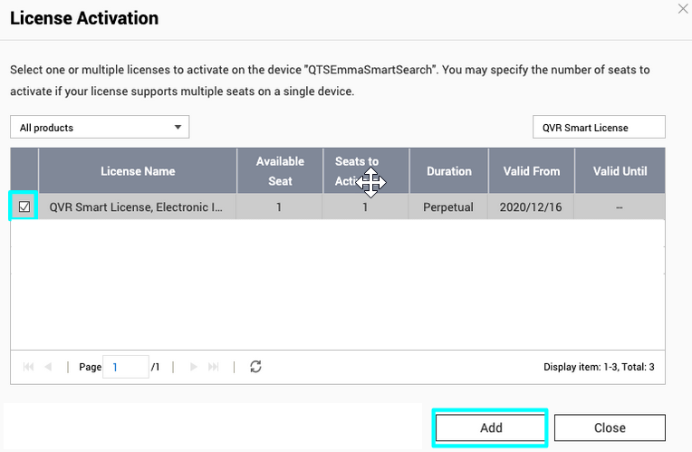

Activating a License

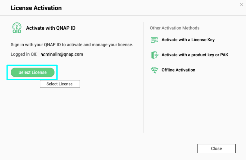

  1. Purchase the QVR Smart Search license at https://software.qnap.com/qvr-smart.html.

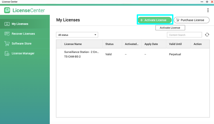

  2. Go to License Center.
    License Center must be version 1.6.10 or later.
  3. Click + Activate License.
  4. Sign in with your QNAP ID.
  5. Click Select License.
  6. Select the QVR Smart Search license.
  7. Click Add.
  8. Click Close.
    Your QVR Smart Search license is added to My Licenses.
    You can also activate the license in QNAP License Manager at https://license.qnap.com/#/.

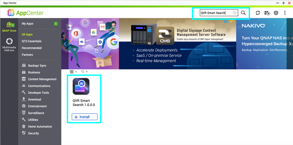

Installing QVR Smart Search
  1. Go to App Center, and then click .
    A search box appears.
  2. Enter QVR Smart Search.
    The QVR Smart Search app appears in the search results.
  3. Click + Install.
    If the window below appears, see Activating a License.

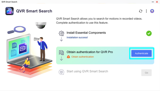

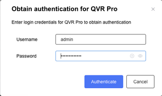

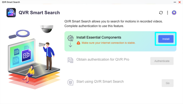

Configuring QVR Smart Search
  1. Open QVR Smart Search.
  2. Click Install to install essential components.
  3. Click Authenticate.

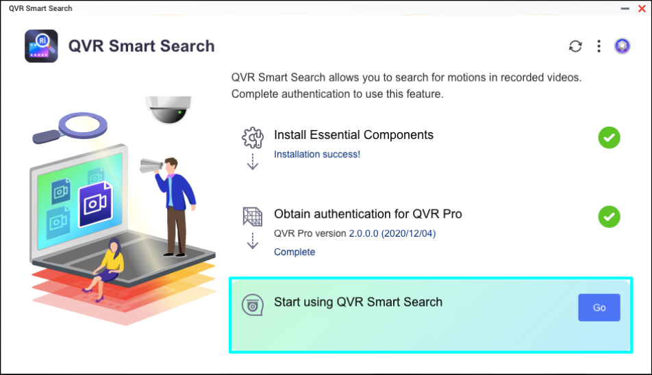

    The Obtain authentication for QVR Pro window appears.
  4. Specify your username and password, and then click Authenticate.
  5. Click Go.

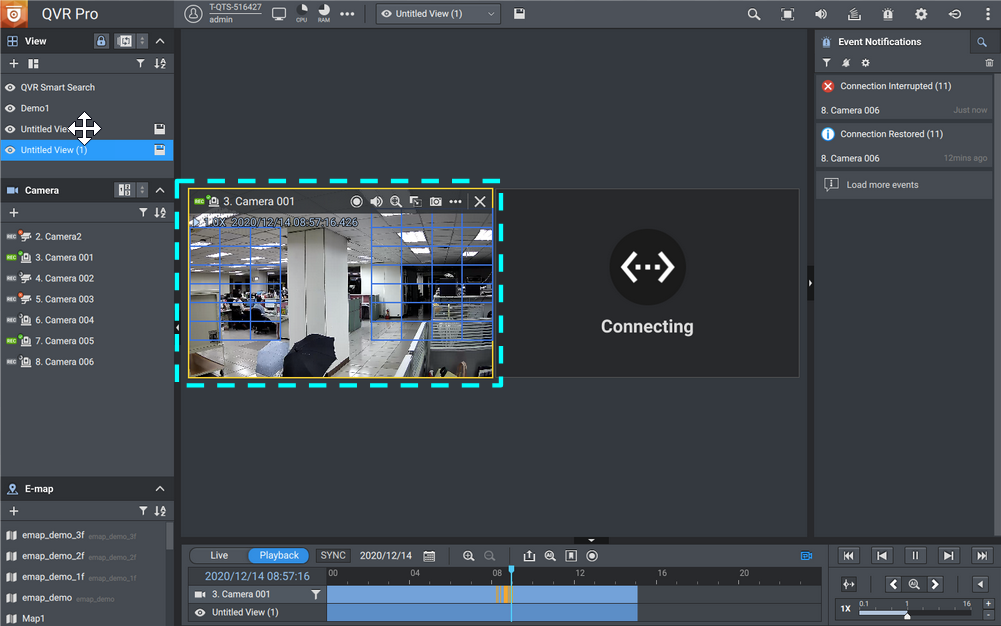

Configuring a Detection Zone

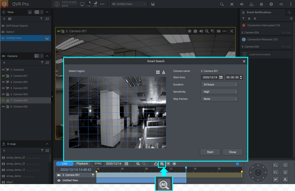

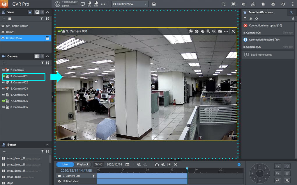

  1. Open QVR Pro Client.
  2. Log into QVR Pro or QVR Elite.
  3. Select and drag a camera into the view.
  4. Click the camera view you want to configure.
  5. Click .
    The Smart Search window appears.

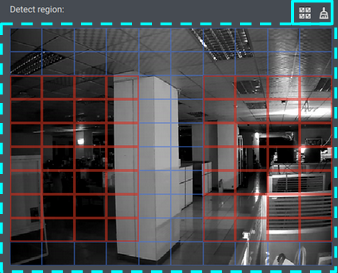

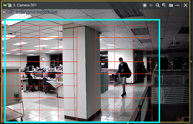

  6. Click and drag a zone or multiple zones in the detection region.
    Tip:
    You can click (Select All) and (Clear) to better help you make a detection zone.

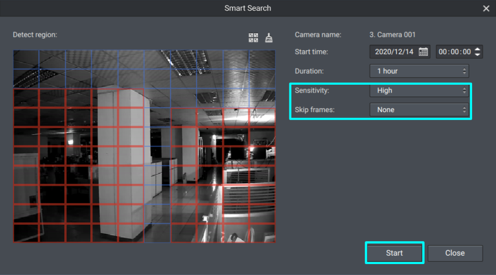

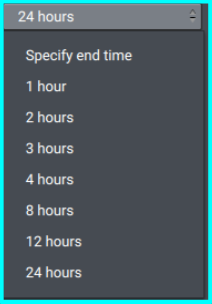

  7. Specify the starting date and time.
    You can also specify an end time if you need to detect for more than 24 hours. The average analyzation time is 2 minutes per hour footage.
  8. Select a duration.
  9. Select sensitivity.
    QNAP suggests choosing Medium.
  10. Select skipped frames.
    QNAP suggests choosing None.
  11. Click Start.
Using Playback

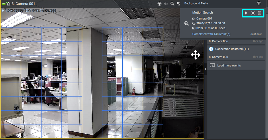

  3. Select an action.
    Action
    Description
    Playback a Recording
    Click to playback a video recording.
    The grids in the detected zone will turn red when an event is detected.
    The timeline runs from the first event in the recording highlighted in yellow.
    Delete a Task
    Click to remove a task.
    Check Configurations
    Click to view configurations.
    Zoom In
    Click to spread each time frame over the timeline.
    Zoom Out
    Click to adjust the timeline.
    Go to Next Event
    Click to go to the next event highlighted in yellow.
    Go to Previous Event
    Click to go to the previous event highlighted in yellow.
