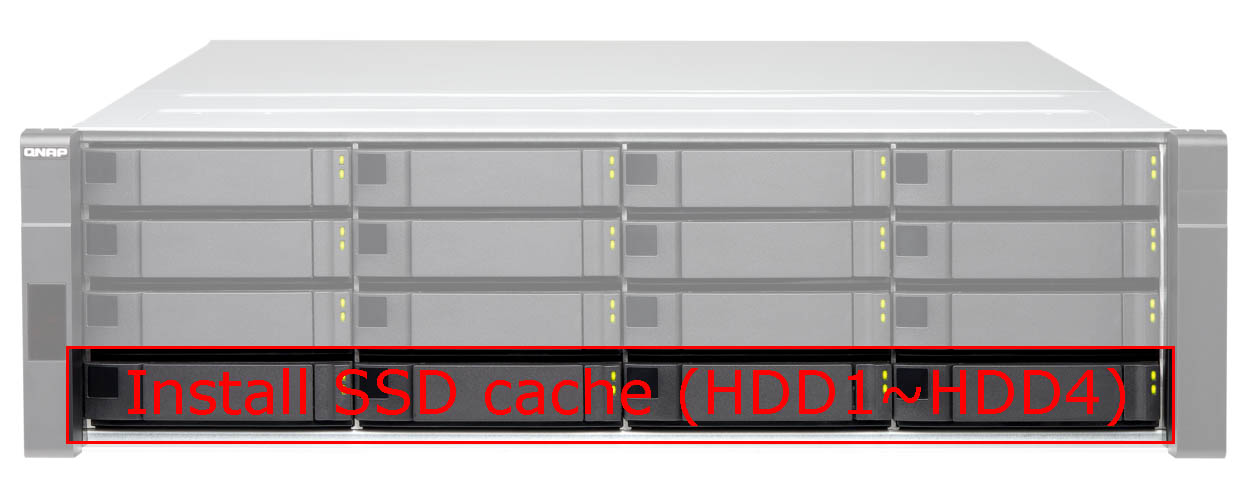

The ES NAS will use drive bays 1 to 4 to store the system configuration, QNAP recommends drive bays 5 to 16 for data storage. This setup prevents data storage operations interfering with the basic operation of the NAS system. It also means that the disks used for data storage can be easily migrated to another NAS.
When using a mixture of SSDs and HDDs, installing the SSDs into drive bays 1 to 4 is recommended.

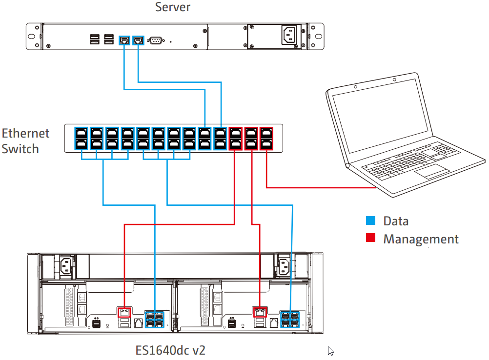

Connecting the ES NAS to a Network
The ES NAS has two types of network ports:
  • Data ports (shown as blue in the diagram below) are used for accessing data stored on the NAS, using protocols like iSCSI, NFS, and CIFS.
  • Management ports (shown as red in the diagram below) are for managing the NAS via QES desktop.

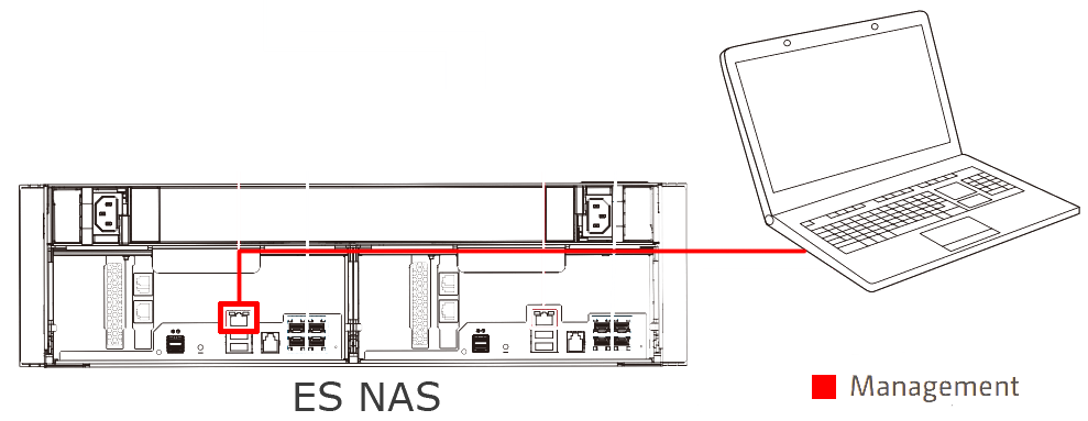

    In an environment without DHCP, connect a PC directly to a NAS management port. Then open a web browser and enter the default QES IP: 169.254.100.100.

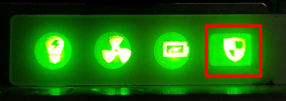

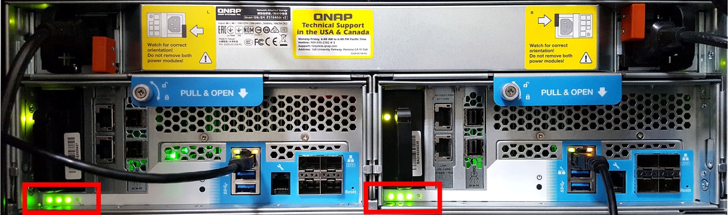

Start-up is finished when the left three of the four LEDs on the rear of the ES NAS turn green.  There are two sets of LEDs, one for each storage controller.

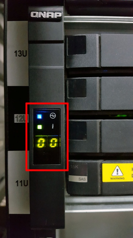

Front panel LCD
Graphical position Position Number
The two-digit number displays the state of the ES NAS power on process.
The left and right digits represent the left Storage Controller (SCB) and the right Storage Controller (SCA) respectively.
No-Display: BIOS booting
1: Device detecting
2: Network settings
3: System settings
4: Services start
5: System self-testing
0: System ready

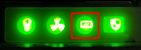

Rear panel LEDs
Graphical position Description LED color Status
System status Green Off = System is powered off
Green= System is operating normally
Flashing green=System is starting up
Fan Green
Orange
Green= Fan is operating normally
Orange= Fan error
Off = No fans detected
NVRAM Green
Orange
Green= NVRAM enabling
Orange= executing data protection
Off = One or more of the following conditions exist:
  • The storage controller is not powered on.
  • The system cannot detect the BBU.
High Availability Green
Orange
Green= Active
Flashing orange= Performing takeover or undergoing giveback
Orange= The storage controller has taken over from the other storage controller
  • The storage controller has failed over to the other storage controller

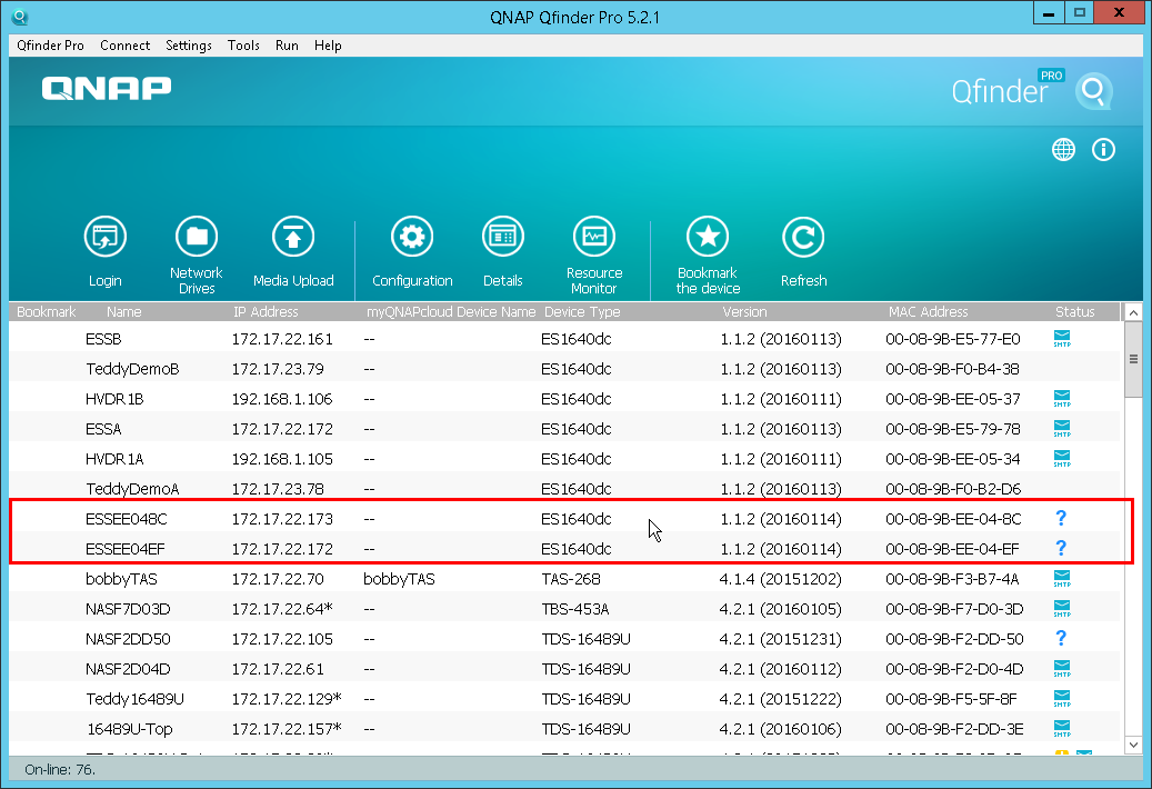

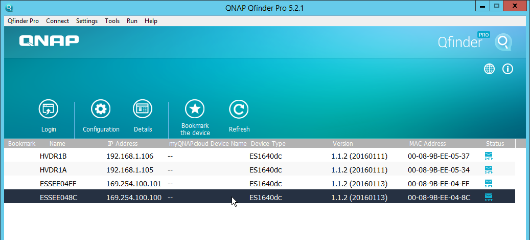

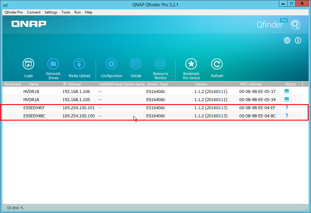

  1. Run Qfinder Pro. Qfinder automatically searches for QNAP NAS on your local network.
    Note: The Qfinder client and NAS must be on the same subnet.
  2. Locate IP address 169.254.100.100 in the Qfinder device list. This device the new ES NAS. The status shows “?”, meaning that the ES NAS hasn’t been configured before.
    Note: If both management ports and the Qfinder client PC are connected using a switch, then Qfinder will also show a second new device 169.254.100.101. This is the IP address of the second management port and storage controller.

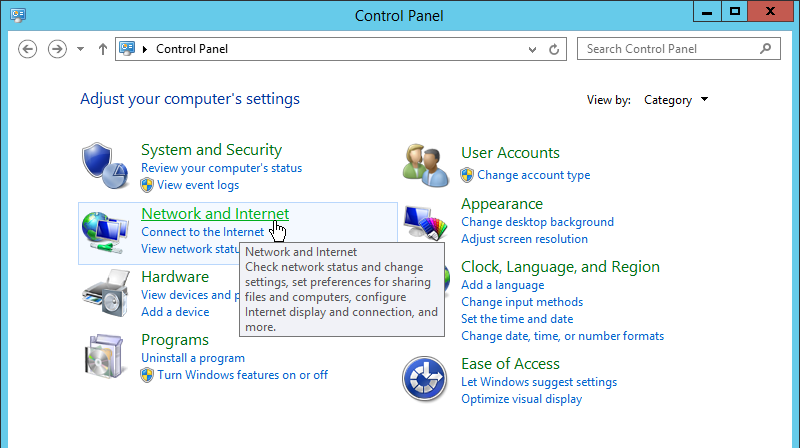

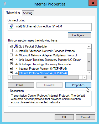

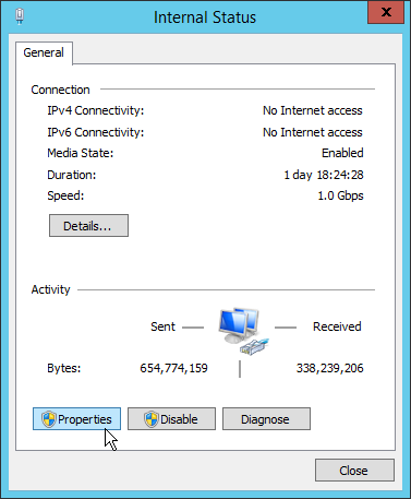

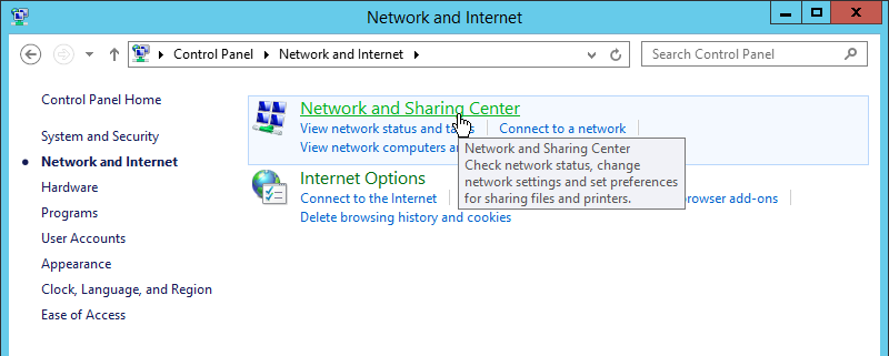

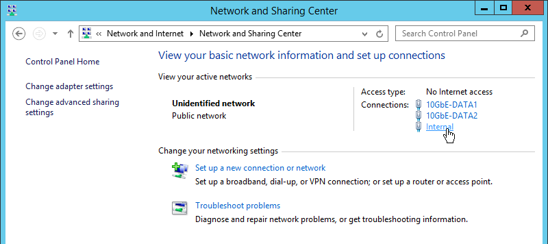

  3. Configure the PC network settings to be in the same range as the ES NAS. Using a PC with Windows Server 2012 R2 as an example:
    1. Go to “Control Panel” > “Network and Internet”:
    2. Click “Network and Sharing Center”.
    3. Select the network interface connected to the ES NAS Management port. In this example it is called “Internal”.
    4. Click “Properties”.

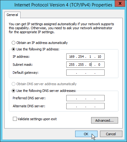

    5. Select “Internet Protocol Version 4 (TCP/IPv4)”, and click “Properties”.
    6. Enter the IP address “169.254.1.10”, and Subnet mask “255.255.0.0”. Click “OK”.

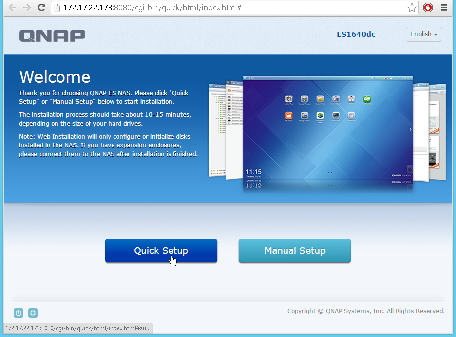

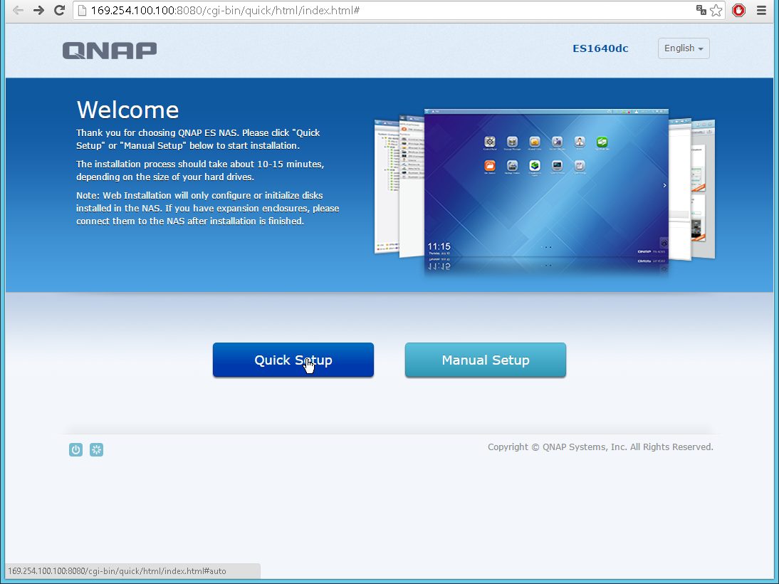

  4. Open Qfinder, and double click on one of two uninitialized NAS.

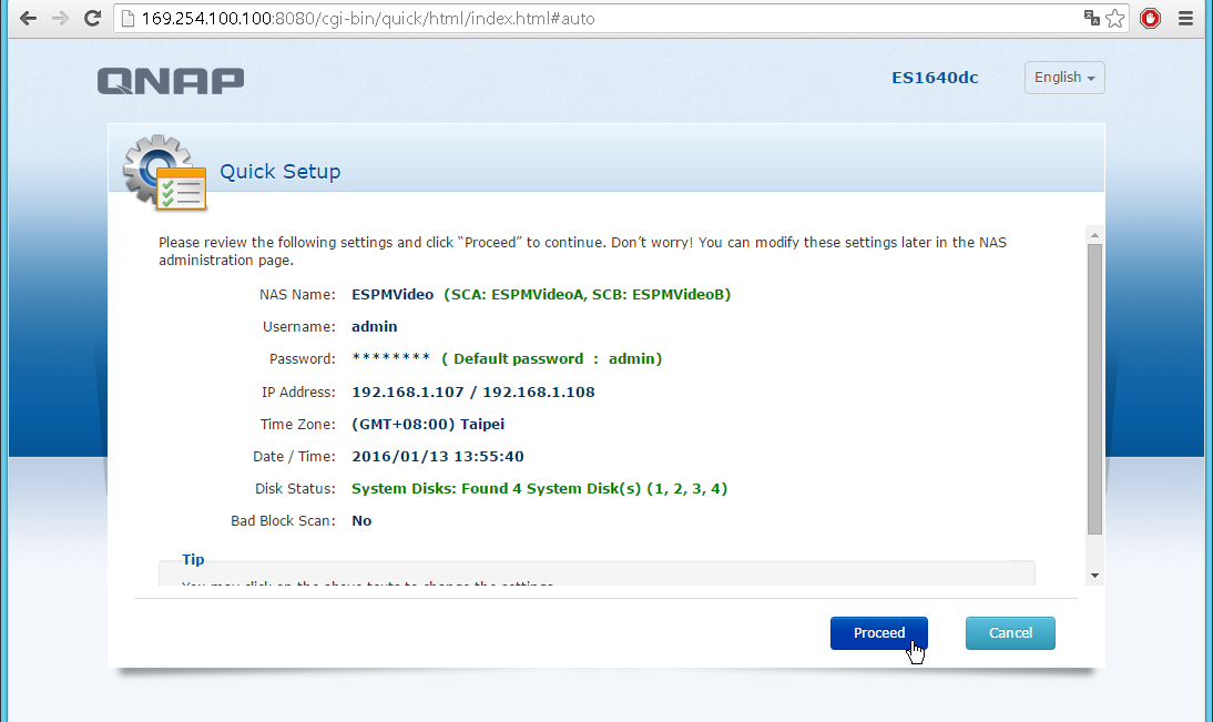

  5. Follow the on-screen instructions. The Qfinder Pro Setup Wizard will guide you through the setup process. Click “Quick Setup” to initialize the NAS with common settings. Click “Manual Setup” to configure the NAS with advanced settings.

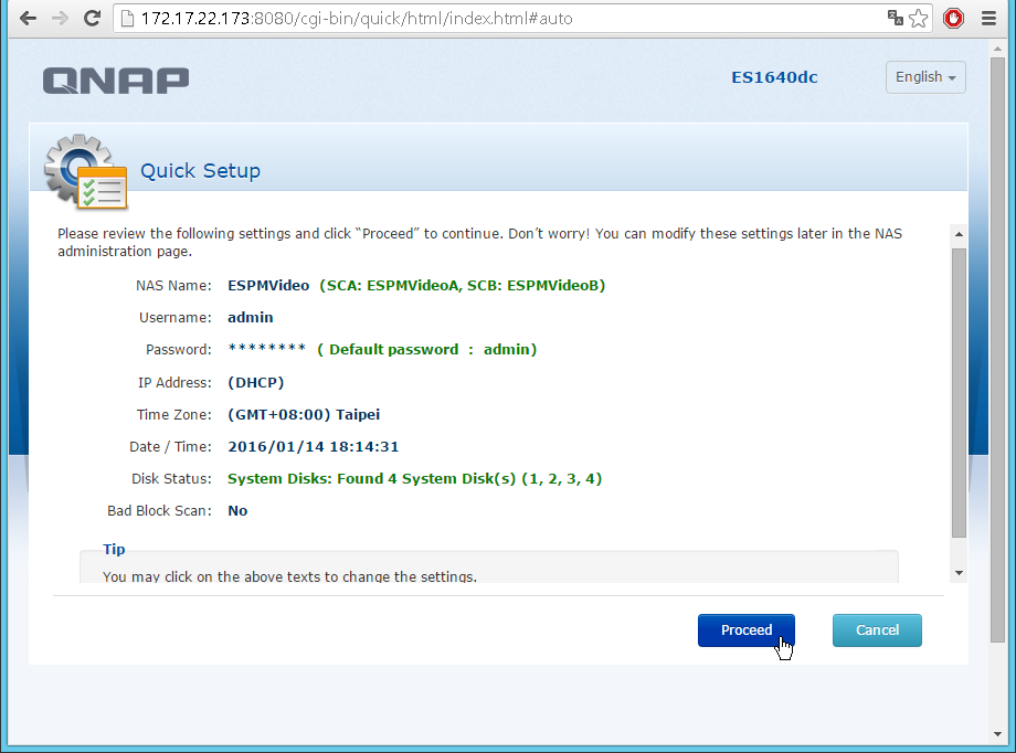

  6. You can configure basic settings on this page, including IP address, username and password, and NAS name.
  7. In this example the NAS is going to use a fixed IP, so click the IP address field to modify it:

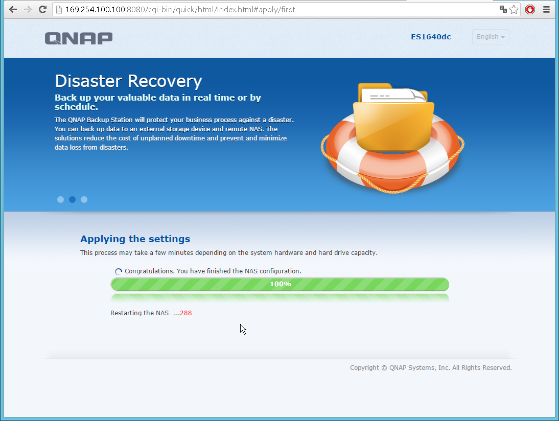

  8. Specify a static IP Address for the NAS. In our example, we have two management ports connected and our LAN network is 192.168.x.x, so we use “192.168.1.107” and “192.168.1.108”. Click “Proceed”.

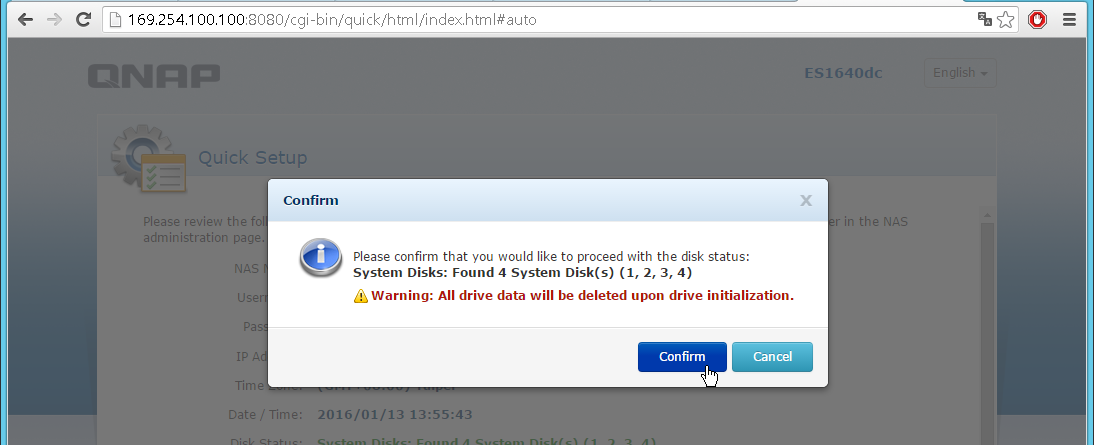

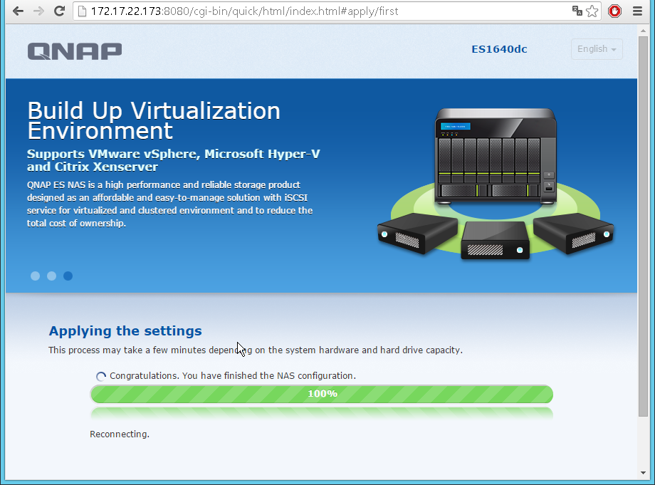

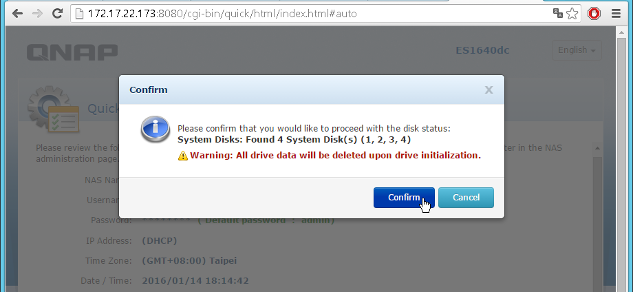

  9. A confirmation message appears. Click OK to confirm initializing the system disks.
    Warning: All data on the disks will be deleted
  10. The NAS will restart.

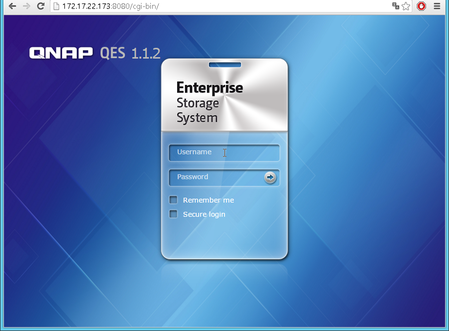

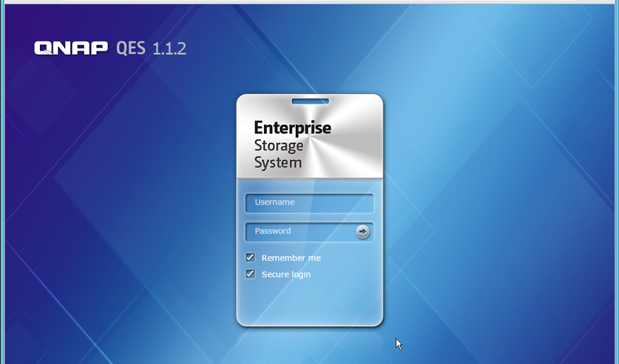

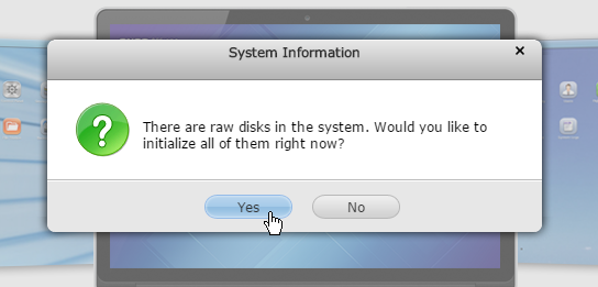

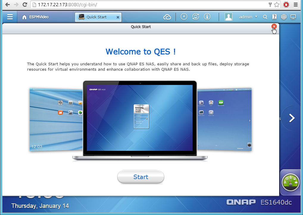

  12. After the ES NAS has finished restarting, double click on your NAS in Qfinder Pro to go to the login page. Log into QES with your username and password created during setup.
    Note: The default username and password is admin/admin.

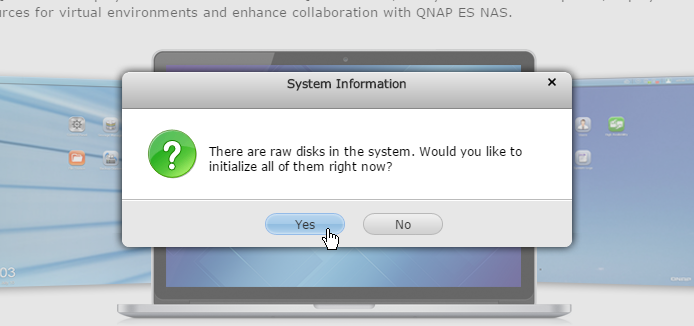

  13. The system prompts you for confirmation of disk initialization, if any raw unused disks are found. Click “Yes” to begin disk initialization or “No” cancel.
The QES NAS management interface is now ready to use.

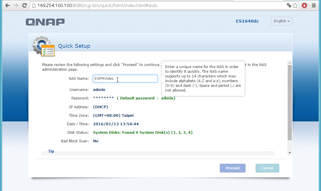

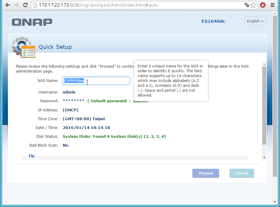

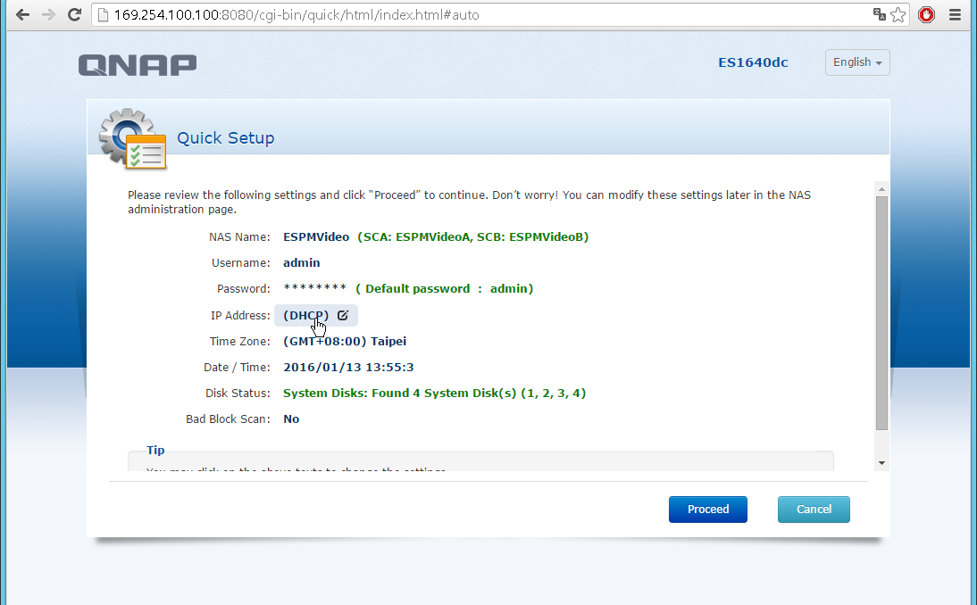

  3. Click “Quick Setup”.
  4. Specify a name for the NAS.
  5. Configure the remaining settings and click “Proceed”.
  6. A confirmation message appears. Click OK to confirm initializing the system disks.
    Warning: All data on the disks will be deleted.
  7. The ES NAS will apply settings and then restart.
  8. Log into QES with your username and password created during setup.
  9. The system prompts you for confirmation of disk initialization, if any raw unused disks are found. Click “Yes” to begin disk initialization or “No” cancel.

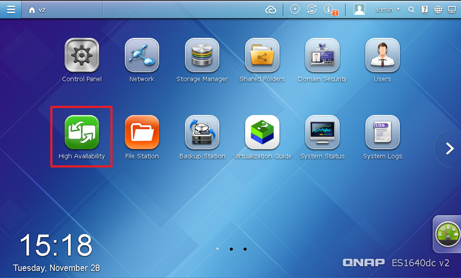

Check the Status of System and Hardware Components

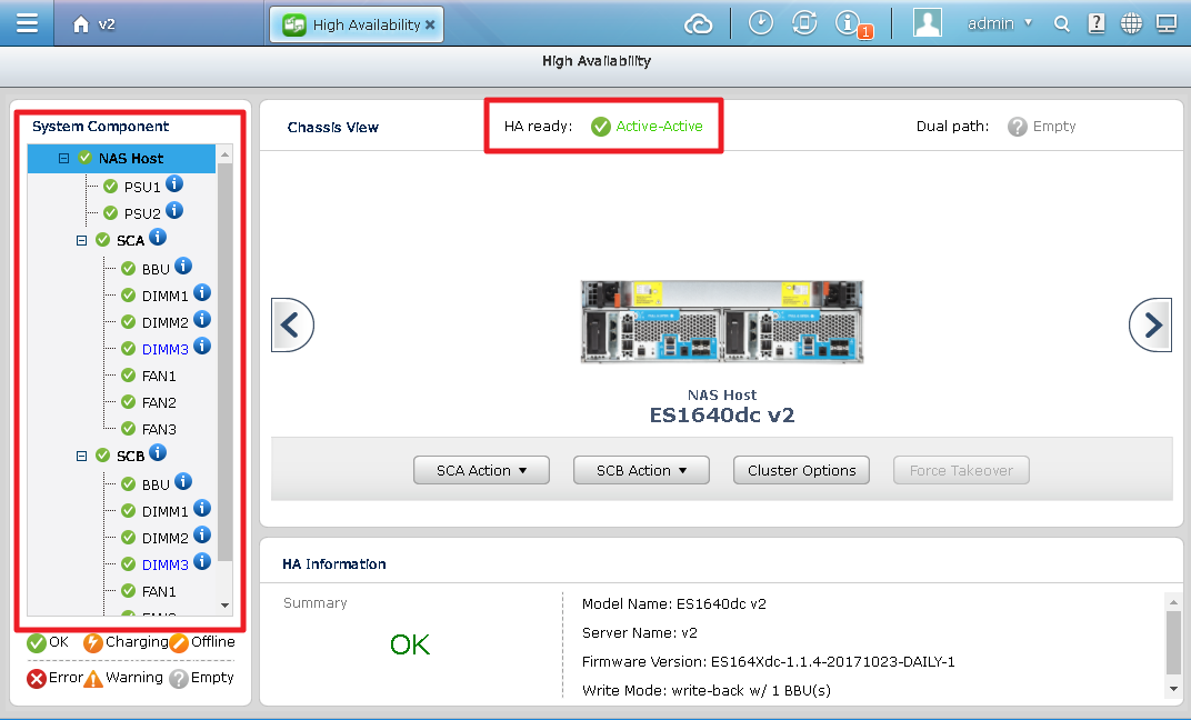

  1. After logging in to QES, it is recommended to check the status of system and hardware components. Click “High Availability” on the QES desktop.
  2. Before using the NAS, check if the System Components (displayed on the left) and the “HA ready” field (at the top) are all green. This indicates that the status is normal. Some of the components (for example, the PSU) may take longer (approximately 90 seconds) to confirm and show their status. If any components appear to be abnormal, check if the component is properly installed.
