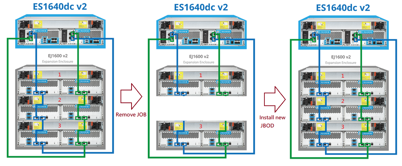

In this case, we will show you how to replace No.2 JBOD without stopping storage service running on other JBODs.

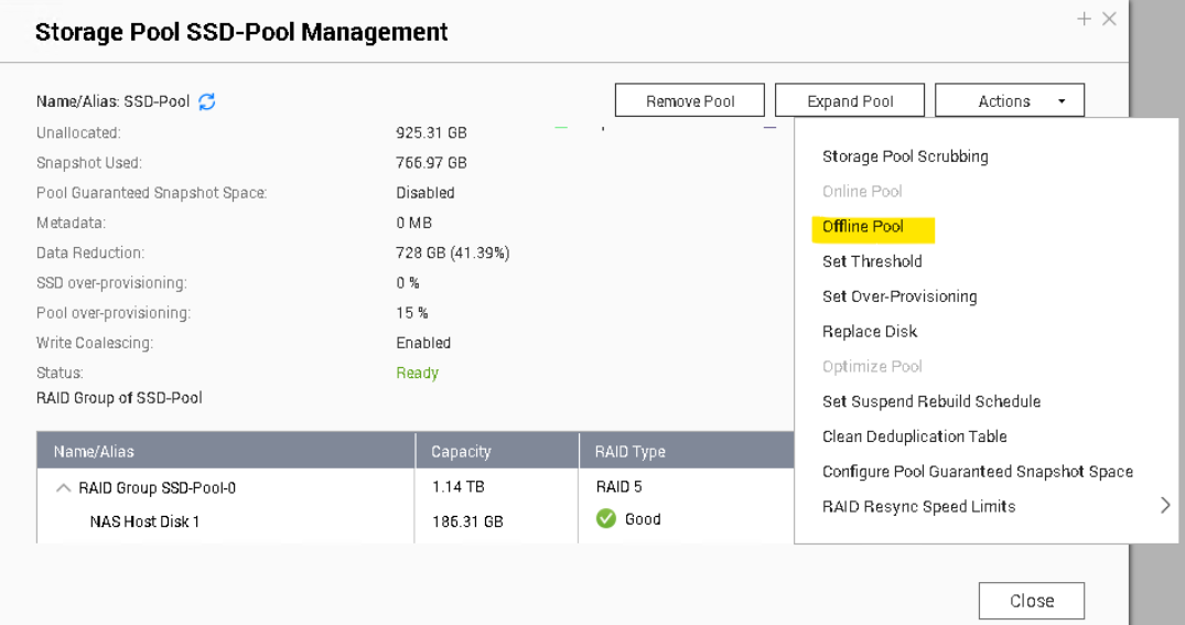

If an existing pool member resided on this JBOD, please take pool OFFLINE first!
Then you can start to remove the JBOD by following steps below.
  1. (For ES NAS model) Disable JBOD failover in the HA page of the NAS.
  1. Powered-OFF JBOD by holding power button.
  2. Plug out SAS cables which connect to No.2 and No.3 right in this JBOD.
  3. Plug out power cables from this JBOD.
  4. Unmount JBOD from rack.
  5. Remove drives.
After old JBOD removed, let’s start to replace new JBOD
  1. Mount new JBOD to rack.
  2. Install drives.
  3. Plug in SAS cables.
  4. Plug in JBOD power cables.
  5. Turn on JBOD Power.
  6. (For ES NAS model) Enable JBOD failover in the HA page of the NAS
